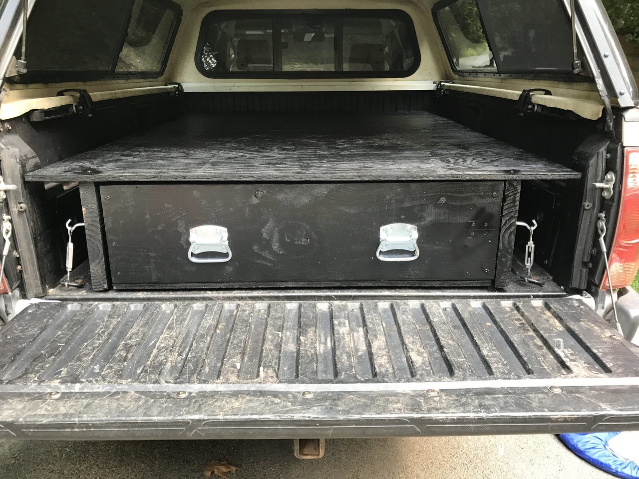

    I actually gave my old platform to another TW member. But I had pieces of plywood left over that I was able to use for this. The only material I had to buy were the 2x6's, 2x10, and more carpet. :)

    Very nice! I'm giving my old one to another member as well. All I needed was two 2x12x16' and two sheets of 1/2" plywood, but even that came out to $110. Those 2x12's weren't cheap! I'm happy with it though and it'll hopefully last a long time. On an unrelated note, is that a solar panel controller I see in the background?

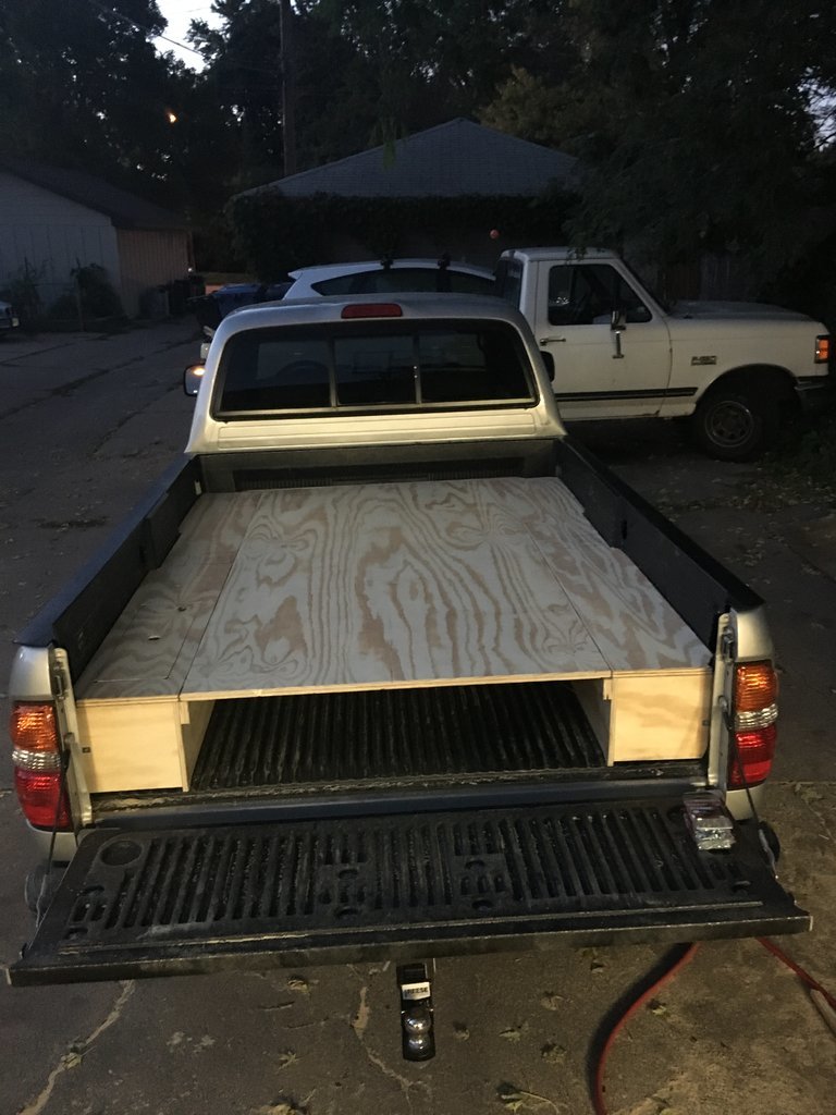

    Productive day installing this sleeping platform. Thanks guys for your tips and infoIMG_0386.jpgIMG_0394.jpg

    I like what you did notching out the 2x10 center support to accept your cross slat. Looks great!

    Thanks! It was practically the only option I have, unless I simply attach a foot to that cross slat. Since the center support is the same height, it adds to the rigidity to the platform. Keeping it simple.

    Not secured just notched 2x10 and the landings hold the 2x6. The weight from the plywood holds everything together. I like it because I can always remove everything if I need the room.

    I had planned on some turnbuckles when I was planning the platform, but after throwing it in for a test fit I didn't bother. My wood deck is VERY tight when I installed the carpet. Takes some real effort to lift the 2 1/2's apart.
    I have climbed into the bed many times and it stays rock solid as I climb on it. No shifts no tipping. Several months of driving has not had any rattles or anything. So basically make it as precise and tight fitting as possible.

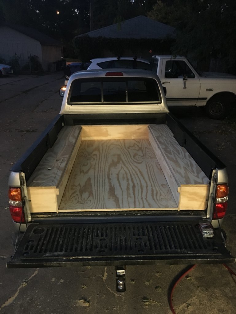

    Here is my quick setup I made. I basically copied another members setup I saw in the forums. I have to finish the stash boxes along the sides. The top is 3/4" plywood and the vertical pieces are 1/2" ply to fit in the grooves of the factory bed liner. I also plan on staining it soon.

    I like the quick removal of the center section for a tall load.

    I'm also using a couple turn buckles on the rearward corners.
