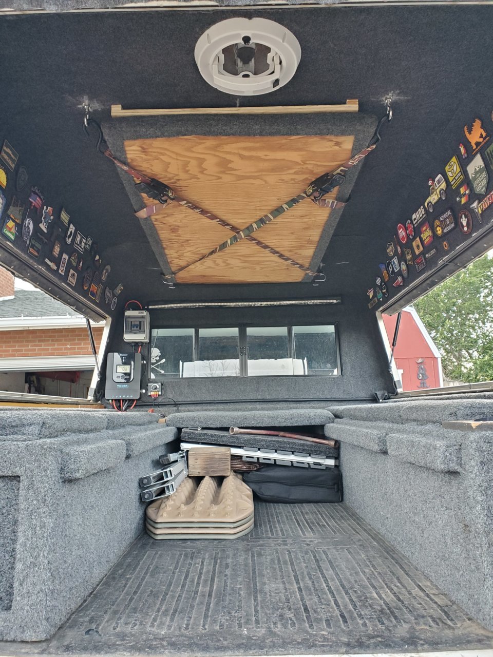

    Trying something different to free up some space inside of my camper. I put 4 eyebolts in the ceiling and strapped my table top and main cushion to see if that will work.
    So far they have stayed secured to the ceiling for a 200+ mile off-road trip last week without coming loose.
    I have a camping trip this weekend, so I will see if this works and if I like it.

    Looks good but if I could make a suggestion- reduce the length of the eye bolts and add either fender washers or backing plates. The lateral stress caused by the straps pulling is likely going to lead to eventual cracking and enlargement of the holes through the fiberglass, especially when off-roading. Look at the way eyes/tie-downs are added to boats for an example. Just wouldn't want to see you get water intrusion into the fiberglass mat (most shells are chopper gun construction)- once you get water leakage started you'll get fungus and it'll start degrading the fiberglass.

    Thank you, I had thought about that. These were the shortest eyebolts I could find, I probably need to take them back out and cut about a 1/2 inch off of each one.
