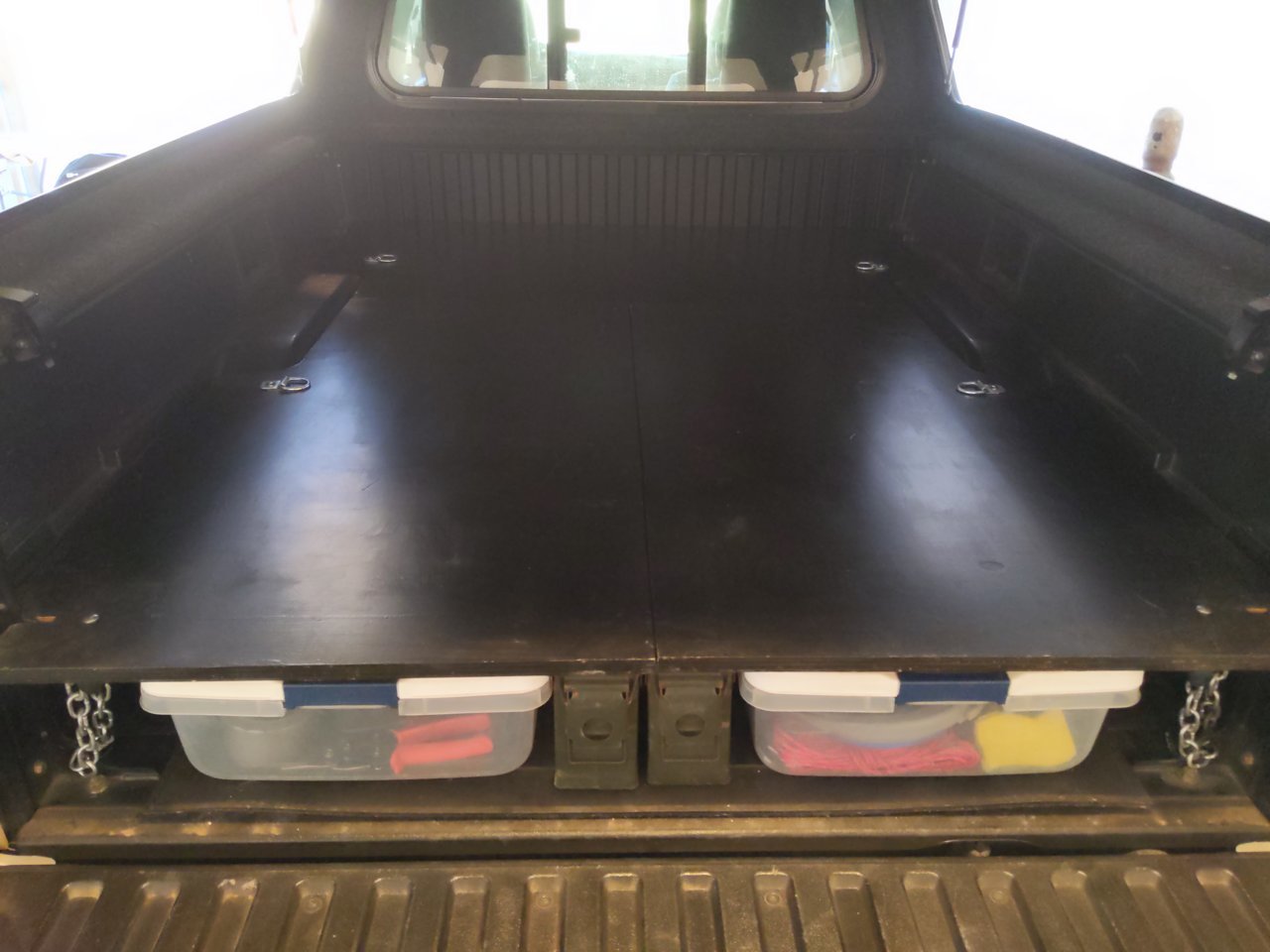

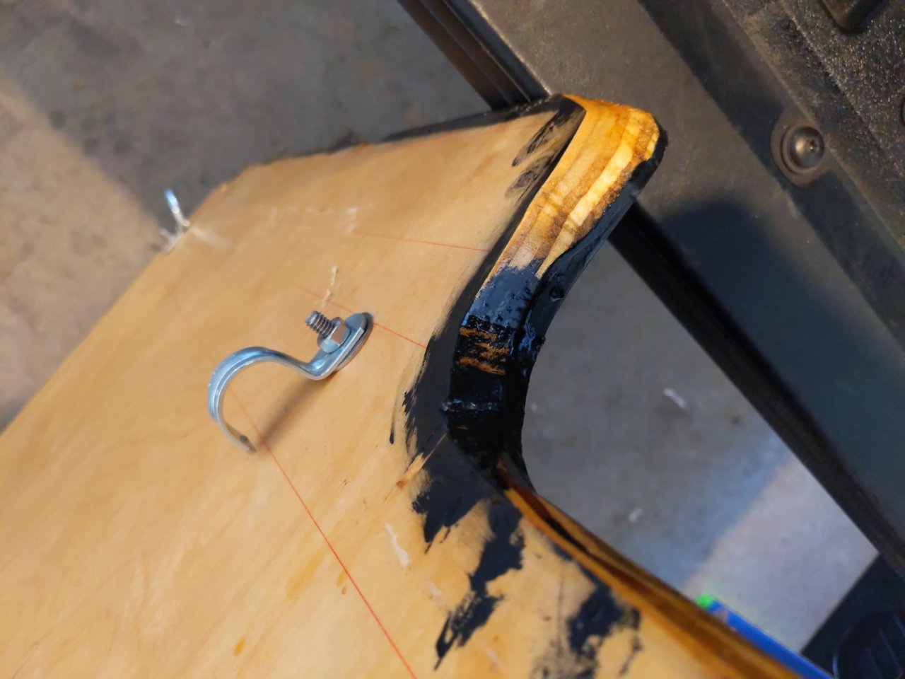

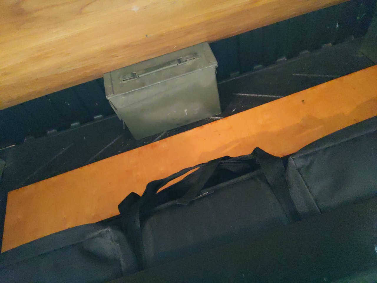

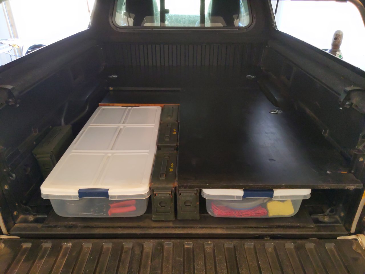

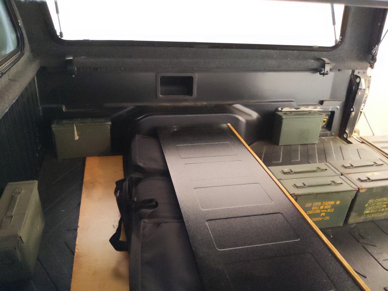

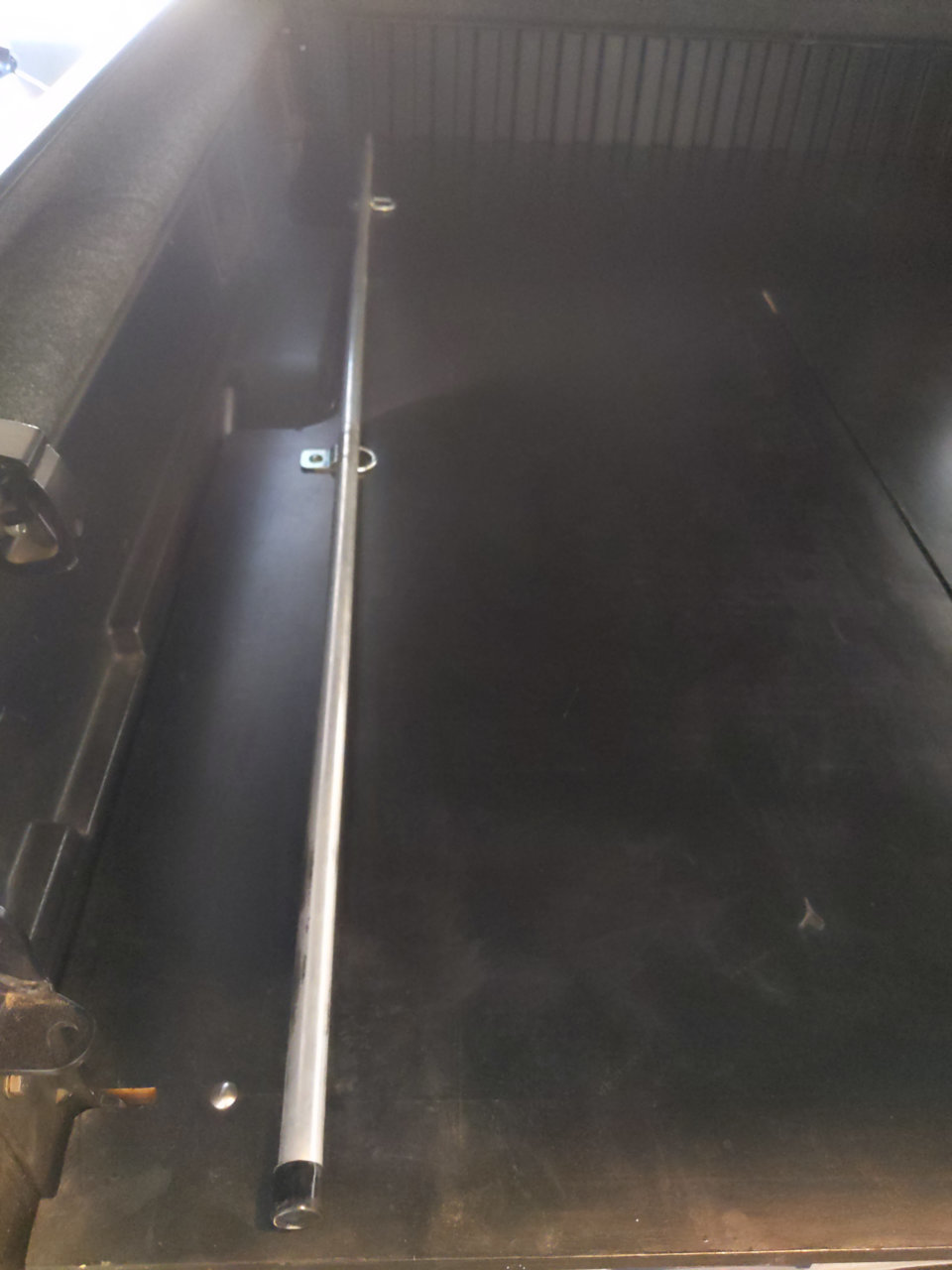

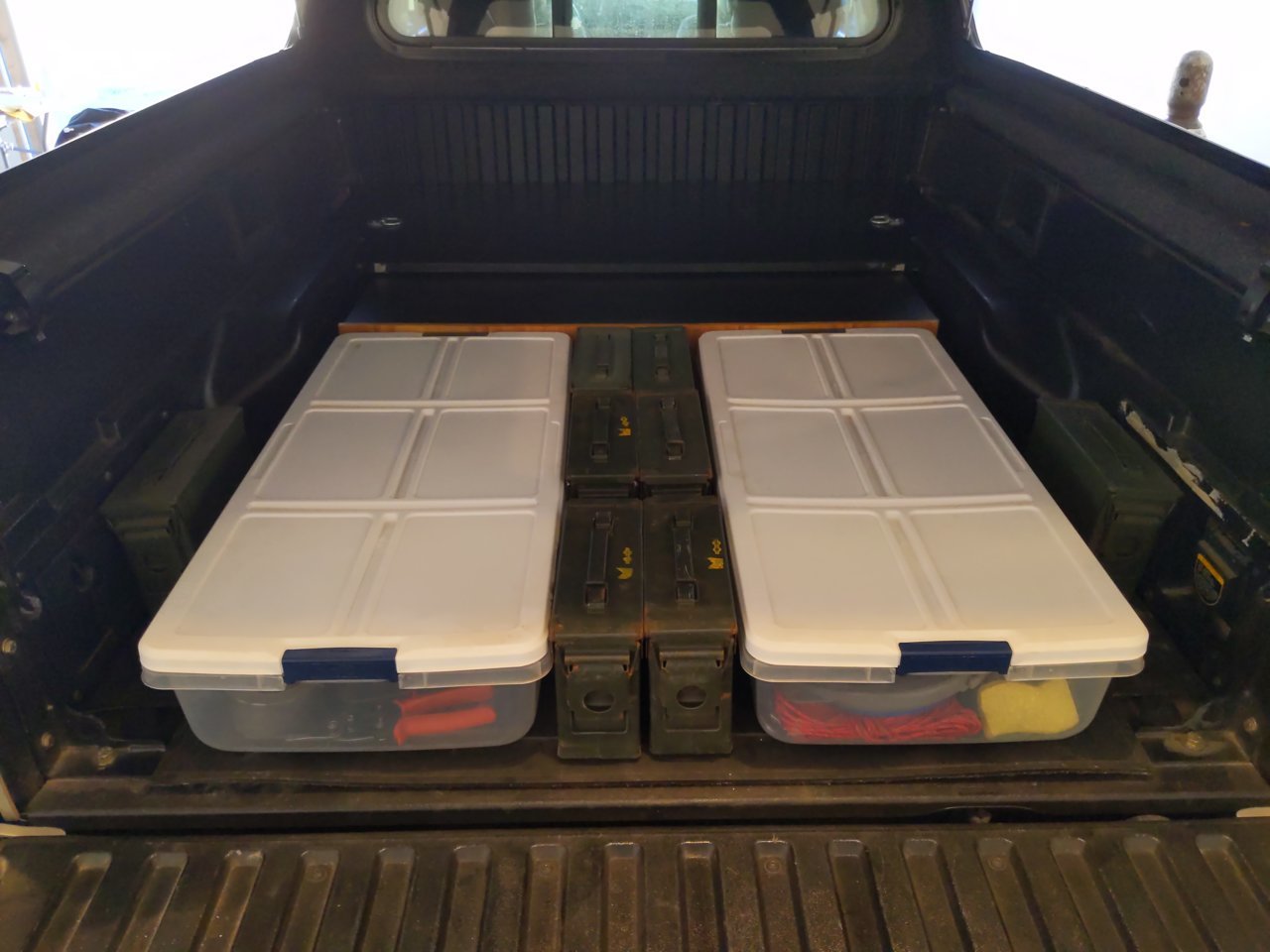

    Hey all, There are a lot of great ideas in this thread. Here is what I'm using:
    11 30cal cans (could've easily used 2 less in the middle, but I had them laying around)
    3/4" plywood. 3 segments, taper around wheel wells. Stained black, and added a few coats of spar urethane.
    Hornady case, bolted down to the bed between the wheel wells, with rivnuts. Door of case is facing truck cab and can be accessed by tilting front plywood piece up (last pic).
    a couple pieces of plywood to help distribute weight in front & rear of Hornady case.
    2 pieces of chain to secure plywood to truck bed
    6 tie down rings (4 facing up to tie down gear, 2 facing down to loop chain through)
    2 padlocks to secure chain to tie down
    2 tarp poles (these run the length of the bed and fit right between the Hornady case and wheel wells)
    4 conduit clamps to hold tarp poles
    Note that it is necessary to (unlock and) open the tailgate, and slide out the two tarp poles to be able to lift up the front piece of plywood to access the Hornady case door.
    This has worked well, though I think I will also secure the two pieces of plywood together in the middle with a locking gate latch. This should be able to fit on the underside, between the first and second set of 30cal cans.

    Holy heavy overkill! But it'll work!
