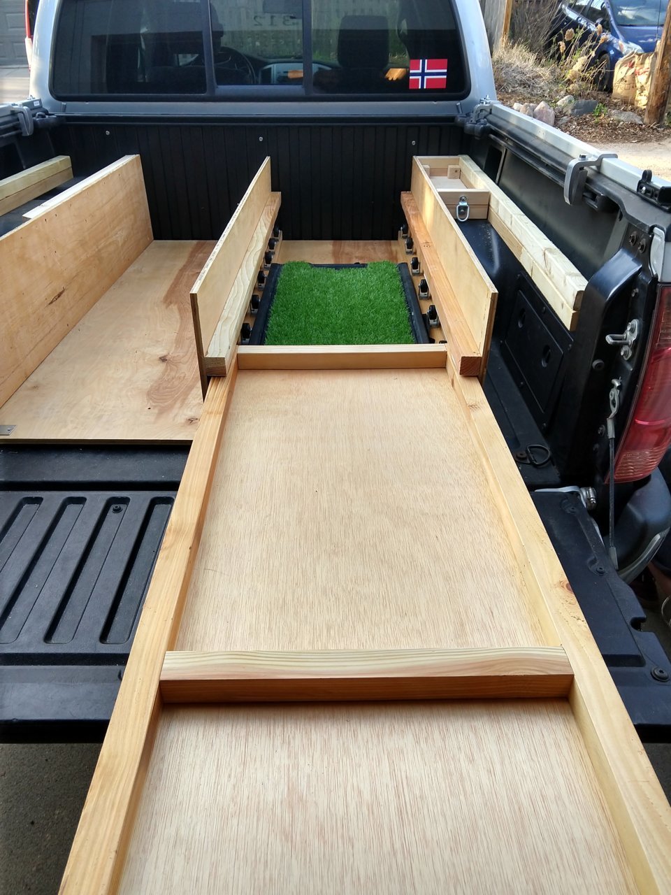

    Love the dog ramp++++

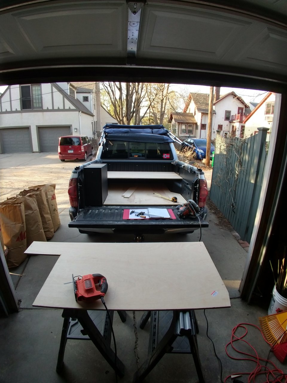

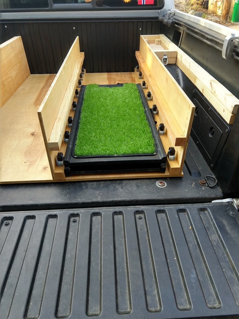

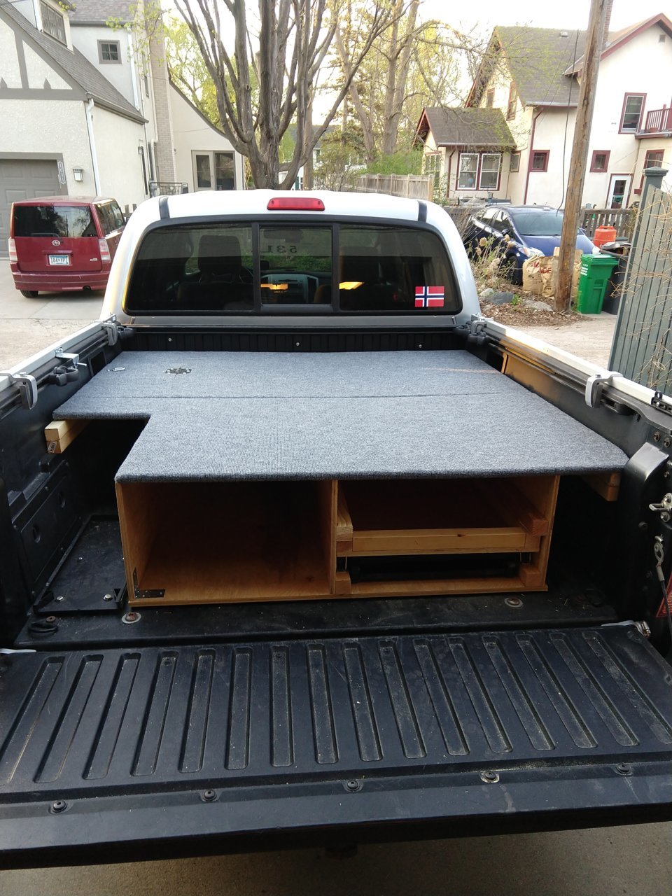

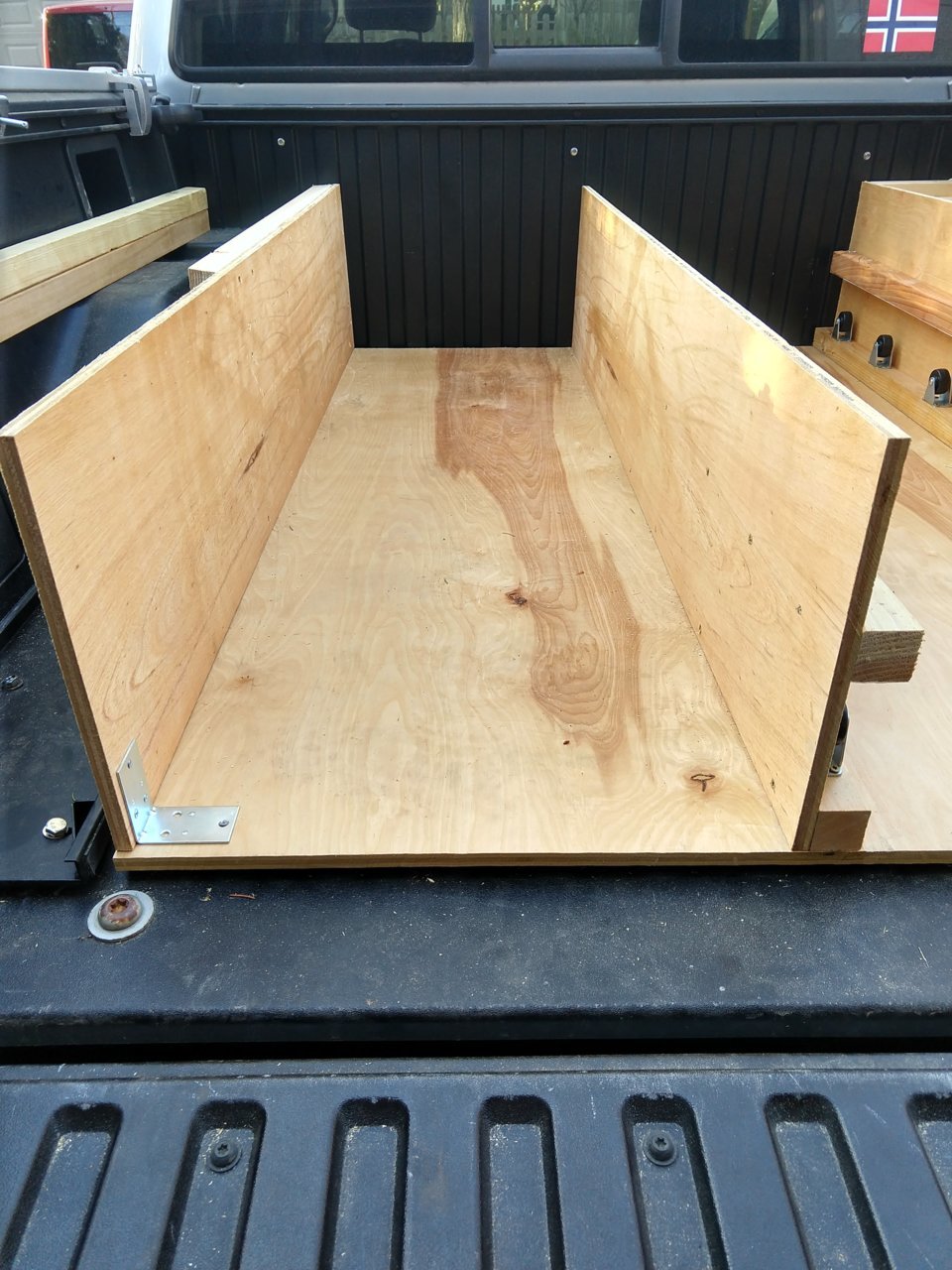

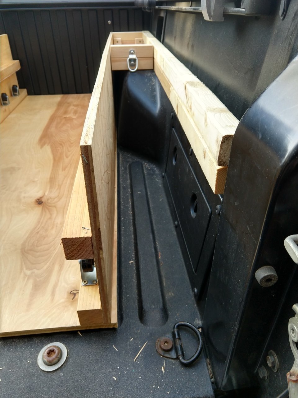

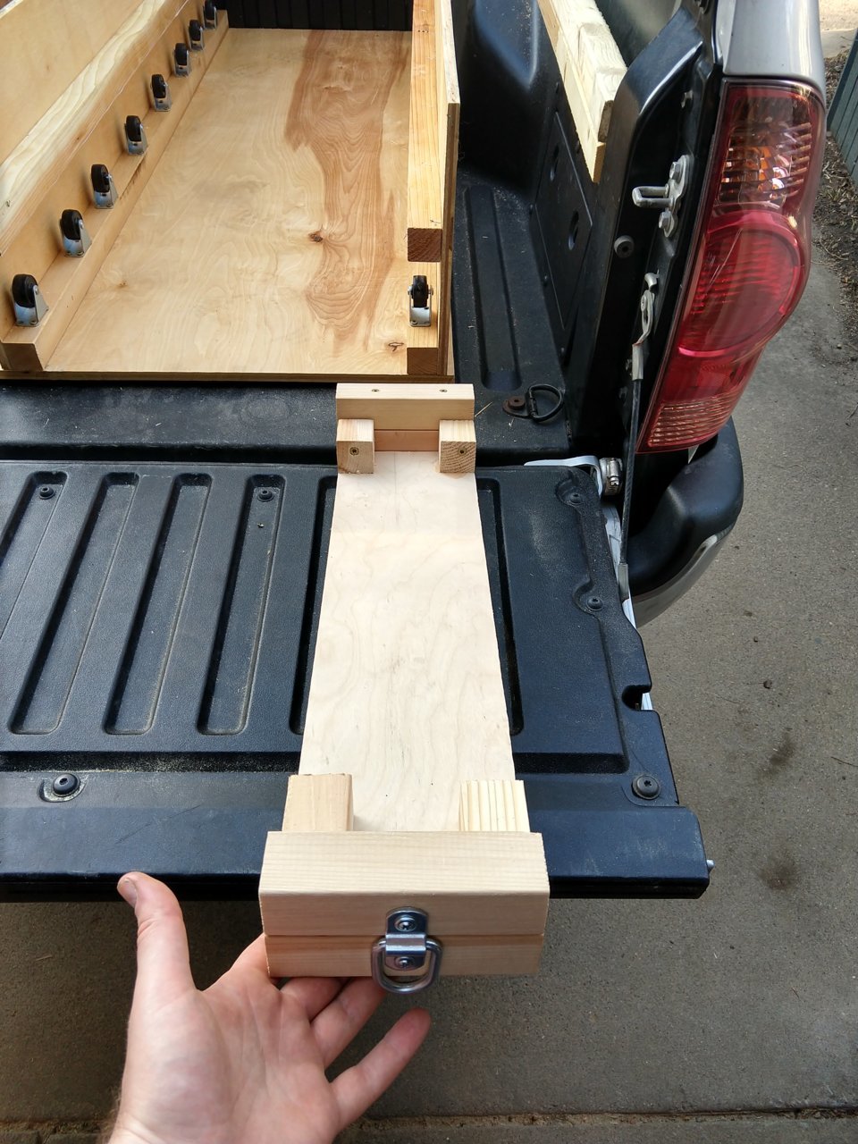

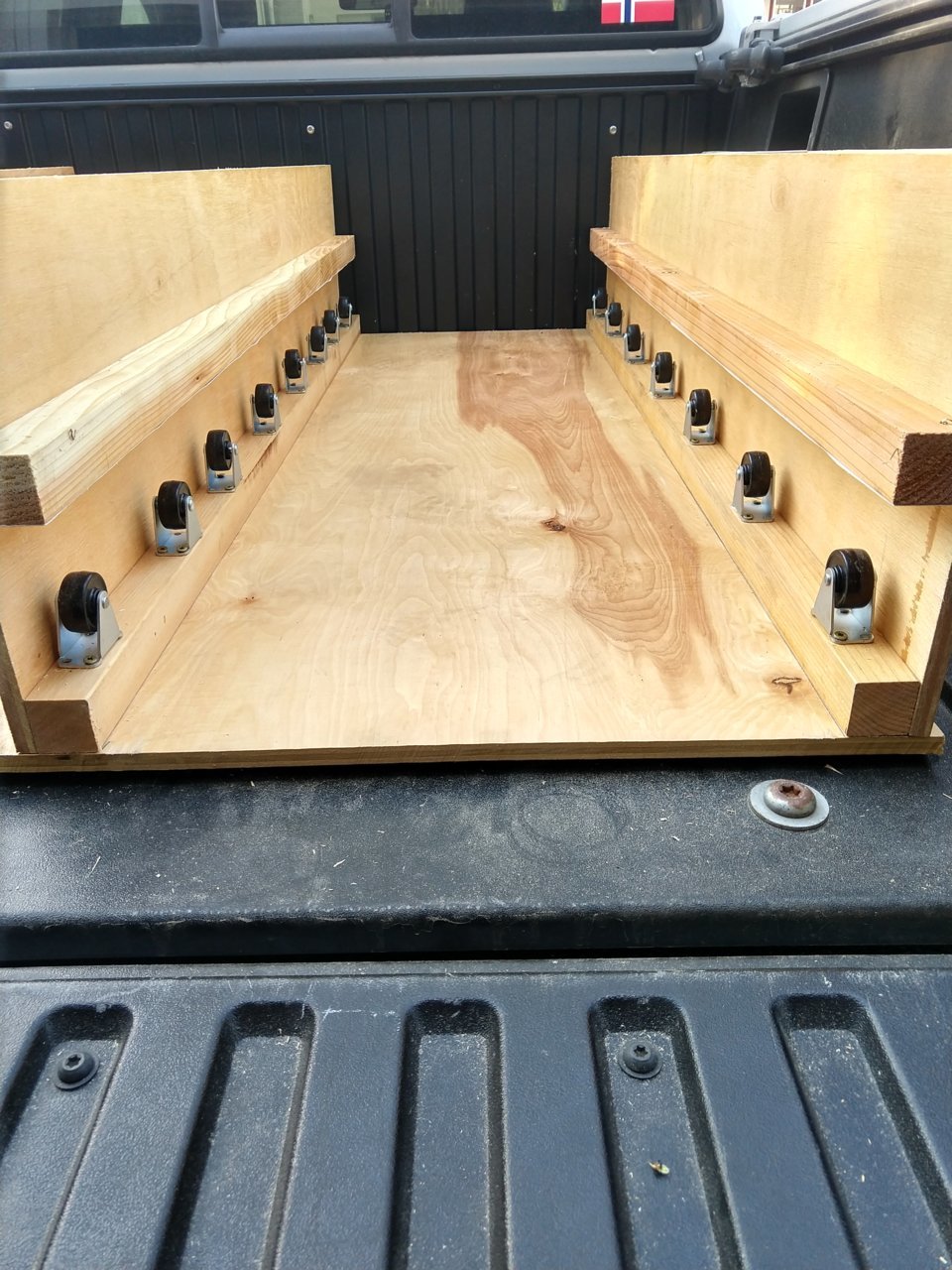

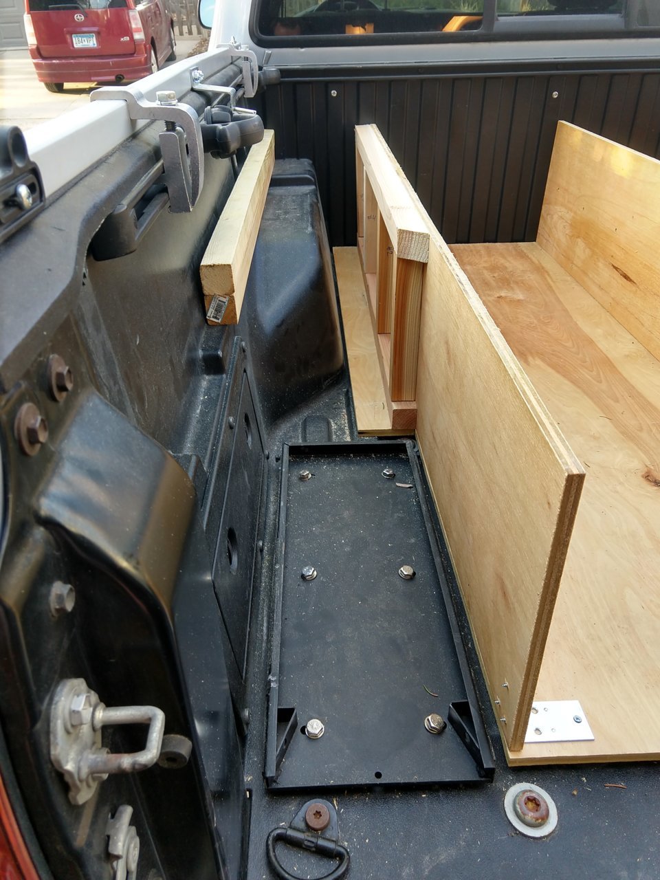

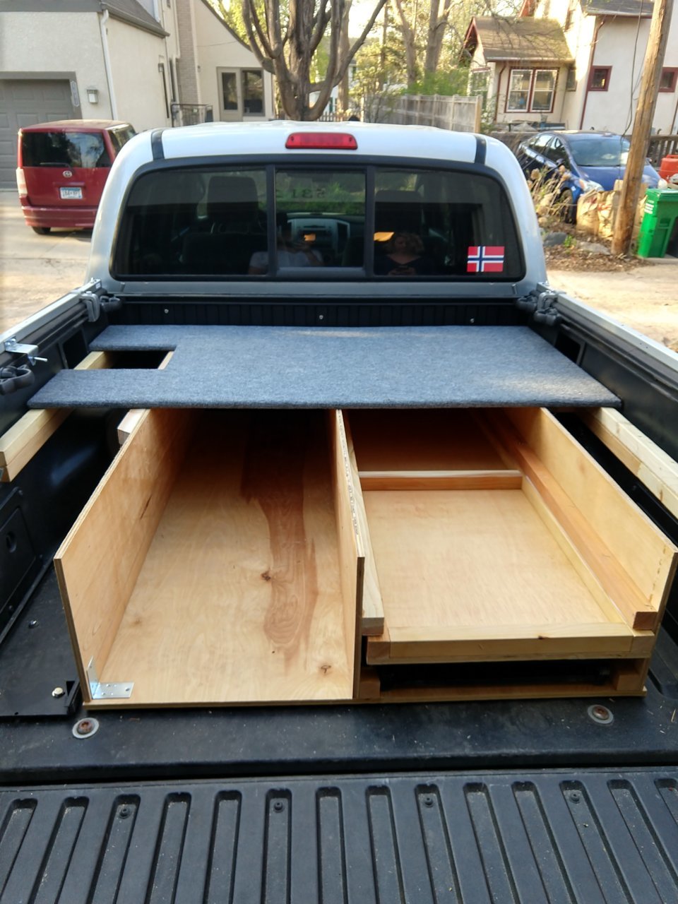

    They’re only 2” wheels so not much. No space is lost on the sides to bearings or a square stock guide and the sides are much thinner so drawer volume is even greater. My drawer has 1/2” ply sides and a 3/8” bottom so it’s light as well. It holds my cordless tools, 10 batteries and a dual charger plus a supply of fasteners and spare blades/bits and ratchet straps. I can still easily access both rear cubbies as well. The tool storage is organized with some 1 x 4’s on edge and the wheels and floor attach to those which keeps the floor from sagging under the weight. Basically it’s built around a lightweight frame of the dividers that hold the wheels and a skin for the drawer body. It could be done without the divider frame with either a thicker bottom or a 5th wheel in the center but I wanted dividers and designed around them. It’s not the best solution for everyone but it suits my needs for work.

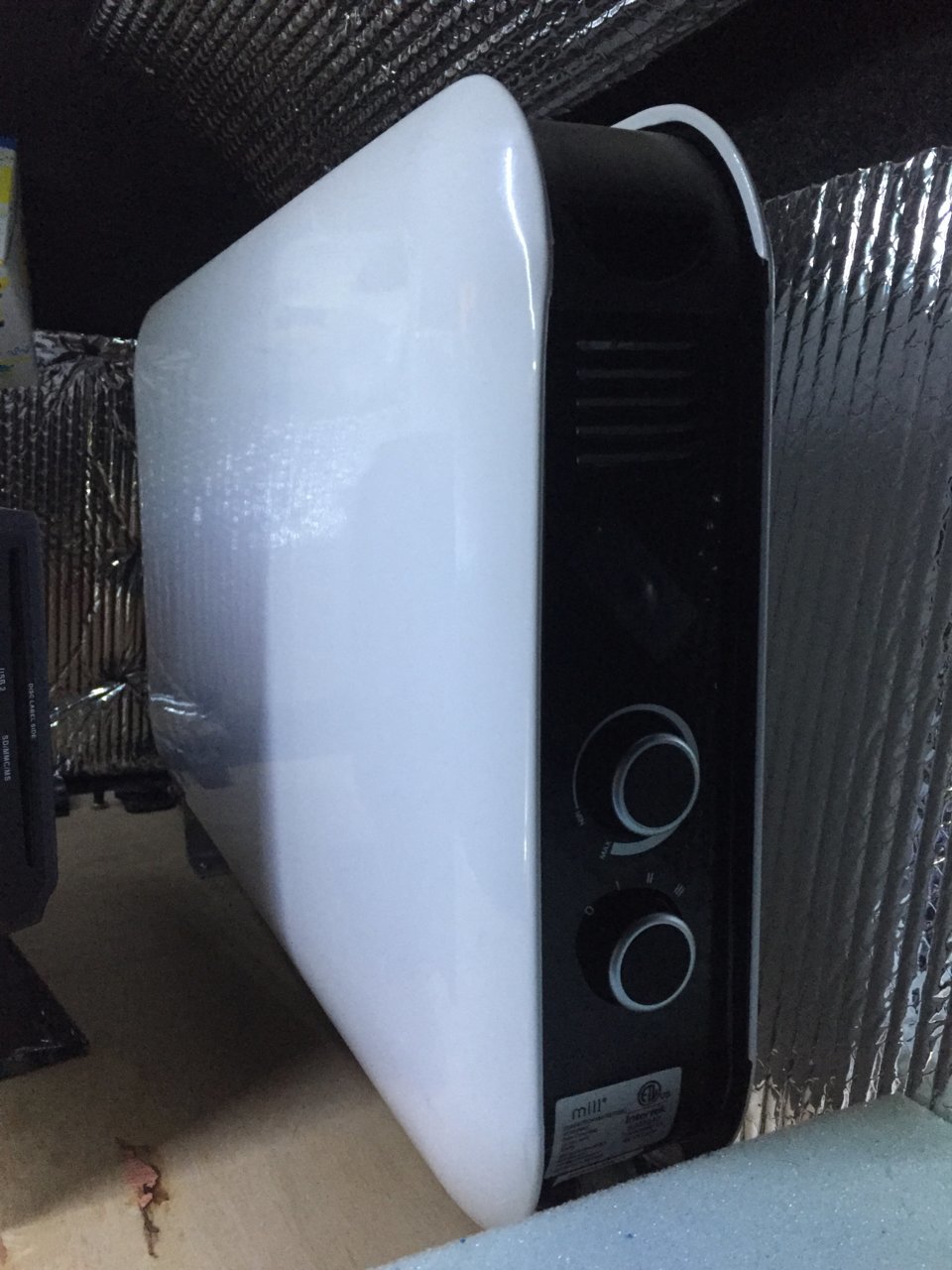

    That heater sounds about perfect.

    That is a cool heater. I don't see it in stock at slamazon right now though.

    So I wonder if we could use it with a jackery. Don't want to have to use a loud generator

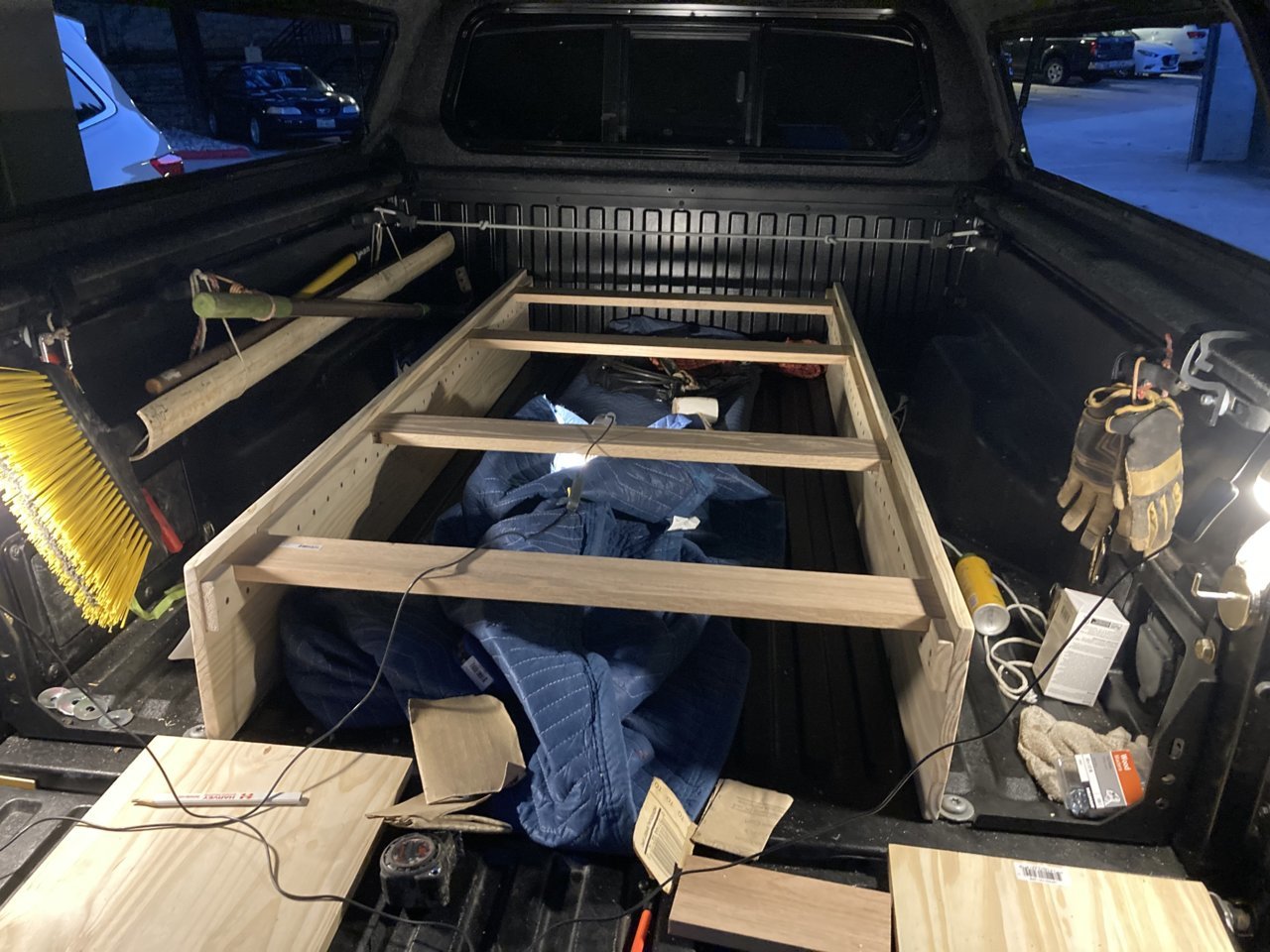

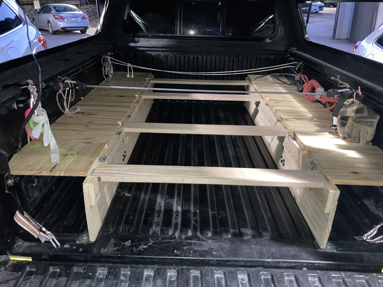

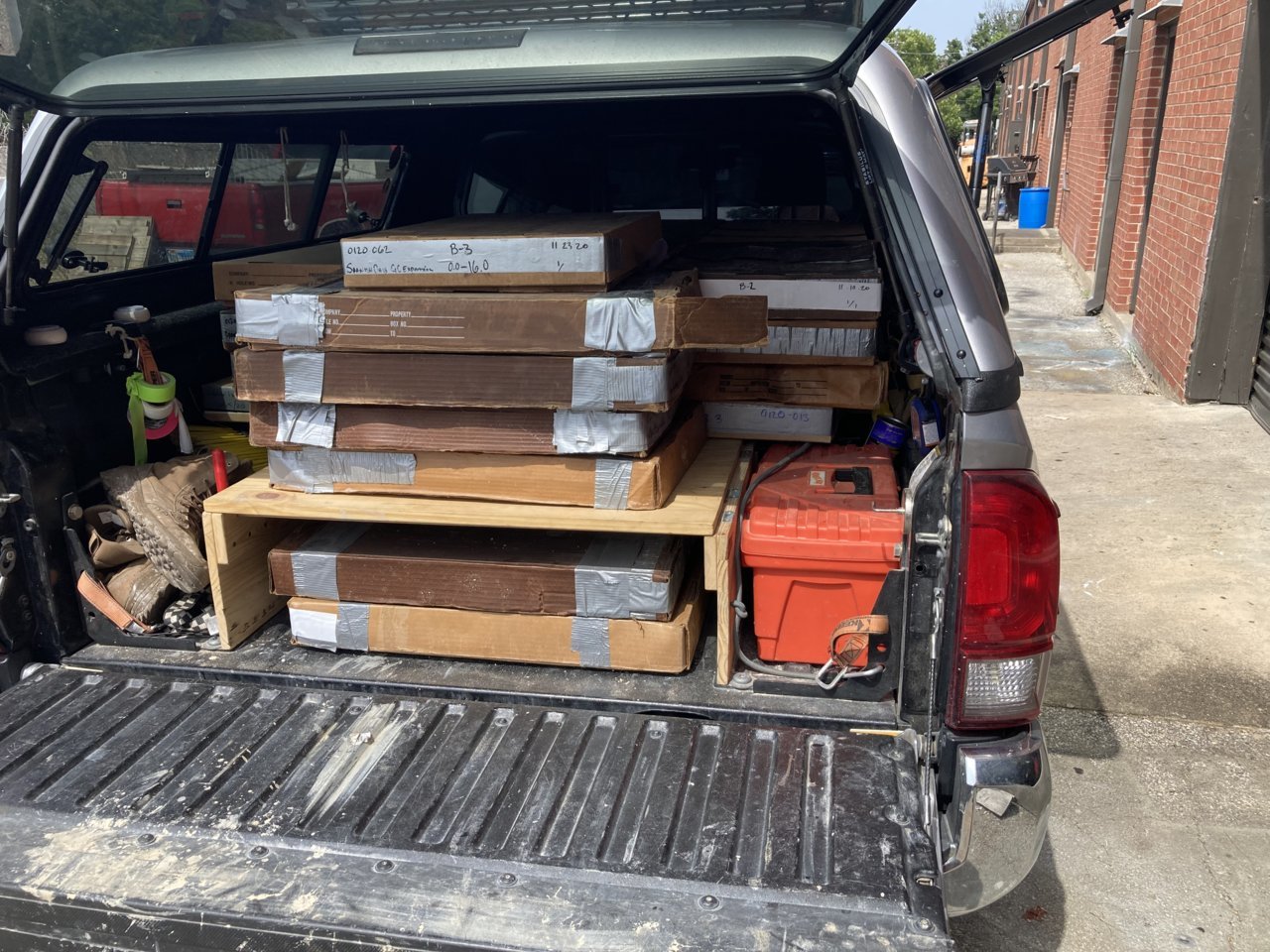

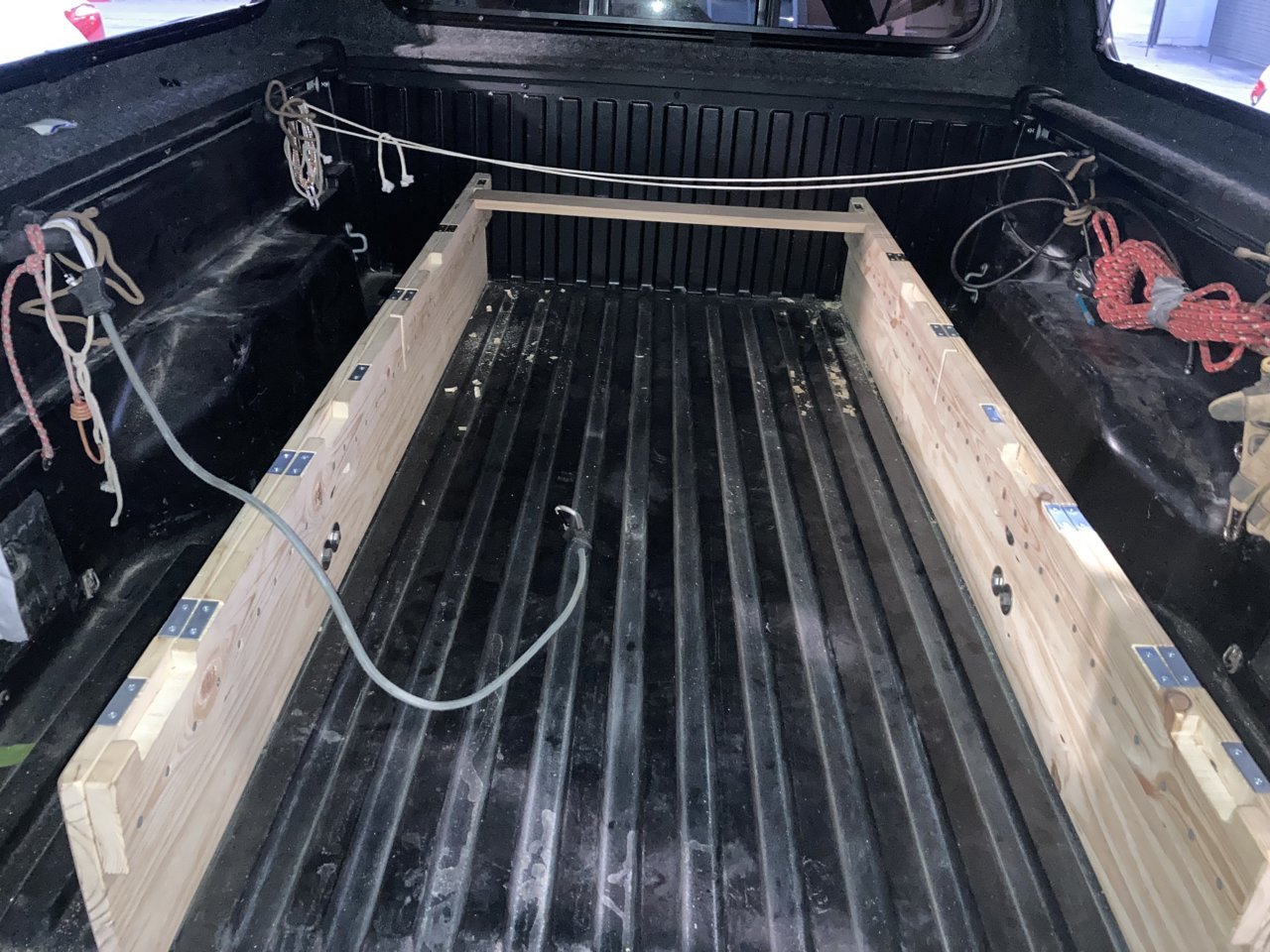

    E50ABEB4-A94F-4D27-A799-9350A5B74D6C.jpg E2A62F81-35B9-4425-9630-2CACD3AF91E4.jpg 0F7CD75E-4526-4C54-A743-3150DA7E097F.jpg E7A5CB84-1123-4C28-BD83-968CDAF40B8B.jpgI’ve been meaning to post these pictures for a few months now. This was a fun build. Mounted the rails using custom fabricated aluminum L bracket. I sanded the ends of the wooden rail to pinch into the vertical grooves at the head of the bed. Center row has 3 inserts, outer rows also have 3 inserts. Each pop out independently and have magnets to stay in place. Most of the wood is 1 inch pine, while the 4 horizontal support members are oak. I’ve put close to 1000 lbs of rock cores on top of this set up and it holds like a champ.
    Sna, Area51Runner and POOLGUY like this.

    This set up is primarily used for work but I have slept on it a few times using 2 exped mats.D1D58747-12E6-4583-BDC5-74E5D1478089.jpg70E5B2B8-F650-45DA-B7C7-C5F2D19E3BF9.jpg57241E40-1AFC-458D-BB86-AC882F863000.jpg
    Sna, chrslefty, devale and 3 others like this.

    You're gonna need the biggest jackery they make if you wanna use a heater that size for more than like 1/2 a night.
    Heaters take a serious amount of juice
