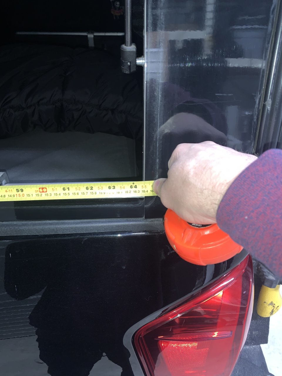

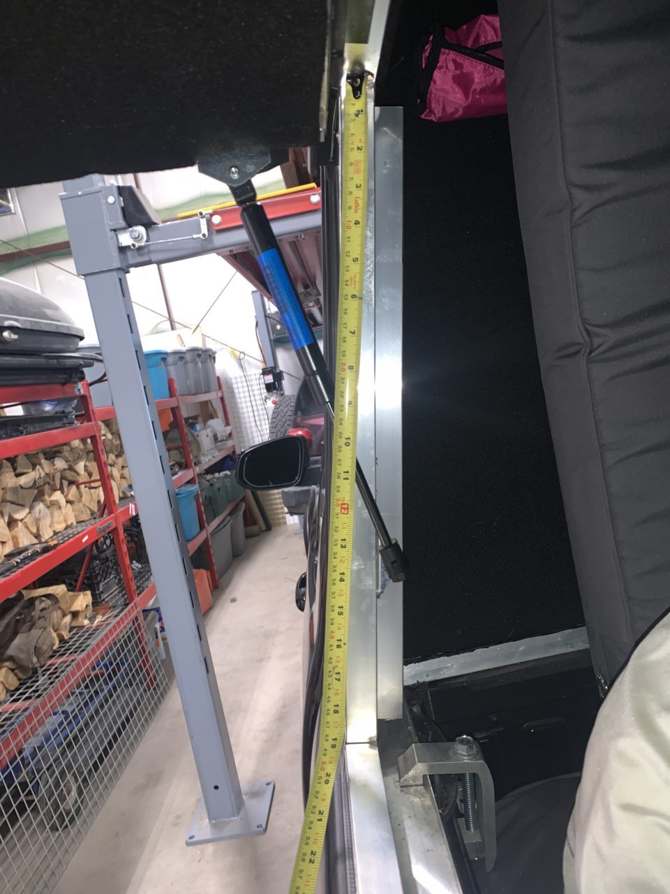

    still not quite sure I follow. Hopefully these help. But you can move the location of the bottom strut. I’ve moved mine about an 1” lower so the door doesn’t open as high and interfere with my awning.
    If these aren’t what you’re looking for let me know and I’ll try and do better next time.

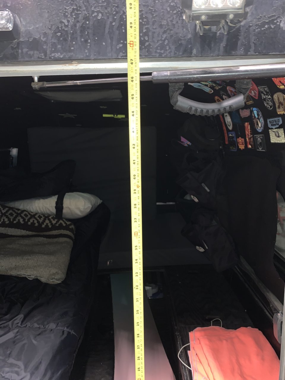

    Thank you so much, I can see how I confused you now. I was talking about the back door that you enter through! The big ambulance style doors.
    I'm debating between keeping my tailgate (doing a gull wing style door) and the ambulance doors like you have. I can't find the measurements for the ambulance doors and the dealer recommended I do the smallest wedge but I think your wedge (which I believe is the middle size) would be safer. Thanks again for all your help!

    Here you go my friend.
    CCA649DB-811B-4068-98F3-B2E25698DDE0.jpg 4148603A-FAE7-49A1-B638-740FB44DFFD6.jpg

    YOU'RE A HERO!!! THANK YOU!!!!

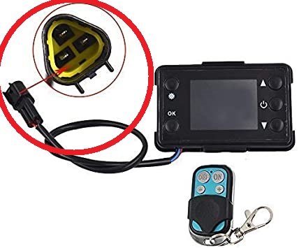

    Looking for leads on a specific quick disconnect:
    I've got a 5kw Vevor (knock off all-in-one Chinese diesel heater) and I want to relocate the LCD/control panel from the unit to inside the bed. The LCD is a "universal" one that has a triangular 3-wire quick disconnect. Before I pull one apart and solder in an extension, does anyone know where I could either a premade extension w/ the quick disconnects or just the connectors themselves so I can make my own?
    I thought had some left over Deutsch connectors but cannot seem to find them for the life of me.

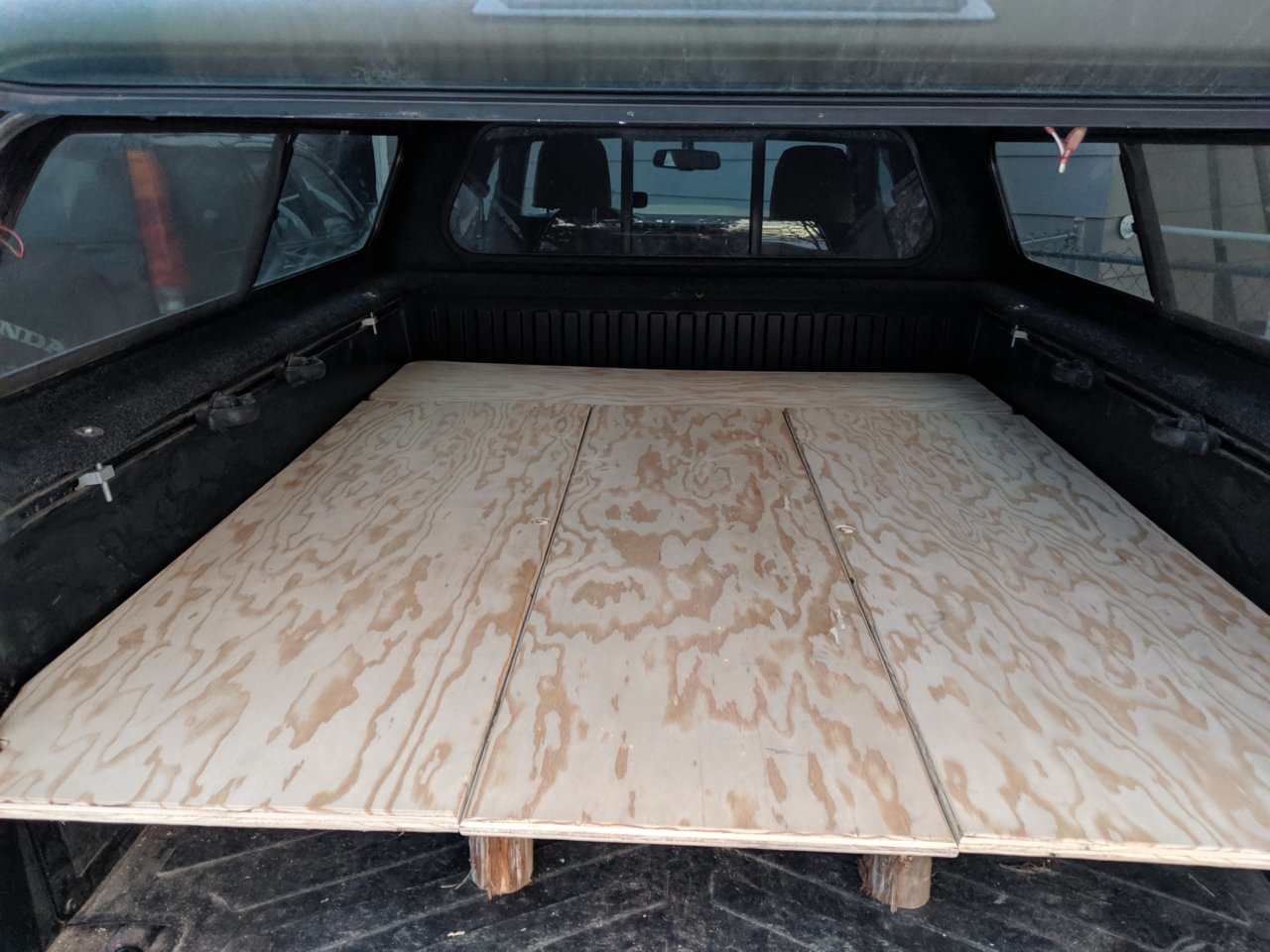

    WA
    '18 4x4 TRD-OR DCLB
    KINGS, Bruteforce armor, Falcon wheels
    Hey guys, does anyone happen to know the dimensions from wheel well.....to wheel well in the turd gen? sorry, at work and don't have access to my truck to check and trying to draw out some plans. attempting to build my own setup. This is for the base part of the build. Also would you guys recommend cutting out pieces to save weight or is that really necessary ? 2nd gen forums were the only ones that popped up, sorry i had to infiltrate these :)
  17. Jan 22, 2022 at 3:44 AM
    #2877
    gsubioguy
    gsubioguy Well-Known Member
    May 22, 2018
    #254259
    1,395
    Evan
    Maine
    '21 TRD OR
    @TX_Taco88 ~43" at the base/most narrow. They are a lightly wider at the top
    TX_Taco88 likes this.

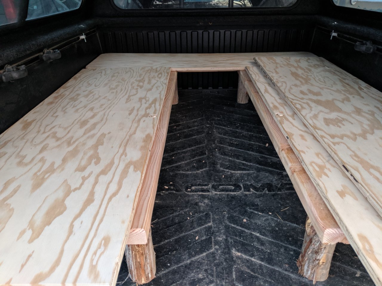

  19. Jan 23, 2022 at 5:21 PM
    #2879
    SW(ta)CO
    SW(ta)CO Active Member
    Dec 12, 2016
    #204664
    27
    17 AC TRD Sport 4x4 MT
    Thought I'd share the beginning of my (3rd gen) platform. Getting a taller shell so there should be room to sit upright when the middle section is removed. Not pictured is a 2x8 supporting the front piece with a lap joint connecting to the 2x4's. Also considering cutouts in the front piece so that bicycles can slot in with the front wheel removed. Then there's the next step of making cushions...
