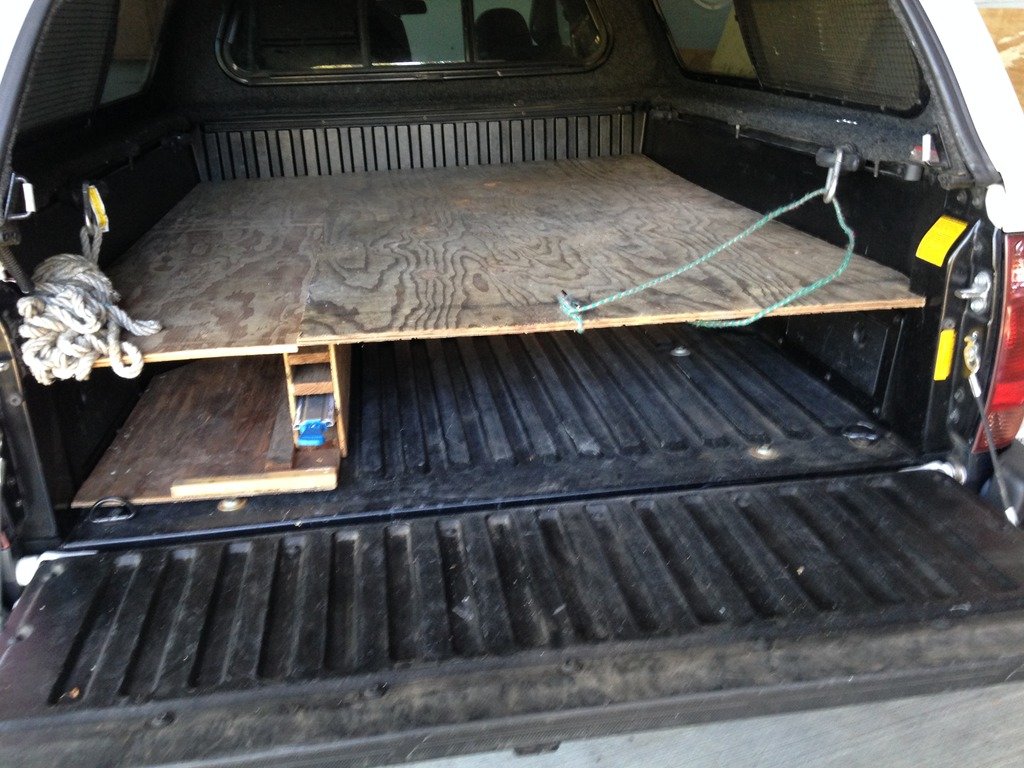

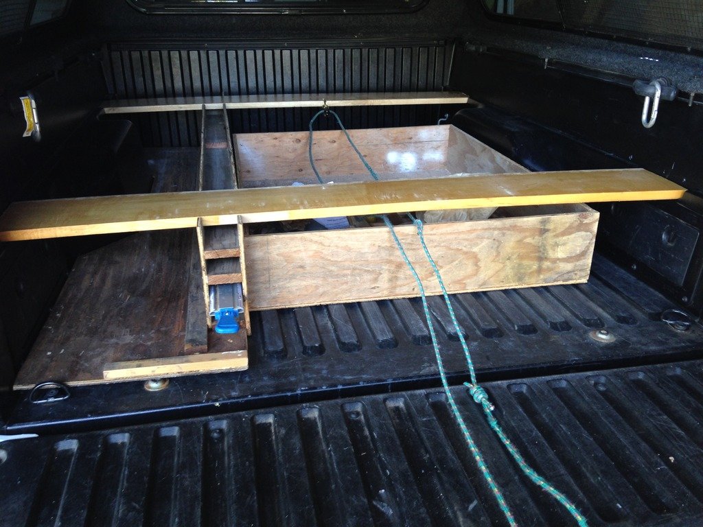

    All made from scrap ply since I didn't give a shit about looks.
    It starts with an offset support that houses my 3',4',6' levels and 4' clamp 'n guide and also serves to bin my Dewalt saw stand. It's notched for some scrap 1x8 maple I had demo'd from a job several years ago for cross supports.
    00E41B41-7180-4208-A9EB-804F48B7D324_zps_884a762ab0ac0c26becbc1f637a402dbcf6c43e9.jpg
    The front piece of maple has a pulley held with some brass wire that allows me to haul my tool bin up against the cab(heavy shit forward) leaving space at the back for 3 lightweight folding saw horses. 3 because 2 hold the cheap ass table saw and the 3rd supports out feed using the left hand cover ply. The larger right hand ply has a small boat cleat used to tie off the tool bin.
    4154A967-D57F-4A3A-90E1-80E4B0AB5E18_zps_3789db53b5b6f7a72e9ad5e3837c73b0fa3d854d.jpg
    It works fairly well but I've acquired some small transfer bearings that will hopefully allow the bin to glide more easily instead of drag. I'll post a pic of the install if they work as planned. Need to charge the phone now but will edit in the pics in a bit. Short ladders, slide saw, table saw, compressor, etc. go on top. The small cleat at the back edge of the bottom ply is there so I can capture it wth the saw stand extension which keeps it from moving around. The stand risers get taken off and stored in the right hand cubby. The left hand cubby has the fill valves for my ride rites inside. When the oba goes in they'll be connected to a regulated line coming from the cab. I've located some 1" pressure guages that might could fit where the 12V sockets are now but I haven't decided where I'd relocate those to yet. Tank, gauges and regulator first, then compressor and output air socket.

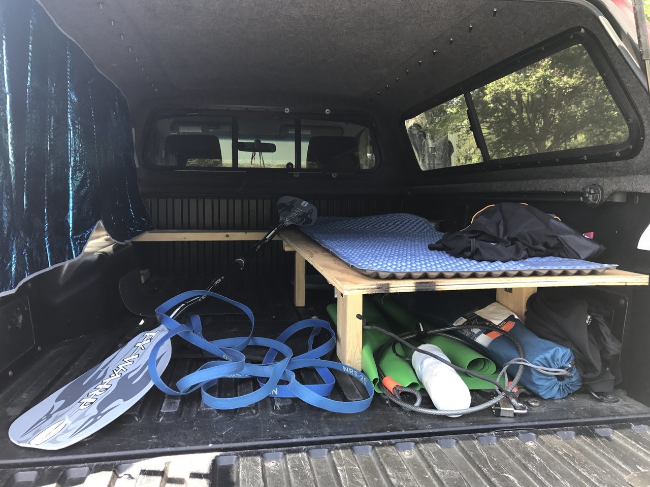

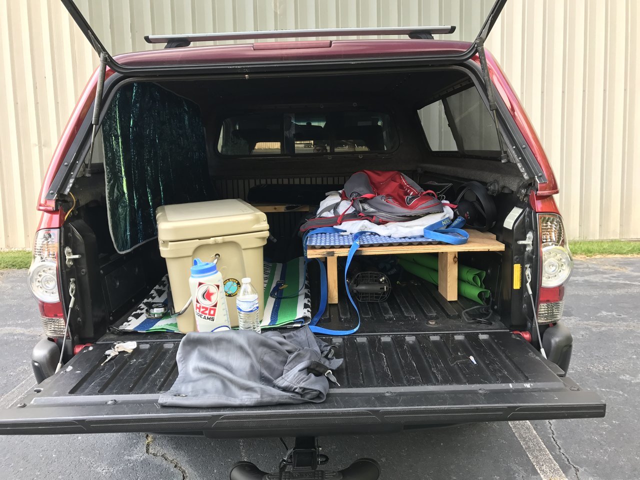

    Super lazy and cheap. Works great though, I sleep back there all the time on top off a thick camping mattress. One of these days Im going to build some drawers.

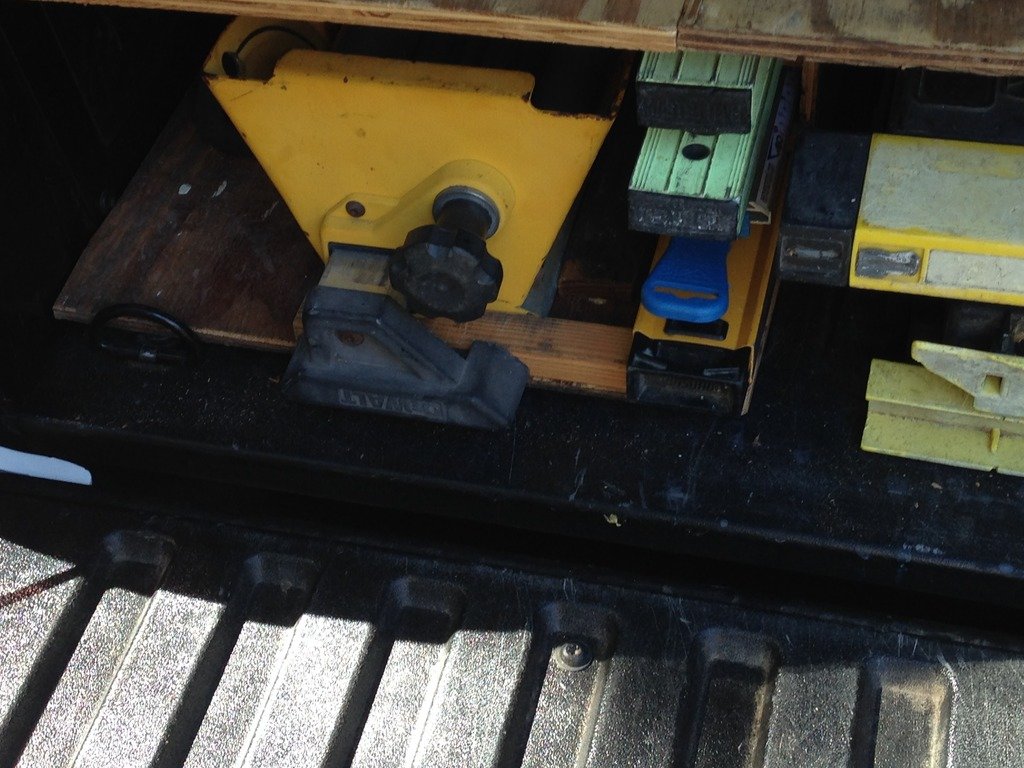

    171D077C-01A0-4089-9BC2-4DCB246E16A5_zps_f15d5d7b20c8627ef827639c0dea1a221ef8b07f.jpg Here it is with the saw stand and levels in place. There are stops for each level and you can see how the stand extension clamps the cleat to prevent it from sliding about.
