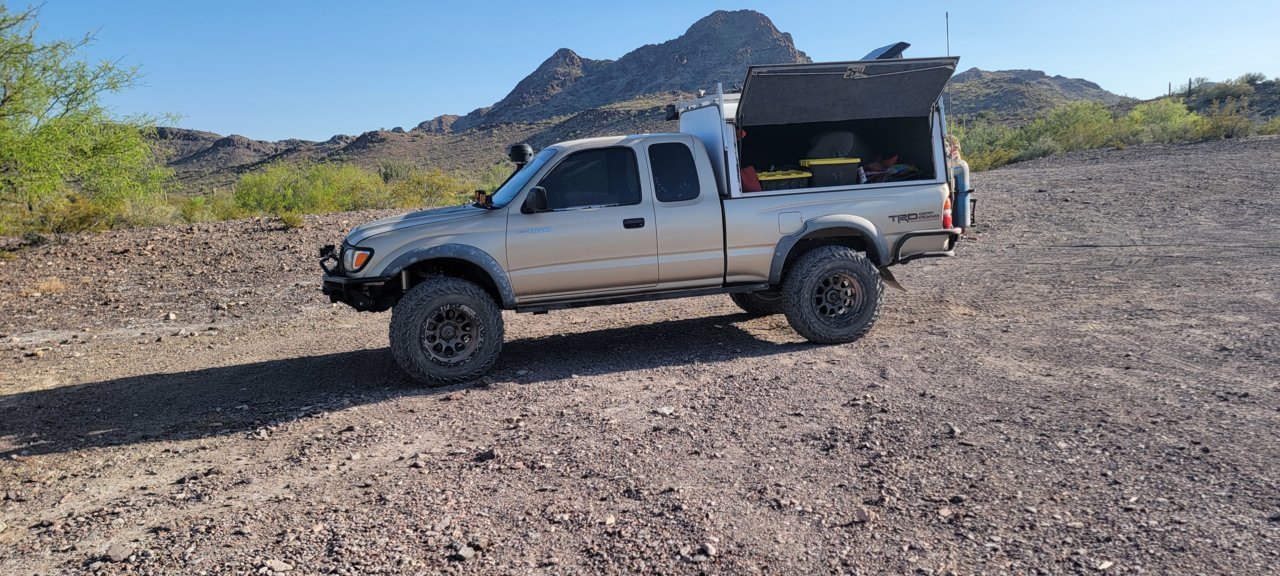

    The side access is really the best.

    How tall is that cap?

    Tall enough to look kinda silly. I think it's 36" but I'd have to go remeasure, if you really want to know I can in the morning.
