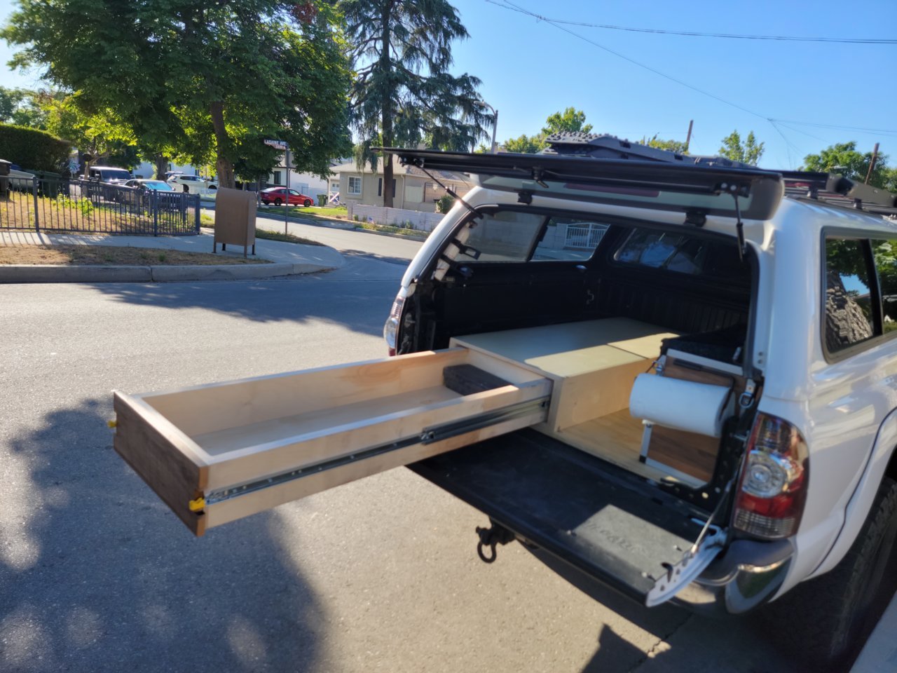

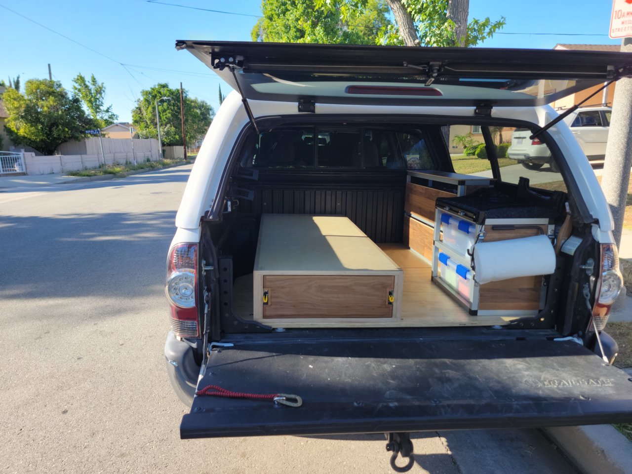

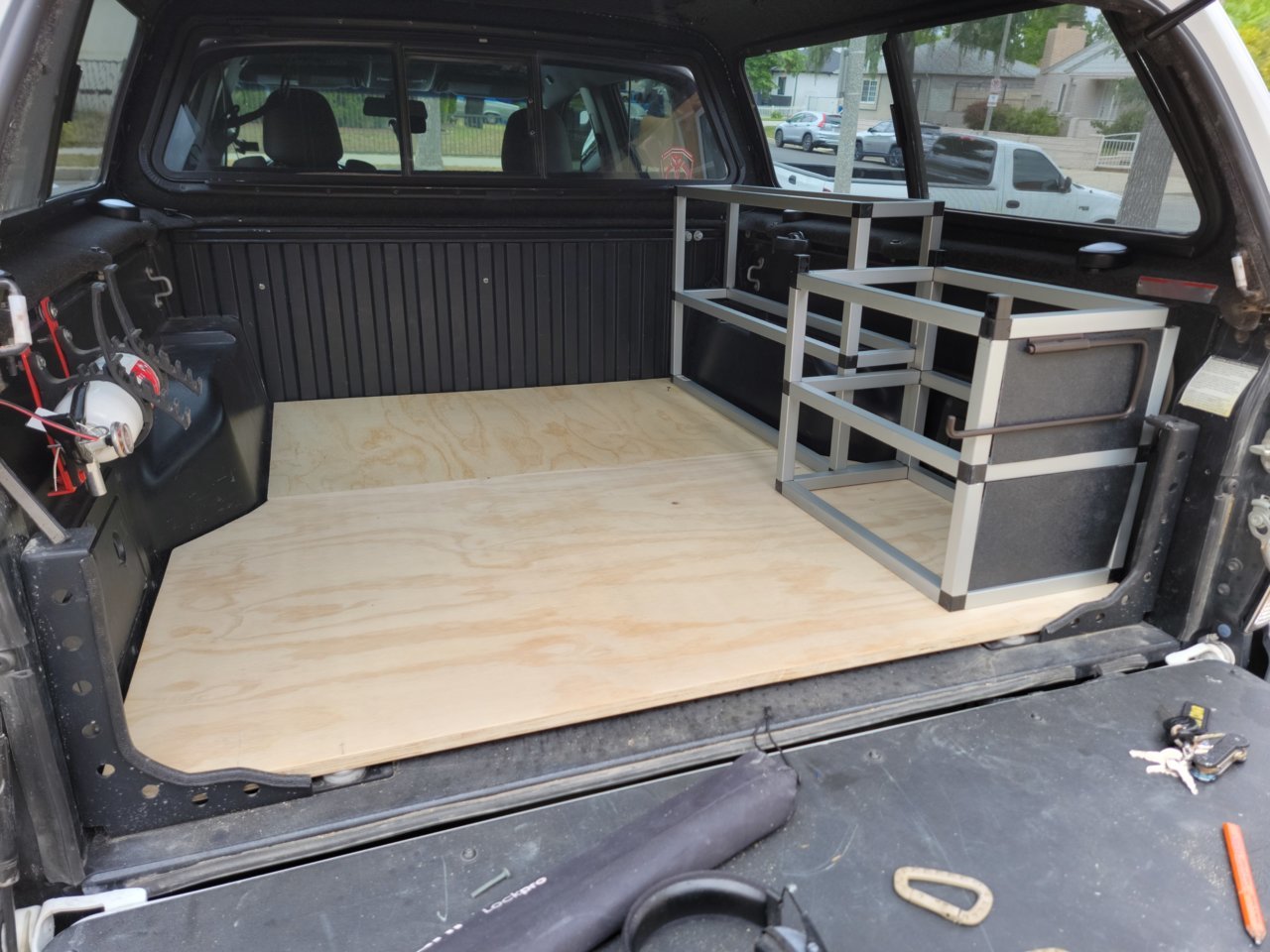

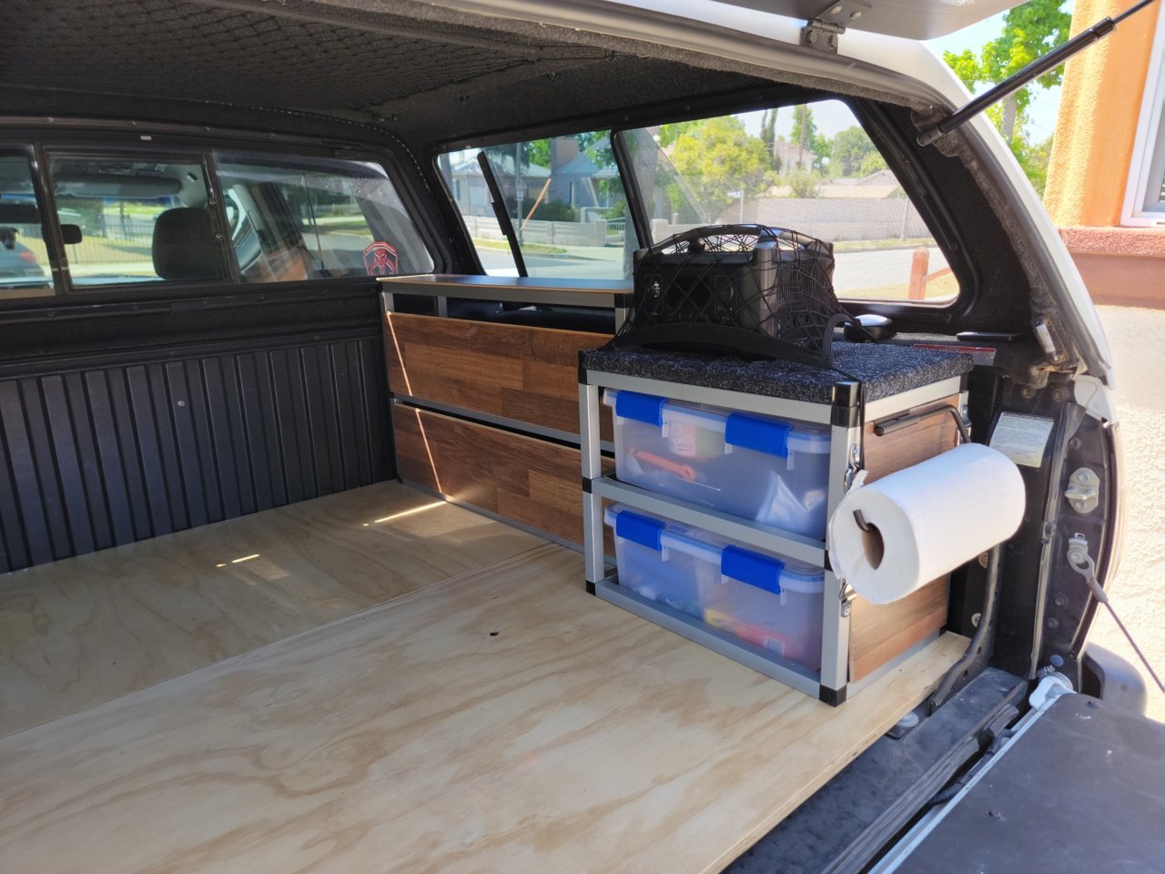

    About as far as I'll get for a couple weeks, but slow progress is still progress. Remembered I had a couple of boxes of laminate flooring in my garage so I used that anywhere I could since it was free. The rear cabinet the doors hinge down with a shelf inside.20230604_144621.jpg

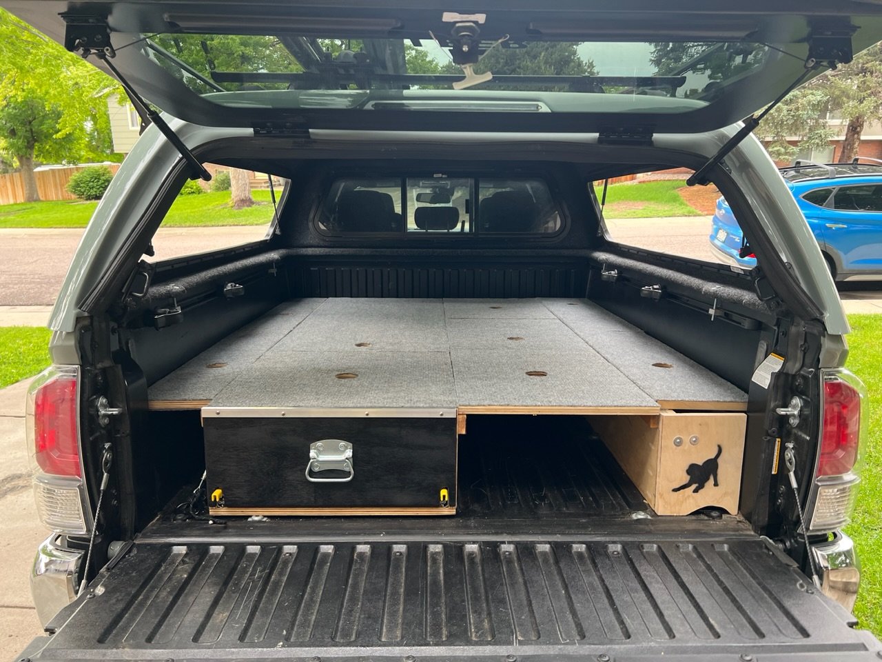

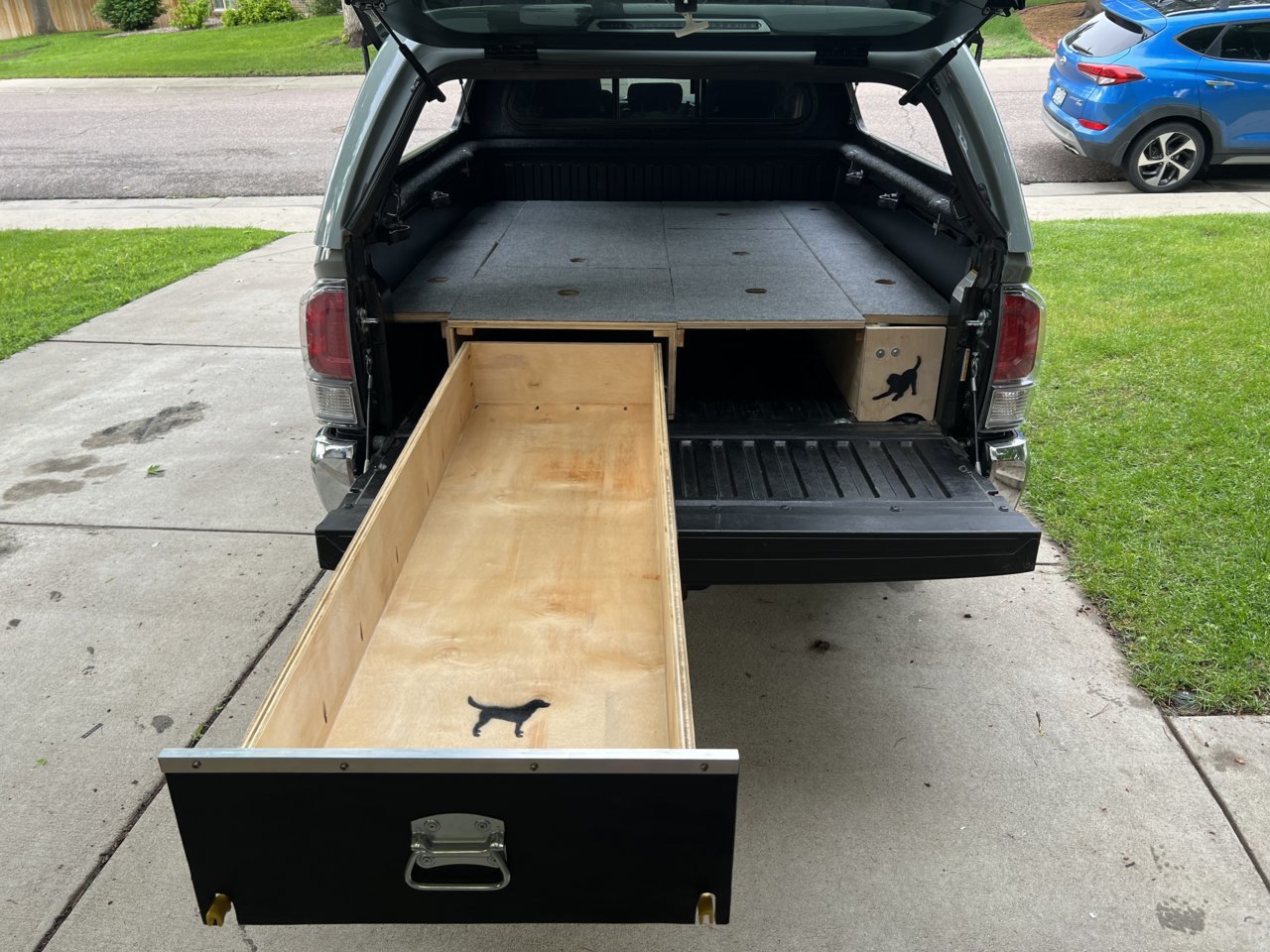

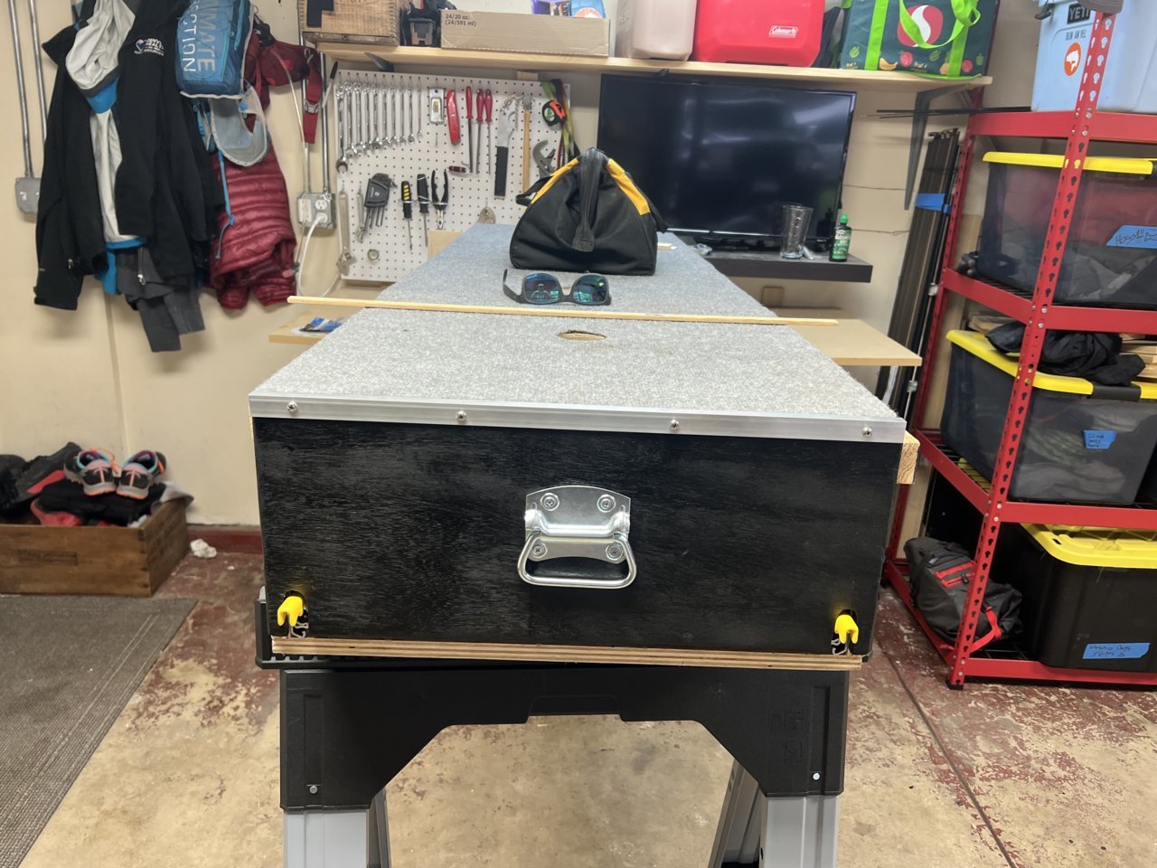

    Added a drawer to my sleeping/camping setup! Super happy with how it turned out!

    Are those 55 inch heavy duty drawer slides?

    yes 60inch heavy duty Vadania slides!

    Tell me about the storage units on the RH side please. I live for weeks in my truck and really need to get the bed better organized as storage for multiple pairs of hiking boots, sneakers, Chacos.... is killing me. I thought about making a plywood shelf system for one side of the bed, and I still may do that, but my woodworking equipment is minimal. Basically, I need a two shelf system on one side, primarily for shoe storage.

    I built them out of this stuff from 80/20.
    80/20 Inc, 9270, Quick Frame 4... https://www.amazon.com/dp/B00J4PNH5C?ref=ppx_pop_mob_ap_share
    i bought a couple 80/20 12' aluminum sticks from grainger to avoid shipping but ordered the fittings through Amazon.
    Super easy to build with minimal tools needed. Really just a hacksaw, a Mallet, and a tape measure at minimum. You can make them as elaborate or basic as you want.

    i believe if ordered through 80/20, they will cut all the pieces as well as give a list of needed hardware if supplied with dimensions and a picture. might be worth going that route if time, tools, and experience are in short supply.

    One step closer.... Hopefully finish this weekend. With the added weight I may need to throw on my Add a leaf to the dakars I have on.

    First, I went with high quality Baltic Birch for the platform and drawer since it has less voids for expansion and degradation, and is naturally water repellent. I coated the wood with urethane for water protection, and may hit it with a coat of flexseal. The camper shell is already mostly water tight but you never can be too safe. The frames of the cabinets are aluminum and the doors are made from vinyl floor planks so they are also waterproof.

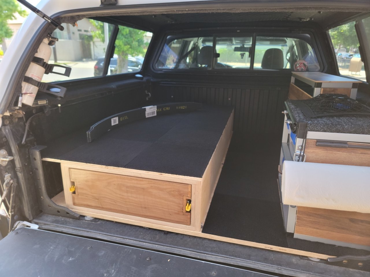

    And......she's done......ish.
    Also made an insert that sits on the open drawer that, with my tailgate down, makes the sleeping platform in my 5' bed 7'.
