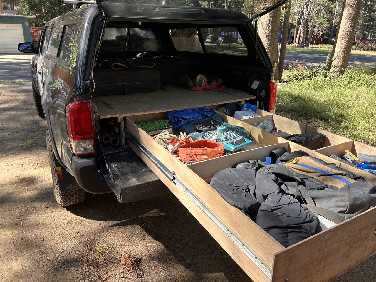

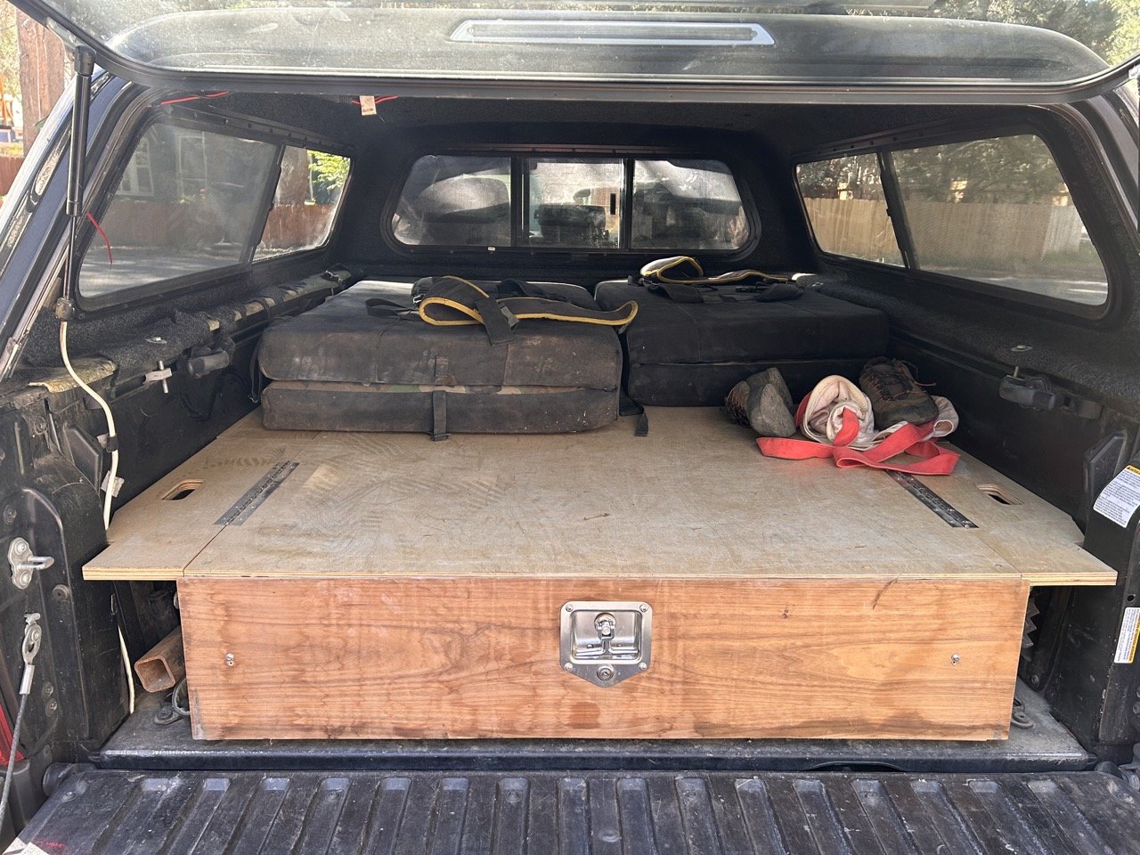

    Finally graduating from TW lurker to sharer ... Figured I'd add my modest bed build to the mix. I've had it installed in the truck for 2 years now and I absolutely love it. Only thing I wish I did differently would be the locking slides that lock the drawer out so when I'm parked sloping downwards I don't have to hold it. Fortunately I just use it to store gear so it's usually just a quick pull out, grab stuff, and push back in. An unexpected benefit due to the way I designed it has been that all my gear in the drawer stays completely dry even though my shell leaks like a bitch and I can't get it to stop.
    At the time I built this my brother in law had access to a huge woodshop with full-size CNCs and he's a wizard with computer design software, so we drew this up on the laptop and had the machine cut most of the pieces....Really nice way to do things coming from a more traditional carpentry background myself. The drawer is 5 feet long and my bed is 6 ft. There is storage on the sides accessible through cubby tops, and a big storage area in the front of where the drawer stops.

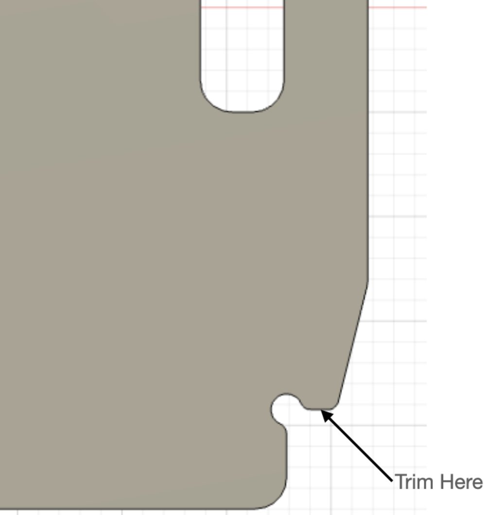

    BamBed is usually compatible with BedRug and I've had numerous customers use it with no modification needed.
    However, sometimes the thickness of the bedrug or the way it was installed can prevent the boards from having enough room in the fore-aft direction which requires a slight amount of trimming on the aft nubs which interface with the tailgate bulkhead. It's easy to do with a basic manual handsaw or jigsaw.
