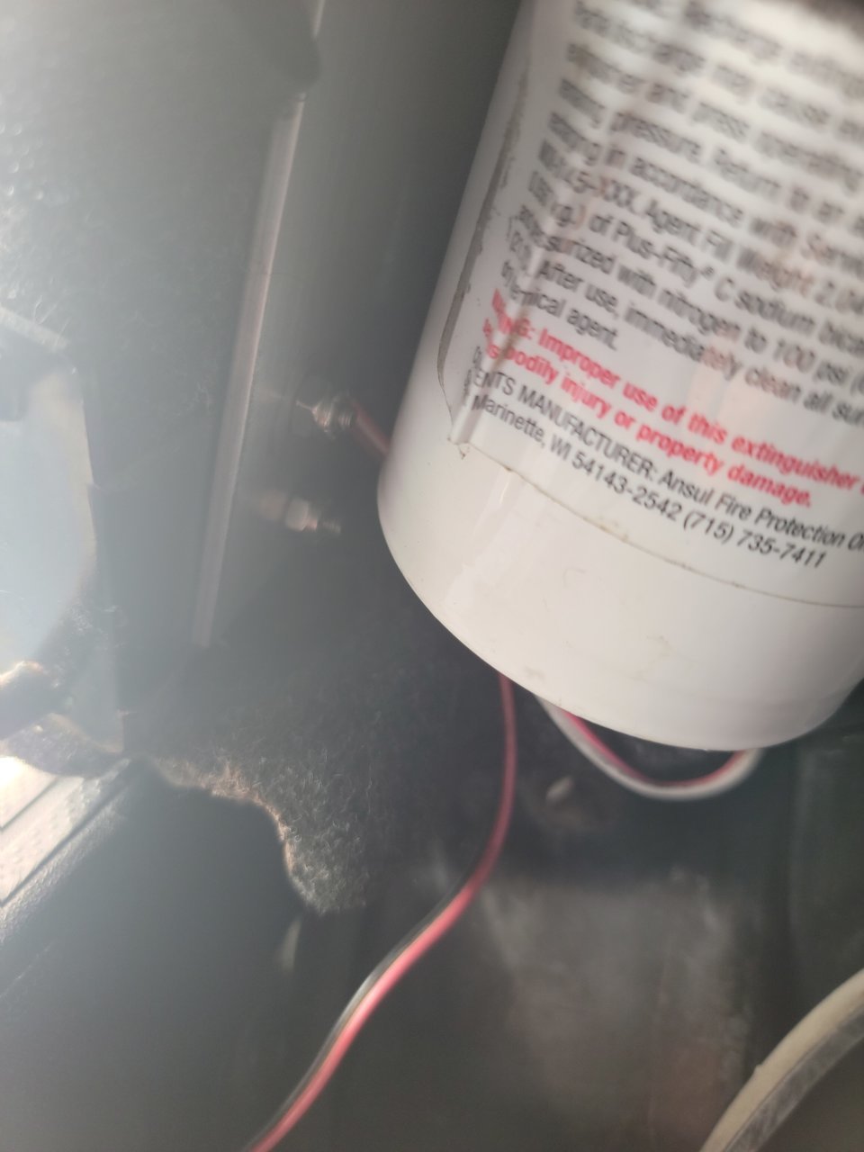

    I’ve been trying to come up with a mounting solution for my bed fire extinguisher on the shell rail or in the corner like that. What do you have the quick fists attached to or did you through bolt them to the sell itself?

    I made aluminum brackets that the quick fists mount to. They bolt onto the existing bolts from the latches in the shell at the bottom, and i bent the top pf the bracket back as an extra support against the inside of the shell.

    Thanks for the reply. I just went ad looked at my shell and I’m not following what you said, mine doesn’t have any bolts in that area. Can you take a picture when you get a chance?

    I think it is pretty hard to see in my photo, but the little u shaped latch catch is bolted onto the cap. I just used those bolts to mount the bracket I made.

    Ok, I see what you did. I didn’t see any bolts on my topper (ARE MX) in that area. I’ll look again tomorrow to be sure. Thanks.

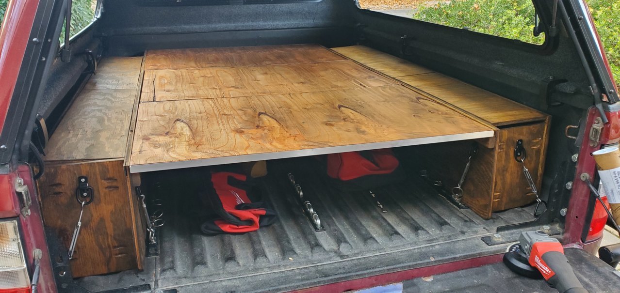

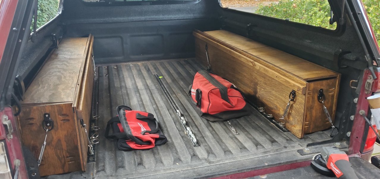

    I didn't remake mine, but originally used the regular "cheap" grade 3/4 and 1/2" plywood. It warps easily though depending on how you transport it. Cabinet grade wood would have been a lot easier to deal with, but heavier like you said.
    The middle removable sections I made are plenty strong to hold two people. I added some aluminum angle on the ends for reinforcement too

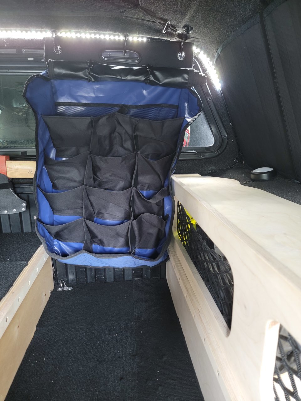

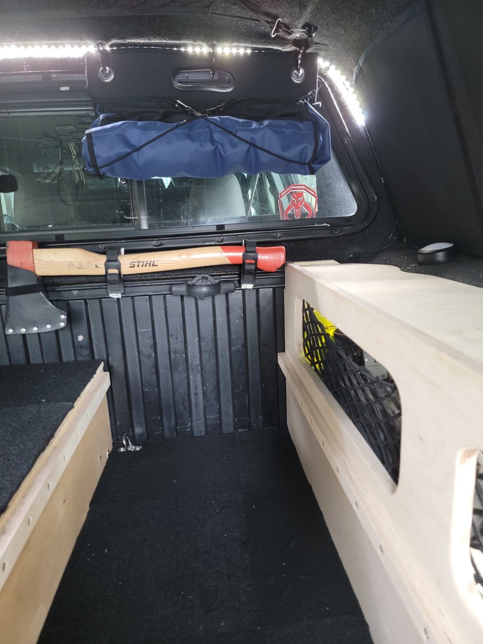

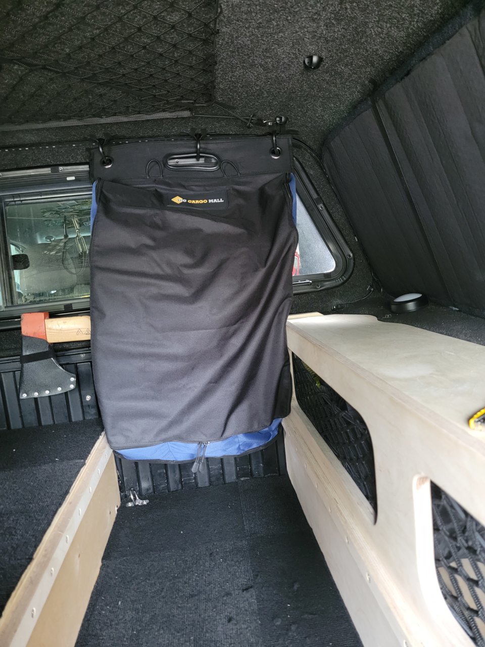

    2014 Tacoma TRD Off Road
    Rigged up a bit of extra storage for camping. I don't plan on driving with it up, but once I'm parked it'll provide some good storage. I think I'll get a couple big suction cups so I can attach this to the outside of my truck also while I'm camping.20230902_102647.jpg 20230902_102533.jpg 20230902_102415.jpg

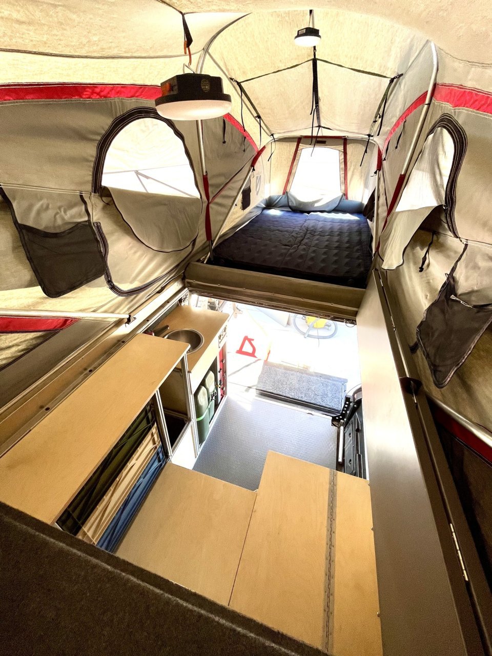

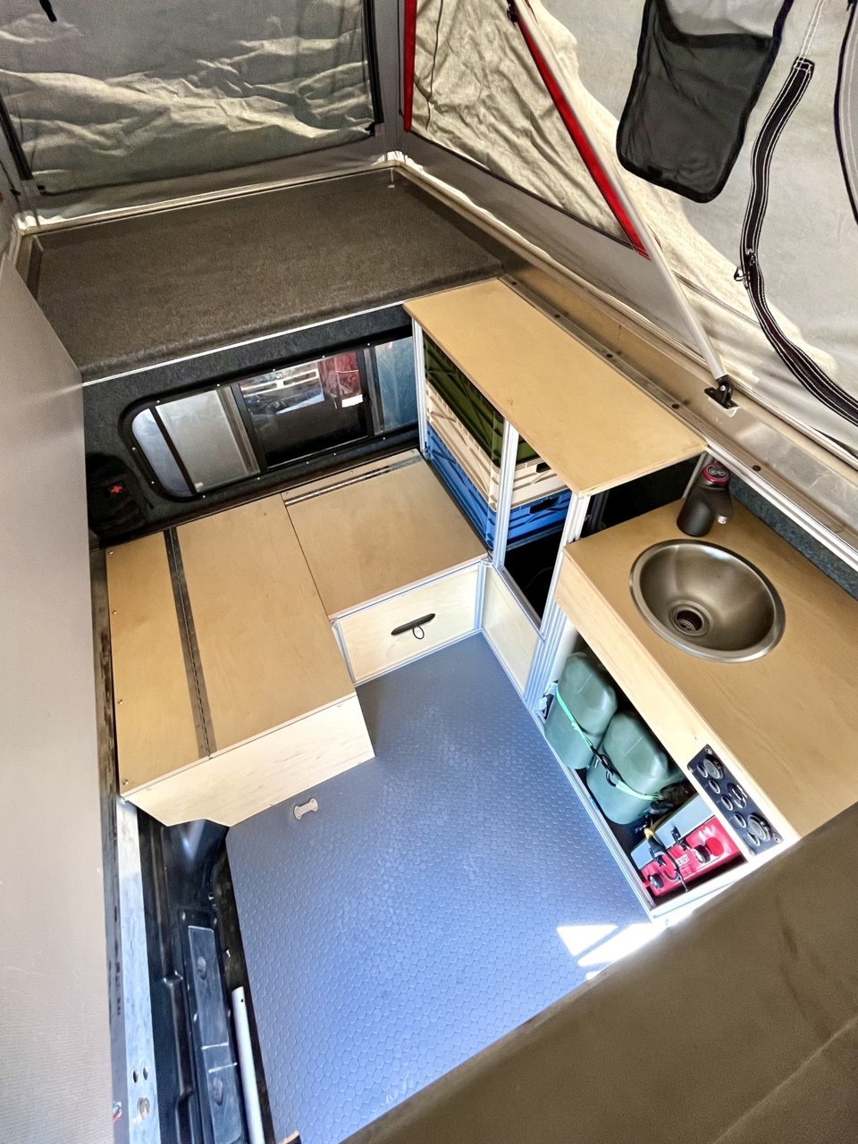

    Inside of my AT Overland Habitat. I can stealth camp in the city with the lid closed

    Slick as shit!
