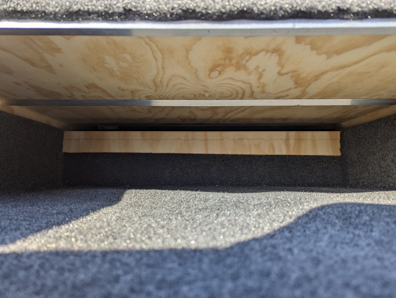

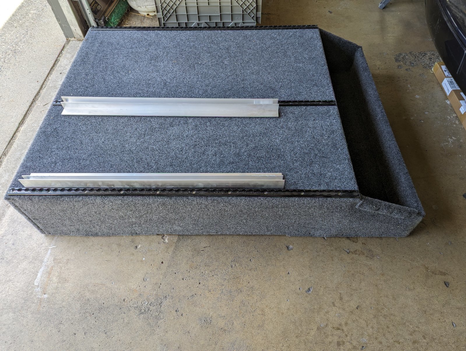

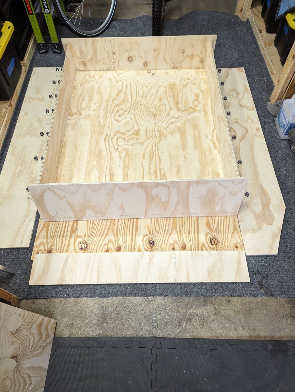

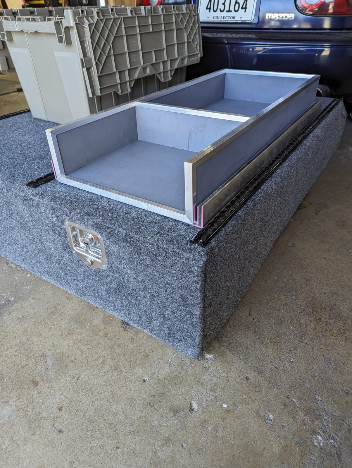

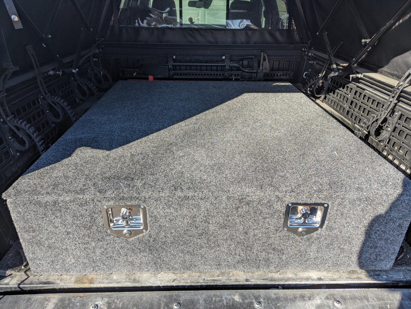

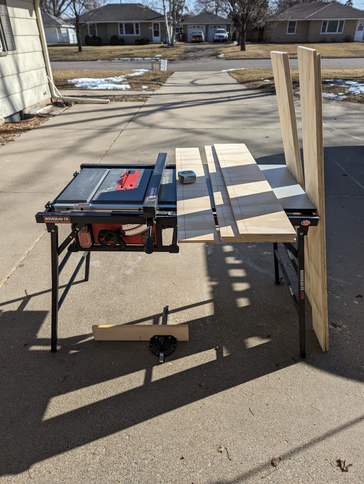

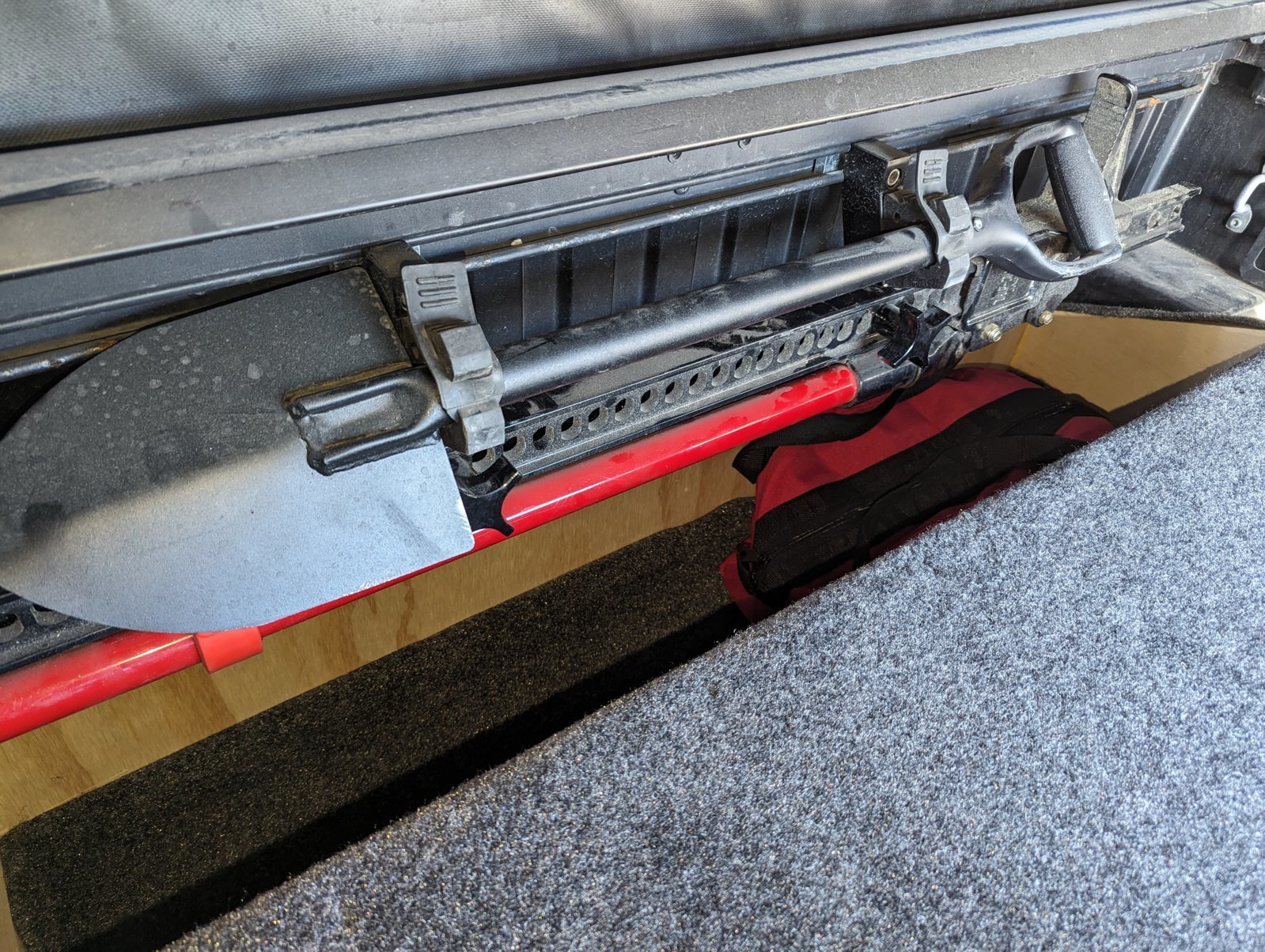

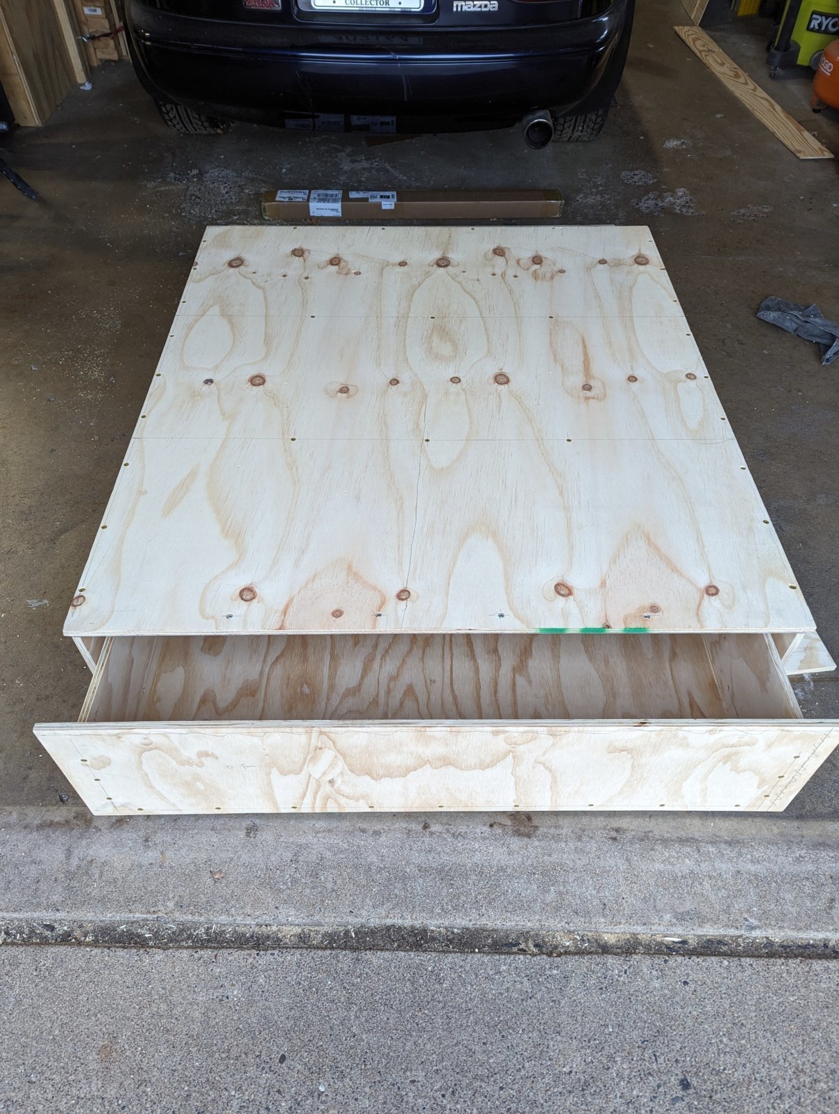

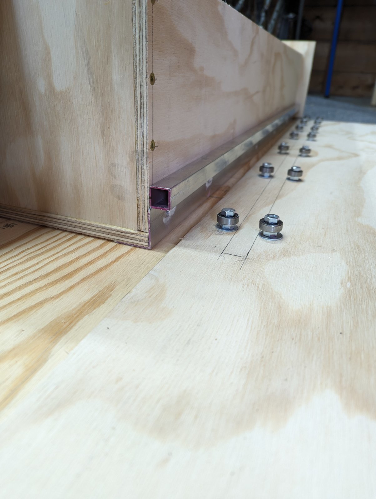

    Spent the weekend building a new bed platform.
    This is my second one, some alterations I made to it over my previous one are; reduced weight, single drawer, one inch taller, and cubby in the back for gear.
    I used some 1/8 aluminum to make some cross supports so it doesn't sag, it helps but it's not as sturdy as my old one, but still strong enough to support me if I have to crawl across it.
    It's right around 100lbs with the fridge slide, I think my old one was near 150lbs with no fridge slide.
    Also built a removable fridge/water cooler slide to go on top of it, just waiting for the slides to show up tomorrow. Then in the spring I will give it a proper paint job.
    I'll use T Nuts so I can quickly bolt/unbolt it.

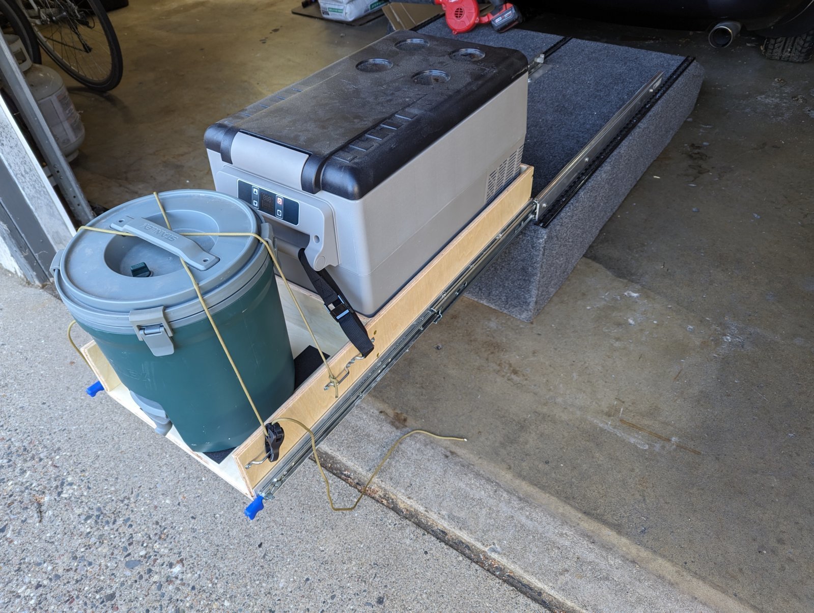

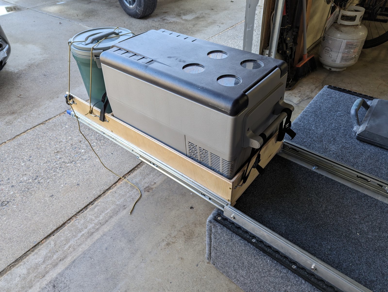

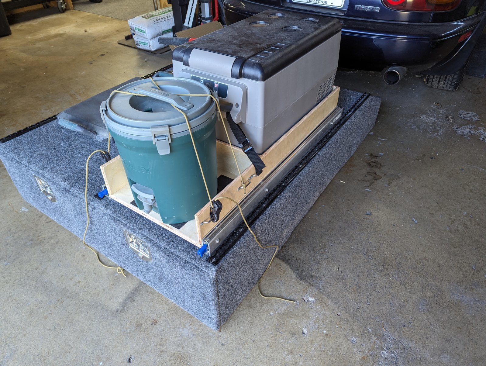

    Finished my fridge slide.
    Decided to buy some birch plywood instead of having it made out of scrap wood.
    Pretty happy with how it turned out, finally no more struggling to get stuff out of there. Plus it's nice to have my water cooler on a nice mount so I can use it easier.

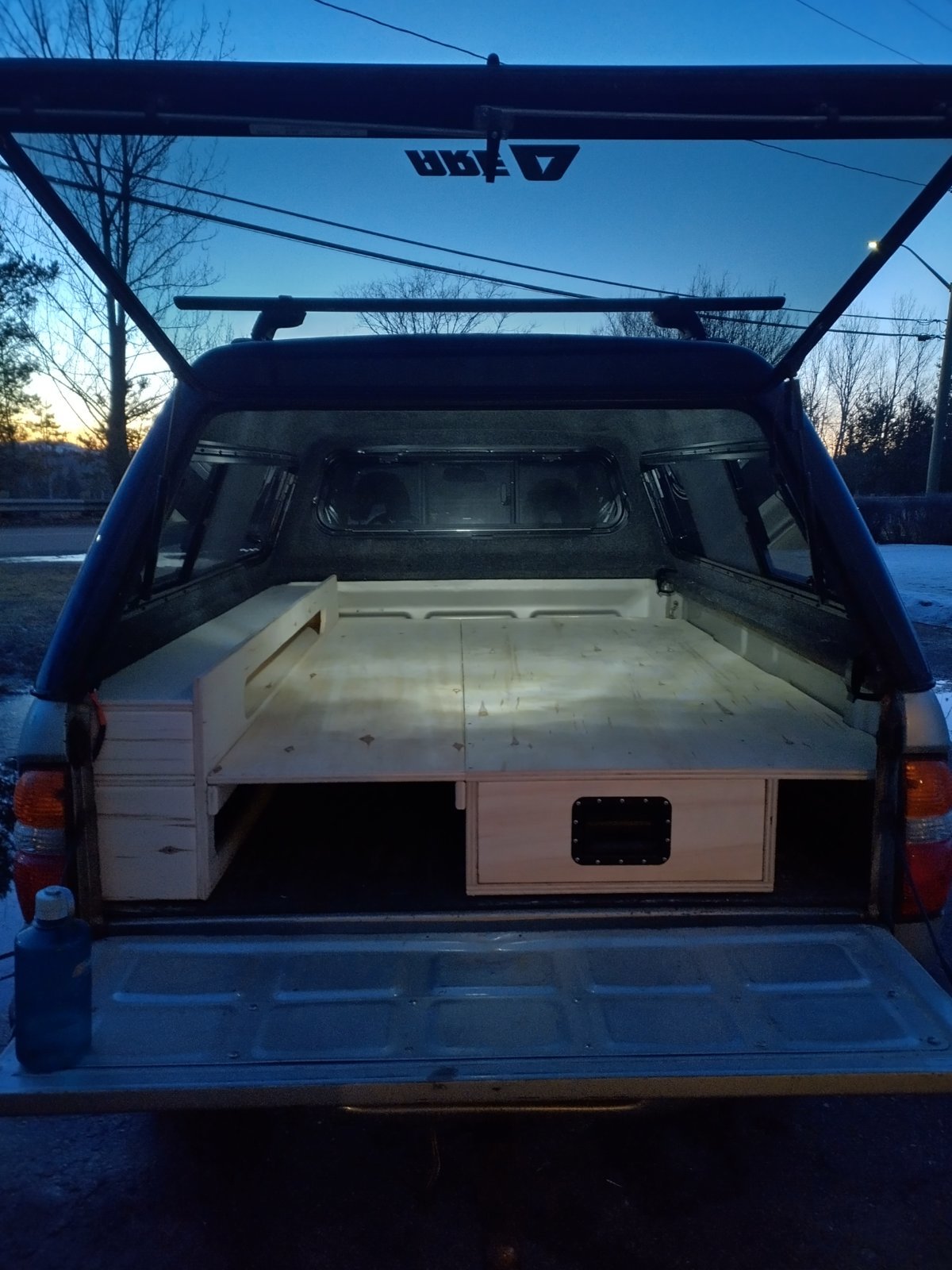

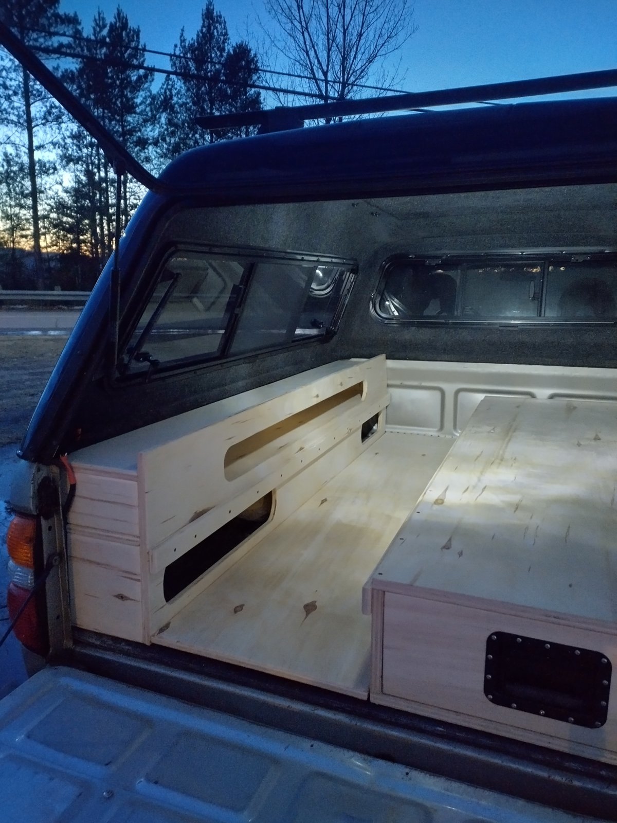

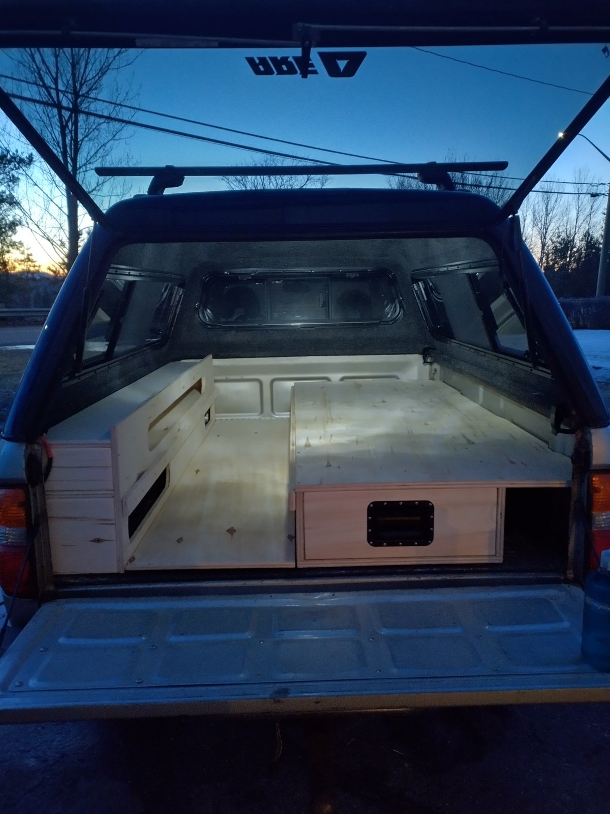

    Taking advantage of the early spring and borrowing some inspiration from this thread. Woodworking skill is slowly getting better and I'm happy with how it's going so far. Still need to put hatches in the main body and finish but it's 1000x better than what I had in years previous.

  5. Mar 14, 2024 at 7:08 PM
    #3305
    powder1134
    powder1134 Well-Known Member
    May 27, 2020
    #329500
    1,429
    2014 Tacoma TRD Off Road
    Looks great! Envious of that 6' bed.

    Thanks! It certainly comes in handy.

    for some reason of all of the ones I've seen this one screams of "sold as pieces you put together" you should think about a business where you ship all the panels to someone and they put it all together. its awesome IMO.

    Not to be harsh but it sounds like a non profit pain in the ass to me.

    Consider the option of a good color-matched vinyl wrap for that. I could say, "There's an app for that," but in the case of a wrap, look for a good app-licator company. Maximum Exposure Wraps at my location...

    Thanks! It's always nice to hear others are into it as well. A little self-vindication for the design choices. That said, not interested in trying to sell it but if you have any questions let me know.
