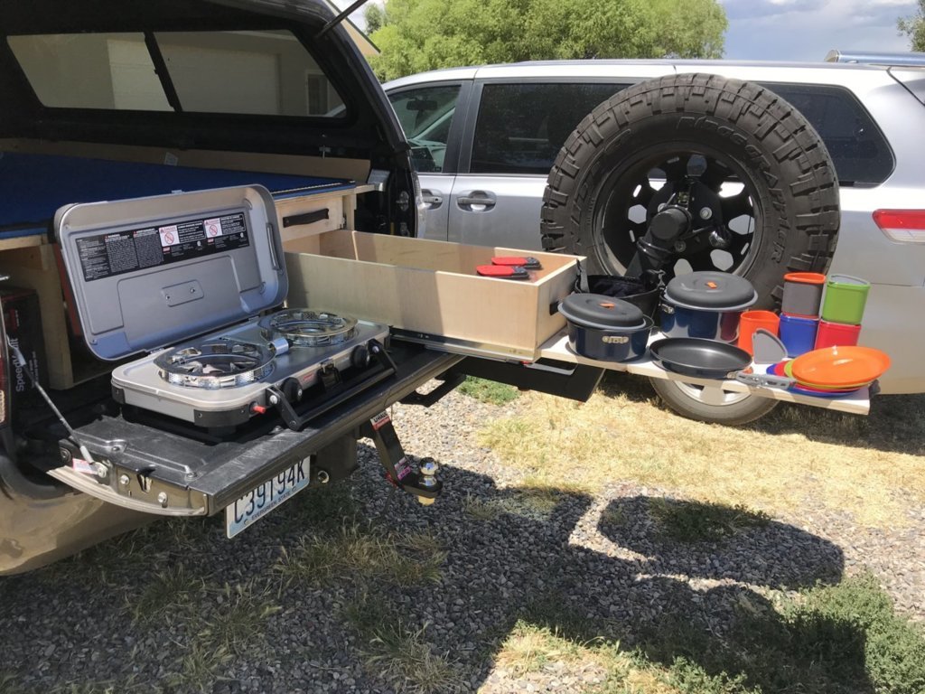

    Stove is 12lbs by itself. To keep it stored in the up position it's easy enough to use latches, etc. I'm not sure what those hinges would support in the down position, stove plus pots and food can get heavy quick.
    I thought about something similar to your drawing, but ideally I'd like the stove mounted so we don't have to store it elsewhere. I suppose I could have it mounted, and when the hinge is "closed" the stove would just be upside down. Might be a better option for the weight.

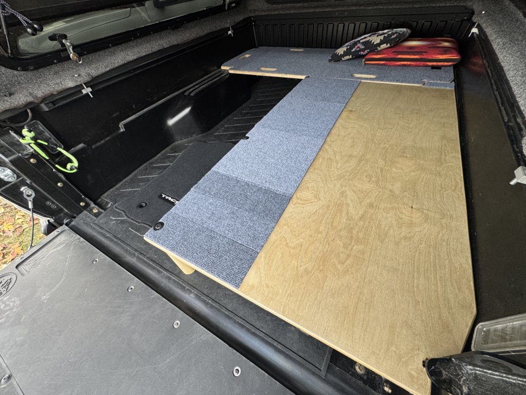

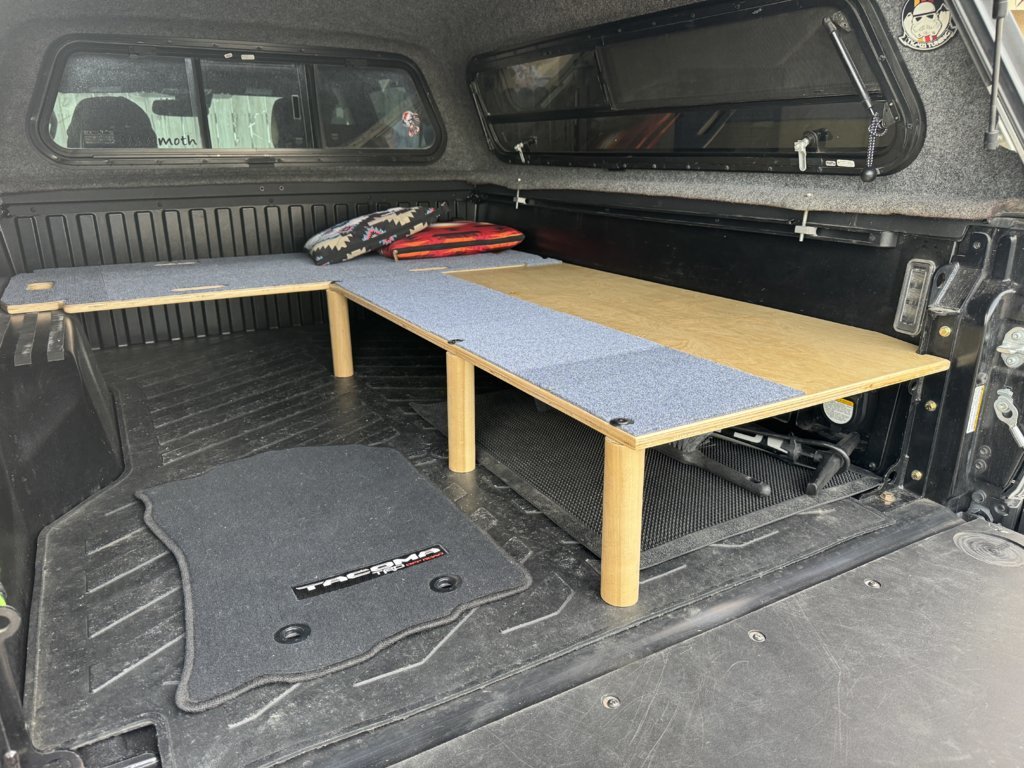

    Added this side piece to my bambeds… I also have 2 other pieces to fill in the full bed that sit on top of the existing legs when I rotate them which make a bigger ledge for them to rest on…

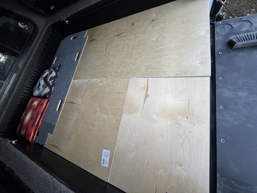

    Had to redo the piece near the driver side brake light in this pic but here’s the full bed coverage for when I need more storage. Couldn’t afford to buy another, new half bambeds that they just came out with…

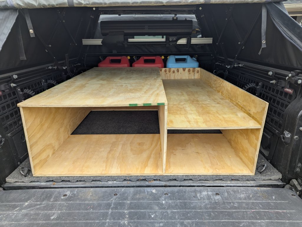

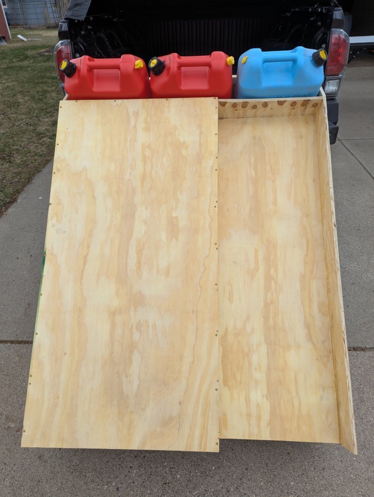

    55.00 worth of plywood.
    Sleeping for one with pieces on the bottom (two separate pieces), sleeping for two with both on top, or table/desk with one up and one down. Storage in cubbies front and back. Everything slides into grooves of bedliner and can be removed in <60 seconds. IMG_0701.jpg IMG_0704.jpg IMG_0707.jpg

    Looks good. I did a similar setup with mine and love it. 3 piece middle boards though. Used turnbuckles to some L-track on the bed to hold down the side boxes, assume yours aren't tied down.

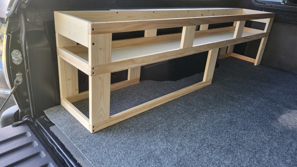

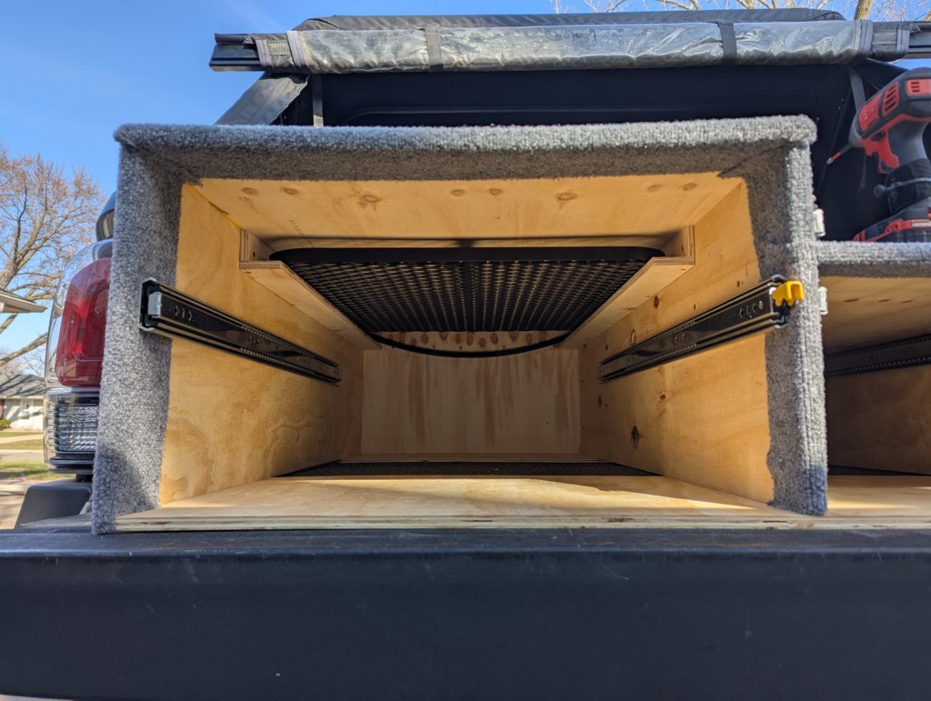

    Started working on bed platform number 3.
    The first one was double drawers but wasn't tall enough. The second one I built taller and went with a single drawer but I didn't like having my food right next to my MTB gear and with the drawer open I
    couldn't sit on my tailgate. So this one is triple drawers, one for my MTB gear, one for my pantry/cooking gear, and one for my fridge/water cooler.
    Hopefully this one is the final version.

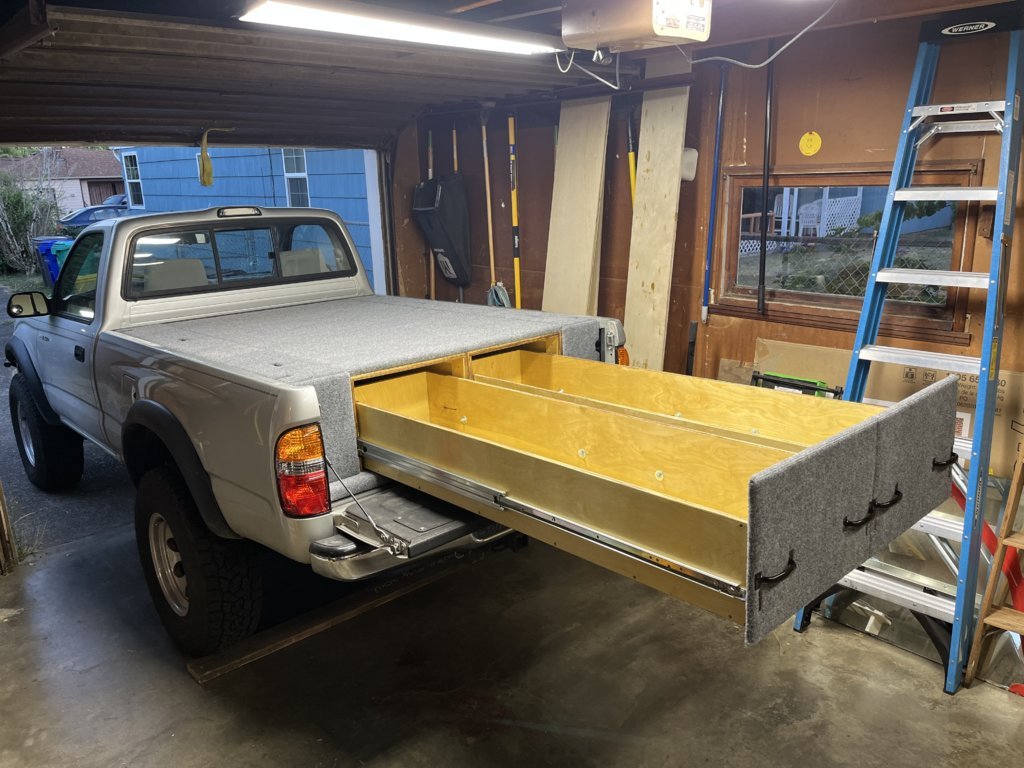

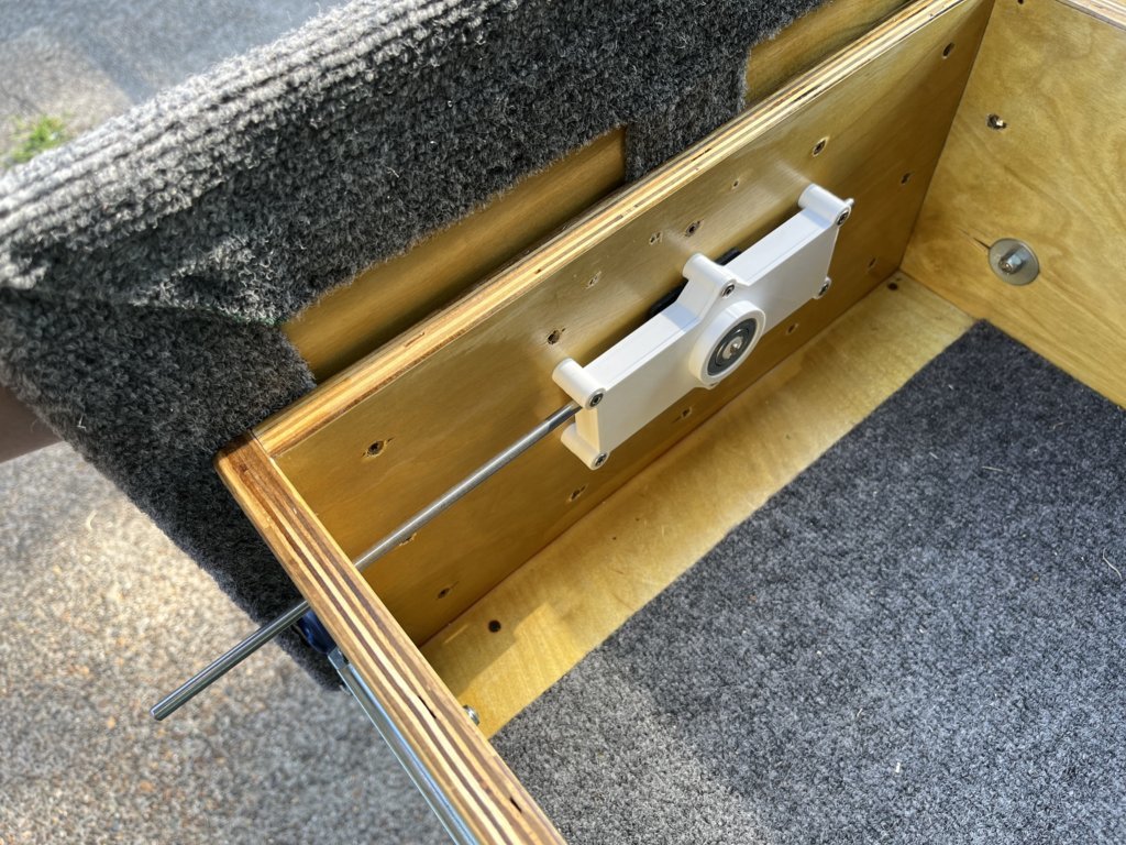

    I got a lil carried away and overbuilt mine. Happy with the functionality but she heavy. Might pull it and do some weight reduction at some point.
    I went tall on the drawers and sacrificed head room because I wanted to be able to stow as much as possible. Mostly succeeded there, the only stuff that has to be transported on top is the cooler, and 20lb propane tank if I bring that for burn ban propane campfires

    That table that hangs off the drawer is such a great idea.
    I might have to steal it.
    reallifedog likes this.

    Do it! Made the hooks by heating half inch strap and hammering it around some scrap ply. Slip knots to level things/compensate for paracord stretch
    Been meaning to source a large cutting board to replace the carpeted scrap ply for a nicer cooking surface

    A cooking surface is the only thing I couldn't figure out how to add to my design without adding a bunch of extra weight, I am trying to keep it under 200lbs empty.

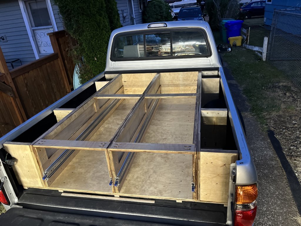

    Made some more progress on the platform.
    Got the carpet on, slides screwed on, and made a ledge to store my tire table

    Just food for thought. I built a pull out table in the bottom of my drawer as a cooking prep surface. It’s another option and not very difficult to do.

    I was thinking of that but my pantry drawer doesn't have any space for it to fit. And the handles I got for the drawers won't leave me any space to put one under the fridge slide drawer.
    Maybe someday I will build platform version 4 and can incorporate a sliding cutting board.

    Are you using two 24 inch drawer slides?

    32”
