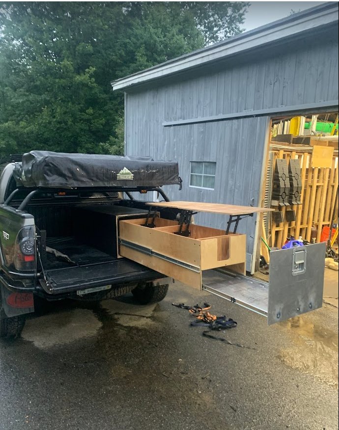

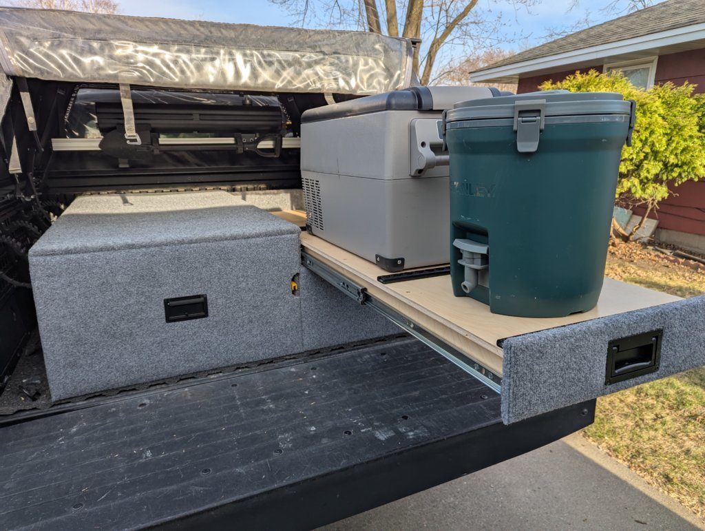

    Like this?

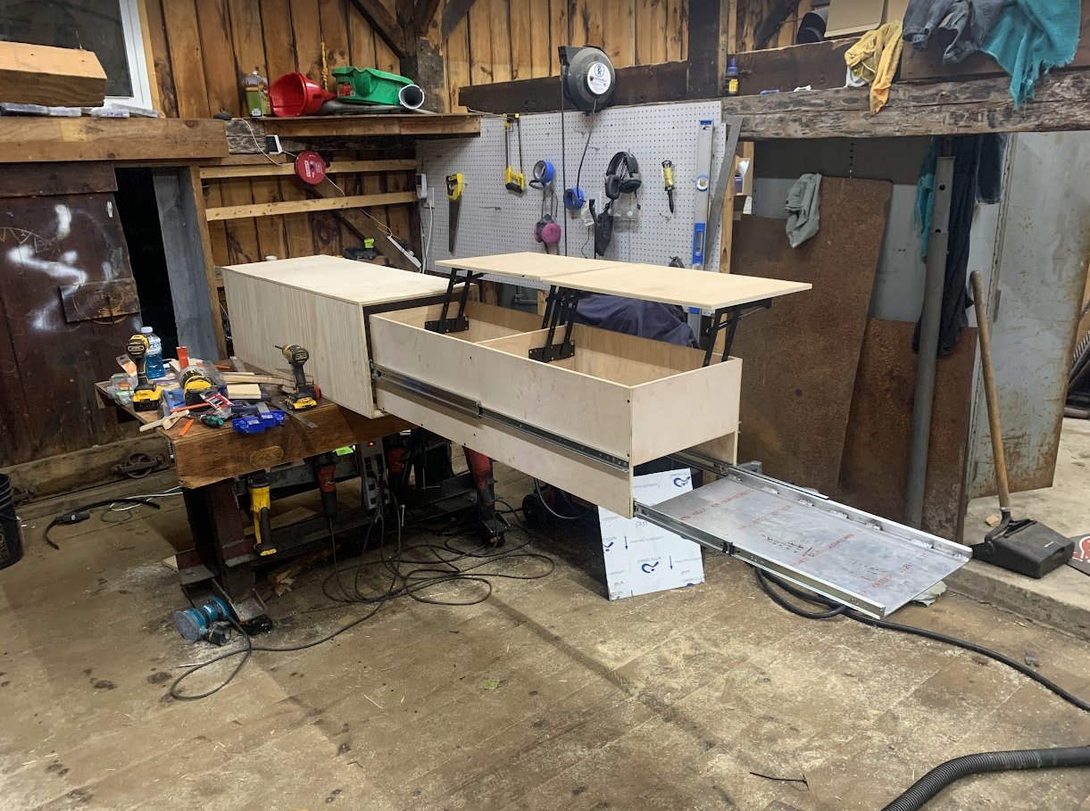

    It’s like you’ve been reading my mind…hahaha Version 2.0 will have the whole box slide out on 6’ slides. I have an initial plan for this. The drawer with the stove will have a flip down side allowing access to stove without moving it. And the side cubby will have a removable panel at the back for long storage.

    Kind of yes. I won't use a lift top simply because that surface would become inaccessible. The stove on the tailgate is already close to being too high up for the Mrs and the truck isn't even lifted yet lol
    Will your stove sit parallel or perpendicular to the drawer? A few posts up an idea was mentioned for a flip down side, and I have a design drawn up with this idea opening to the right side in order to stand in front of the stove and clear the tailgate. If putting it on the left side you'd need to pull the whole unit out farther to clear the tailgate, might be easier with a 6ft bed though. Downside of that is you're now getting so far out away from the truck that you'll lose awning coverage.

    How well does your stove shelf handle the weight of a stove with pots/pans/food/water? Seem to hold up fine? Does it get wobbly or sag or anything?

    I like the lift top vs having a hinged top so you dont have to clear everything off to open it. Not really used as a working surface either

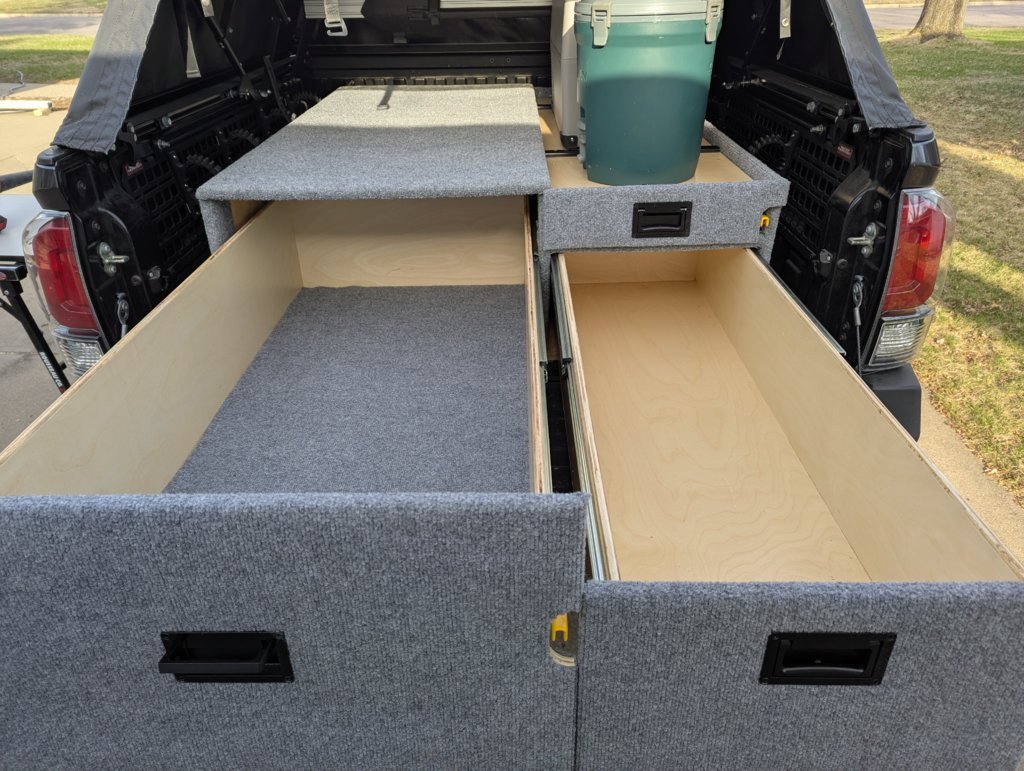

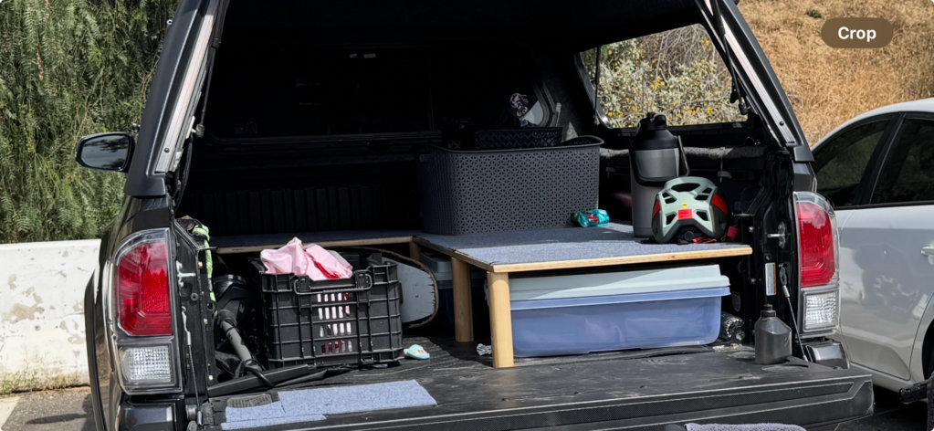

    Finished...mostly.
    I still need to;
    -Figure out hooks for my MTB helmet and for my floor pump inside the main drawer.
    -Make some dividers for the main drawer to keep my chainsaw and recovery gear separate from my MTB gear
    -Make some dividers for the pantry drawer so my stove and pots stay put.
    -Maybe make a notch in the side of the fridge drawer so I can get water from my jug or maybe just put some spacers under the jug. Don't know yet.

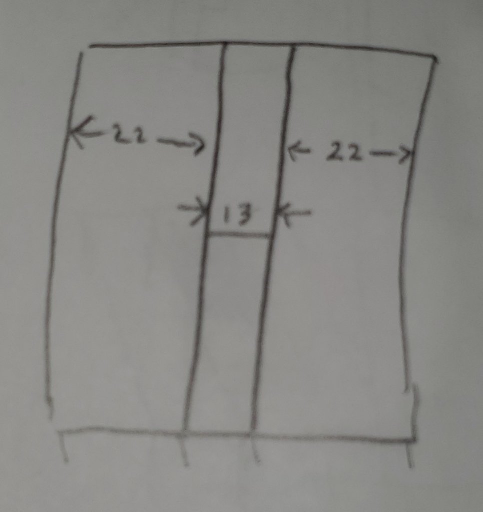

    [EDIT] Wider than 22" for single sleeping and wider than 13" for walking room.
    @TacoZmtn thanks.
    I have an idea. I have not seen the same, yet. If anyone has, please let me know.
    57" across the bed.
    (2) 22" sleeping platforms allows
    13" open area for feet
    So we can sit on the sleeping platforms.
    (2) 13" wide flats would stabilize the sleeping platform.
    1 can be removed for sitting, and the other maintains the stability.

    I like it.

    This, I really like and will use this as a reference.

    I like the way you look at this.

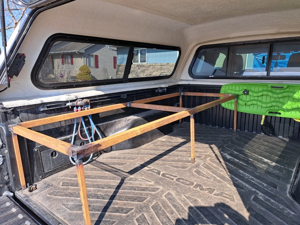

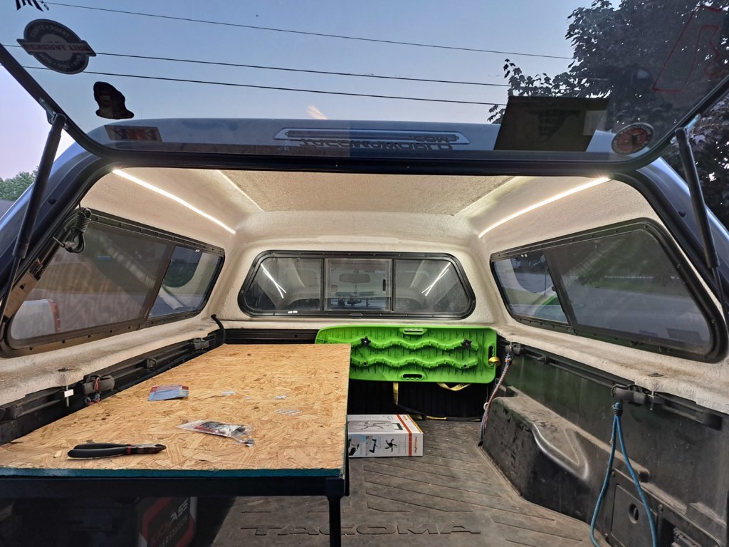

    What I've done:
    20230407_161018.jpg 20230407_170003.jpg 20230805_200728.jpg 20240702_174048.jpg
    It's evolved as I built it up. The two totes in the 2nd picture now reside in the front, as I added solar/2nd battery (AGM)/1kw Inverter. My fridge sits on the right, just inside the tailgate. In between, I can slide my EZ-Up and I have room for additional things in front of the fridge. The last pic shows my bicycle mount, which easily comes out for camping. I also have an RV tent that I can put up behind the truck that attaches to the back and opens up to give me a 10x10 room to work out of if it's raining or if I'm staying at the same place for a couple of days. This gives me flexibility for what the trip calls for.
    I made a rear seat delete tray that stores all of my recovery gear and other misc stuff. It also gives me more room to stash stuff to keep it more secure or dry.

    @TacoZmtn
    Thanks. I have a plan that I want room for 2 to sleep, and an easy adjustment to make room for sitting with our feet on the floor.
    I do not plan for sleeping in the truck as a first option, that is the Springbar tent.
    The truck is an option for those quick nights, and we might be sitting in it for some time.
    Thanks again.

    Love this set up. If i didnt already have my bamboards modded set up, id buy a welder and go to town haha

    I'm a metal kind of guy. Give me wood, I'll use it to heat the shop in the winter. Give me some steel, I'll make some stuff.
