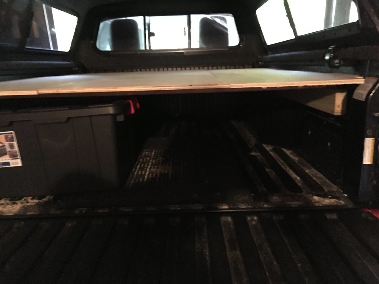

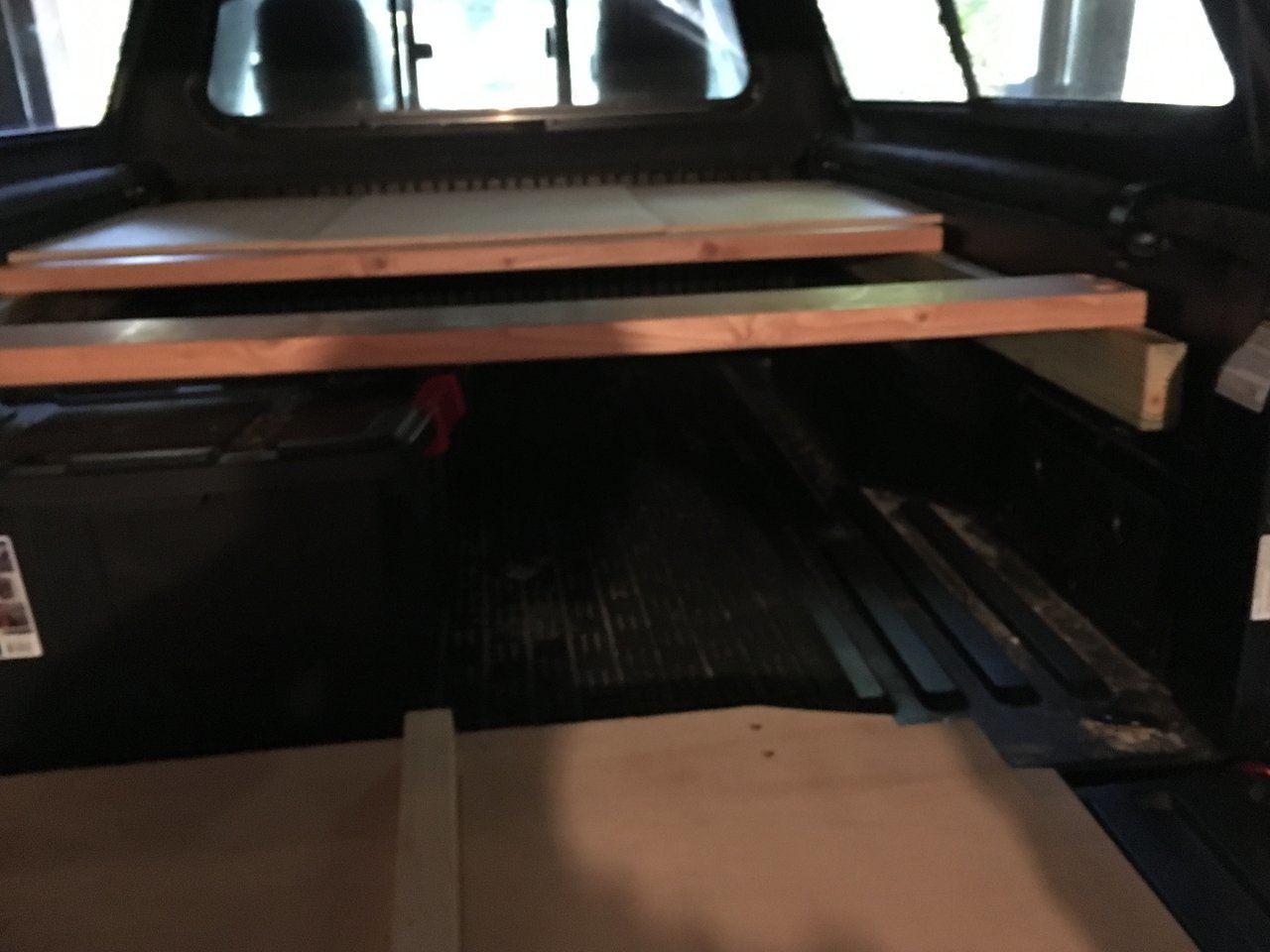

    Well I finally redid mine after seeing all of the ones here.
    First, I should say I am NOT much of a carpenter.
    But I wanted something simple where I could store 12" high bins underneath. Also, some non-stackable heavy items on the bed floor.
    For the top I wanted something that would hold a lot of weight &/or me (though would not be able to sit up).
    Also, wanted to be able to easily disassemble & lay flat in only a few minutes.
    Finally, wanted something that would allow for big bulky things in back of bed & heavy items & bins in front of the bed.
    Instead of using the notches for two cross beams, I put a 2x4 on the lip with 3 2x8 cross beams... undo 4 nuts & the rear beam comes off for my outdoor rockers to go in back of the bed :).
    There are 6 plywood pieces that fit to make the plywood. I wanted to be able to pull up center pieces to get easy access. None of the plywood pieces are bolted down, but I have "shims" underneath to keep them from sliding out of place. As such, can take them right out.
