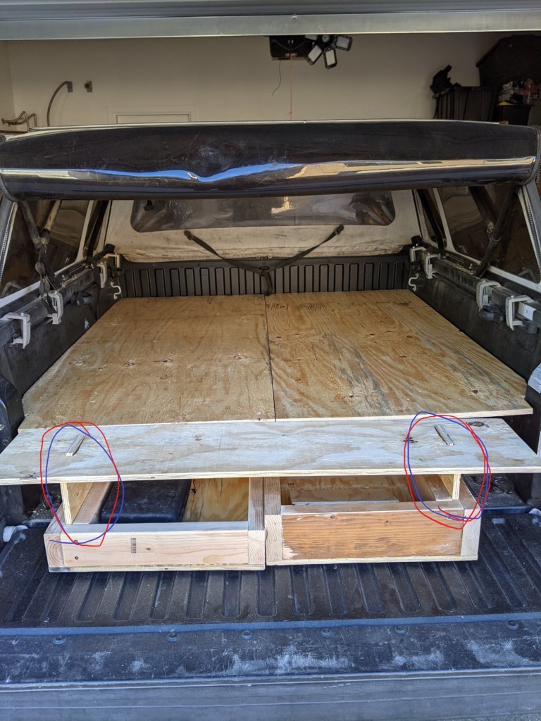

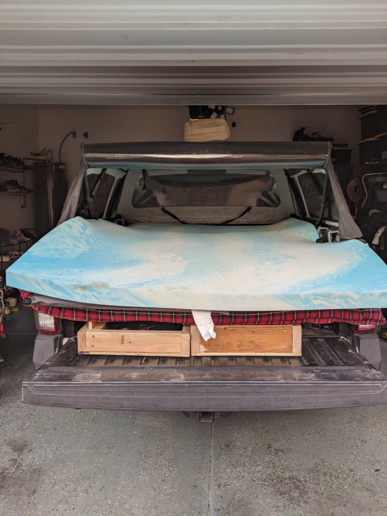

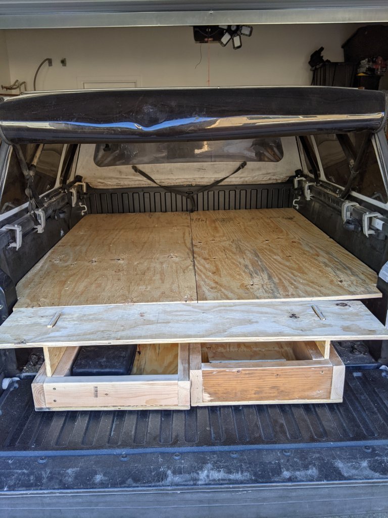

    Mine was cheap and shoddy but I made it so that it was easy to extend a shortbed to a sleeping surface long enough for a 6'2 person to sleep in a non-fetal position, fit a queensized sleeping setup that I could just tuck/fold up in there for the day while we drove around and then flop it down and set up the extension. I think this is the cheapest DIY full length bed platform option but not necessarily the nicest or the lightest. Also my feet stuck out past the flap when closed but I survived a few trips. Kinda snug with 2 little kids, kinda cozy when it was just the wife and I (no further questions your honor). It was cheap and mostly scrap from other projects. under the plywood I had some 2X6"s for reinforcement. I liked it - actually just sold it with the topper last night.

    I originally wanted to do something just like that but found it seemed to restrictive so ended up tweaking it to more of (2) widths between the wheel wells and cubbies front and back of the wheel wells on each side.
    I made the permanent sleeping platform a little wider, around 24-26" from the side of the bed (on top of wheel wells) which fits a lot of the "single" size folding mattresses on Amazon. That leaves you around 18" wide drawer underneath. The open aisleway/feet area is also wider which I would highly advise if you ever use your truck for other stuff. Mine is 22" wide which is just barely enough for pretty much everything it needs to fit. Cooler, toolbox, 4 pairs of skis, leaf blower, etc. are the recent things that have come to mind. It makes sitting on the mattress side feel a little roomier having more foot space as well. You don't lose as much storage space as you'd think since you get a compartment in front and behind the wheel wells.
    It works really well to swap a single folding mattress with the full folding mattress when my wife joins or I want some luxury space.

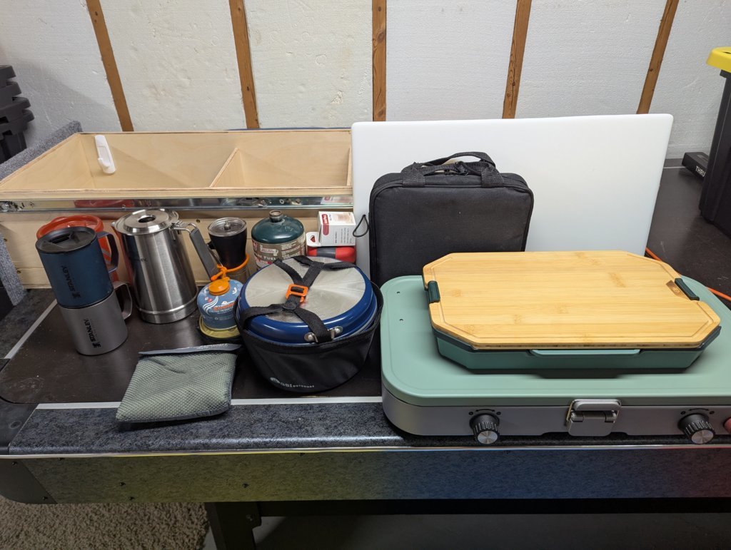

    Finally got around to organizing my kitchen drawer.
    I think I'm going to make some DIY TrekPak for the front compartment to hold all the loose bits.
    I have a trip coming up in a few weeks to test how it works and what I might need to change.

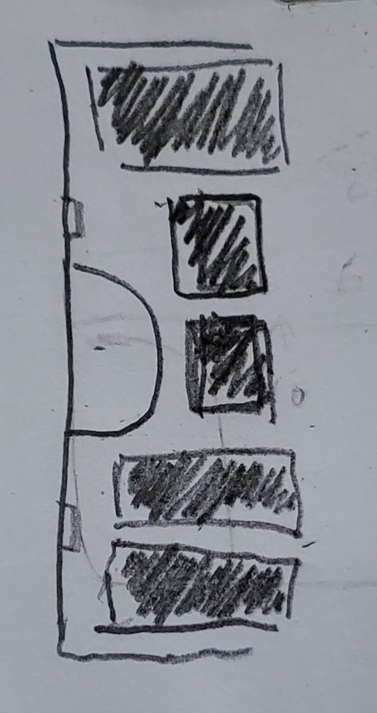

    Yes. I was thinking about that and yours as well as others prompted the idea for wider walkway.

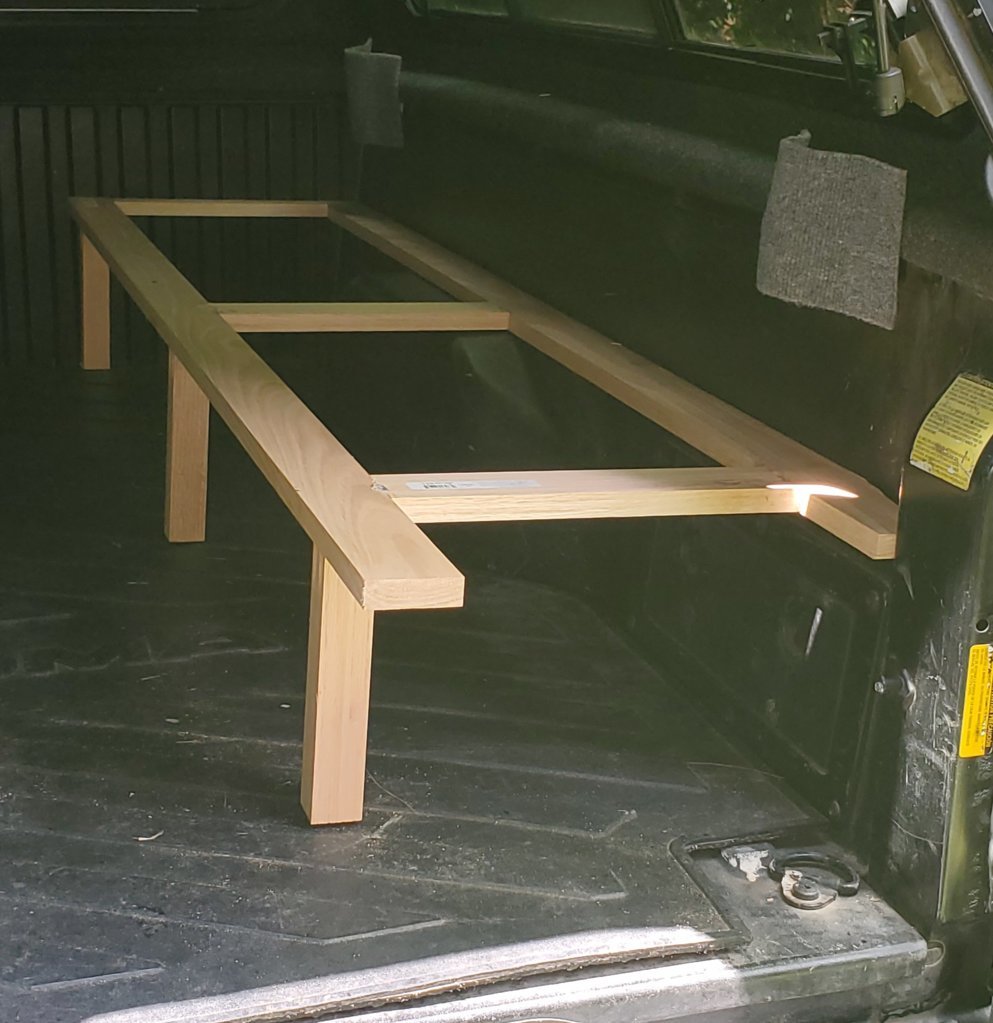

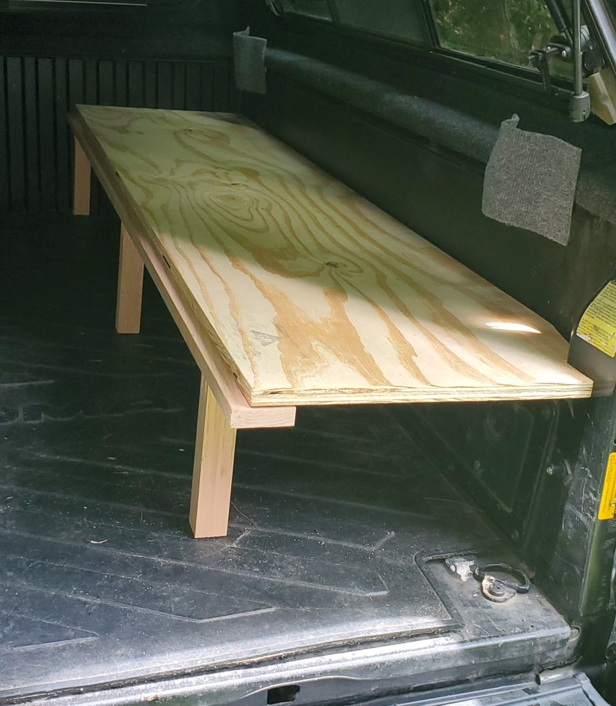

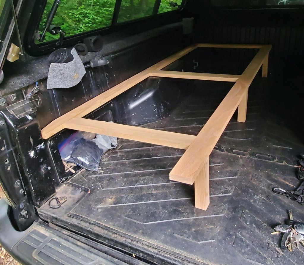

    24" leaves 33" to be divided into seating/walkway.
    24" on the left allows 5 Hefty Hi-Rise 18 Qt clear totes under it. They are what we use to organize. Coffee kit, kitchen, camping/fire, stoves, etc.
    16"/17" will easily allow the 2 Scepter 10L to lay, plus a tote with lights.
    Room to spare for odds and ends.

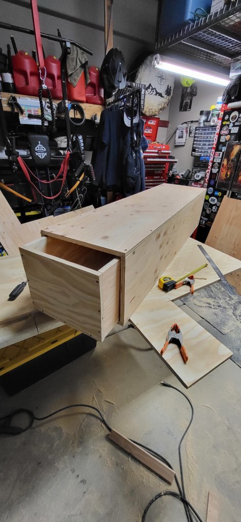

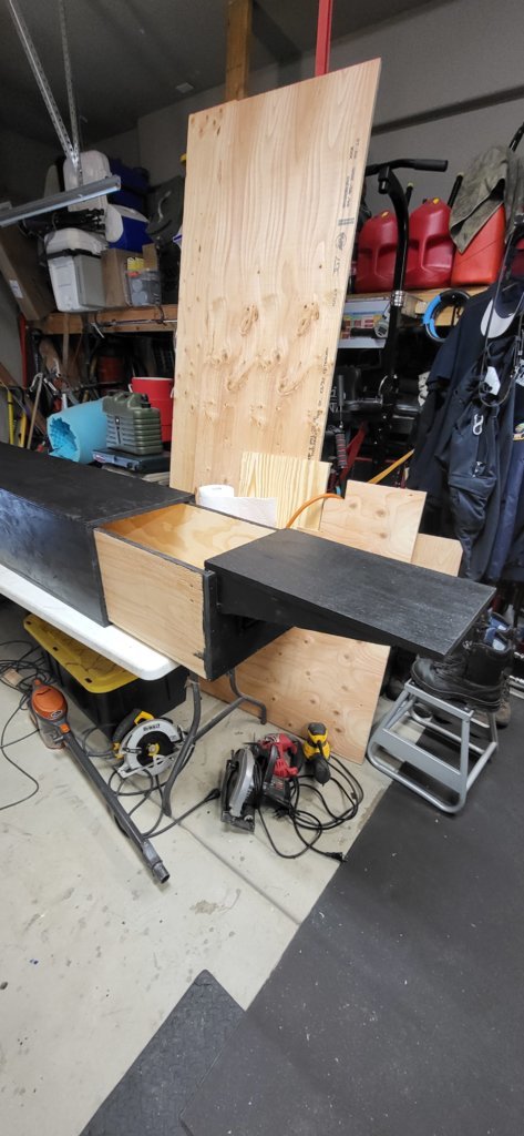

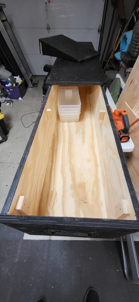

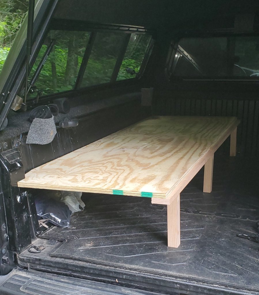

    20250602_195327.jpg 20250602_201145.jpg 20250603_151339.jpg 20250603_173801.jpg Ditched my Diamondback for a bed rack and needed a storage solution. Built this with 3/4" plywood coated in bedliner. Measures 16" wide x 60" long x 12" high. Found the shelf idea on YouTube, works great.

    Driver side
    Passenger side.
