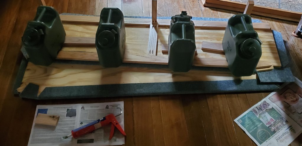

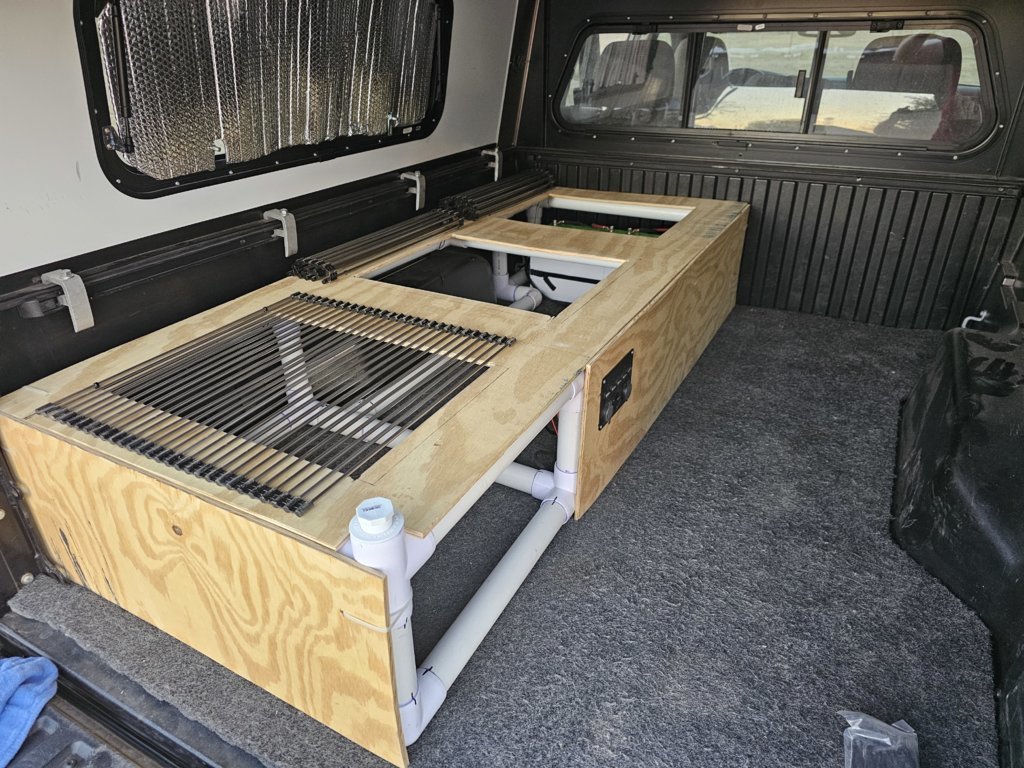

    In process.
    Indoor/Outdoor carpet and Liquid Nails.
    lowmower, POOLGUY, rob1208 and 2 others like this.

    Progress
    20 lbs each container so just like clamping.

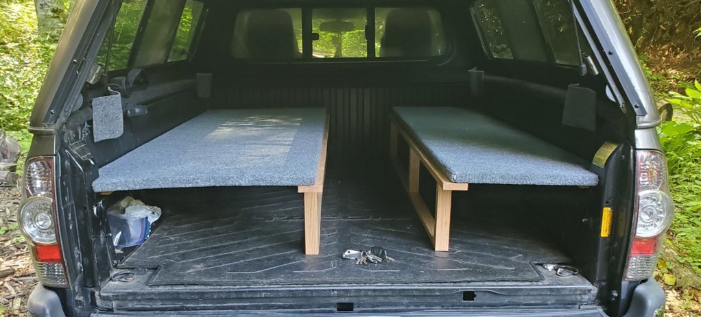

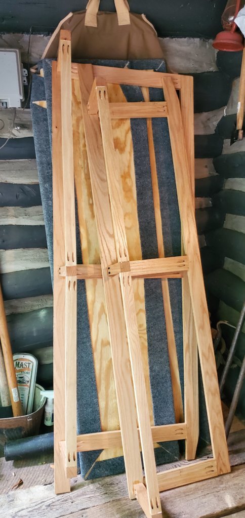

    Platforms covered.
    Frames completed and varnished.

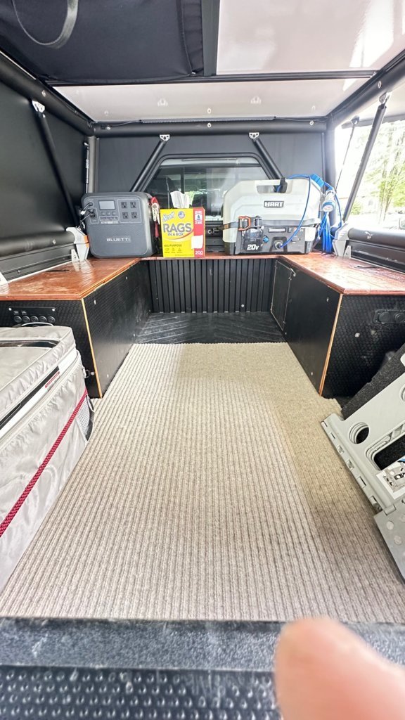

    From another thread so I don't have to upload the pics twice...

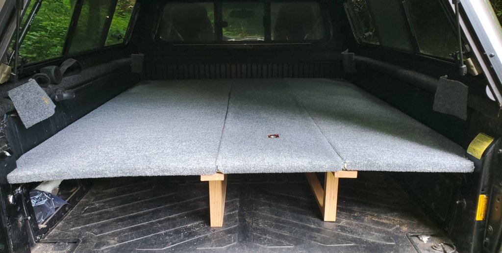

    Almost done.
    2 middle pieces are getting carpeted.
    lowmower, jwctaco, POOLGUY and 2 others like this.

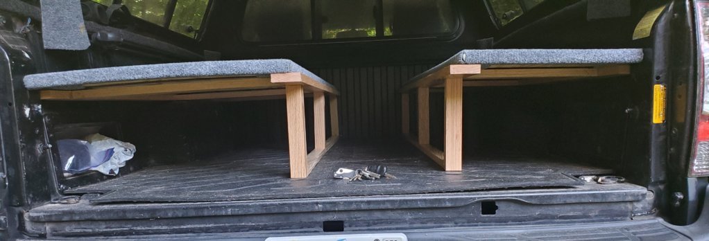

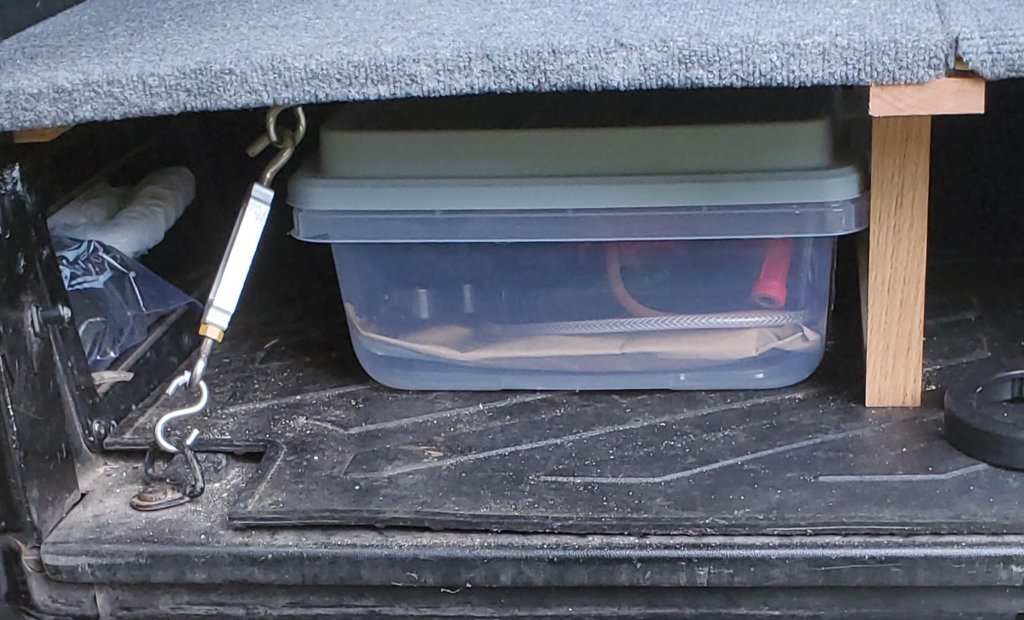

    Done.
    Just gotta turnbuckle them.

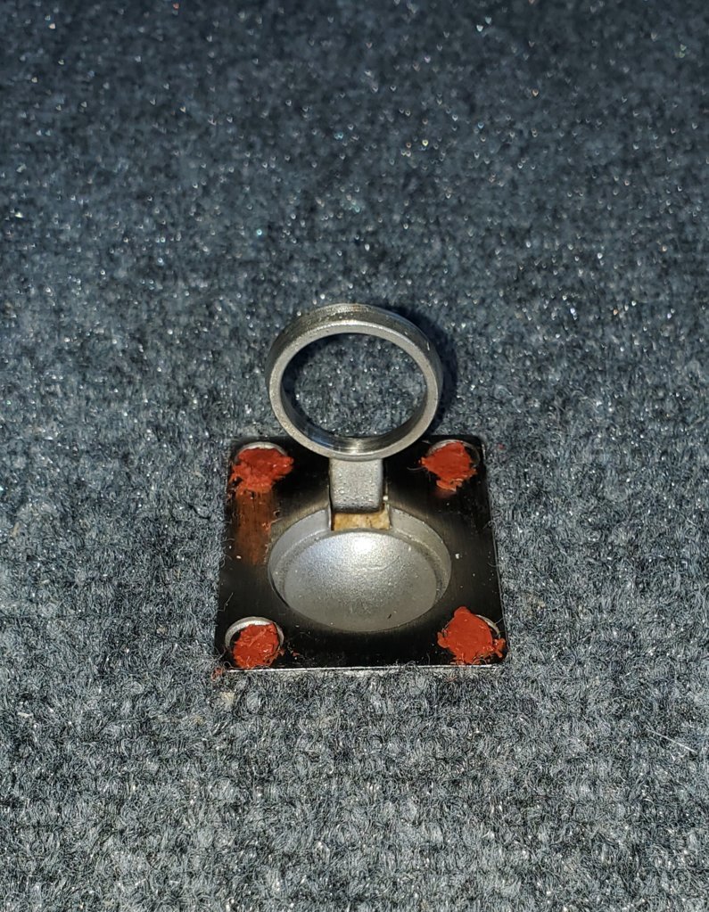

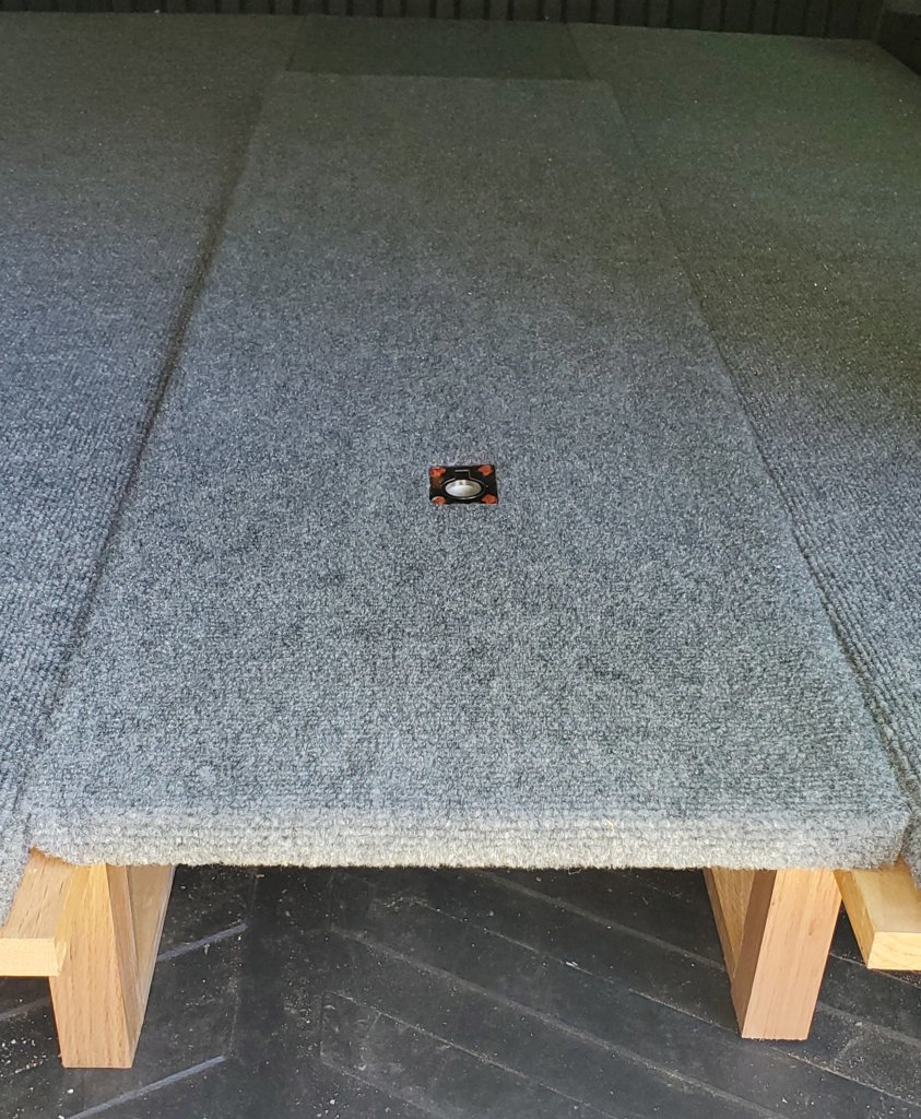

    Pull ring to pull up the middle while inside. Silicone is to prevent snags.

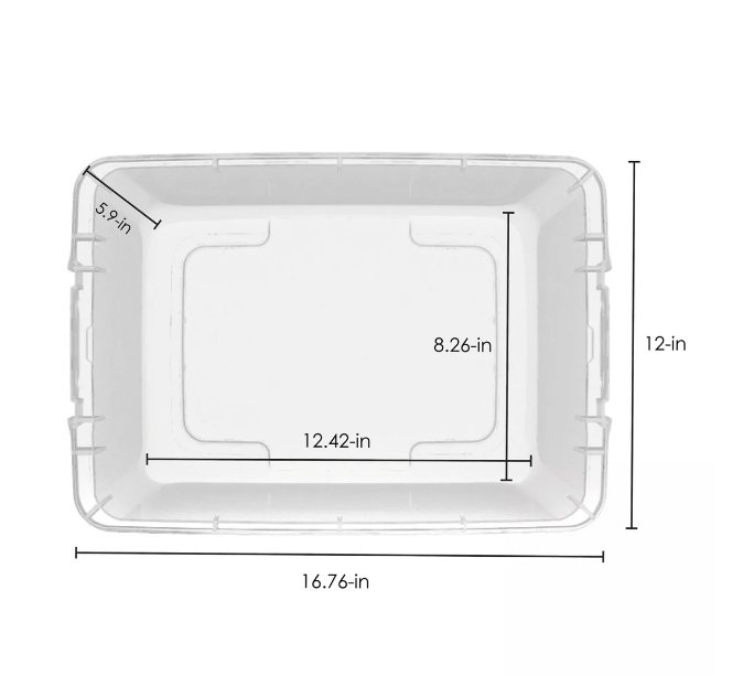

    Good idea! I ran across another thread a while back that mentioned the DeWalt box size that fit in the AC rear footwell, so I'll measure the bed slides to see what size totes fit the width...

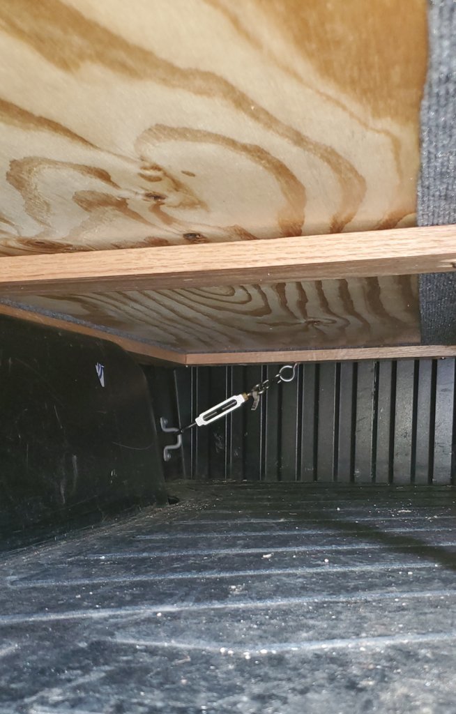

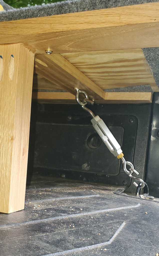

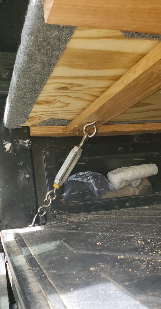

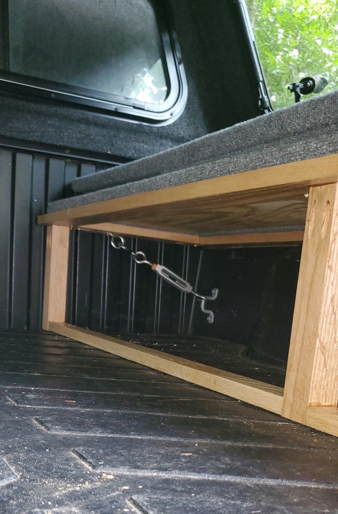

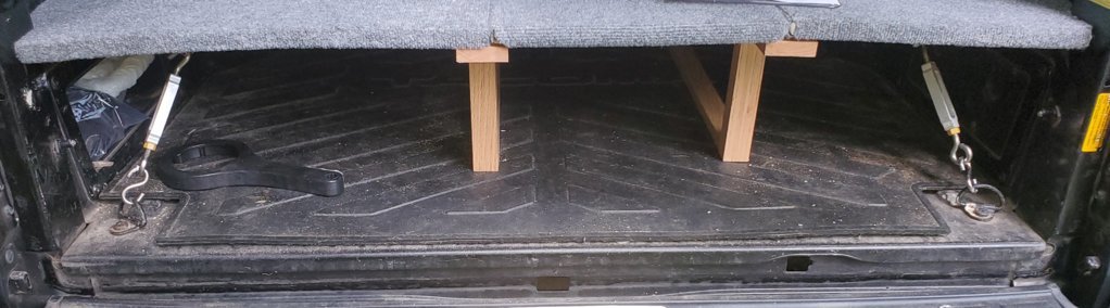

    Note the lock nuts.
    20250714_135814.jpg 20250714_135904.jpg 20250714_135012.jpg 20250714_135001.jpg 20250714_133737.jpg 20250714_133726.jpg
    4WDTrout, ETAV8R and jwctaco like this.

    These totes fit my AC rear foot well.
    Charlie Bravo[QUOTED] likes this.

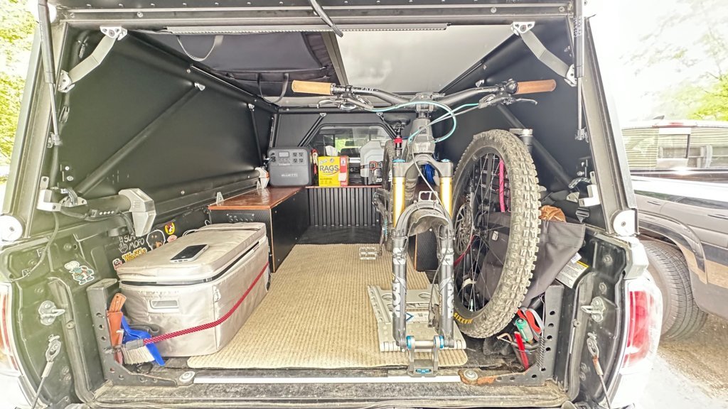

    Looks awesome - truck, platform, trip - just awesome

    Do you have a write up on how you made this?

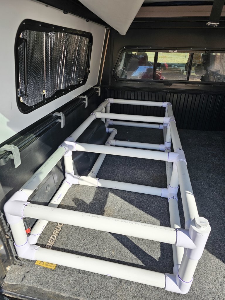

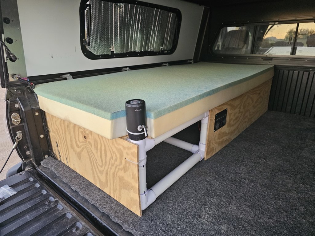

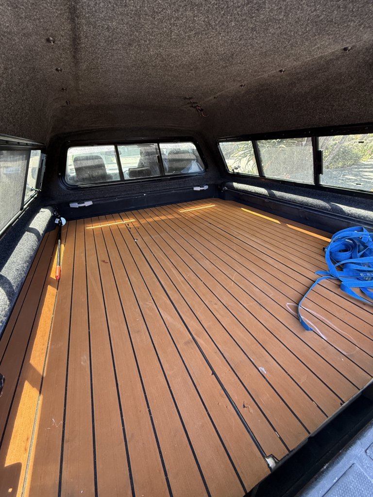

    To make the Tacoma BamBeds Kit you'll need the following.
    Material:
    Two 4x8' sheets of 3/4" thick plywood.
    Total material cost: $150-$600 depending on material choice.
    We use a high grade birch or bamboo made with waterproof adhesive to prevent delamination in the long term.
    Tools:
    One jigsaw
    One router with a 1/4" or 1/8" bit
    (Circular saw or table saw is ideal but not needed)
    Time:
    2-8hours depending on skill.
    Key Dimensions:
    Each board is approximately 57"x24". Make a paper template for the angled cut at the back of the bed.
    The tailgate bulkhead width is 53"
    The height of the ledge is 9" (this is how tall the feet should be)
    Best Finish:
    My favorite way to finish the boards is with with EVA boat decking foam which provides a comfortable surface to crawl on and really protects the wood as well.
    Very easy to apply, just peel and stick. We've got a link and DIY install video to this on our website.
    Example on my Tundra (about 2 years of use so far)
