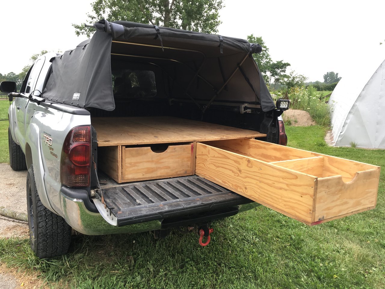

    I built this about a year ago to do some package delivery...I think I spent about $100, maybe a bit more.
    I bought the casters at Lowes...if you have a few power tools (or even if you don't) it's a pretty easy build. I looked at several different builds (some on YouTube) and took what I thought were the best features from mainly two of them.
    One note of caution...the wheel wells slope outwards as they go up...so, basically that means your bed can be a bit wider than your base...I didn't realize that until after the build and left at least a couple of inches of bed width on the table...not too big of a deal, but every inch counts (imo) when you are losing area in front of and behind the wheel wells...
    If there is a weak part to the design, I would say it is the side brackets that kind of guide the bed in and out...I had an air compressor fall over and hit one of those and kind of loosened it a bit...so I went back and reinforced it with some 1" x 1" blocks to give the screws a bit more to bite into.
    Everybody who sees it really digs it. The lady who owns the package delivery company couldn't get enough of it and was taking pictures of it...She did mention that she thought some packages could fall over the sides (and she was right), so I built a little fence system that I can install when needed...

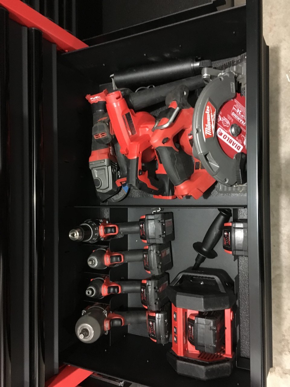

    I’ll take those pesky dewalt off your hands :D
