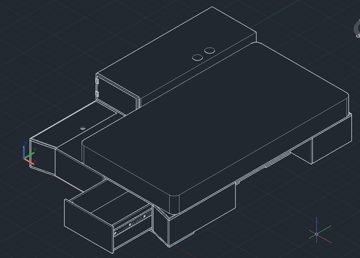

    Been drawing this up in cad
    Still have a lot of ideas I wanna mess with

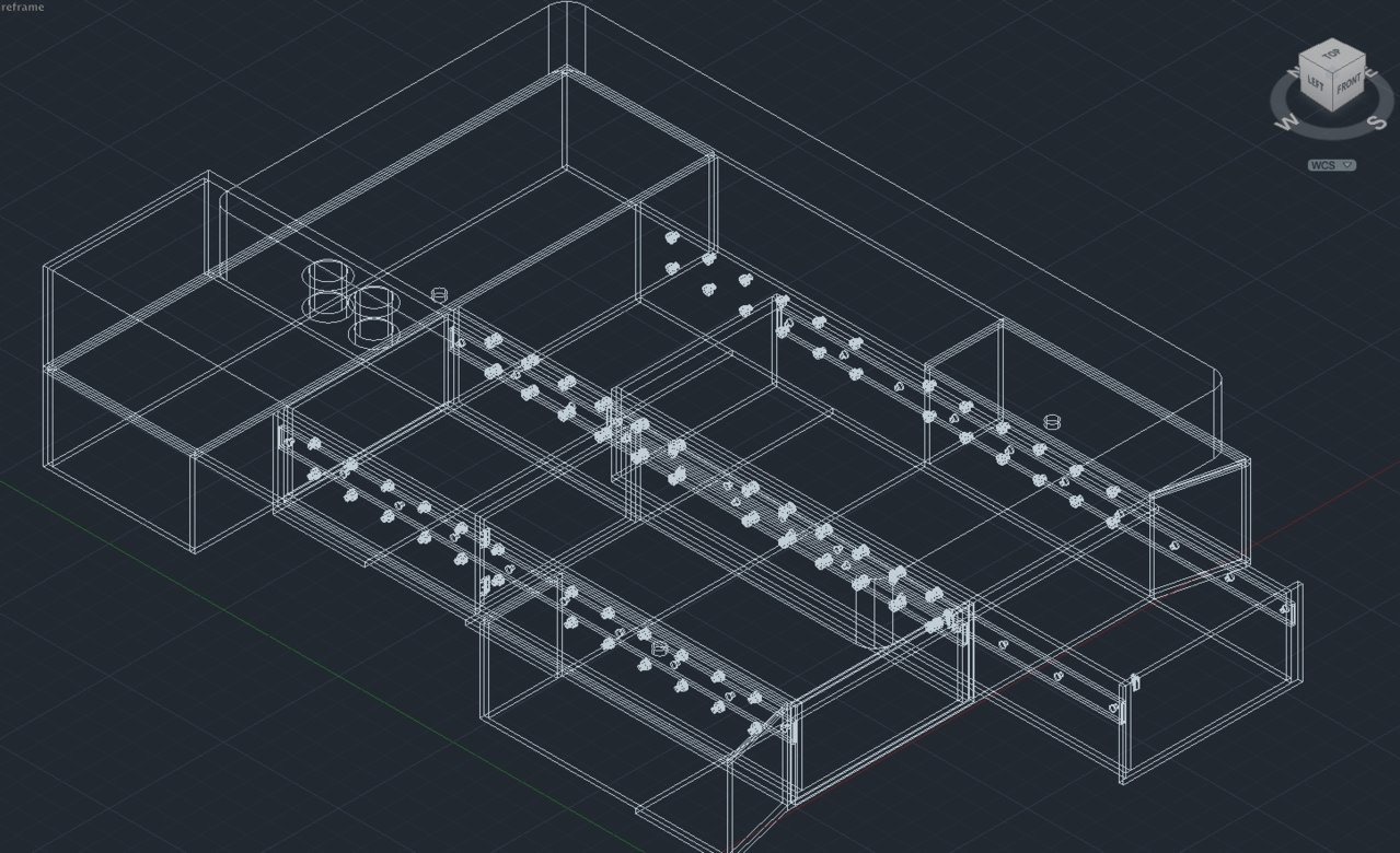

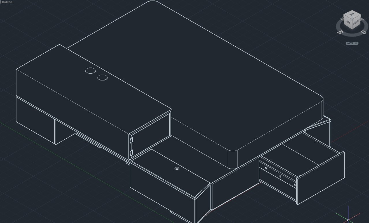

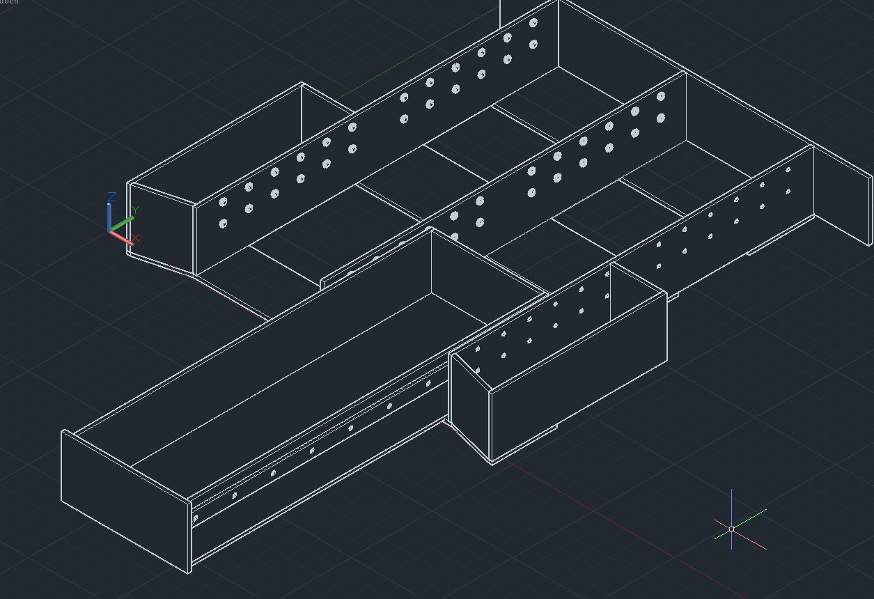

    finally got to finish this. Dimensions aren't super precise I just wanted to get an idea. Gonna price everything out tomorrow, I'm thinking of doing the whole thing with 0.5"x10" boards and 0.5" plywood on top. But using plywood cut in 10" strips might be cheaper. Gonna carpet the entire thing most likely. Gonna do air and electrical (12v but possibly an inverter if I go dual battery in the future) on one panel and water on the other. I left 16" off the back to store a 21 gallon tank if I ever decide to do that. The whole side thing next to the bed will be removable so that I can use the entire space if I need to. Also it has cup holders.
    (heres the water tank) https://www.amazon.com/dp/B007MSK5RQ/_encoding=UTF8?coliid=IFIT47HS6R4RI&colid=1V4KIQ181UVTA&psc=0
    Im basically gonna copy Chux's idea for the drawers using a 2" hollow aluminum tube and skateboard bearings.

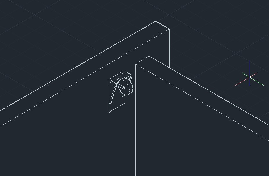

    I wanted the drawers to stay shut somehow, especially considering they are spaced away from the tailgate, so I figured the best way to do it would be these small roller things that would fall into a divot to "lock" in. I have absolutely no idea what they are called and can't seem to find them but Im sure someone here knows what I'm talking about. I did a half assed design here:

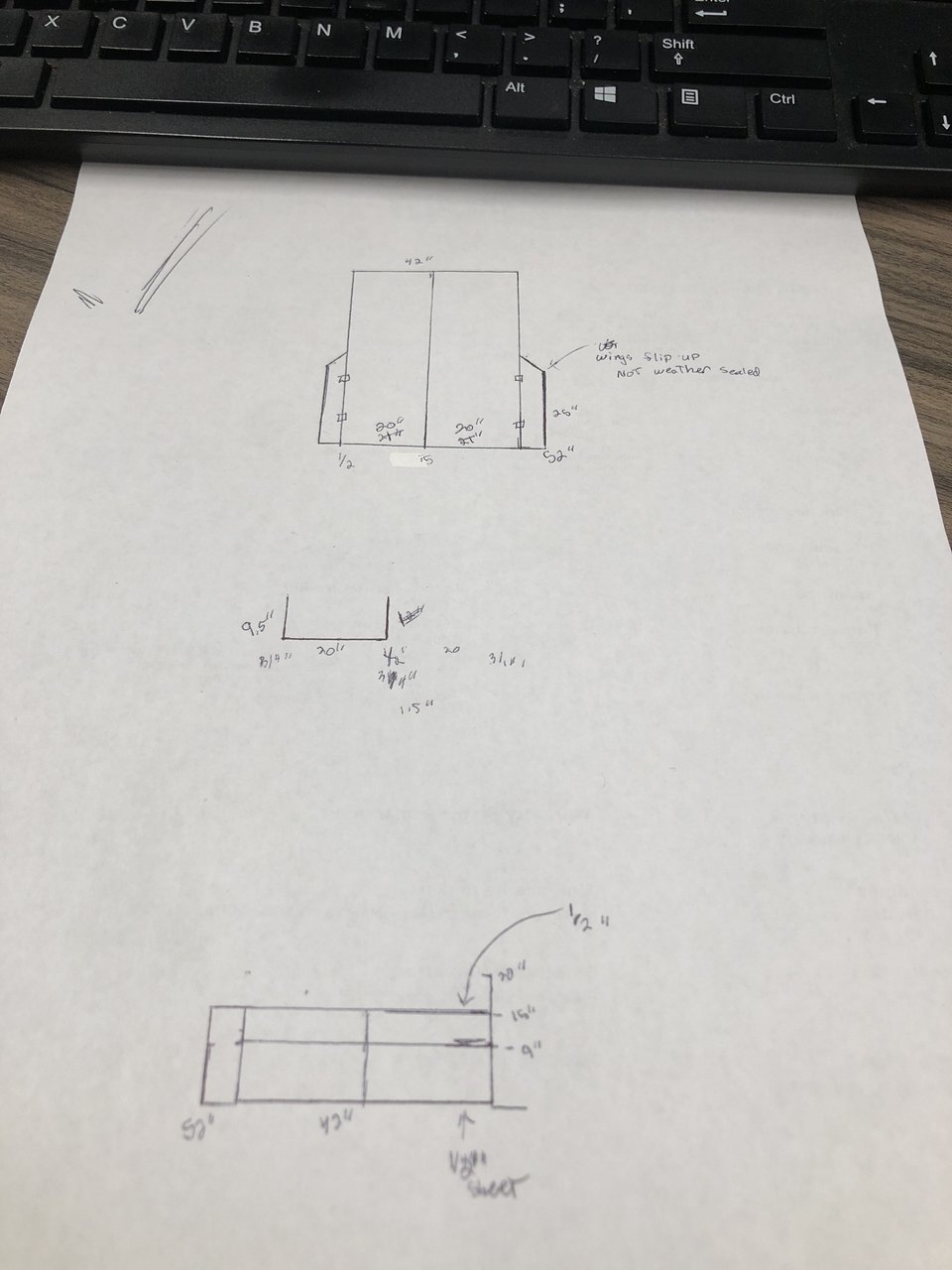

    Do any of you guys have drawers built and not have a topper? If you guys do, how did you guys go about weatherproofing it?
    I've been going back and forth thinking about trading my Tacoma in for a 4Runner, but love the truck too much. I carry around a lot of photo equipment and wanted a safe place to keep it when my truck is full of people. I then thought having a bed drawer system will work out for me pretty good. But Im concerned about water or too much dust getting into the drawers.
    Sidenote. I think having stuff in the drawers would be even safer than keeping them in the cab theft wise, because I have dual rear swingouts that I am able to lock
  14. Feb 8, 2018 at 12:03 PM

    I've not done this myself but couldn't you add a tonneau cover/locking tailgate for weatherproofing and security?

    I wanted to avoid any topper/tonneau because I wanted this to also be some type of a makeshift photo platform. Kind of what Ansel Adams had on his van. The drawers don't need to be completely waterproof, My biggest concern is how much dust would get into them

    I was planning on having the platform built to the tailgate. It would be locked by my tailgate, and by my dual swing outs. If I needed extra security the latches on the dual swing outs have the ability to be locked.
    How are you guys sealing your drawers? Do you think high density foam would be enough?

    This is an extreme rough draft I’ve been working on. I’m hoping if I can make the main box part that will contain the drawers well enough, it should be (hopefully) dust/water resistant.
    Do you think sealing the plywood and using high density foam would be enough to keep the drawers dry?
    The wings toward the rear of the bed would flip up and down to allow me to have access to the cubbies.
