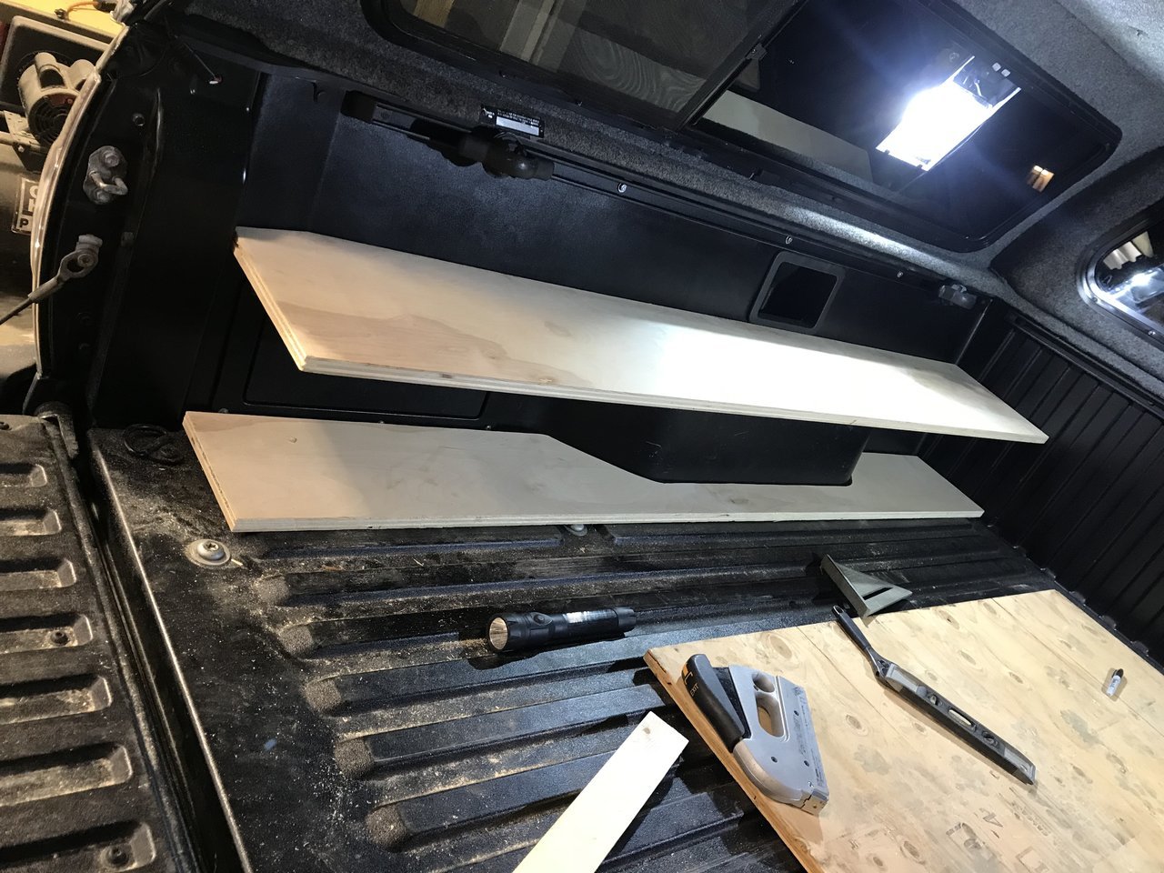

    Awesome. Thank you for that info. I was planning on using wood glue and screws to keep everything together. What wood did you use with your build? How are you planning on building your drawer system? Are you going to use drawer slides?

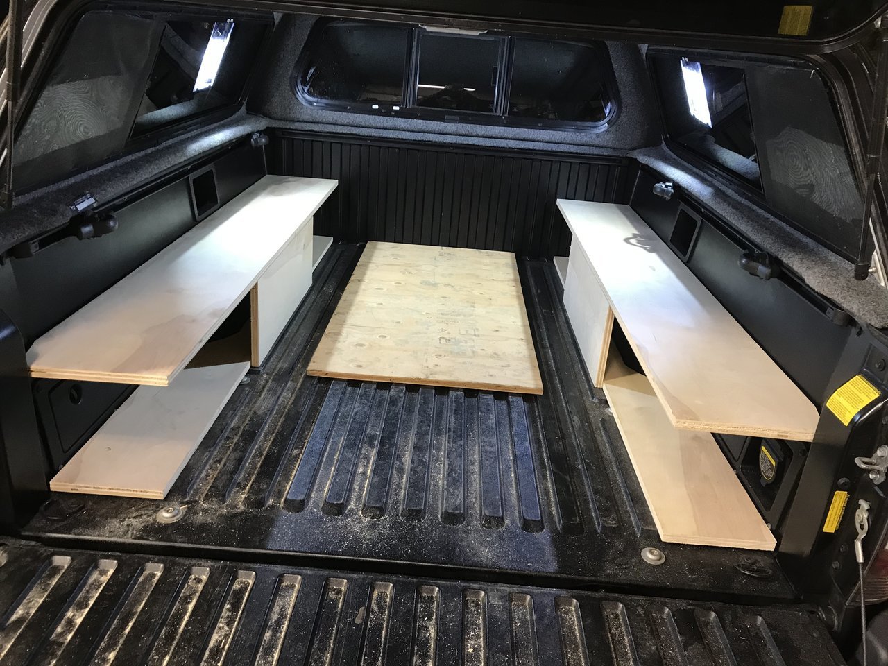

    And a couple more because I am happy with how this turned out! (Repost, but it will give others ideas too)
    I built this out of 1x sheet of plywood and 2x lengths of board. If you didn't want the hinges, I don't believe it would be possible with the center being the width that it is.

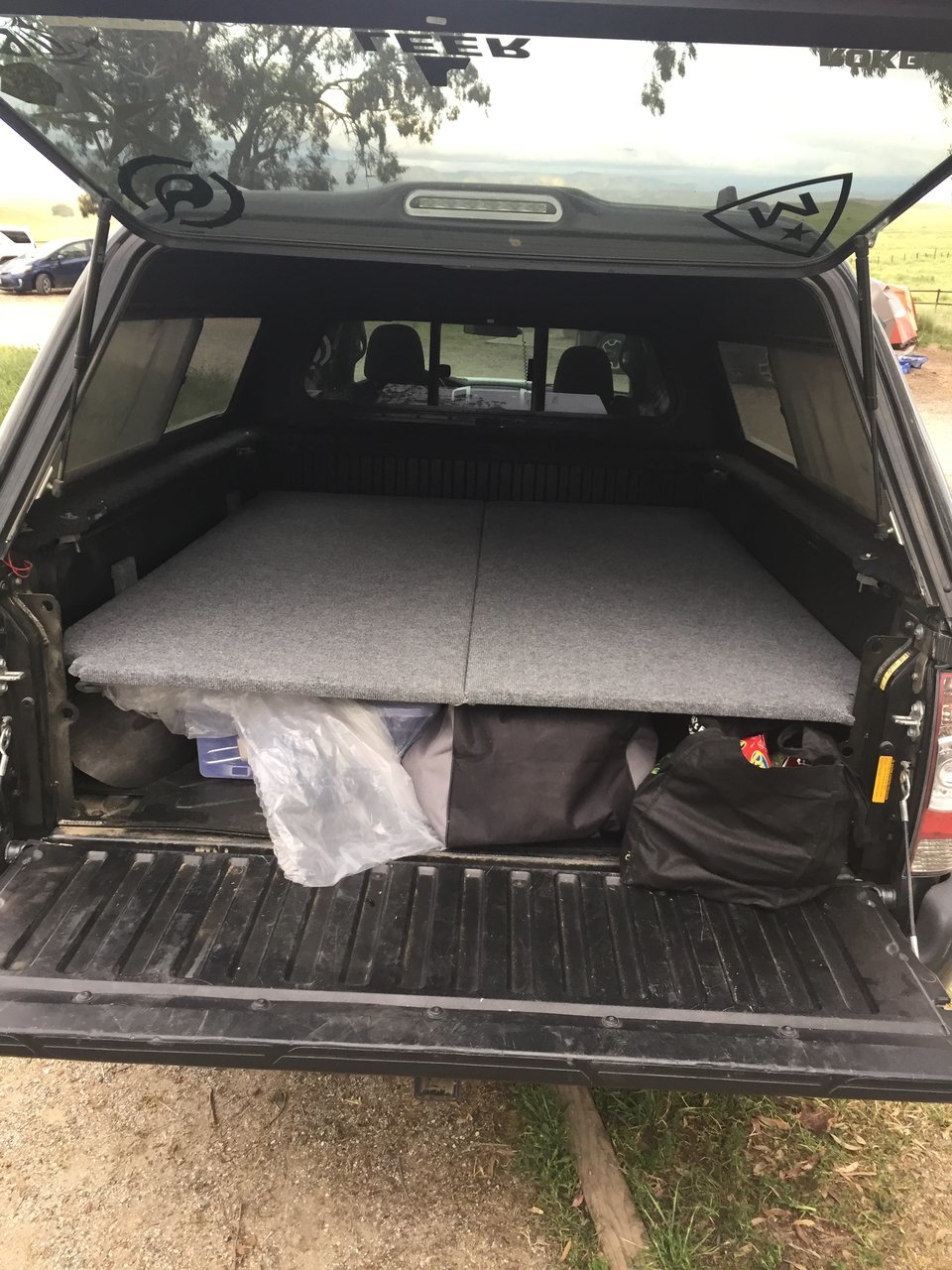

    I threw mine together real quick the night before a trip. 2x6’s across and two sheets of 3/4 ply. Took the measurements and had HD rip em down to size, then used cardboard and a jigsaw. To trim the ends to match the tailgate area and clear my bed supports. Grabbed a role of indoor outdoor carpet to cover it. I made my half’s equal so I can fold the one side on top of the other. Alllows me to fit the yeti and scepter cans on the bed floor so if they did leak they wouldn’t leak on the platform, then I just use s cable lock and lock em to the hitch outside at night. Also picked up some long tubs on wheels that roll underneath the platform.
    Also made my move across the country nice by allowing me to run 2+ levels of stuff

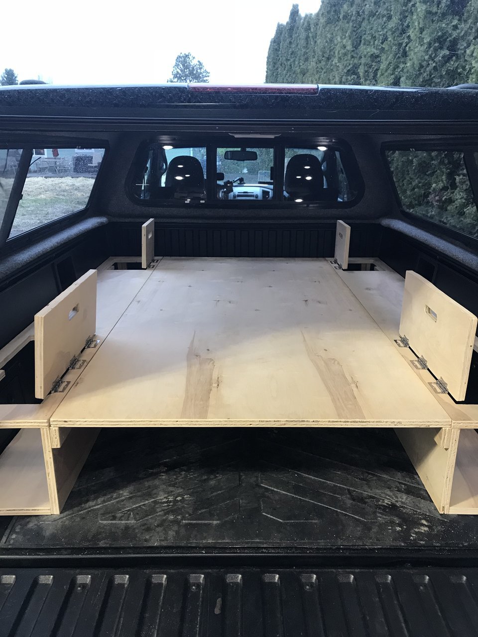

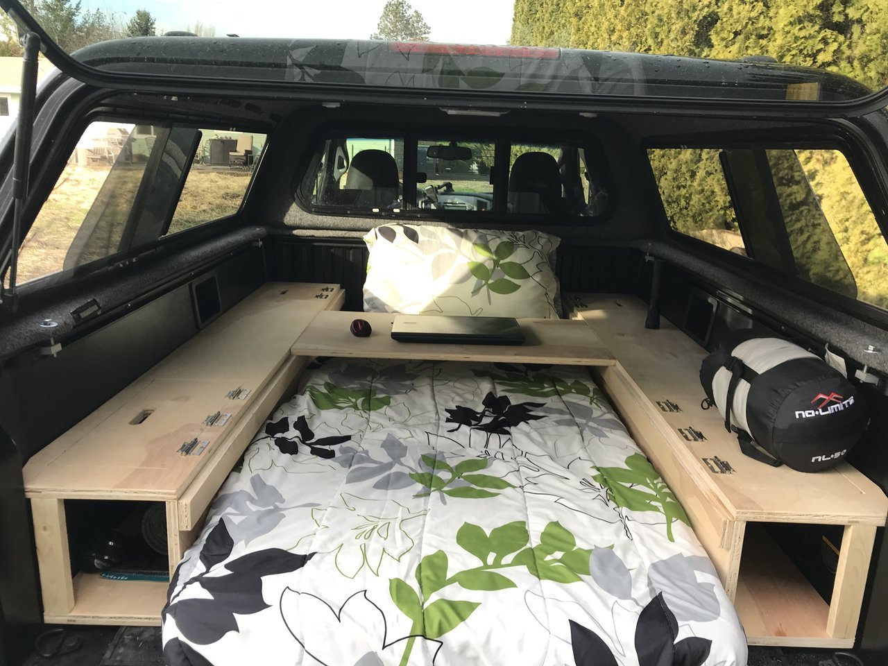

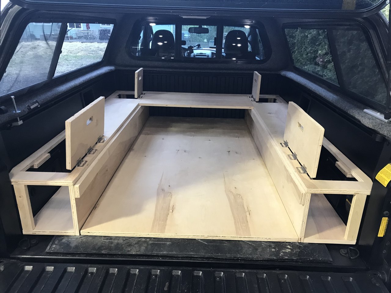

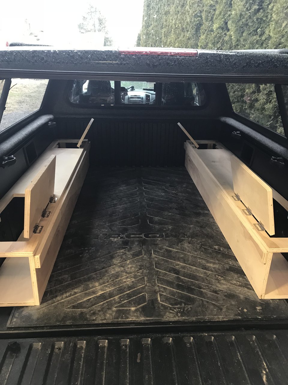

    Hey guys first of all i bought my first Tacoma about a month ago. I wanted the AC for the long bed so i could build this bed platform but also because i happen to like the look of the shorter cab and longer bed. I spent a lot of time looking around online for ideas for my bed platform and took pieces from a lot of different designs to come up with my own. I figured I'd post it here to add to the collection and give yet another example of a bed platform arrangement.
    A few of the criteria I had in mind for my design were the following.
    -Easily removed without any bolt on components(comes out in three very manageable pieces, four including the across the lap desk piece)
    -Two configurations: One wide bed platform with storage underneath to sleep two. And a configuration for one person (or a tight fit for two) with the added head room to sit up.
    -I wanted it to be sturdy and tight fitting with no bow when on top and no noise from it bouncing around while driving
    IMG_0782.jpg IMG_0784.jpg IMG_0794.jpg IMG_0796.jpg IMG_0798.jpg IMG_0807.jpg

    That’s really nice.

    Daaang! I like that desk idea!

    Looks great. Did you secure the long side storage bins to the bed?

    No, my goal was not to have to. I knew that if i had to bolt the side boxes in, they would rarely come out and I wanted the flexibility to be able to go back to normal truck mode again. The thing i was afraid of in this design was that this would allow the boxes to rattle around, or cause the boxes to bend inwards when a persons weight was applied to the center platform, but because i was very precise in my measurements and cutting, everything is very tight and there is no rattling while driving (even aggressively and off road) and the center platform actually pushes against either side with weight applied in the center, which actually makes it very strong and sturdy while in the top position mode.

    Looks great. This is most likely what I’m going to be doing as well. Did you bolt the rear of your box down?
