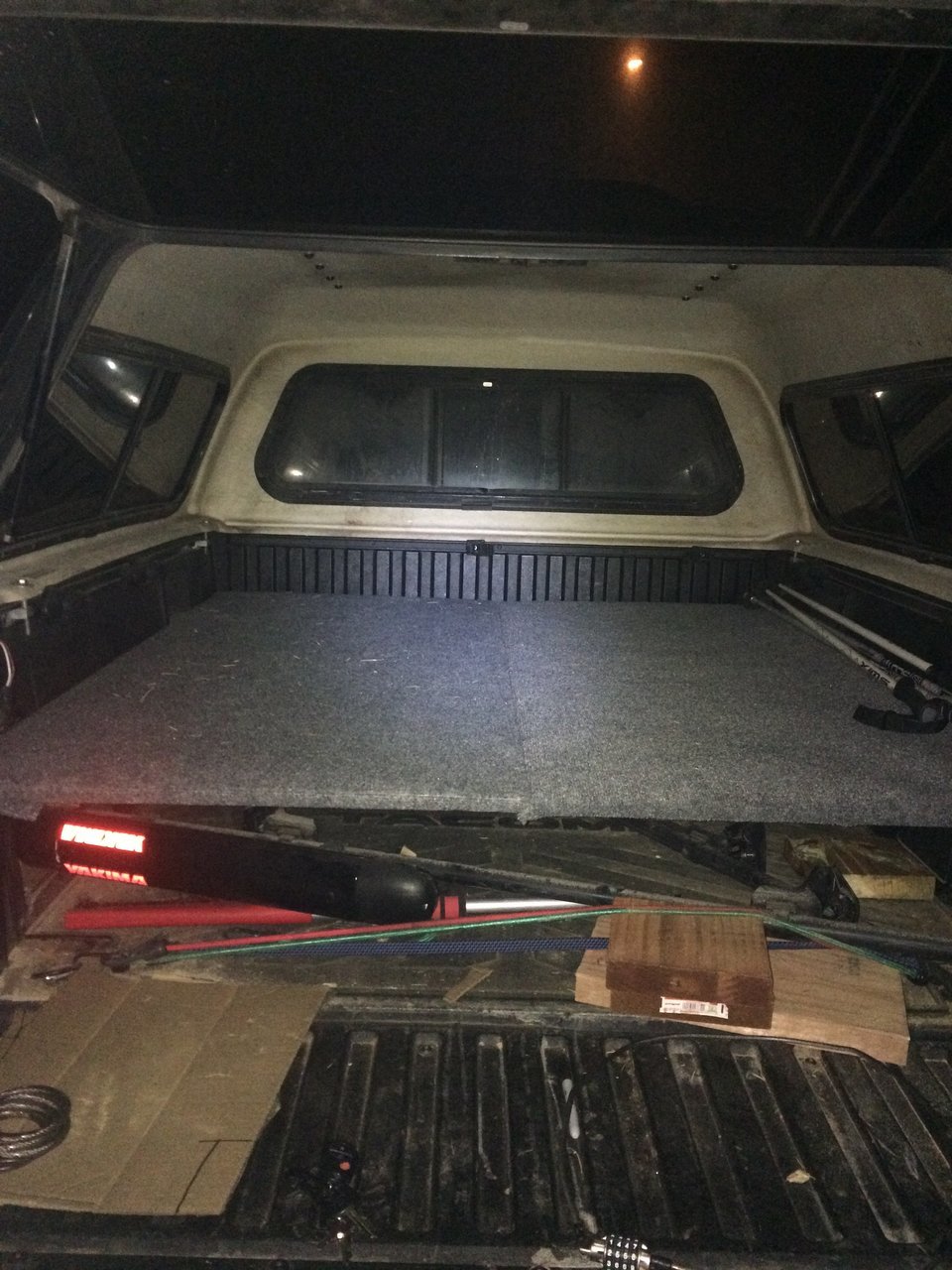

    Put this together tonight really simple 2x8 and ply covered in some cheap carpet from Home Depot I wish I had a 6ft bed but this works fine diagonal 223637A4-2763-4EC2-BDAE-5841A417FDF2.jpg
