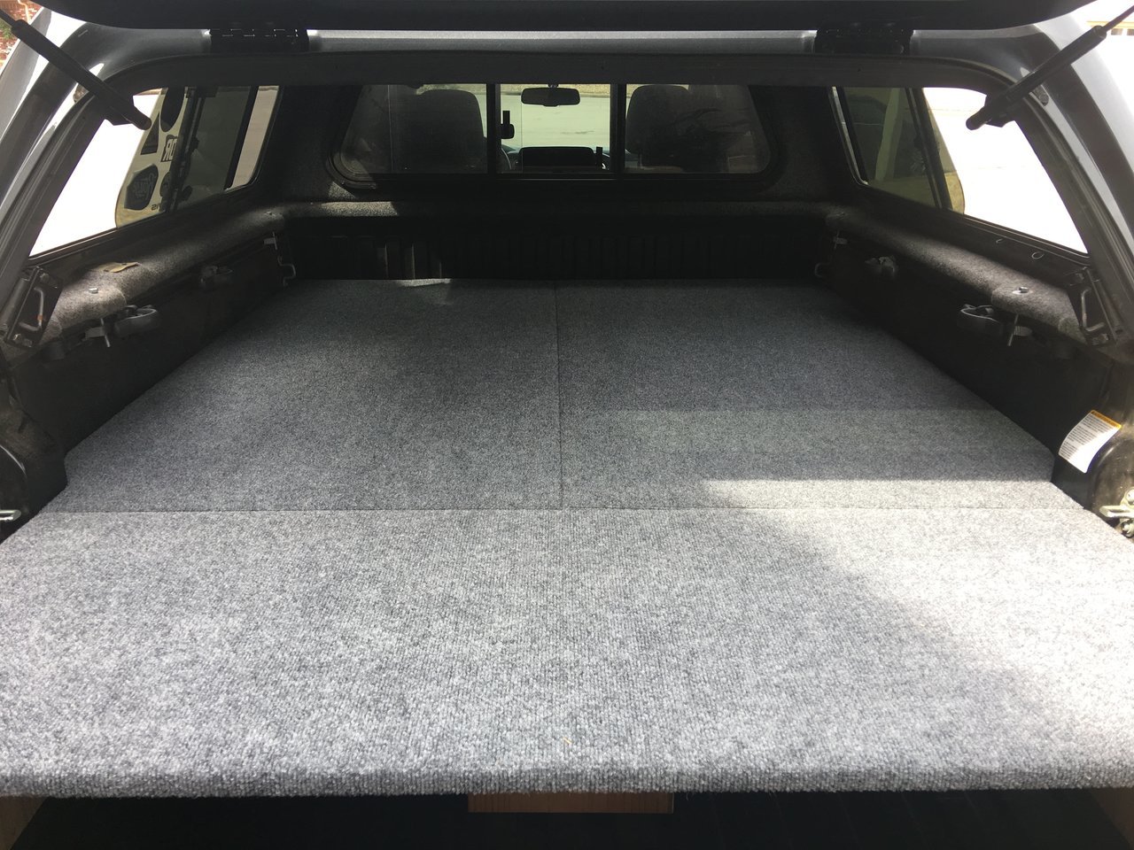

    After getting my wood cuts within an 1/8-1/4”, the carpet created the perfect fit. Happy with it, for sure.

    Did you take off about 1/4” for carpet? 1/8” per side? Trying to gauge how much room to leave

    1/8” per side would be perfect. This cheap carpet compresses really easily.

    I made my plywood as close to the exact dimensions as possible, then used force to push the wood down in place. There is 0 wiggle as I drive.

    Same. I cut the platform to 57 total inches, but I am not the most exact person when ripping with a circular saw, so I figure blade loss was around 1/8”, if any at all. Definitely want it tight to push it down into place. No way mine is moving as I drive either.
