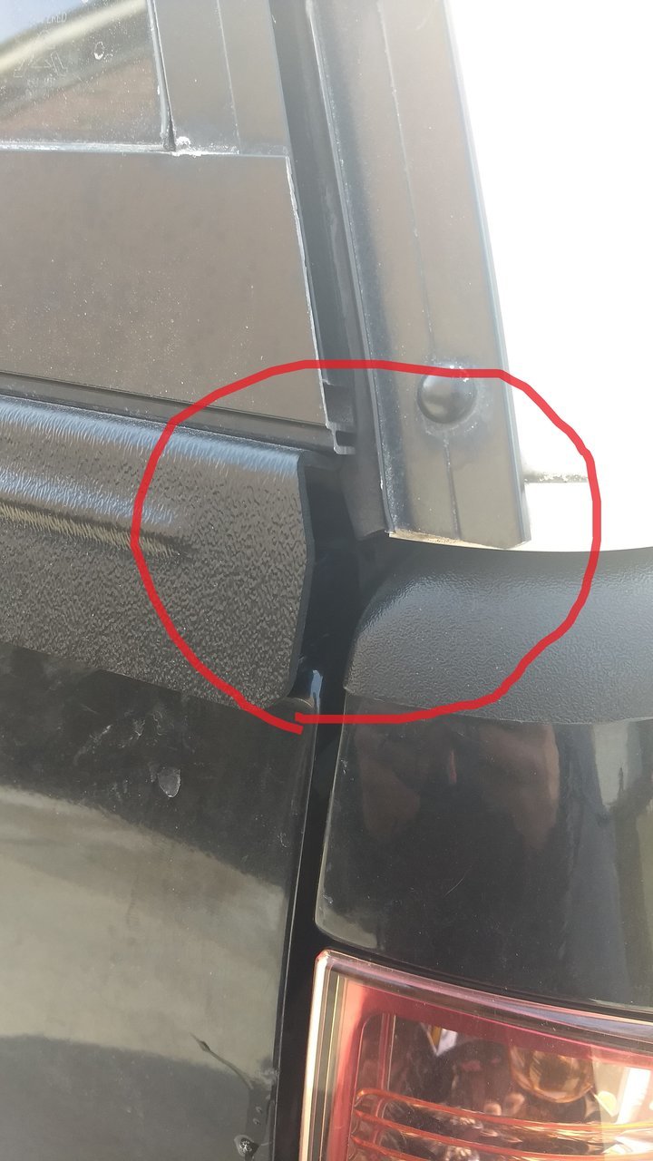

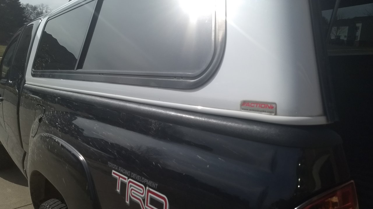

    Just picked up a shell for my truck. I noticed a few gaps in the shell, where light coming straight though and where water could easily get in. There is a decent gap in the front of the shell near the rear window. Do I need to remove the bed rail covers, so it would sit more flush? How would you recommend on filling the gaps, what type of seals/weatherstrip? The cap is only two years old and was off the same year truck as mine.

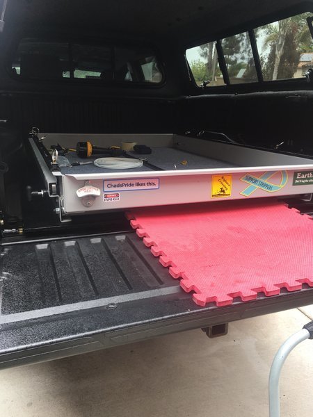

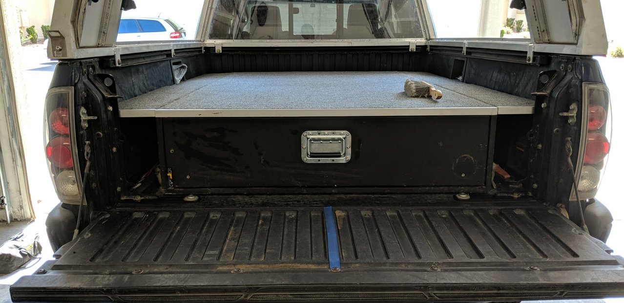

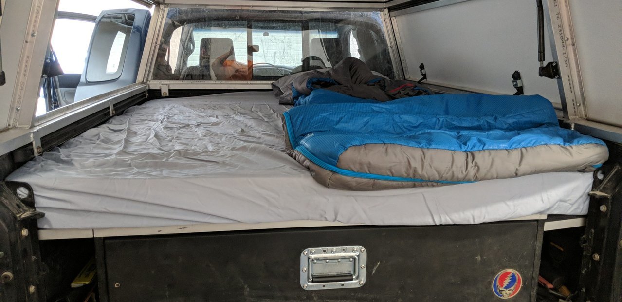

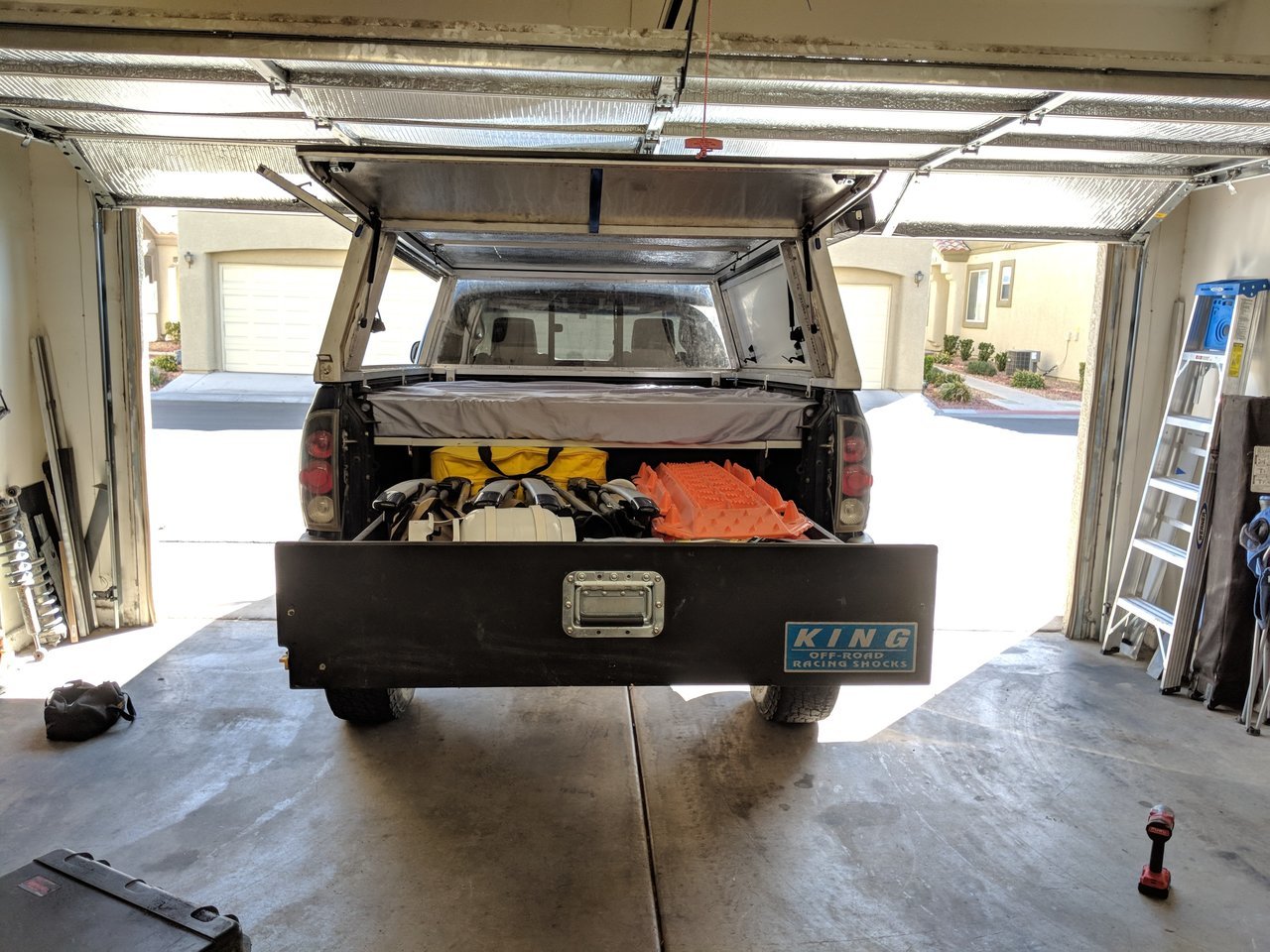

    Reclaimed my buddy's old drawer. Needed a few repairs. Full length drawer at about 65-66"x39ish"(interior demensions)on 60" drawer slides. Plywood construction with bedliner coating and carpet on top. Got a custom 4" foam mattress that is about 5" short of a Full mattress. I use a full fitted sheet and just use the elastic to take up the slack.
    Have only slept one night on it and it was pouring rain and 45 degrees. Slept like a baby.

    In your first picture, some gap seems to be common on most caps I've seen. It'll allow dust in but water doesn't seem to be an issue. But looking at that and your last picture your cap also appears to be missing the rubber flap or gasket that goes between the black hard plastic flap and the truck. It's probably like one of the "Door Seal" styles listed on this page: http://www.truckoutfittersplus.com/store/topper_parts_topper_door_accessories.htm (No affiliation with them, just the first page where I found a picture).

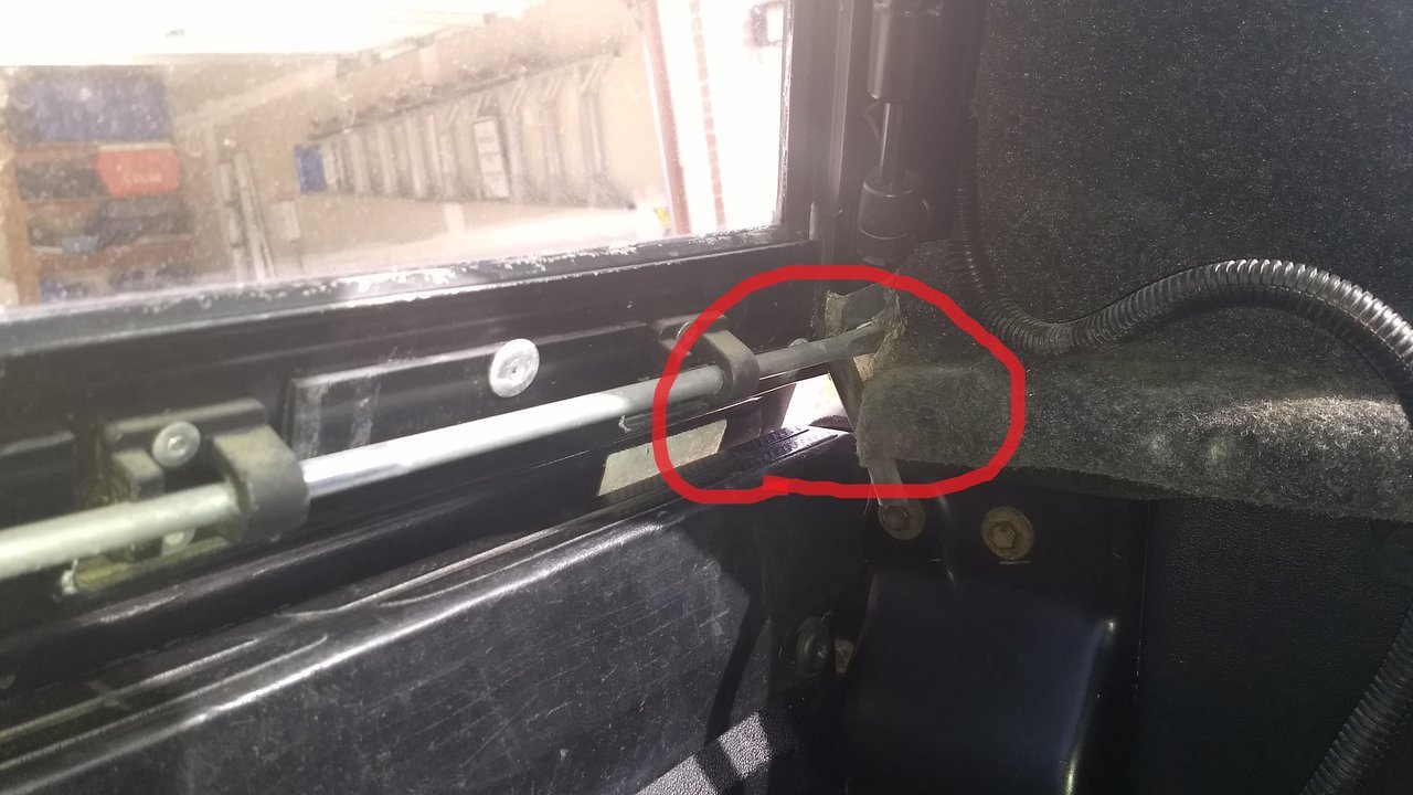

    In the second photo that cap is sitting on the bed rail, not overlapping like some designs so you need to make sure that your seal is good all around, thicker in the front as mentioned, or you will get water leaks.

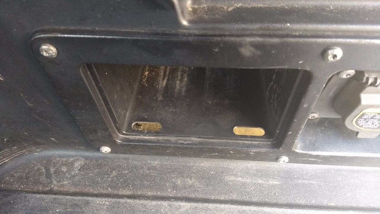

    In the third picture of the cubby, I used a piece of rubber (an old bike innertube) and contact cement to make a loose fitting patch. By making it just a little loose you can still easily put the door tabs in their slots and still have a seal. I didn't worry about the top slot for the latches.

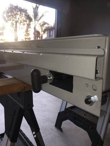

    I have a drawer that I had a spring pin welded on. The latch that came with the drawer only locked it closed which was a PITA. Here's a couple pics.
