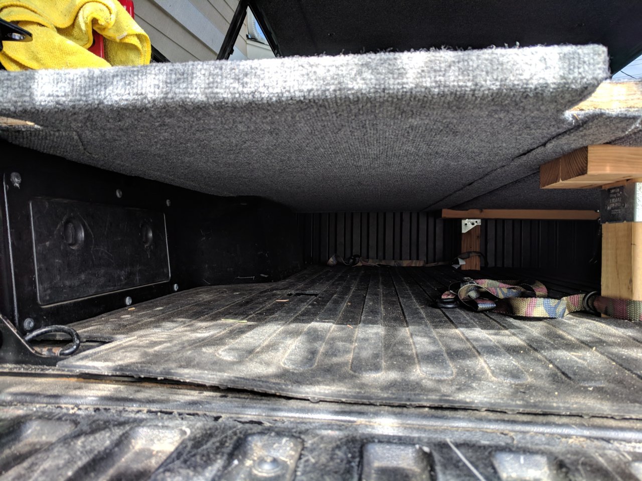

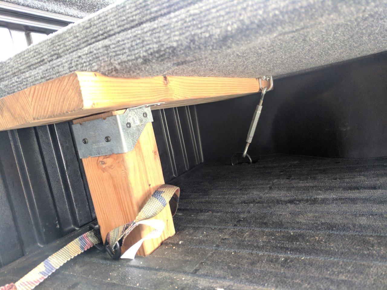

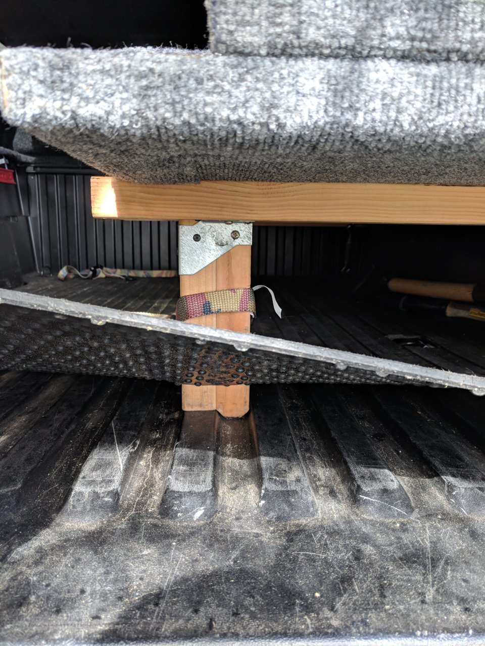

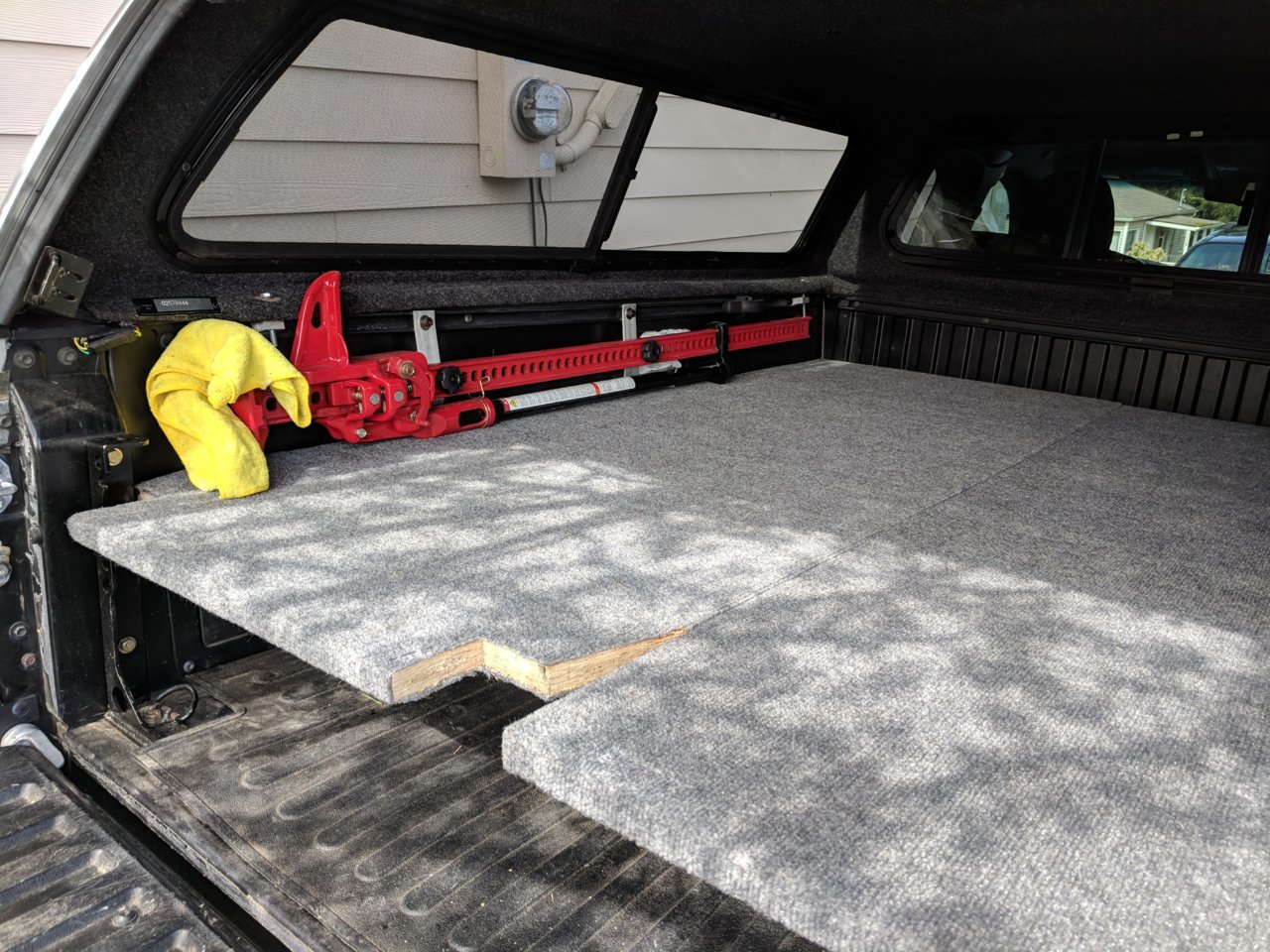

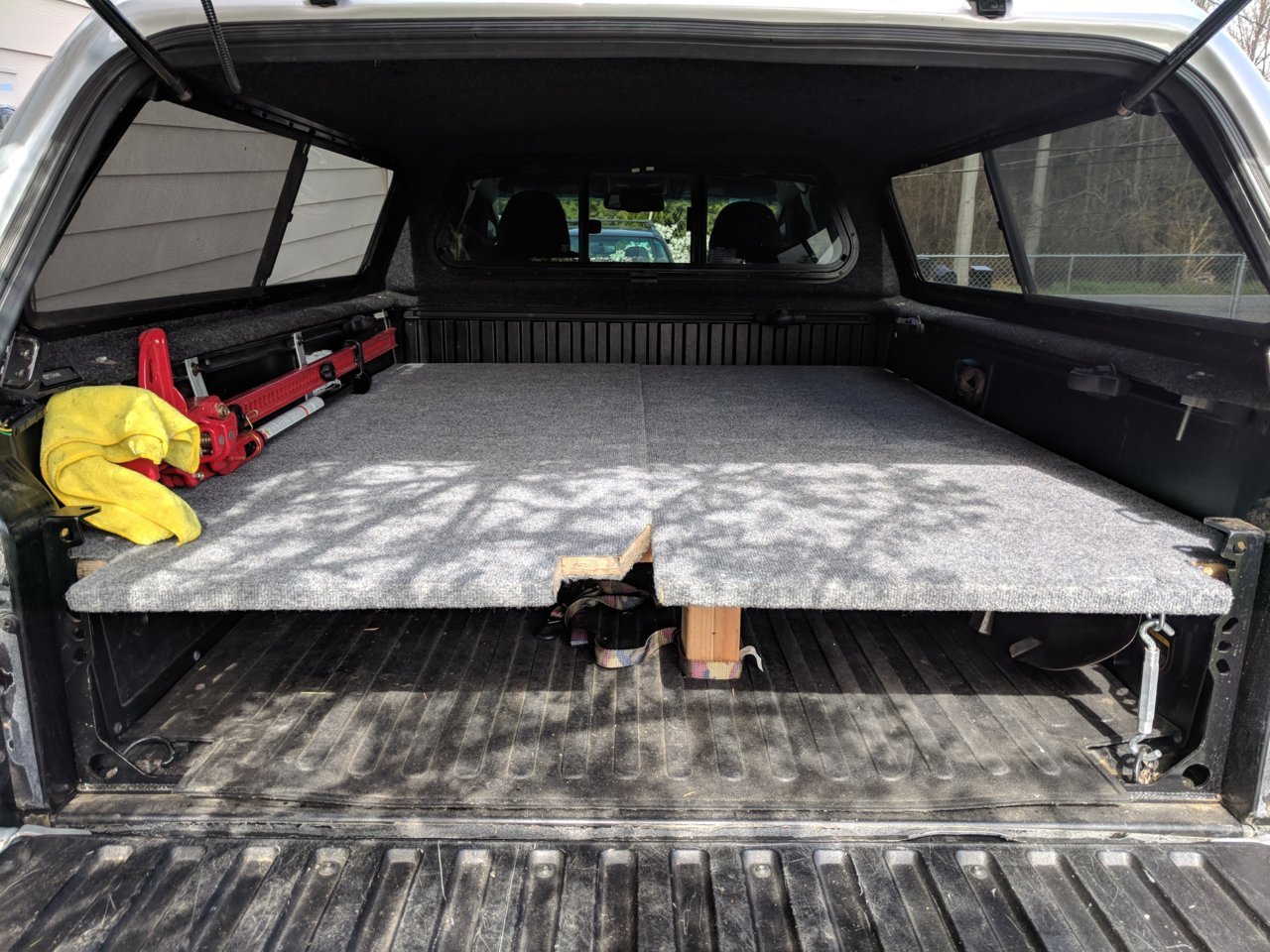

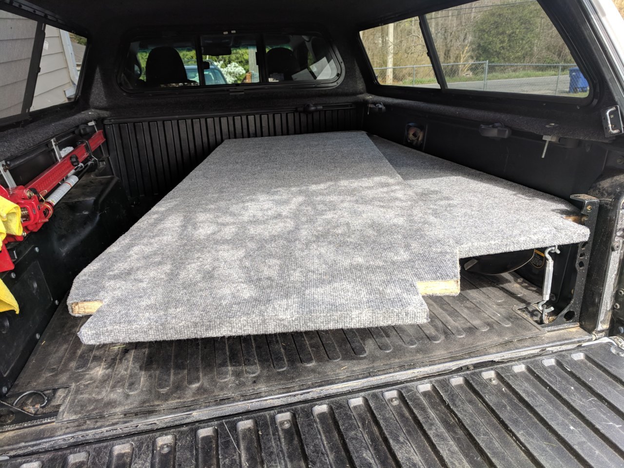

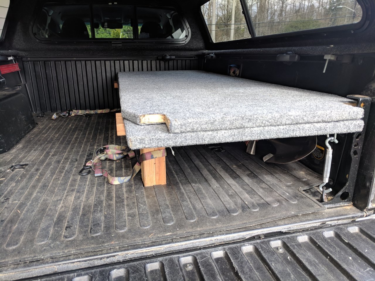

    Here are some pictures
    IMG_20180328_131627.jpg IMG_20180328_131651.jpg IMG_20180328_131716.jpg IMG_20180328_131819.jpg IMG_20180328_132103.jpg IMG_20180328_132057.jpg IMG_20180328_132112.jpg
    wbelac, thatzachguy_, Orco59 and 11 others like this.

    Thanks! I like the ease of switching from single to double bed, and looks easy enough to remove the setup quick which is what I'm looking to do.

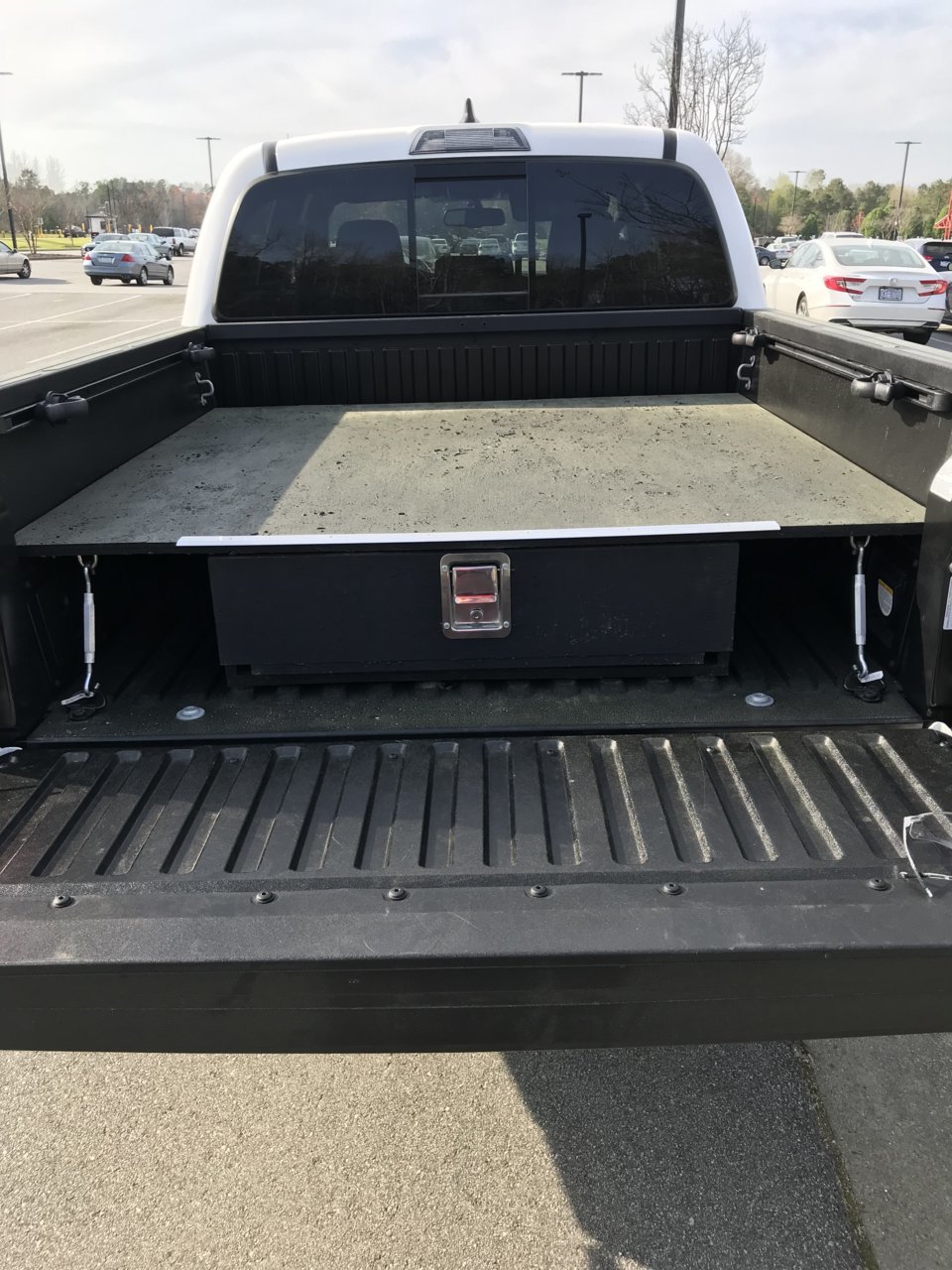

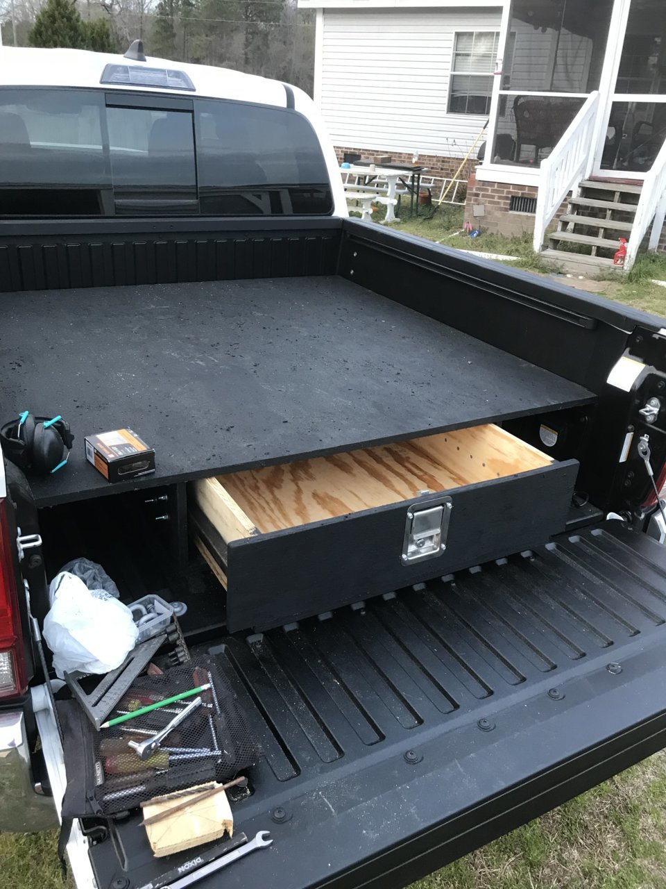

    6160C033-574B-48FC-BB3D-0B6AD27C5164.jpg Inspired by some of the skate bearing designs up here. Got to this point today. Almost finished. Just need to add a striker plate for the latch.
    Jobr, kimo, fs007 and 10 others like this.

    are you putting a cap on your truck? Ive been trying to figure out a way to build a drawer system thats water resistant if I don't have a cap on the truck...

    Interested in this as well. I'd be more inclined to build one if I could comfortably leave it exposed in the bed full time.

    Yes it is going to be mostly exposed. I am adding a bed-rack and RTT. I painted the top, case, and drawer face with Dupli-color: Bed Armor for weather-proofing. The drawer itself is currently coated with a spray-on clear polyurethane sealant. I have also added a section of tapered aluminum for the drawer opening to help shed water from around the drawers lip which I will provide pictures of when I get out of work this evening. These counter-measures should prevent the unit from absorbing too much moisture and the bed drain holes should take care of any standing water. This is yet to be proven but I will provide updates to its durability. I`m sure its not going to be completely water-tight. When I work up the nerve I will give it a spray down, see where any issues arise and address them.

    Hi Maximilan, are those panels 2"x6"s? No trouble supporting weight in the middle?

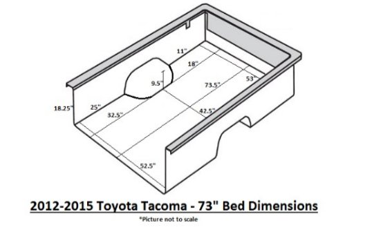

    Just posted this in a different thread, but figured it'd be useful here too. Pretty sure the dimensions are the same for all 2nd Gen longbeds, not just '12-'15.

    The width at the top of the bed is wider than at the bottom of the bed.

    So having literally just measured my bed for building a new sleeping platform, there are a couple things wrong here (source 2014 DCLB):
    1) Length on the inside and still close the tailgate is 73.25"
    2) Width between the wheel wells is 42 5/8"
    3) Height to the top of the wheel wells and the rail tops is 9"
    Edit to expand on #3: the 9" measurement is from the top of the runners in the bottom of the bed. Add 3/8" if you are going up from the true bottom of the bed.

    Right on. I took those measurements just for rough numbers on a project a little over a year ago. I couldn't find any kind of specs/measurements diagram for the bed, so figured it'd be useful to other people here too. (although i can defintely see there being 1/8"-1/4" difference in some measurements)

    To expand on #3: the 9" measurement is from the top of the runners in the bottom of the bed. Add 3/8" if you are going up from the true bottom of the bed.
