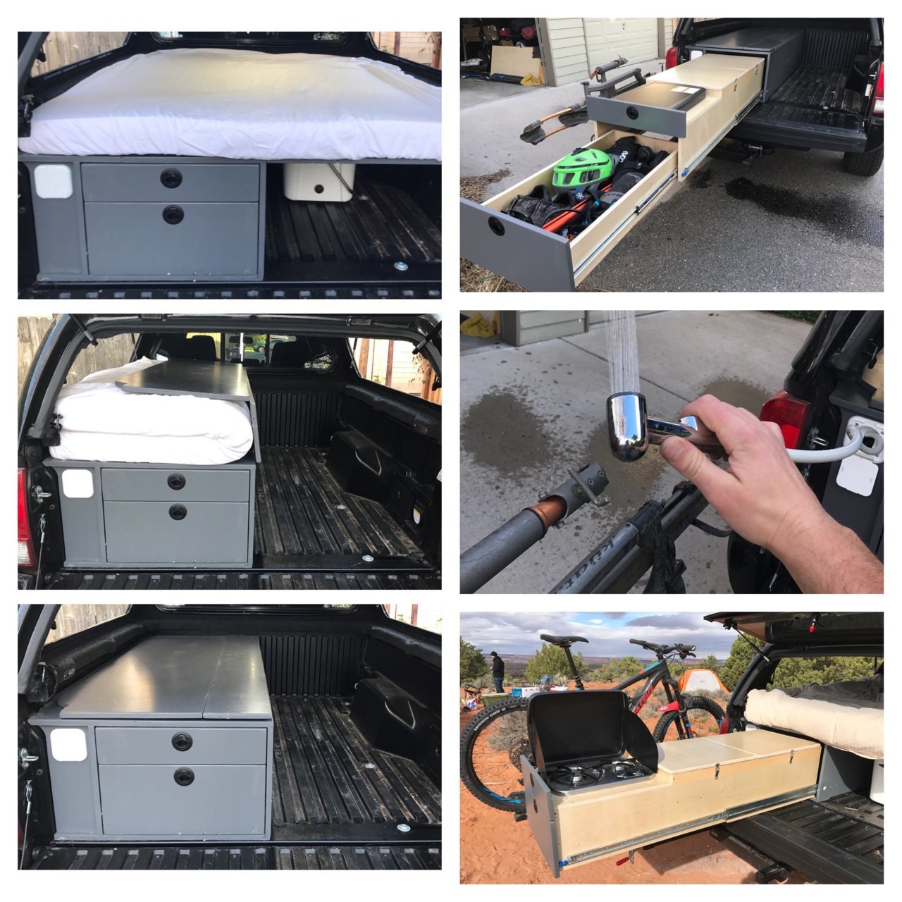

    I was debating the merits of the decked system with a buddy today and ended checking here to see what people thought of it... It looks super clean, but I definitely wish they had found a way to use more of the free space on either end of the wheel wells. Seems like there's some space up by the cab that's left unused. Also, after having different sleep/storage systems in other vehicles, I hate to permanently lose the height from the bed to the topper.
    I did a thread about it before (Kitchen/Shower/Drawer/Sleep System), but only using half the bed for drawer storage has been clutch for those times when I need to put something in the truck that's taller.

  10. Apr 27, 2018 at 9:16 AM
    #750
    Lux
    Lux @jamesgrouss
    Sep 15, 2014
    #138357
    2,881
    James
    NJ
    2001 tacoma sr5 4x4
    OME 3" lift 881 coils, Dakar's 33" General Grabber AT2's TG low profile front bumper
    That is an awesome and really clean setup, really nice work :thumbsup:
    faw3 likes this.

    Damn! Thats extremely clean! I would have totally built a unit like I had planned on, but being that my bed isn't water tight and I like to roll the sides up in the summer, the decked system really appealed to me because of the weather resistance. I had an OSB drawer before, and I was always paranoid that I didn't want to get it wet or that I couldn't set anything real heavy on top for long periods of time.

    Awesome setup m8, probably would have been better to put on other side to accommodate for taco lean. Unless that's not an issue for 3rd gen ?
  13. Apr 27, 2018 at 10:00 AM
    #753
    ryan5mith
    ryan5mith H1IWS
    Aug 14, 2015
    #161786
    141
    Costa Mesa, CA
    2012 PreRunner ACLB | MGM
    Wow, thats clean af! Almost looks like its made of sheet metal, like a filing cabinet. Love how you can still use one side of the bed too.

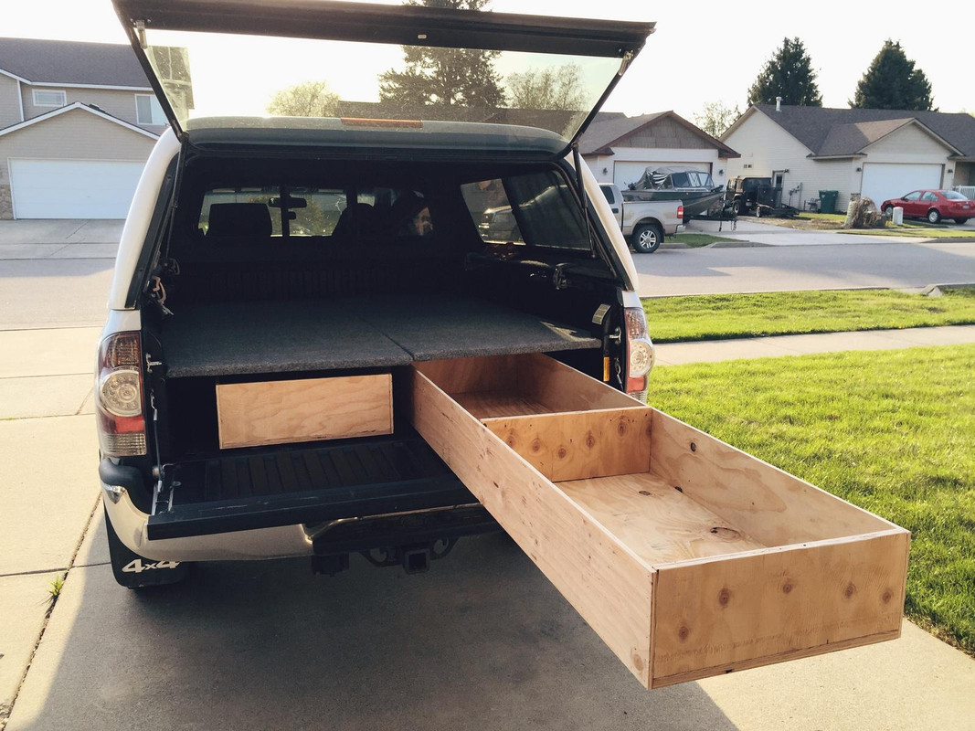

    Finally found a decent deal on a canopy off CL, which in turn led to the creation of the platform + 6ft drawers. Offset center made for the ability to get a bit of extra sleeping space if solo and/or allow for taller stuff to be stored on the side. Might make a support leg(s) that sits flush with the underside of either drawer that slides in a bed liner slot, but as it sits now, I can easily access the full length of the drawer while it's still supported by the tailgate and a stop support by the platform crossmember. Also ordered a modular, trifold 4" memory foam mattress that should be here next week - looking forward to that.
    Stoked on it all so far. Now just for finishing touches ie drawer handles, lighting, and curtains.
