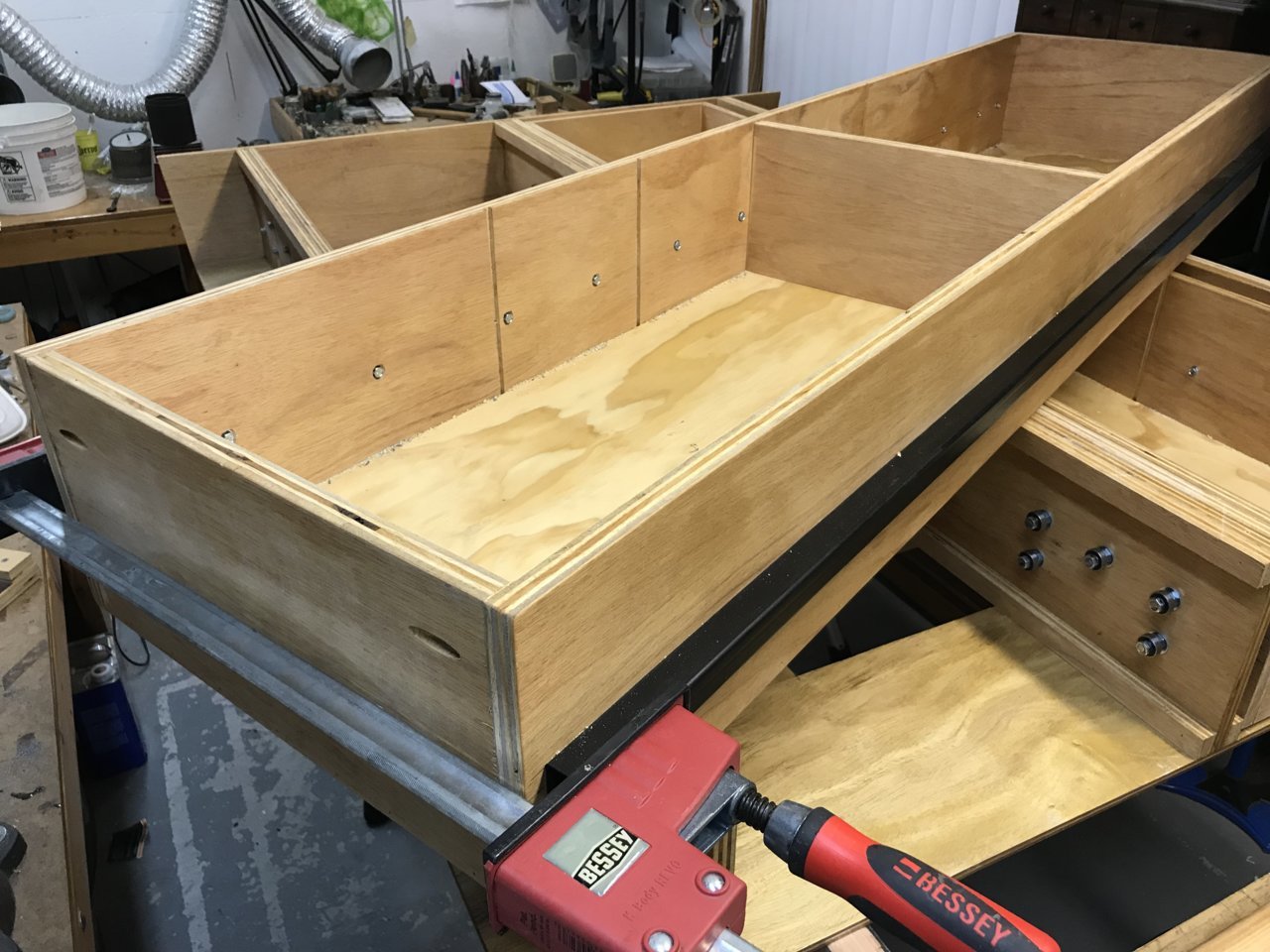

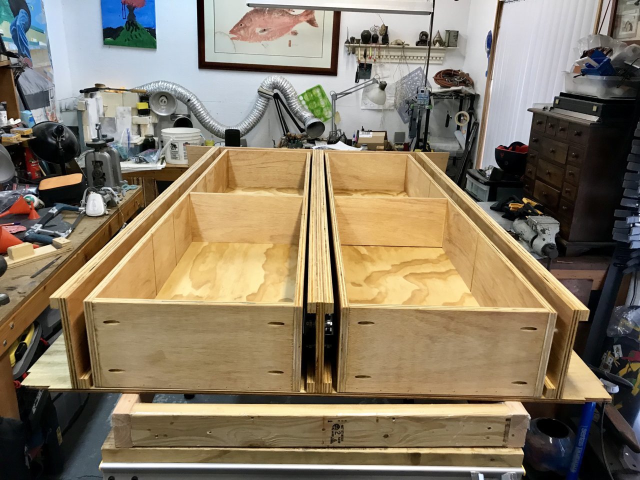

    @EatMeImATaco how much space did you leave between the bottom of the drawer and the bottom sheet? 1/4” I want to do an 1/8th but I’m afraid of some sagging

    I only left myself with 3/8ths to work with. Hope that wasn’t to overly optimistic. Seems like it will be fine.

    It was an eyeball estimate but roughly 1/8". I laid the tube on my template where it would sit in the final position and set the bearings tight to both sides then just slid them out by a hair. I used 3/4" plywood for everything but the base so I'm not really worried about sag and if it does, it gives me an excuse to design and build v.3 :thumbsup:

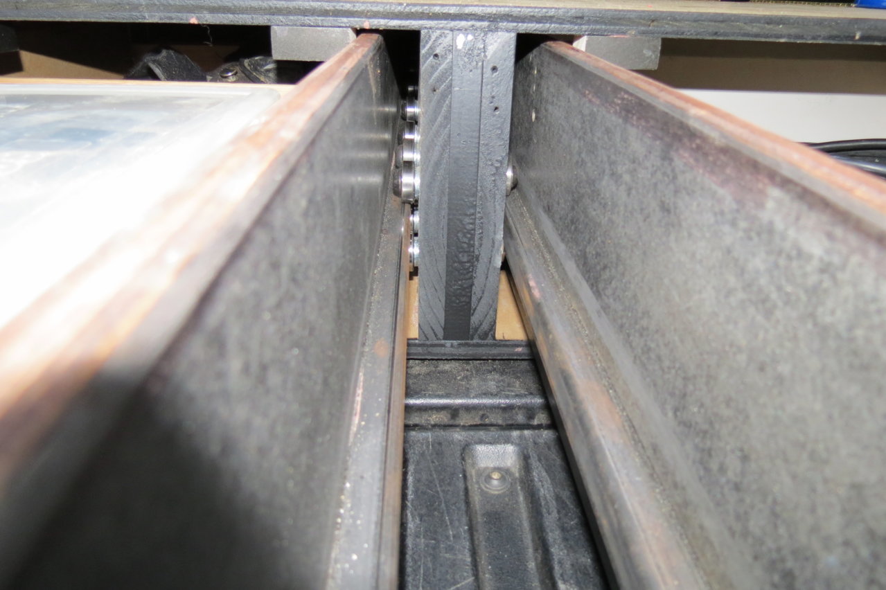

    On my build I ran a dado about 3/8 deep down drawer sides and glued & clamped steel tubes with 3M 5200, - mainly because I couldn't figure out a way to attach the tubing without drilling through inside of drawers. Its held up fine after over 12 months of abuse. Wish I'd made the tolerances tighter cause they're a little slack.

    maybe you can see here

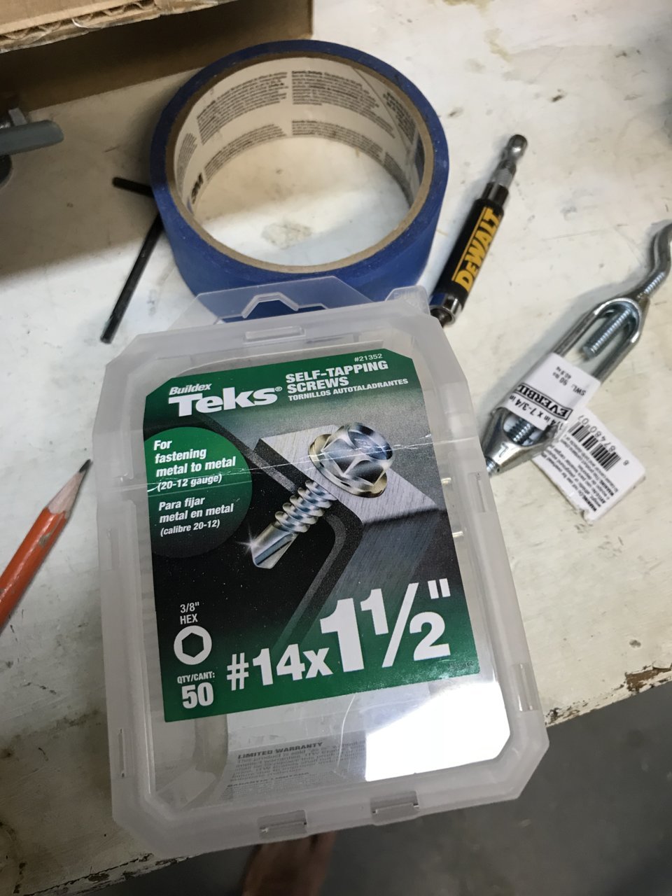

    I just finished attaching my rails tonight. Drilling through didn’t bother me too much. I used these self tappers and they bite hard!!
    ogdog[QUOTED] likes this.

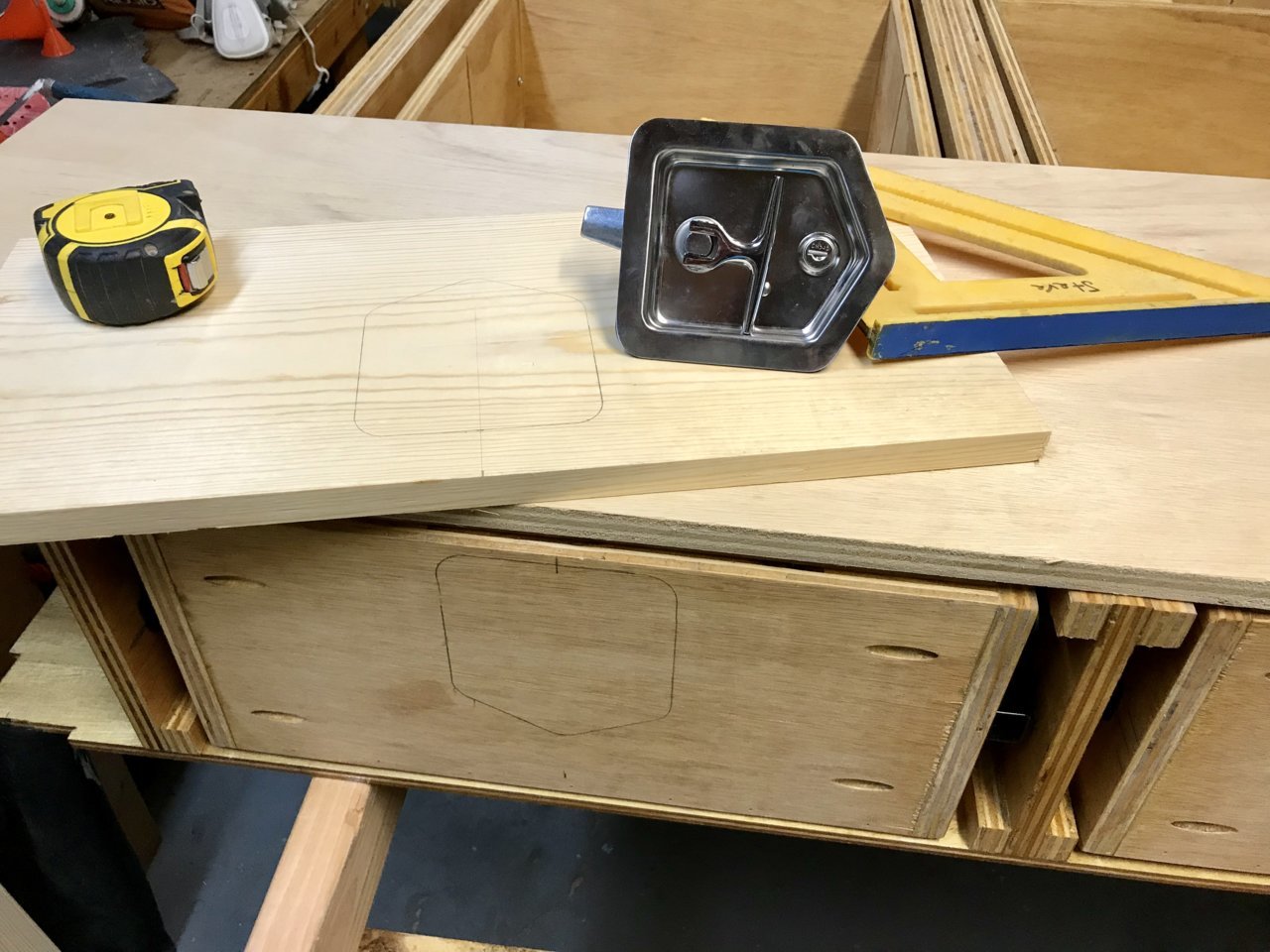

    Now, figure how to mount this thing. Going to have to alter it a bit. Best choice I could find though that was lockable.
    30k+ truck and the tailgate doesn’t lock. Boo hoo

    Do what I did and just get a locking latch from Pop-Lock, you can get them keyed to your ignition key too.

    I might have to do that!! Thanks. Wish we could have something that worked off the fob. I wonder who has hacked a 3rd gen gate lock?

    Pop and lock makes one that works off the fob. I have one on my ‘13
