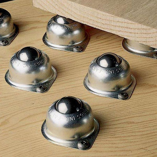

    How many bearings do you estimate that you used per side? I'm considering doing this, and found a 100 pack of skate bearings for something like $25 on Amazon but it seems like that would be overkill, lol.

    edit: maybe not. I swore I read that in here, but I can't find it anymore.
    I think he mentioned earlier in the thread that he used all 100 bearings

    theres no such thing as overkill, the more bearings the better, I used 100 bearings (same ones you're referring to I believe) for about a 5' long drawer and its not enough. I need more near the end to hold the weight when its pulled out, If I was to do it again Id probably close the gap between the bearings as I got closer to the edge so like: [ . . . . . ..]
    edit: if you're only doing 1 drawer its more than enough :D

    I'm planning on putting a few on the back side of the drawer itself, so that they can take some of the weight as you get closer to the end of the run. But I'll plan on using them all.

    Possibly. I'm not quite sure how much bearings run each. With 4 of these you could hold 300 lbs in one drawer for $14. I haven't worked out the design completely but I would have these on the bottom of the drawer. Might be an easier install...

    Yes, I used all 100 bearings. Honestly I might even add more. I have a lot of weight in the drawers though. My spacing was fairly tight as well.

    I'd be concerned about the running surface holding up to that sort of weight. The bearings themselves could probably handle it, but probably not the wood they were running on.

    Good point. Maybe run some thin sheet metal on the bottom...

    And the top, where the weight of the drawer pushes the drawer end UP.

    There would be some pressure on the top depending on how loaded they were. Possibly some wood rails would support it slightly above the drawer on each side.
