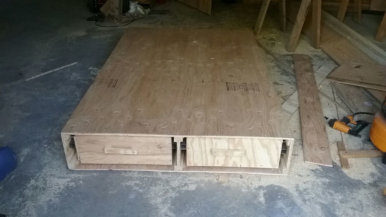

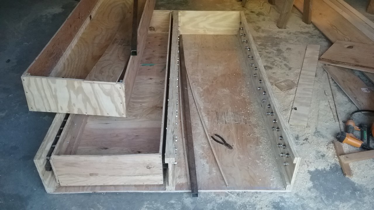

    Update on mine. I also used the skate bearing approach. Glued & screwed the boxes and the lower parts of the frame but the top sheet is just screwed on for now since this is just version 1.0 and I wanted to make sure it didn't need revision before I glued the top cap on. Same reason it's not sanded, painted, or carpeted, and there's no faces on the drawers.
    Worked well this past weekend, but I want to add a slideout piece to one of the drawers for a platform for my camp stove, and add some means of dividing the drawers into smaller cubbies so all my gear doesn't slide to the front when I brake (because then when I open the drawers it's at the back :laugh: )
    I also need to add folding 'wings' to either side that will rest on the bed wall cutouts and wheel wells when they're folded out, so I've got a level surface all the way across.
    I married my tacoma and bmgreene like this.

    The importance of the glue depends a lot on the configuration you're using. For a simple crossbeam/deck setup using 1x6 or 2x6 set into the notches on the sides of the bed, then just screwing the plywood deck to those beams should be sufficient. If you're constructing boxes, then you'll want to have the edges glued at least (I doweled mine as well for extra lateral rigidity/strength). If your vertical elements are solid wood, then screwing into the edges would be fairly strong, or decent strength could be obtained using pocket joints in hardwood or BCX plywood, but access on one side will probably be an issue if you're making a closed box. I wouldn't trust joints consisting of only screws into the edge of any kind of ply, though.
    MolonLabeTaco likes this.

    Looks good. If you're looking to overdo the divider system a bit, you could consider bolting in some E-track rails. They're low profile and create a very flexible set of options for installing dividers or lashing points when and where you need one.
    Noelie84[QUOTED] likes this.

    Thanks. I'll have to look into those; right now I'm basically planning on gluing plywood laths on the insides of the boxes that I can then put a divider between (mostly because it would make good use of the abundant scrap cuts of plywood I've currently got kicking around :laugh:
    bmgreene[QUOTED] likes this.

    I can understand that urge. I used the skate bearing/square tubing system and used well over 100 of the bearings (probably around 150) and some heavy-duty tubing, and to secure the tubing to the boxes I used long self-tappers with washers underneath them to help resist pull-through on the plywood.
    All of my camping gear I'll be storing in there combined probably weighs 250lbs. :laugh:

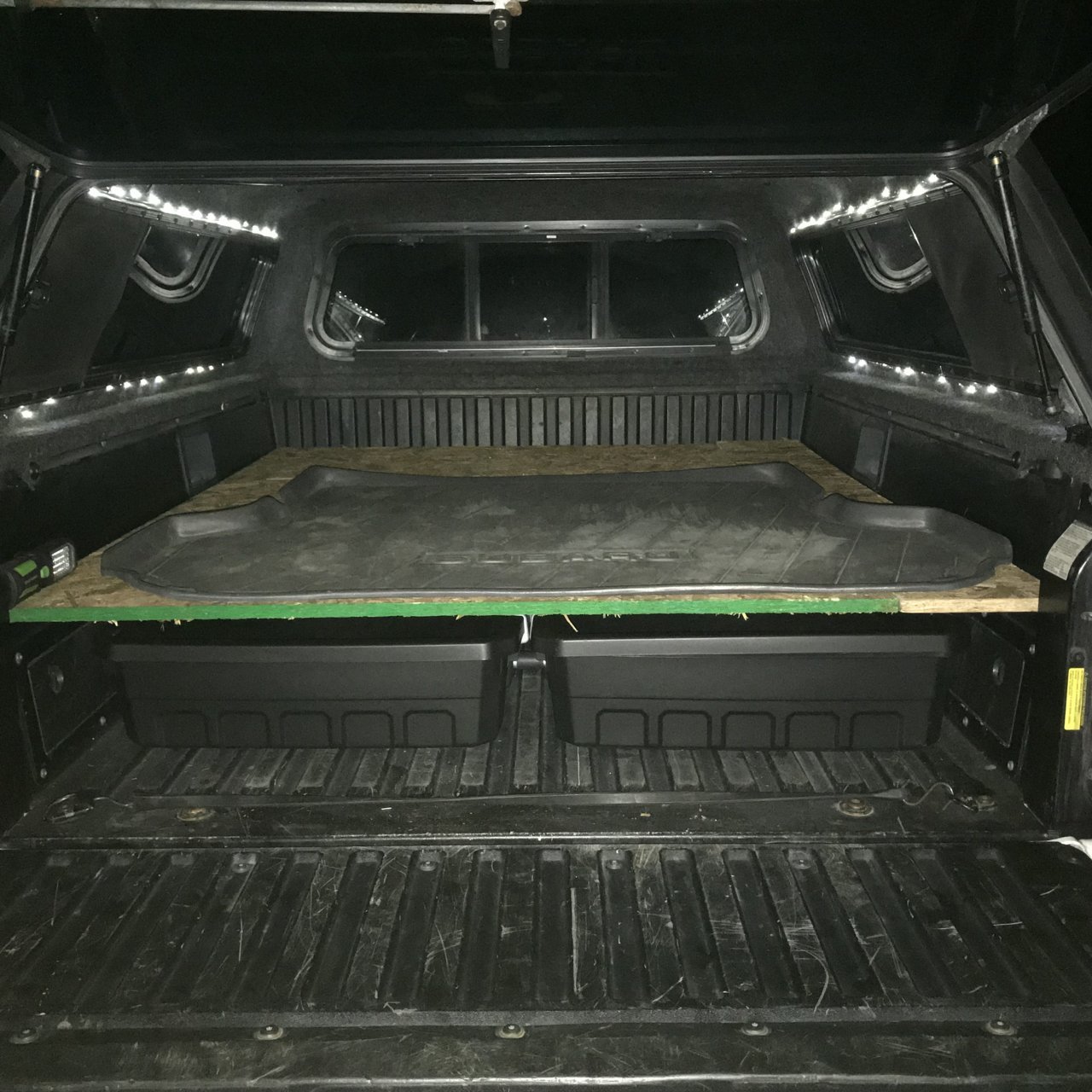

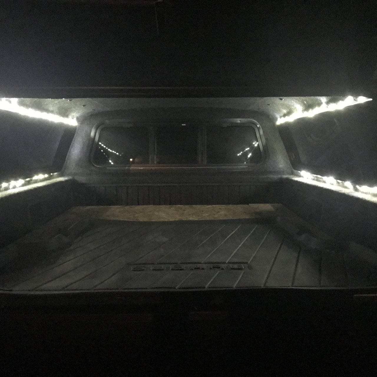

    thanks for the previous posts/photos all helped me complete my build F925F597-39E1-423D-B6EF-DA41832C9DCD.jpgE921F0CF-C591-4B8F-9469-5774E5FC32CB.jpg

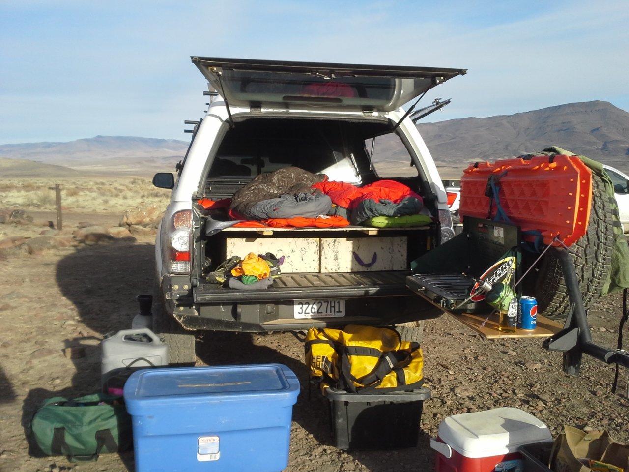

    DSCF4578.jpg not the best but has been working for years now and I can take it out 5.
