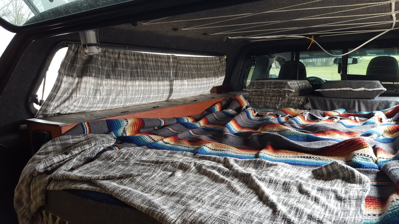

    I'm in the process of making curtains out of the sun reflective stuff we use for windshields but regular Curtains look awesome hmm

    They are super easy, nice that that can be bunched up to allow access to cabinets from the windoors. I just took bungee cords and snipped the hooks off then took adjustable metal hose clamps and clamped a nail i bent into a hook with a vice onto either end. Drilled small holes into the top of the window frame for the nails to hook into. the bottom of the curtain is sewn into a loop and I just took a piece of skinny PVC to keep it weighed down and it fits snug between the cabinets and the truck bed wall. You could just use bungee on the bottom though.

    That was my theory too for using the reflective stuff it would cut a tad bit of noise out and black out my truck. Like yours also mine is carpeted so was thinking the same thing put Velcro on it then when i didn't want them up take them off and slide then under my bed. I do like the idea of putting a thin design on it, would it block the sun out the same? As far as temperature wise

    We used 'blackout material', from a fabric store, and Velcro to adhere to the carpet lining.
