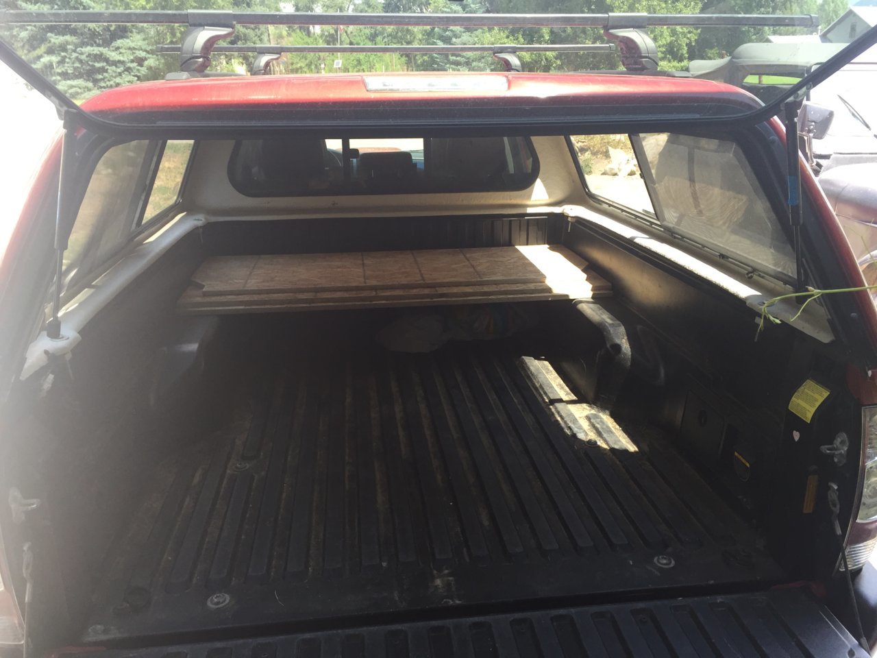

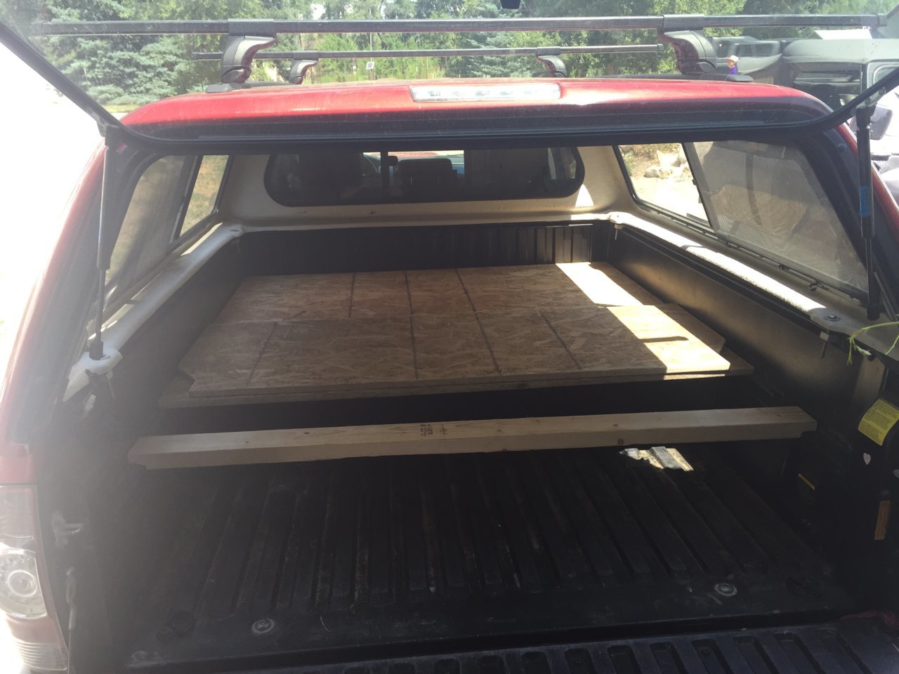

    I went ahead and built the idea i posted about a while ago. I think it came out pretty great. There are 3 sections cut across the bed. The 2 on the ends have supports, but the middle one just rests on the wheel wells. I used a beefy 3/4 inch OSB. It is really rigid and doesn't feel like it bends even if you are in the middle of that span. I like the simplicity of the storage underneath.
    The best part of this setup is how versatile it is. Not only is it easy to take in and out, but it stores really nicely in the front of the bed so you can use most of your bed and still have it ready to deploy.
    Im considering drilling some holes in the back of the pieces to make them easier to grab and move around. Im also wondering what would be best to finish them off. Im thinking about just staining them. Maybe paint? or carpet?
    My next project is building shelves using the ends of the bolts on the roof rack. Any ideas?

    The idea of stained OSB makes my skin crawl, but that's probably all of the fine woodworkers in my family... Under a hard top, there probably isn't much need to seal the material, but a couple coats of poly wouldn't hurt any, either. Cheap carpet/astroturf laid down with 3M "77" spray adhesive and staples will help heavy stuff slide in and out a little better without causing so much slip that things will shift a lot and also provides some protection against abrasion on whatever sealing you do use; I'm pretty happy with the outdoor "RV Rug" I got at HD since it's easy to trim with a utility razor and was under $20 for 48 sq ft.
    Shelves using those bolt tails shouldn't be too hard, just some boxes drilled through the top to allow for some nylon lock nuts to install them onto the threading, maybe use some kind of bungee along the open side to retain stuff (similar to galley shelves on a boat/RV) if you don't want to go with a full door closure. If the stuff you plan to put up there is generally lightweight, a cheap nylon "gear hammock" might be a simpler way to go. Just install some light-duty tie down rings on a couple of those bolts and you can clip the hammock in and out with a quick-link or caribener.
    dtoll12 likes this.

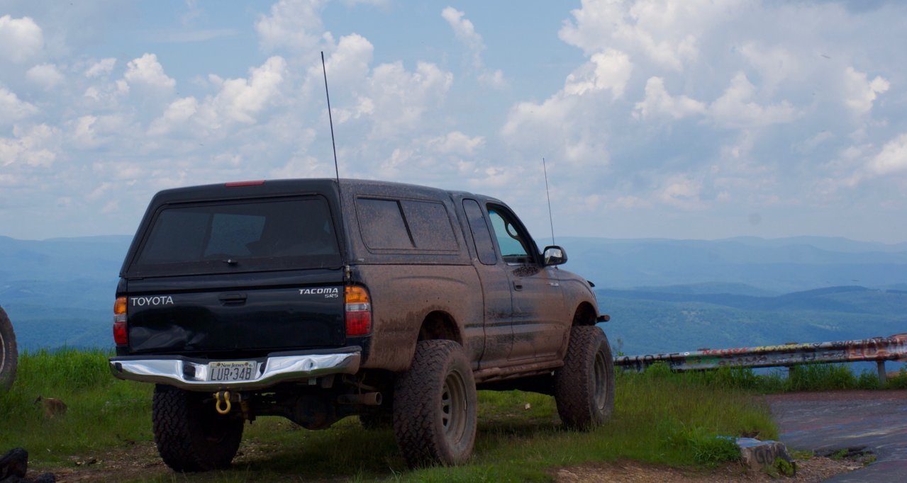

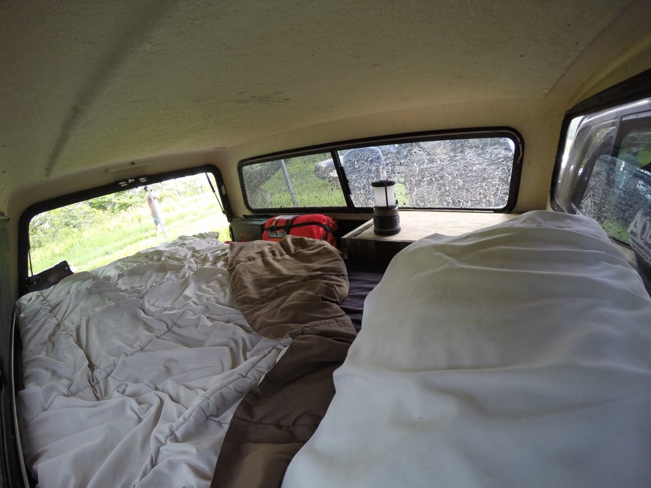

    Never posted pics from my trip, maiden voyage. Worked great, could use a dehumidifier though :D maybe next time Ill put a bucket of ice in there or something. Had to put the spare in my back seat. I kinda like it there though, didnt move at all.

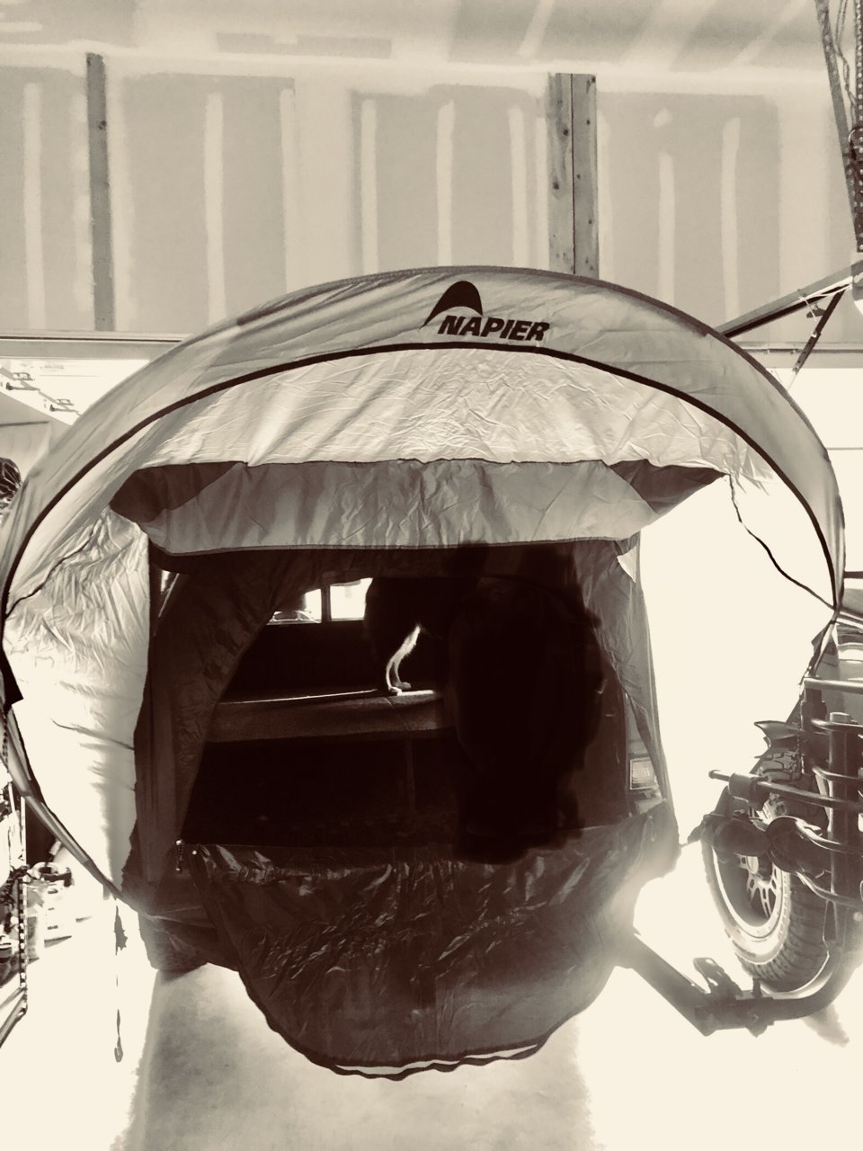

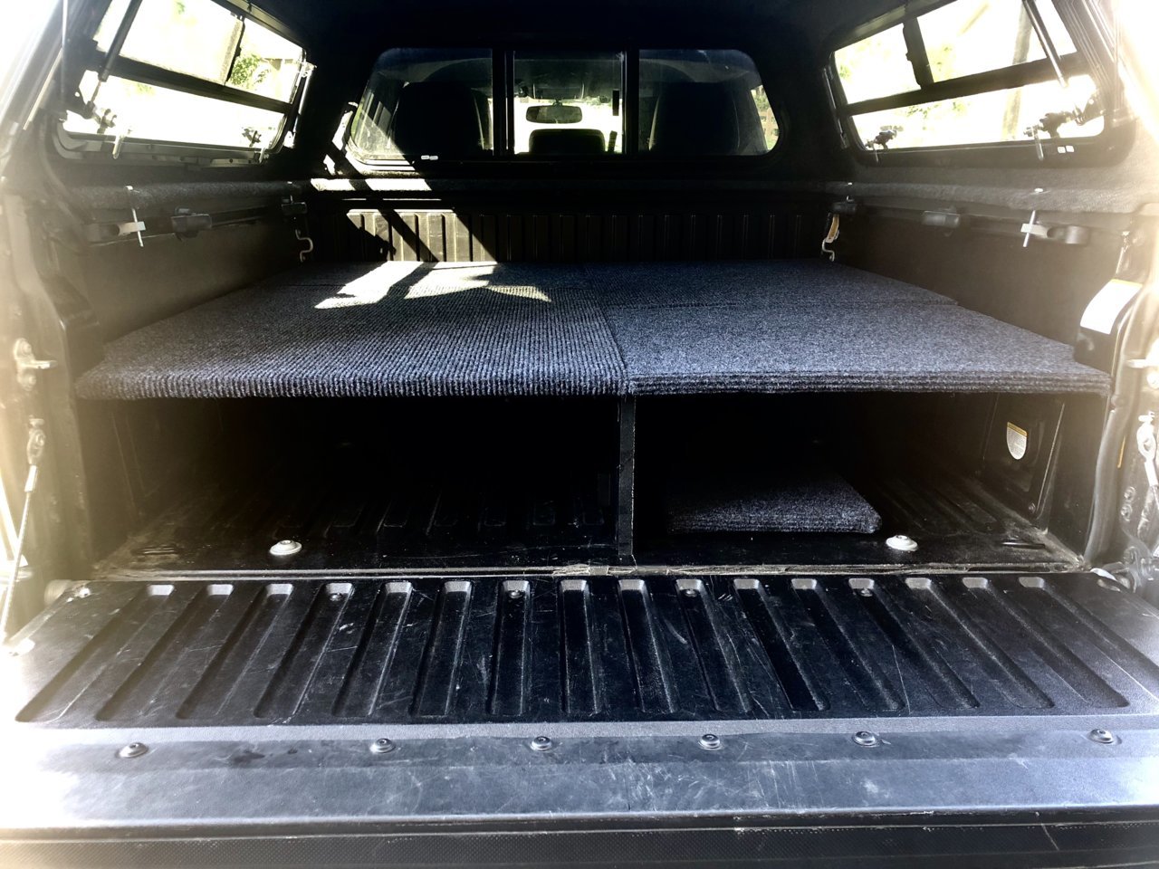

  14. Jul 17, 2018 at 6:03 AM
    #1034
    localflow
    localflow Member
    Oct 1, 2017
    #231669
    15
    2017 TRD Pro
  15. Jul 17, 2018 at 1:11 PM
    #1035
    azhiaziam
    azhiaziam Well-Known Member
    Feb 8, 2014
    #122554
    3,174
    The reef ca
    White 2023 trd off-road
    that's awesome man i just bought the napier 8400 i believe the bigger one than that found it on cl never used for 200

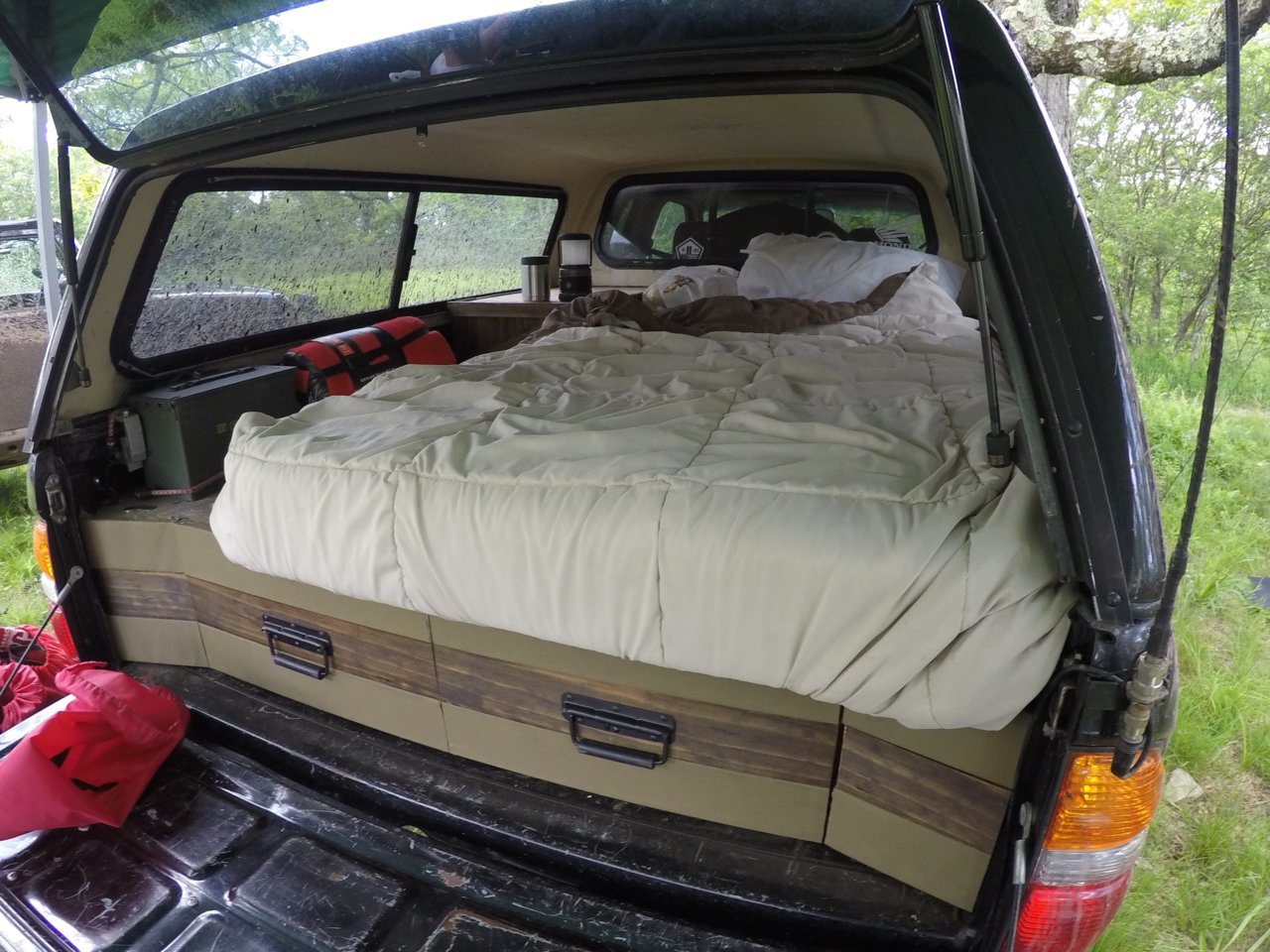

    I might be using my sleeping platform for some quick jaunts up to the mountains over the next few months. I doubt I'll get stuck or get a flat but I wanted to take some tools just in case...are any of you able to fit a 33" spare, shovel, 60" hilift, and other stuff under your platforms? I'm having trouble picturing even my tire fitting under there without raising my platform further, decreasing my headroom :(

    Great idea, don't think I could make it work with mine unfortunately because I have a Pelfreybilt bumper with built-in receiver. I thought of beating the tabs down where the original spare went but that seems like it'll reduce my clearance a lot having a full spare under it.
