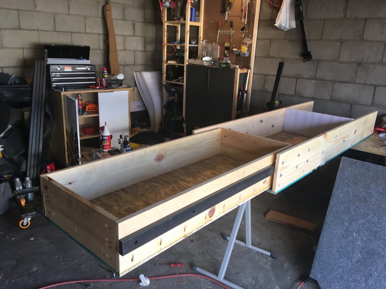

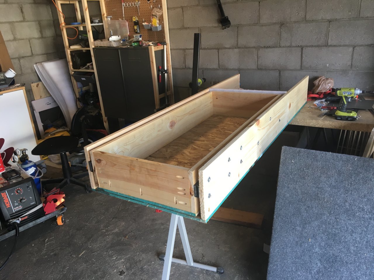

    with this type of operating system, why so many top bearings? I can understand a few to keep the drawer from tipping, but the previous picture of just the bearings installed against the carcass seem to indicate there's more afoot that I can fathom. thanks

    I mostly went off of others experiences. Having used this system now for a few months, I will say it works very well. The top bearings def support the rail as it slides out. My drawers are full of tools so they are quite heavy. Also I am in and out of them all day, so to have them smooth and easy to use is nice.

    You could probably do with an assymetric approach to spacing since very few are needed at the front end(cab) when at or nearly fully closed with progressively more needed the further out it extends until at max extension the bearings are adjacent. This goes for both top and bottom bearing spacings but not necessarily exactly the same since the bottom load is maxed at the opening but the top load might be a foot or so in from there wherever the back of the drawer is stopped. This would also be true of the rail attachments though they would be concentrated towards the cab end off the drawer.

    That’s basically what was done on mine and any Pask Makes style box. I actually added even more bearings on the bottom at the front.
    The biggest problem I see is the tolerance. Unless these are done with a cnc, most people are leaving a 1/4” of space in between. I went with 1/8”, and got lucky. You have to be incredibly careful even with a jig.

    1/4" between the drawer rail and bearings?
    I'm working through this now:
    I didn't leave any gap, the slide is a nice snug fit on the bearings currently.
    Sna and I married my tacoma like this.

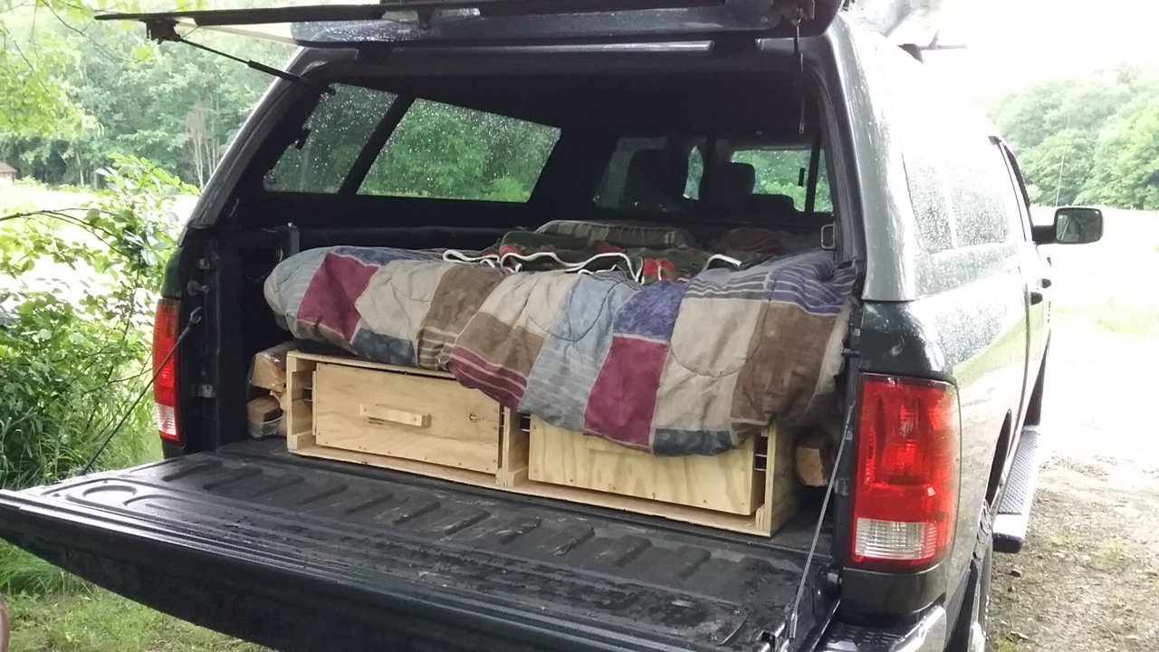

    I left 1/8 on mine when I built it, but on a humid or rainy day it was enough that they were sticking (you can see the rub mark on the left side of the left drawer). So I took the drawers apart and recut them to leave 1/4 instead. Seems to be working better so I'll probably paint everything, carpet the platform, and put a real face on the drawers instead of my current ghetto handles.
