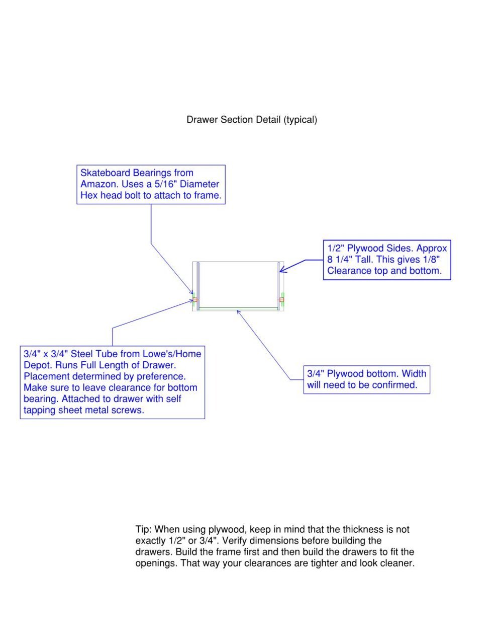

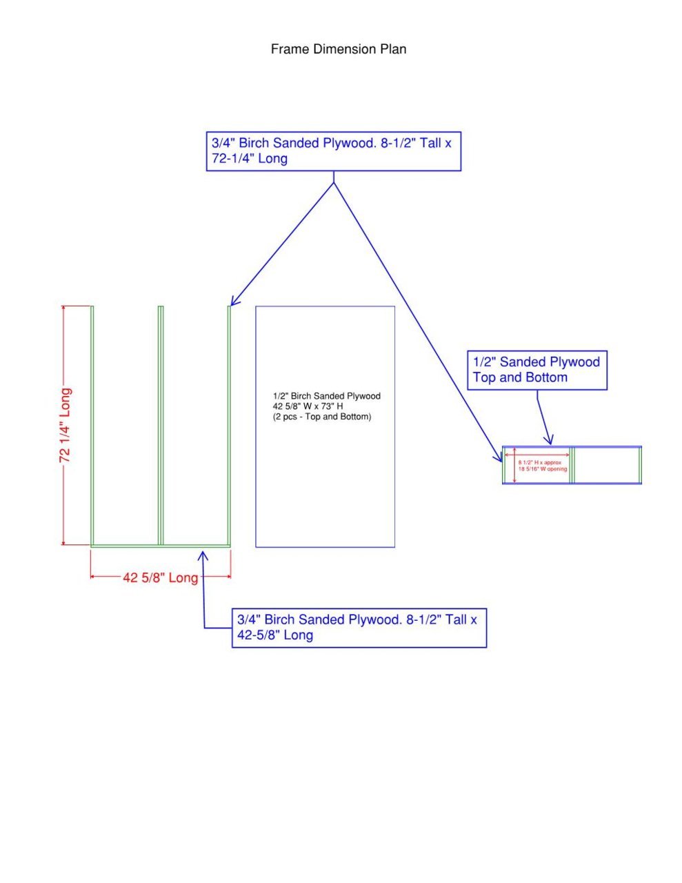

    Had a couple questions about dimensions on my set up. I drew these sketches to show the concept and basic dimensions that I would use if I were to build it again. I'm happy with my setup, but after building it, I made it more complicated and not as efficient with space as possible. Hope this helps you guys out. Always open to questions and helping out if I can. This was a fun project to build.
    I did not include the kitchen drawer I did since it was designed around a specific griddle. It is the same construction concept as the regular drawer, just has the sides cut out for access to the griddle.

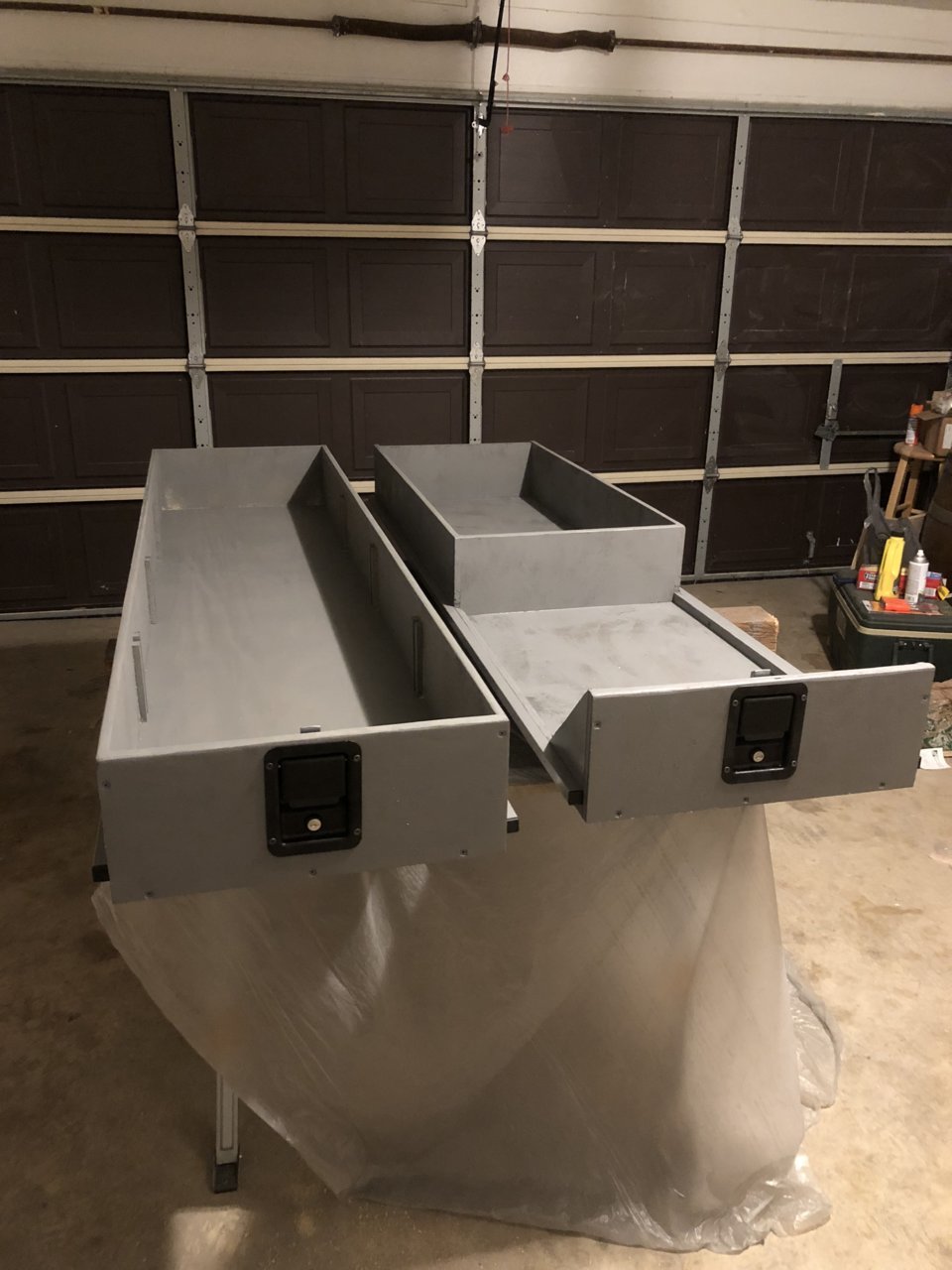

    Updated progress. Got the frame and drawers painted and handles mounted. Still need to paint and carpet the top sleeping platform. Will do that after my hunting trip this weekend.

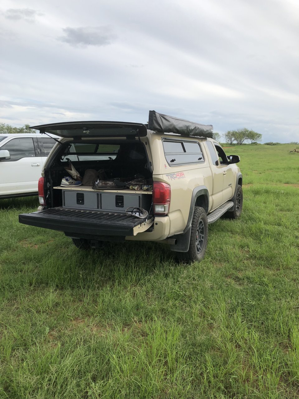

    Got to use the set up this weekend while hunting (minus the griddle and kitchen drawer) the paint didn’t dry all the way before I loaded it all up. It was stuck a bit at first. Gotta finish painting and carpeting the top boards, put the drawer stops on and Then figure out how i want to secure it in the bed.

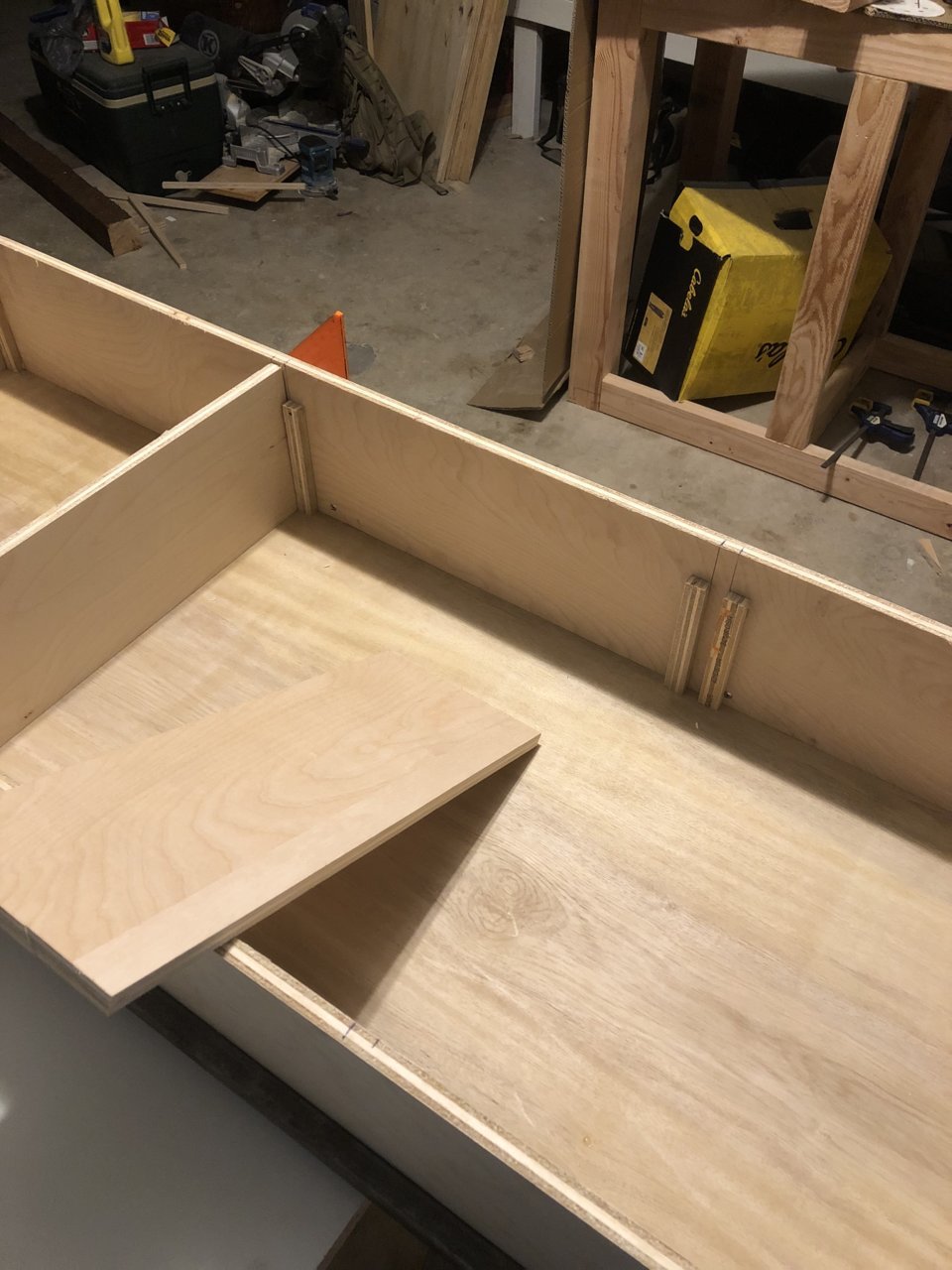

    I used 3/4” sanded plywood for the bottom, back and front pieces and 1/2” for the sides. No need for special joints. Just glue and screw.ise pilot holes so it doesn’t split the plywood. I screwed the sides into the bottom piece since it was thickest. Once you add the 3/4” tubing to the sides for the rail, it adds a ton of structural integrity to the 1/2” plywood.
    For the dividers, I just had some left over strips of wood that I trimmed from a larger piece of plywood and glued them to the sides of the drawer with enough space for a piece of ply to slide in between them. Just glued them and let sit for an hour. They were solid.
