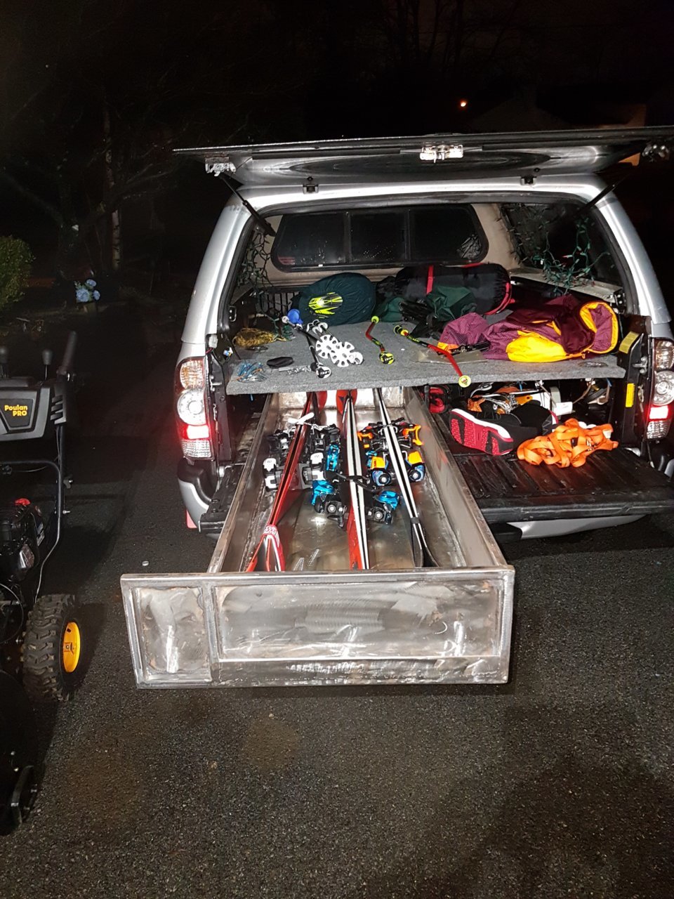

    1x1 is more then you need. I used 3/4" square tube and it's very strong. Last winter I threw 20 bags of wood pellets on the platform for a total of 1000#'s. Truck squatted bad, but the deck was rock solid.
    If I could have found 1/2" square I would have used that. Save some weight as well as space.
    Take a look at my bed build thread.
    https://www.tacomaworld.com/threads/building-my-bed-platform.497053/
    The great thing about doing it from steel is so much less material is needed to make the system. I don't know for sure as I've never weighed my metal setup but it has to be as light, or lighter then wood. Definatly lighter then some of the very over built setups I've seen.

    Nice!
    Any reason you cut all corners to 45* angle instead of just butting them together?
    What wall thickness metal did you use?

    I did 45's as that's what I see on tv welding shows, and it's just cleaner looking.....also i guess to make sure it wouldn't rust from the inside as they are sealed tubes.
    No idea on the metal tube thickness. I went to my metal supply house and gave them a basic idea of what I was doing. They chose the metal for me. I know 3/4" outside, and I think it was the only 3/4 they stocked. Once when I went to buy metal, the worker accidentally grabbed 1" square. It was a lot heavier carrying those cut pieces to my truck then the proper 3/4".

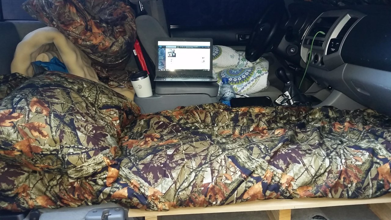

    So this is what I did this weekend to make my cab sleeper better.
    I went to Home Depot, and spent $19.49 on materials.

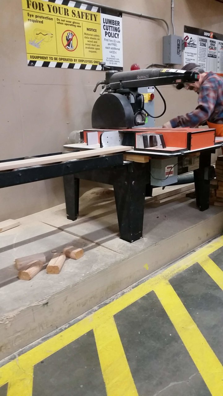

    Then I had the guy cut everything, since I don't have any saws.
    Then I got some help from this guy...

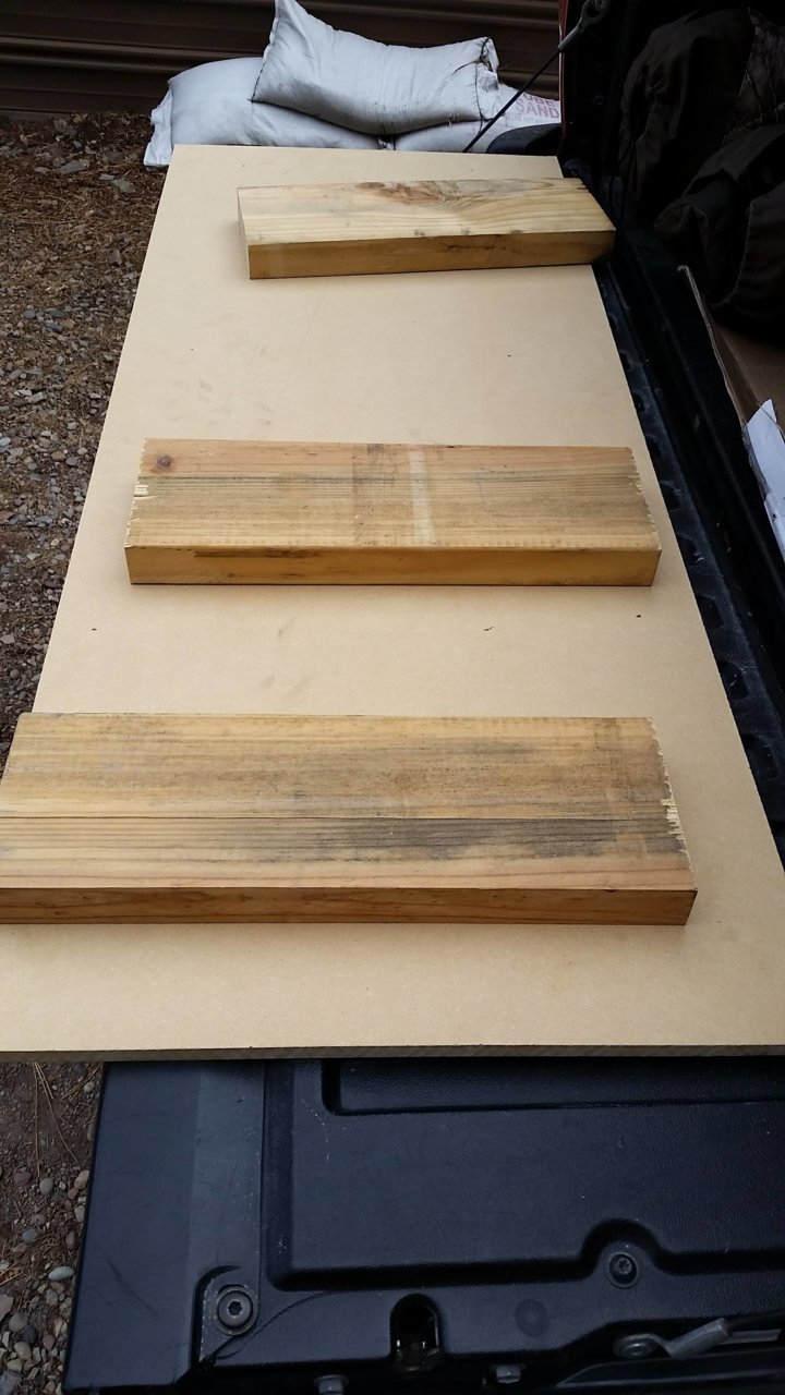

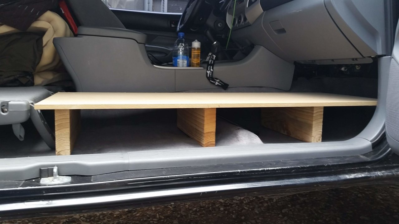

    I started with (3) 16'' peices of 2x6 and a 4 foot, 1/2'' piece of particle board, and had the side trimmed to a width of 19''.

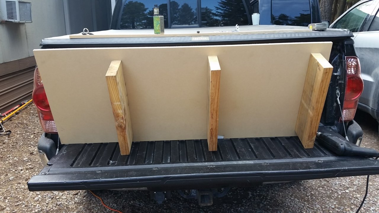

    Then I drilled the boards to the bottom...

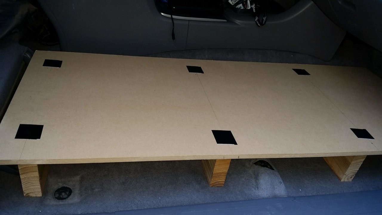

    Put some Gorilla Tape over the screw heads for an extra safety measure so nothing gets caught/ripped.
    Here, I still have storage space under the bench seat, and 3 divided storage spaces under the platform.

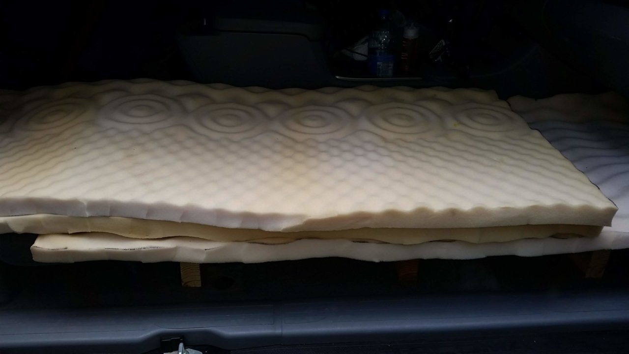

    Then I taco'ed the memory foam around a Big Agnes insulated camping mattress, and then wrapped that in an insulated hammock underquilt.
    Here is my complete setup with sweet sheets.

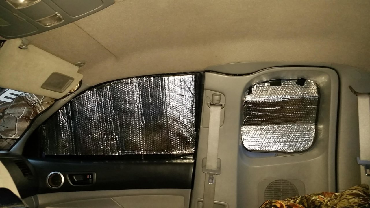

    I cut up a sunshade to black out my windows.

    Cool idea, but you must be under 5' or sleep folded in half. :cool:

    Awesome guys, thank you! I really your scrap plywood approach to dividers, I've been tearing my hair out trying to decide the best way to make little notches for 1/4 or 1/8 inch plywood to slide into. Your style looks way easier.

    I am 5' 3" but sleep in various positions hahaha

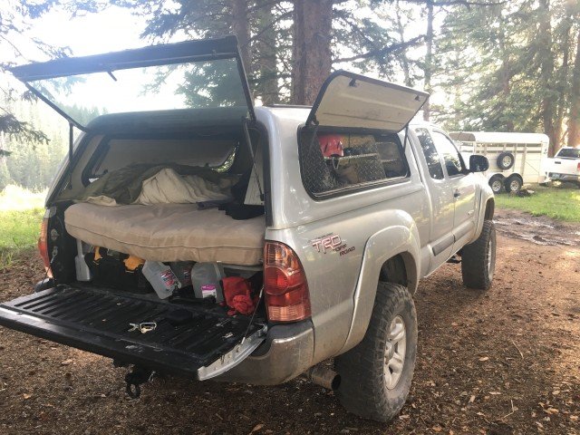

    Simple but effective. Side tool box for frequently used gear, the rest that i dont use often goes under the platform

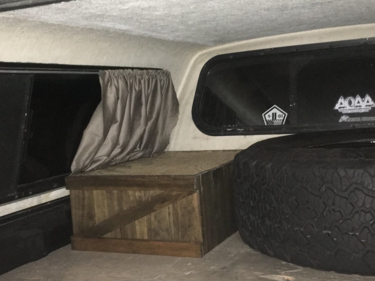

    Finally made curtains
    They’re kinda hard to open since it’s not loose enough on the rod but they work fine for now
