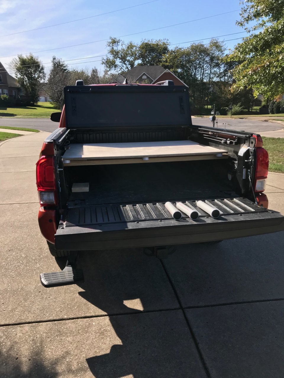

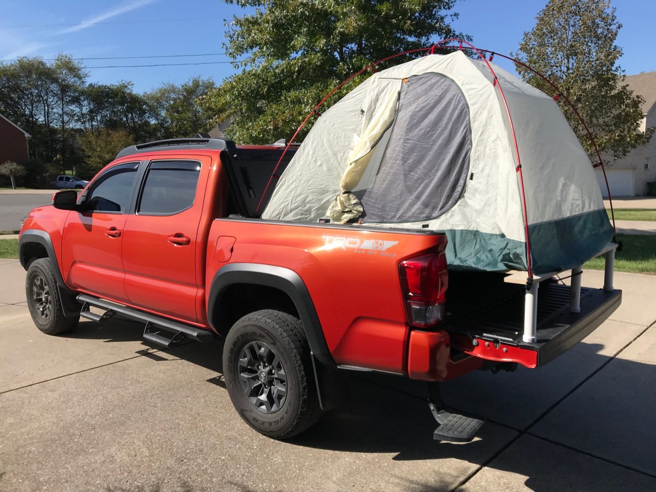

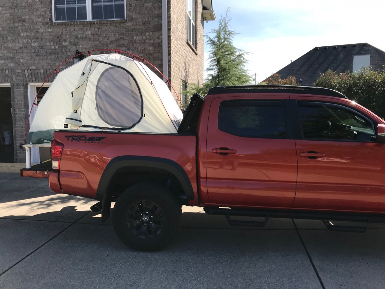

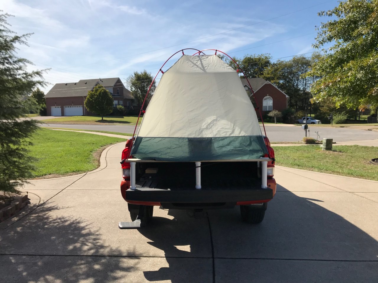

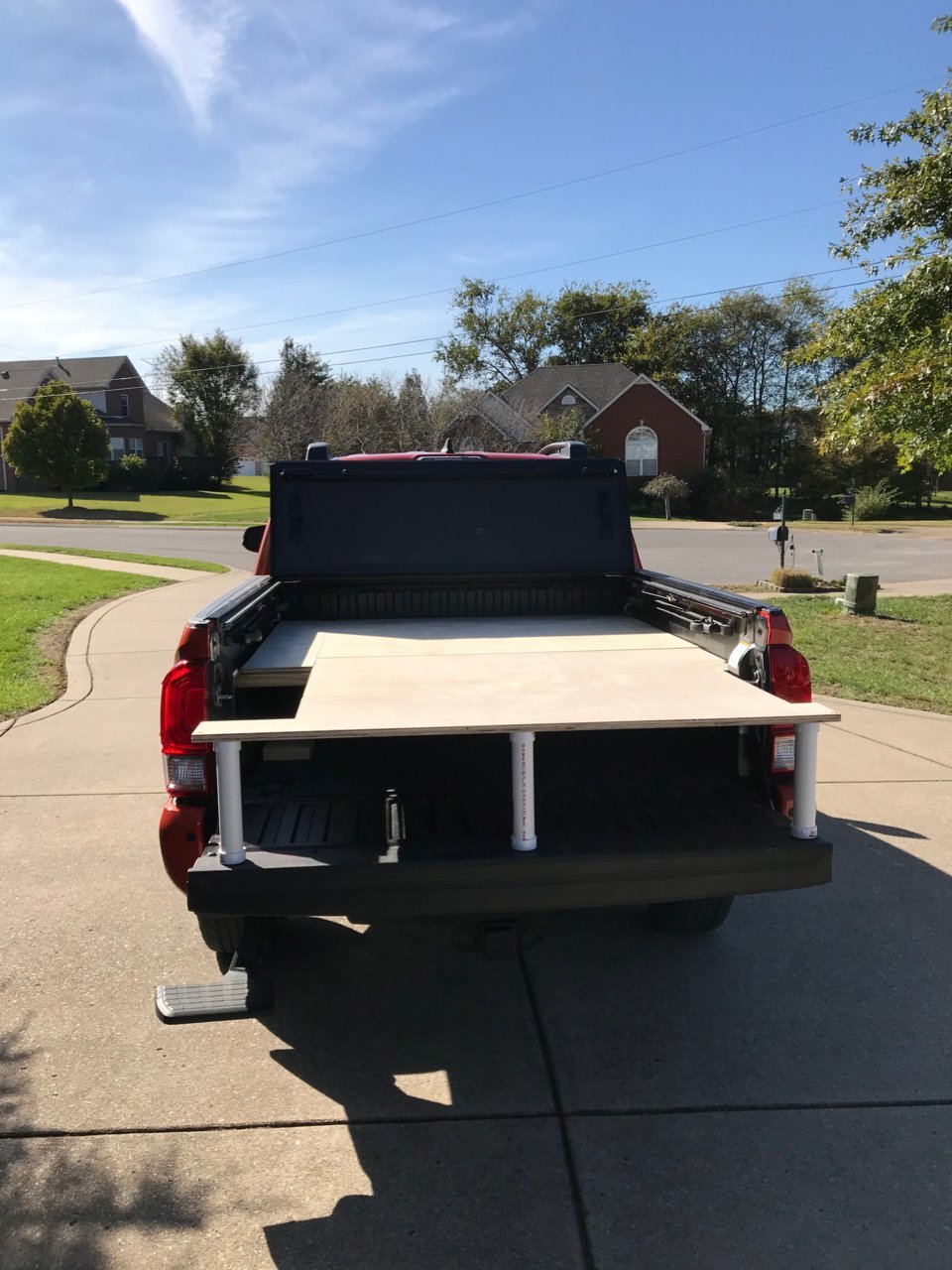

    Not a 2nd Gen, but same concept.... Test fitting everything in the driveway. Still need to paint the platform.
    Set up and tear down takes less than 5 minutes each. If moving from one location to another I can just store the tent folded on top of the platform without completely putting it away in the storage bag.
    Enough room on top of the sleeping platform to put my chairs and tables (with the cover down). They come out at camp anyway and other items can be stored in bins under the platform without having to remove them to set up the tent.
    Plenty of room to sleep two, however, the wife does not like tent camping so this should be great for solo camping. I have slept in the tent on the bed floor but had to take everything out of the bed. Found this thread and said to myself .... a new project. Thanks for providing the inspiration.

    My ass would trip and fall off the side of the truck getting out.

    I have a bad back and bad knees, so it is hard to get myself up off the ground. This will allow me sit up with my feet on the truck bed and then stand up.
    My Redneck RTT

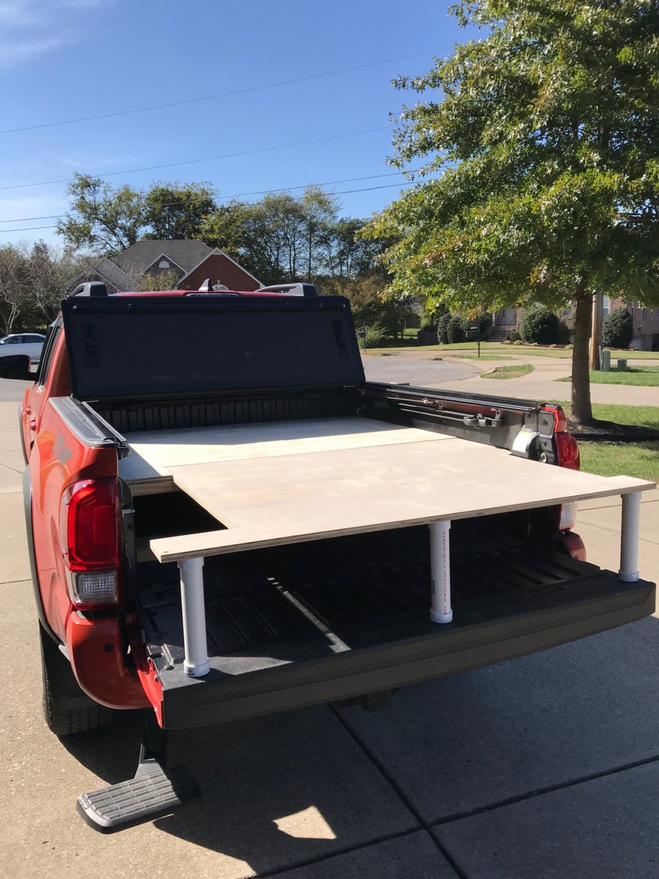

    This was my attempt at a tent platform. I'm intrigued with the idea of rooftop tents, but not the cost. I figured I had a tent already.
    The plywood has a piano hinge so that it can be folded away in the bed and unfolded for the 5'x7' tent. I doubled the amount of brackets under the tonneau cover rails to support the weight.
    Everything is stored under the tonneau cover.
    I don't camp very often, so I didn't want the truck to be permanently modified. This project was more of an experiment than anything else.

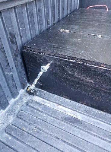

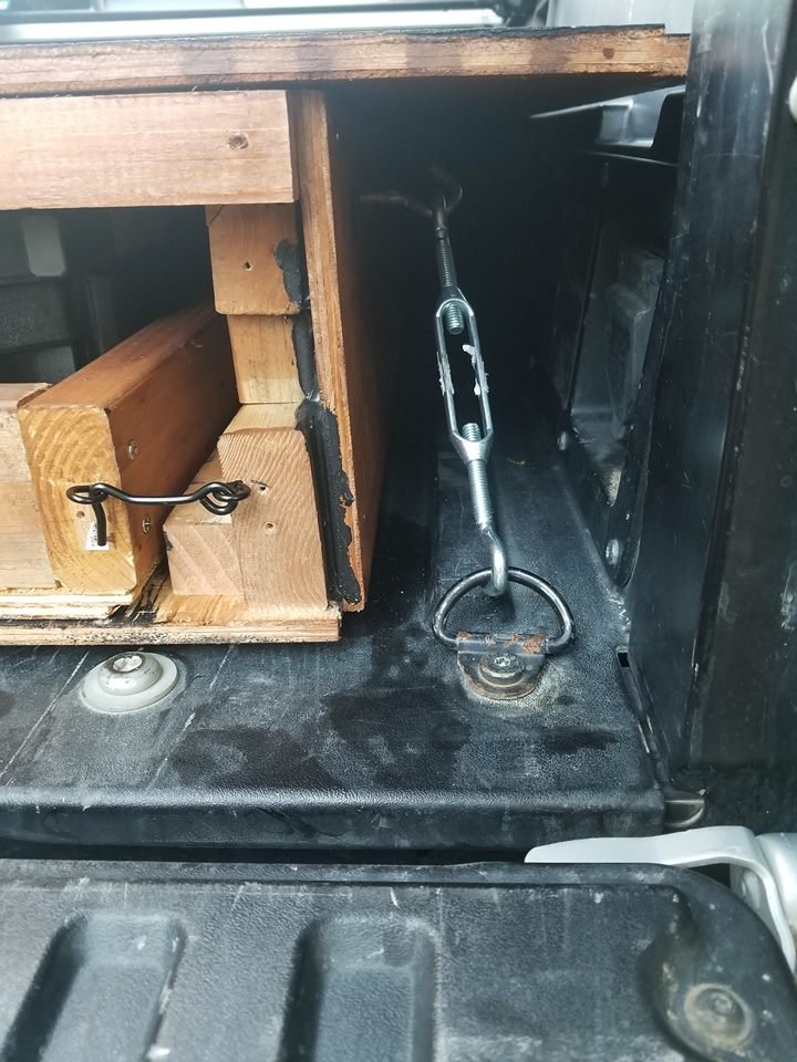

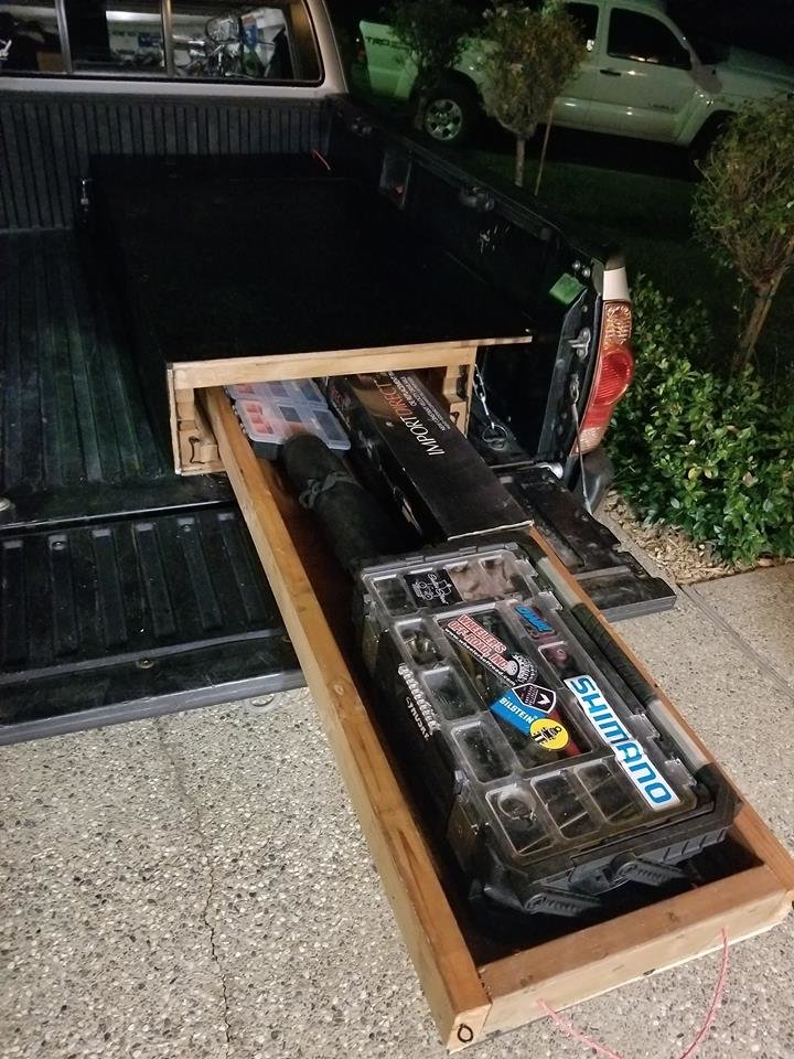

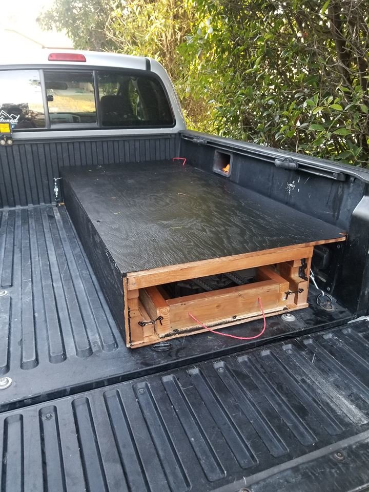

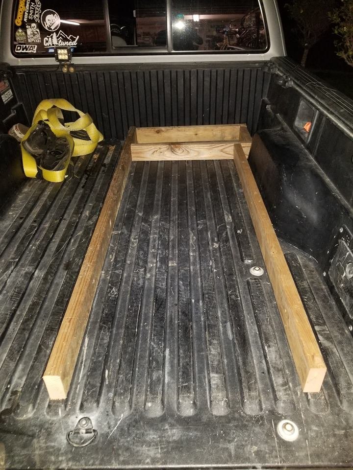

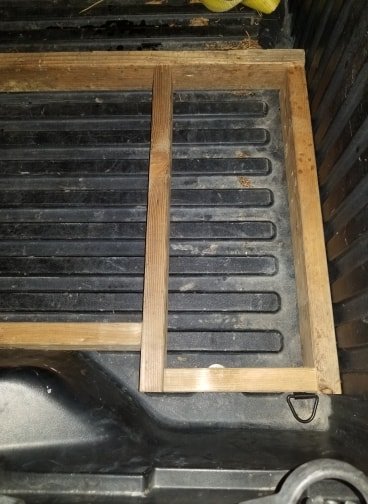

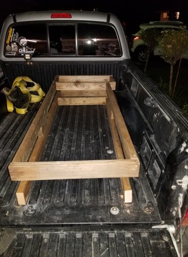

    I just built this thing up as a solution to get my spares and tools out of the truck. Trying to free up some space for the doggos. I took a bunch of ideas from this thread and kinda mashed some stuff together. The truck doesn't have a shell so I sealed all the wood with deck sealer and black silicone caulking, then painted it flat black to match the bed a bit more. I cheaped out on drawer slides in place of 2x2 wood on wood slides for now. I wanted to be able to sleep on it on solo trips without the wife. I also needed to have room for bins and my mountain bike on trips so I built it for half of the bed. I still need to do some finishing stuff like put a face on the drawer and a lock but I'm headed out for a 3 day trip this weekend and wanted to give it a test.

    Nice, if the drawer is hard to move you can put some transfer bearings in the bottom to let it roll on the bed ribs. They're cheap and work well.

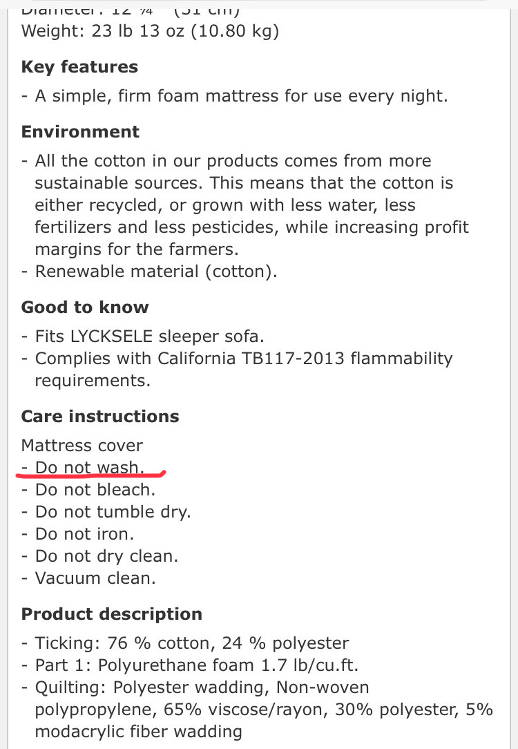

    I know people have brought this Ikea mattress up before, but it not very often. I just picked it up today and it fits perfectly, is comfortable, the top 3rd folds and the cover comes off to wash.
    I'm pretty happy, I think I will prefer it to blow up sleeping pads.
    https://www.ikea.com/us/en/catalog/products/20102074/

    Just fyi
