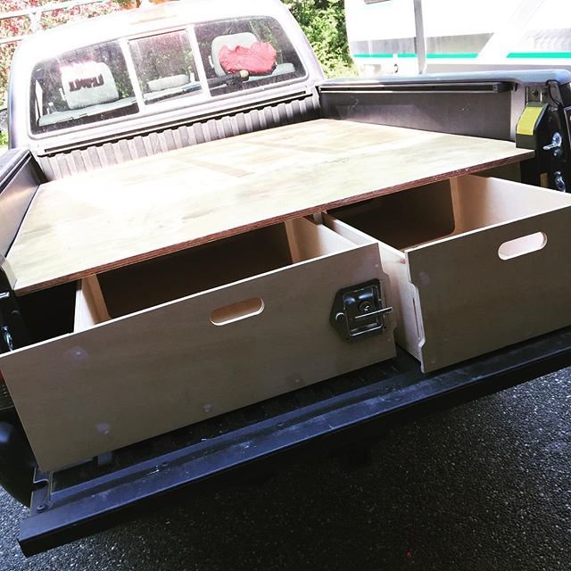

    '13 TRD OR
    OME, DX4, S/T Maxx, Bushwackers, A.R.E Shell, Yakima Racks
    One cabinet is 10in the other is 7in wide. Enough for 2 people snug

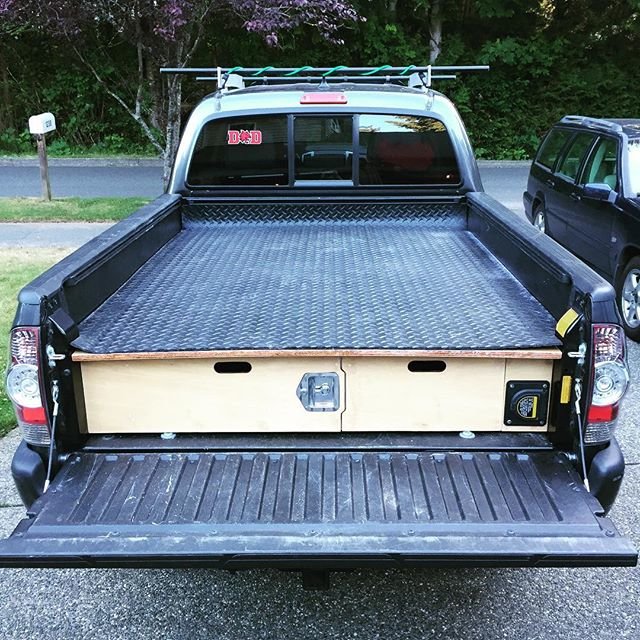

    Home-built roof rack for spotting platform and/or kayaks & bikes & stuff. Home built bed drawers Firestone Ride-Rite airbags on the rear for level camp trailer towing
    Simple, 3/4" plywood deck bent to a 1" crown then 6 oz fiberglass cloth and West System epoxy resin coated. Under that plywood drawers also coated with one layer of 6 oz and epoxy. The center latch locks both drawers, but I also added a Pop & Lock tailgate lock.
    I use the truck for exploring, but also still need to haul yard waste and other bulky stuff, so no canopy yet. The deck is finished off with a rubber bed liner cut to size, rolled up in the front under the bed rail, and caulked on the side. I drilled "scupper" holes in the side of the bed up forward so the new bed floor drains ahead of the wheel wells.
    The 400w AC outlet was moved so it's still available - there on the right.
    Since this photo was taken I've painted the drawers all around.

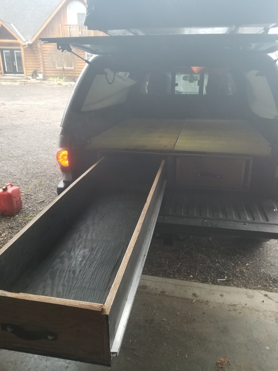

    I can put my fishing rods and rifles in there
