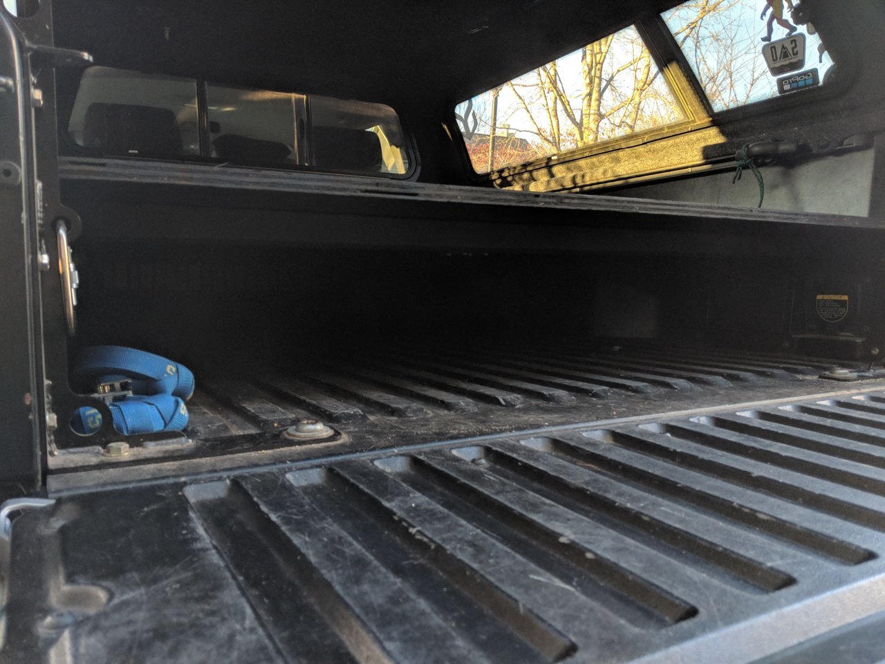

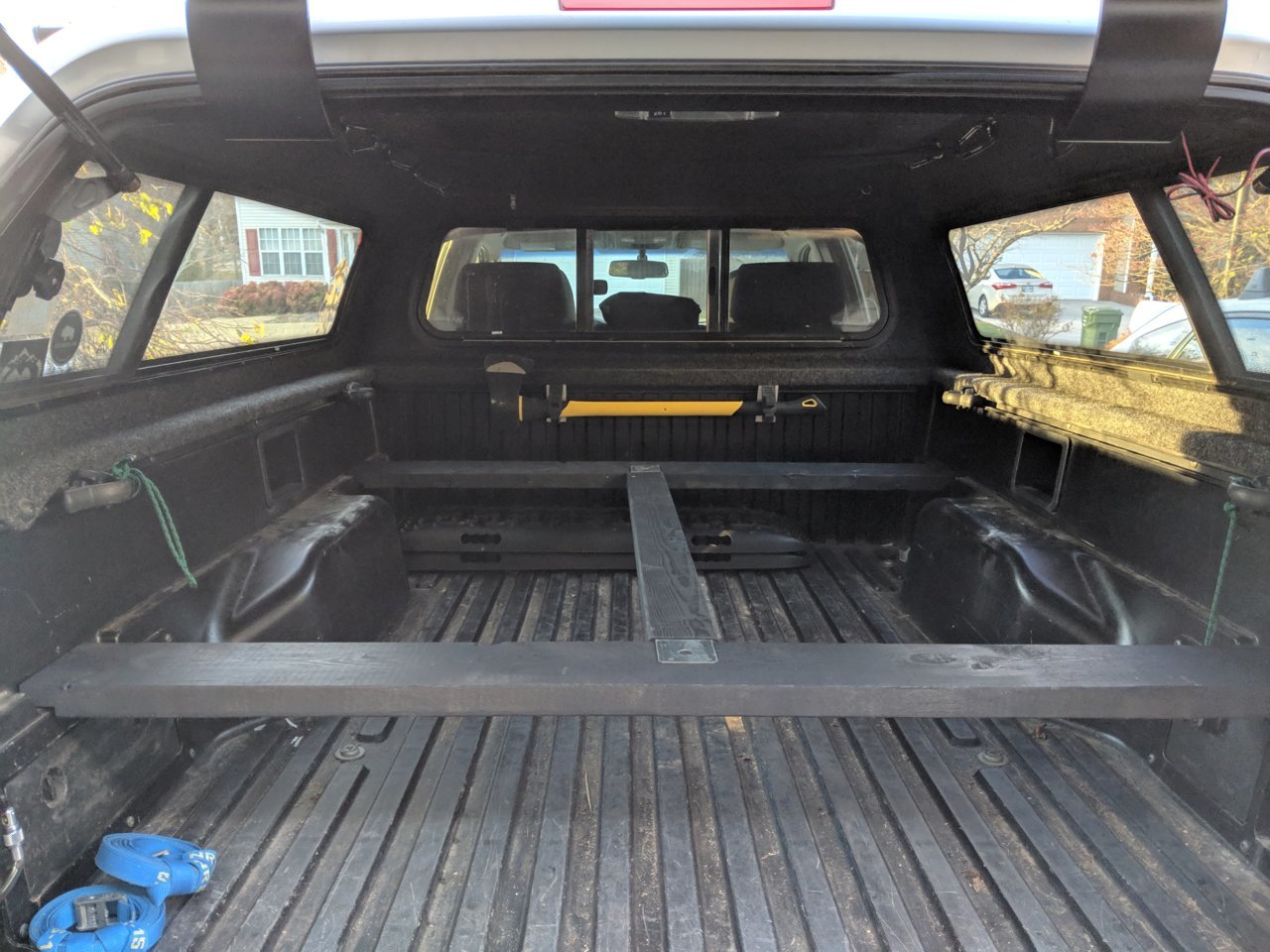

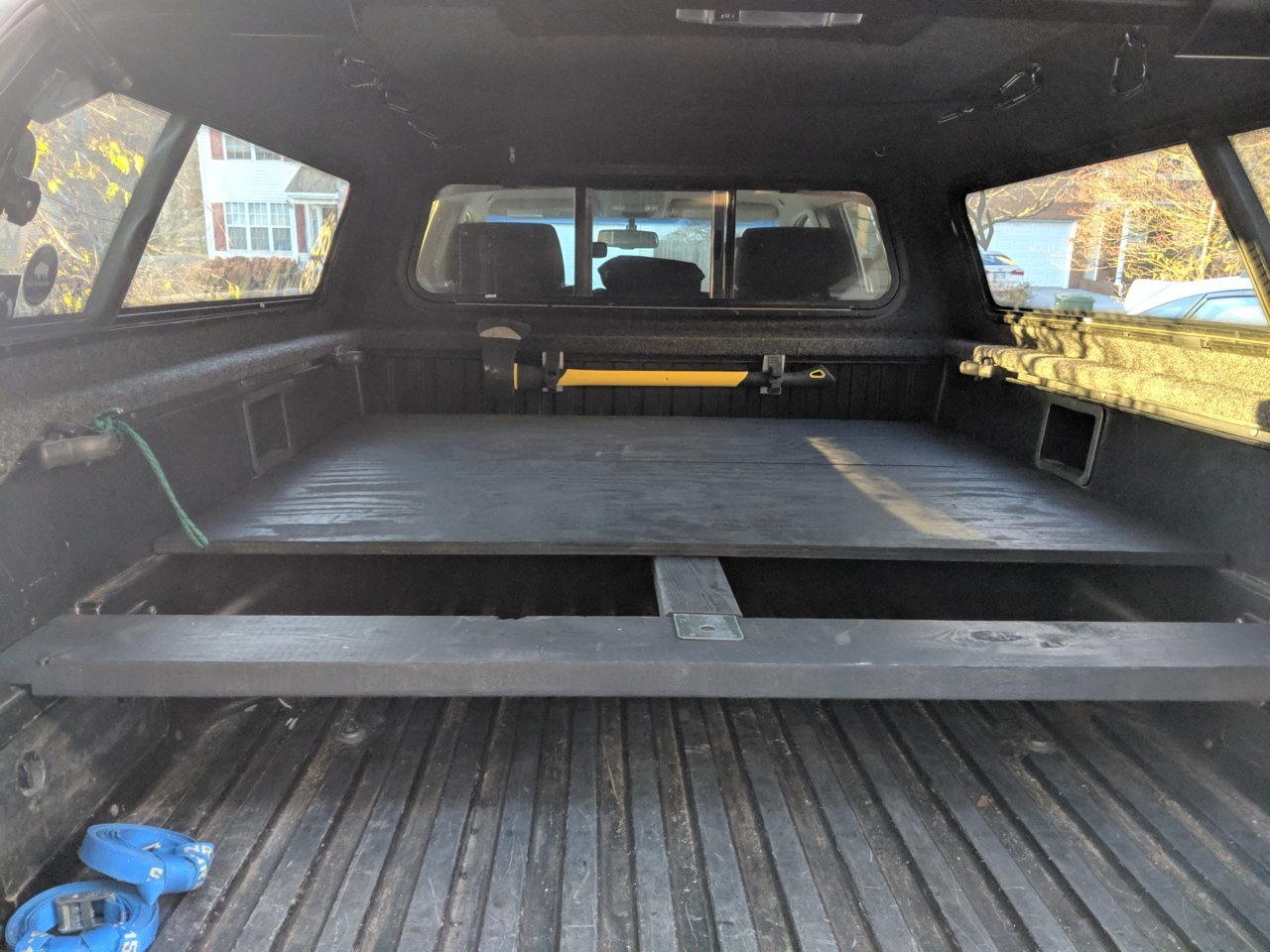

    I finally made and installed my sleeping platform. Over all I'm very happy with the design and function of the bed. What i like about this design is its super easy to remove as needed. There is no center support touching the bed floor which leaves a lot of room under for storage. A few things I want to change/add are as follows
    1) Drill hole or add handle to making lifting the platform sections up easier for access to back of the truck bed (right now with the flat surface its hard to grab hold of the plywood)
    2) When not using the full platform I need to come up with a way to store it in the rear of the bed like a 1/4 platform. I want to stack the sheet and lock them in place at the rear of the truck
    3) If i start to see that the middle section of platform sags with just one support I will make another and install it (just drops in place so very easy to add later)

    I like it. You could get some of those plastic bins with wheels that could act like drawers. But they'd be easier to remove and would keep stuff from sliding all the way up towards the cab.
    Does the middle sag at all when you are laying on it?

    it did a bit ~1/4" before I added the center support. Now it works perfect. Like I noted I may add another support in the middle like the one I made (if needed). Its easy to make and drops right in place if i need

    I really like the simplicity of this as I need to easily remove and limited place to store (in garage) when not used. Thinking I would use 2x8 notched for the cross bed supports. Tks for posting.

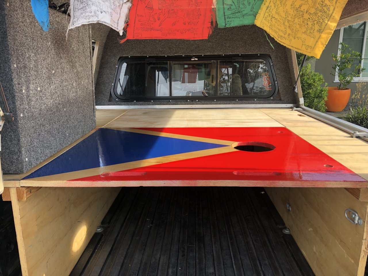

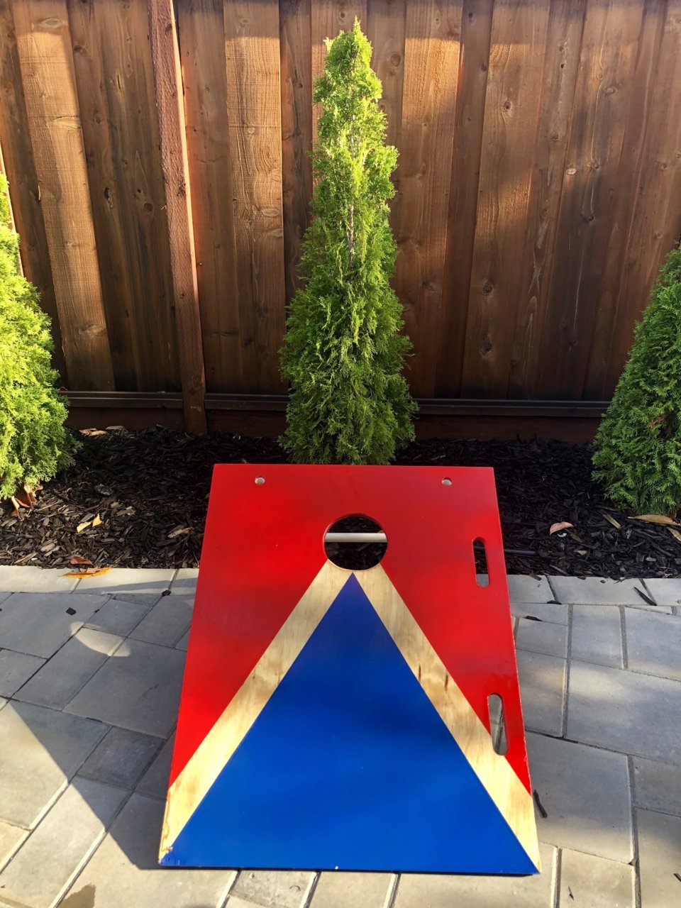

    72BA8161-6BD2-4650-9F90-FC7C00A01721.jpg 3753FE3F-7FFD-4B36-86C7-AD47454F59E3.jpg
    The sleep platform now doubles as a corn hole game. Only did the one section becuse the memory foam and sleeping bag will roll up on the back section.
    And who says inspiration doesn’t come from hanging in bars?

    How is the metal bracket secured? I'm thinking you drilled them on from underneath?

    The bracket is Z shaped so it's screwed on the bottom
