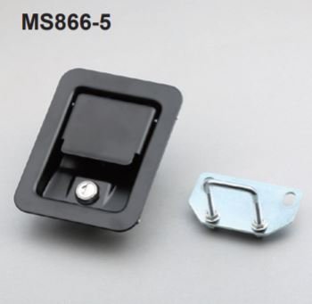

    Anyone have these latches? I'm having a hard time mounting them to my drawers. I think that i have to return them and get some different ones. The latch on these isnt far back enough so theyre pretty much useless to me I think. Anyone know some good slam latches that are lockable similar to these?

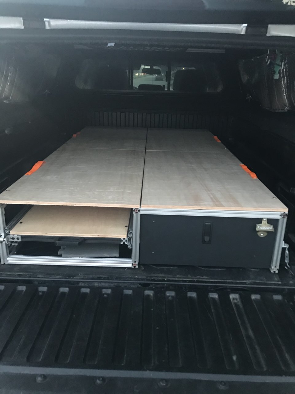

    Here is my bed platform set up, I also added carpet to it from Home Depot, The round holes are so I can still use my tie downs

    Have you notched the backside of the drawer to allow for the latch?
    I don't know of any latches that are thick enough to go through a 3/4" piece of wood.
    Post a picture, perhaps we can offer more help.

    I have latched like that. They work great. What do you mean it isn’t far enough back? The latch doesn’t stick up high enough? Or is the wood drawer too thick to mount this to? I used a 3/4” wood front piece on my drawer and mine fit great. I got them from graingers website. They were on sale when I got them. I’ll find a link to the ones I got.

    Yeah the wood is too thick. The front of my drawers are made with 1x12s. The latch looks like it would only allow something super thin to work. Ill post up some photos so you can better understand. Do you have any photos of how you cut it out and mounted it?

    Cut out the wood however size is needed. Then take a small piece of flat stock metal and screw it to the outside of the wood. Metal can be way thinner then wood.

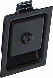

    https://www.goose-gear.com/products/compression-latch-with-keyed-lock

    So I want the drawer fronts to be flush similar to what I have right now. But for that to happen I need the latch part to go back way further.

    If you’re good with a router then countersink the drawer face so the face of the latch is recessed.
    Or get the correct handles.

    I'm gonna get these guys. Looks like they'll work out.

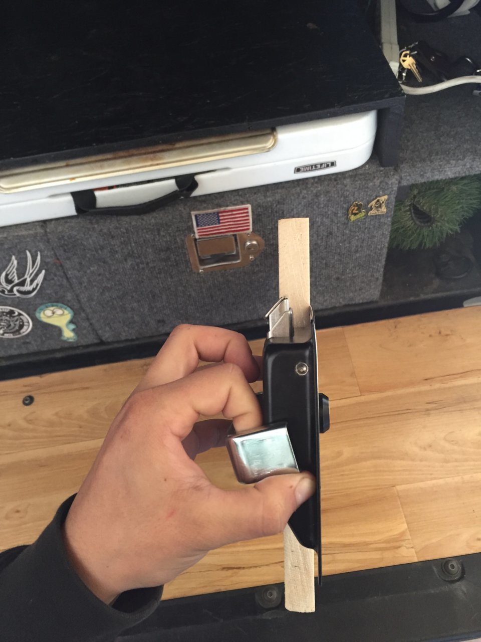

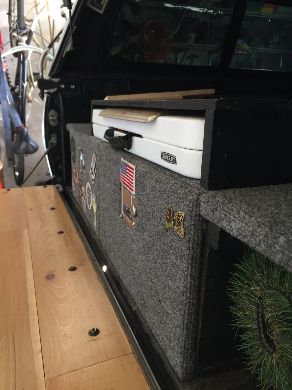

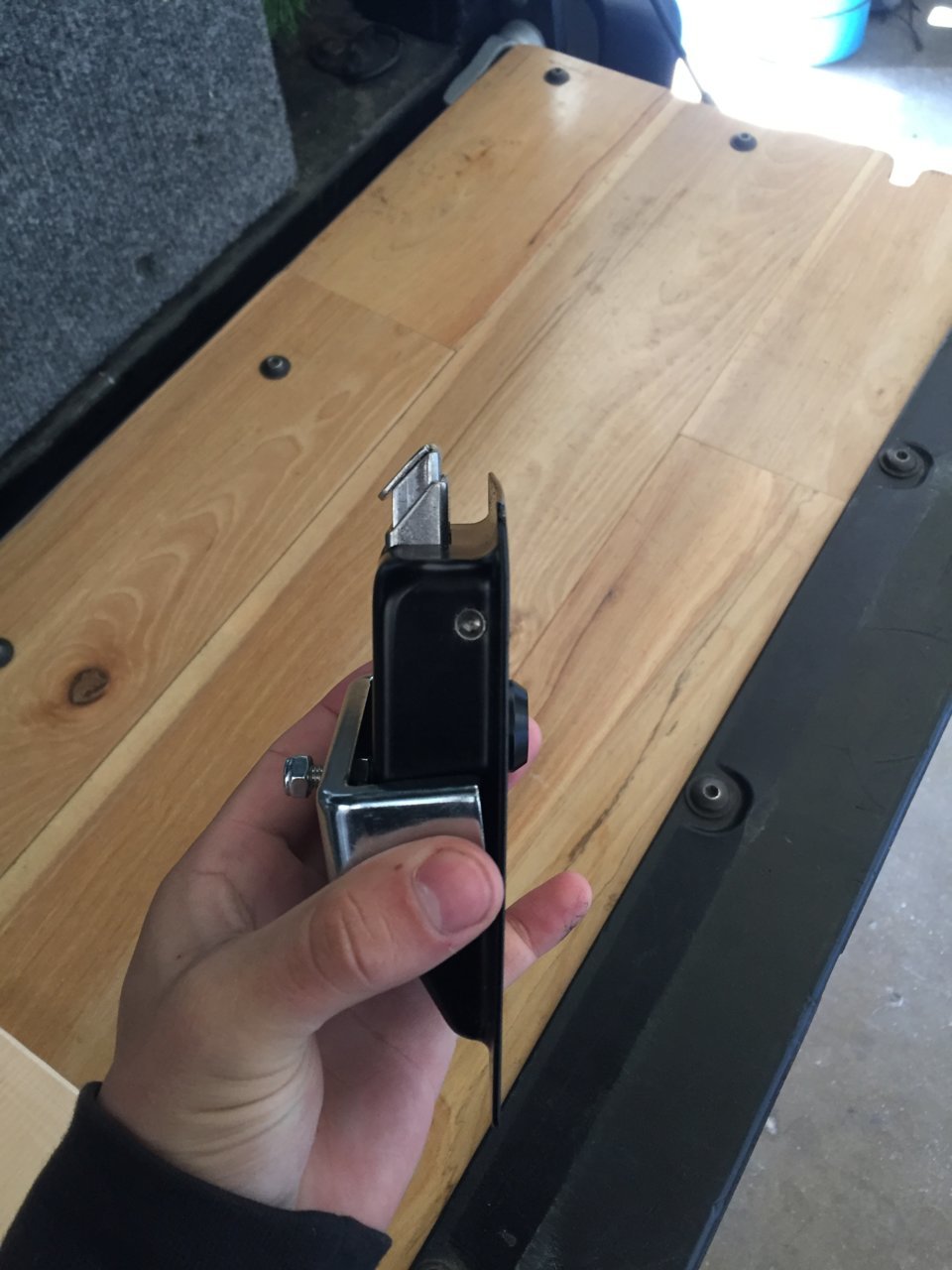

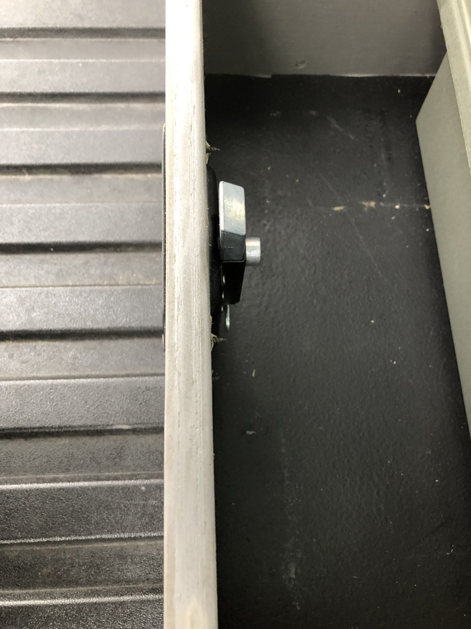

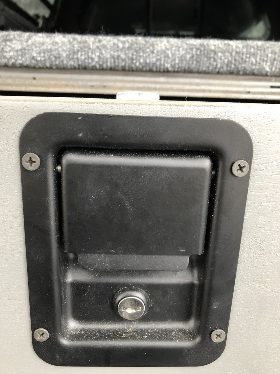

    Didn’t see this post when I replied earlier. Here are some pics of mine. I need to swap out the screws but I couldn’t find the ones I bought for these handles. These are ones I had lying around. They do stick ya if you aren’t careful!

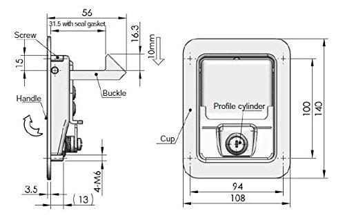

    That 31.5 mm dimension is 1.240157 inches. You said you are using 1x12.

    Yeah but the 1in is really 3/4in

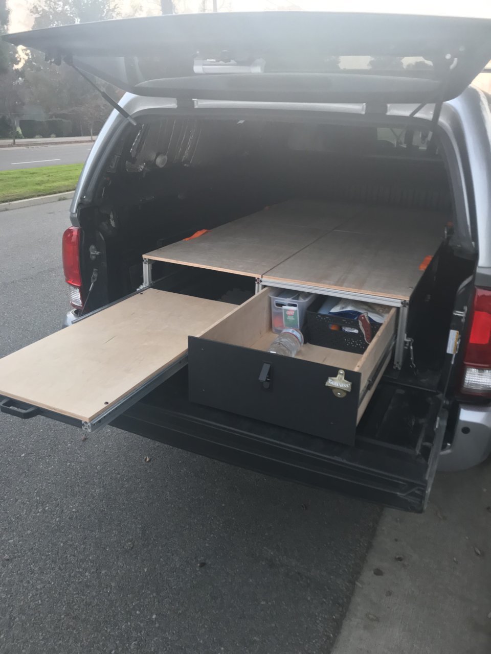

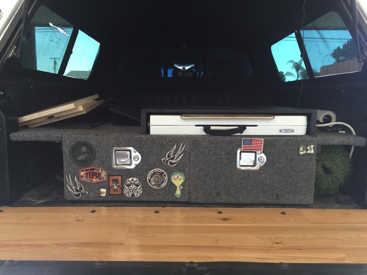

    Here’s my setup, shown with no sleeping pad in it at the moment. The tray slide out holds an RTIC 65 (the panel above pops right off in that case) and I sleep on the right side above the drawer.
