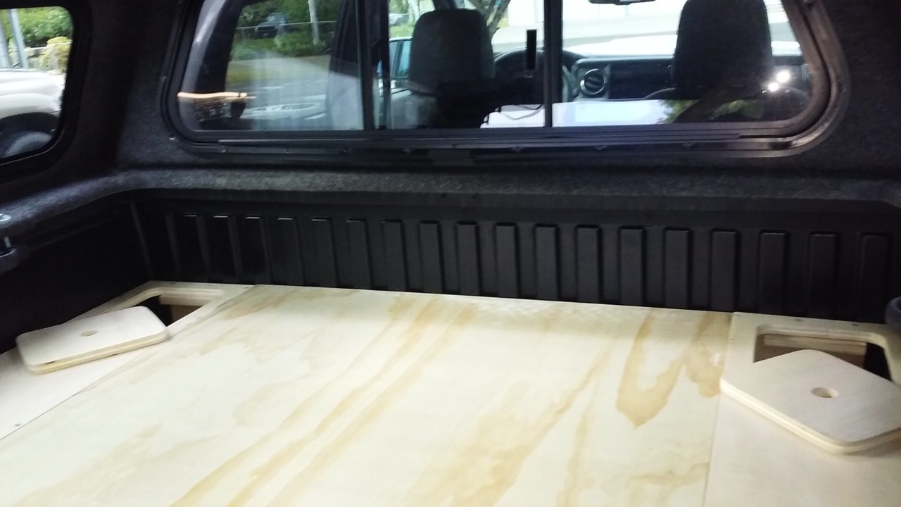

    I used Varathane on mine. 3 or 4 coats, and it is holding up fine.
    I have BedRug carpet Velcro'd to the top of the platform, which protects the wood, and provides a little padding when lying down in there.

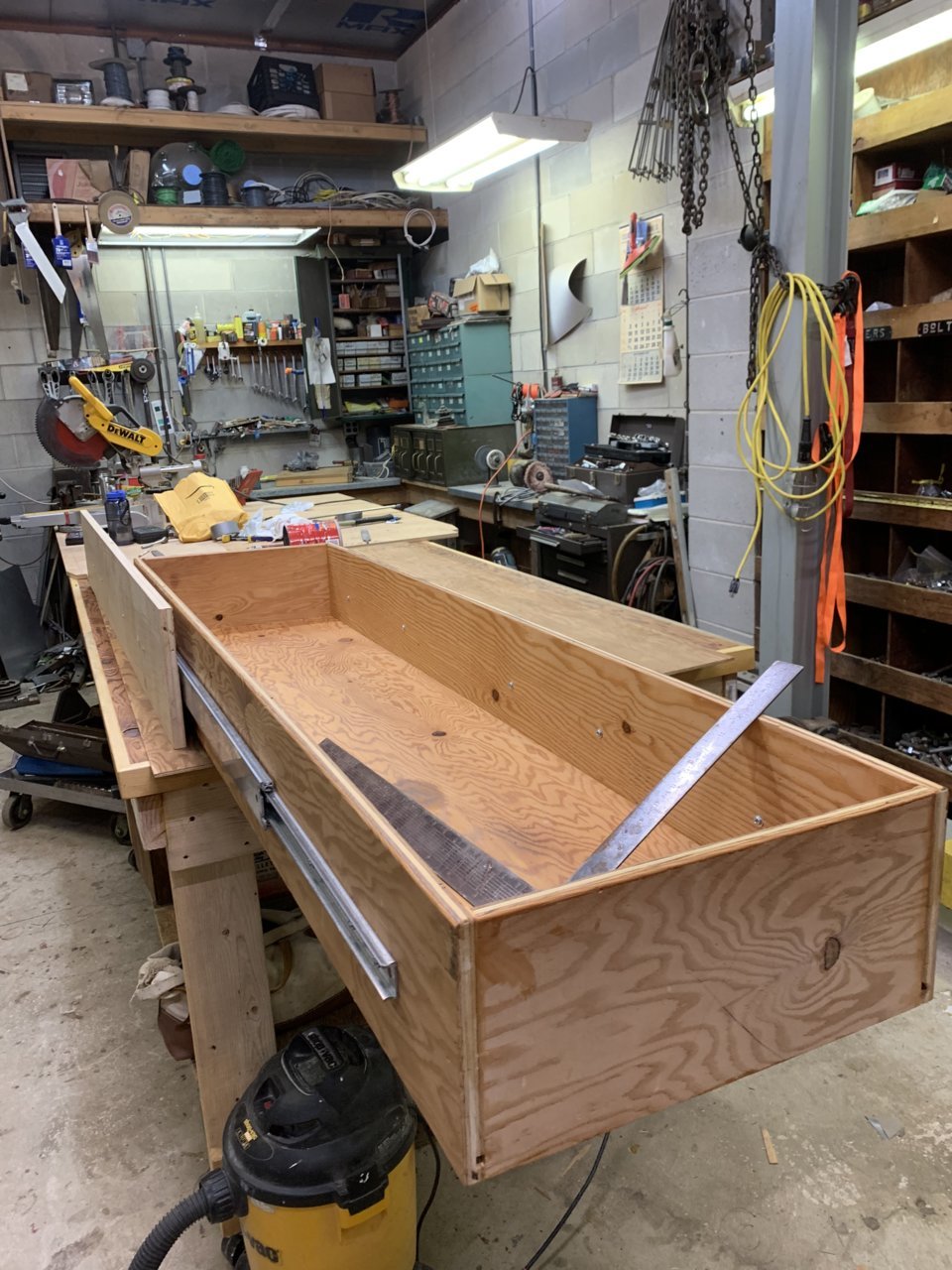

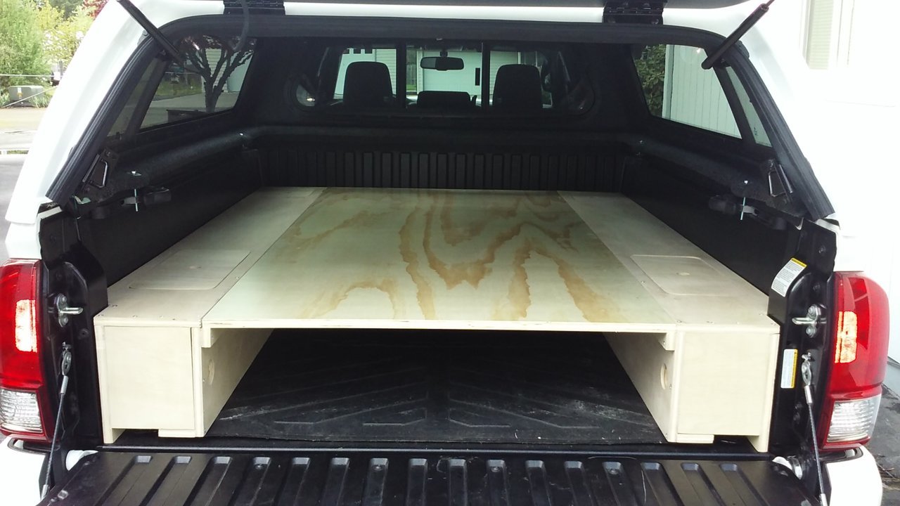

    ARB front with KC HiLite’s. LED backlit grill and ARB. Century topper. Lots of stickers. LED interior accent lights. Sleeping platform / storage platform. Rear topper LED lighting. Anti-steering-rack-zip-tie-mod.

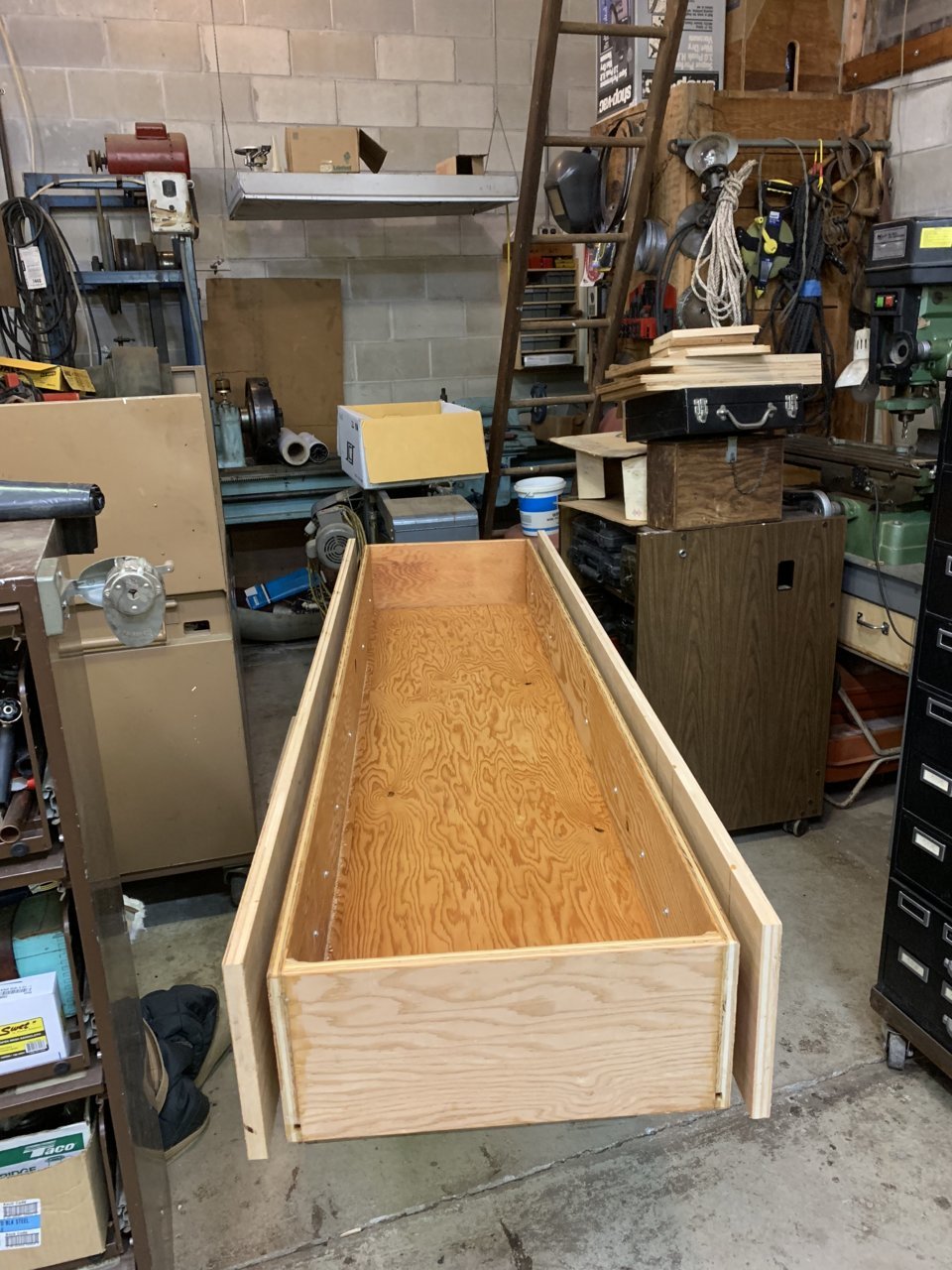

    234FBF3B-298E-440F-9BEE-19ECF2801D5A.jpg A1294613-0055-4F9A-AD14-02FD31FF094C.jpg

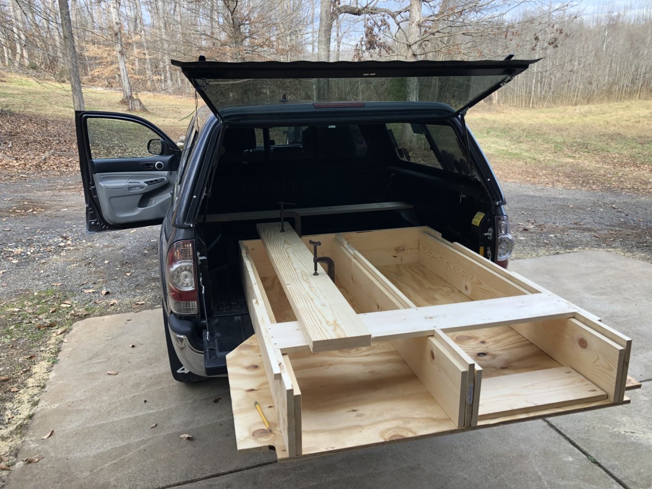

    Coming right along. Been working on it for about a week. More pictures to come.

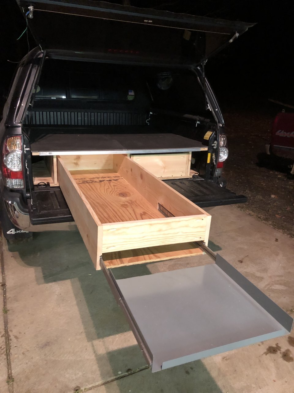

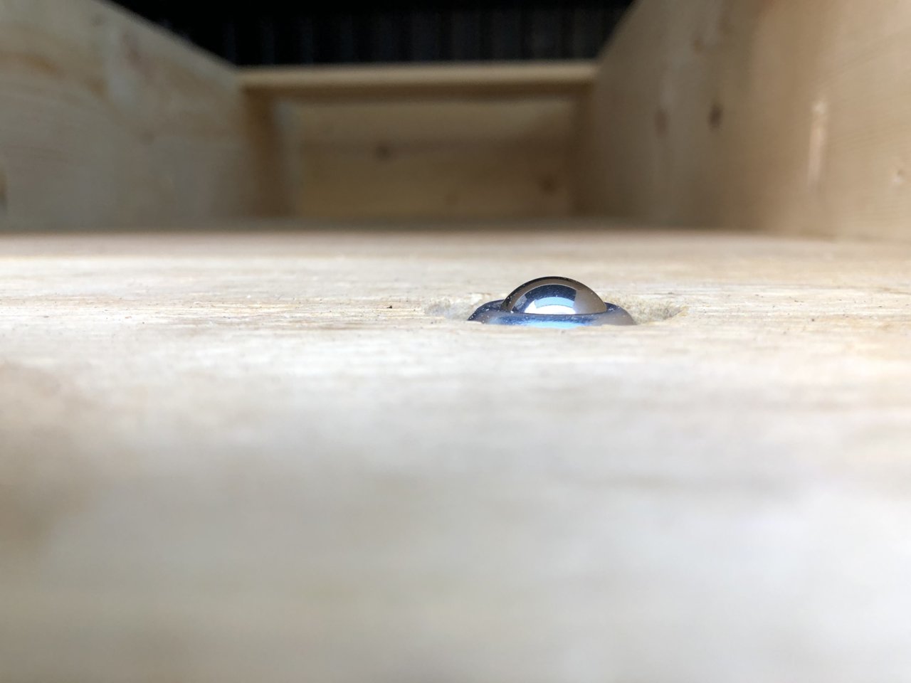

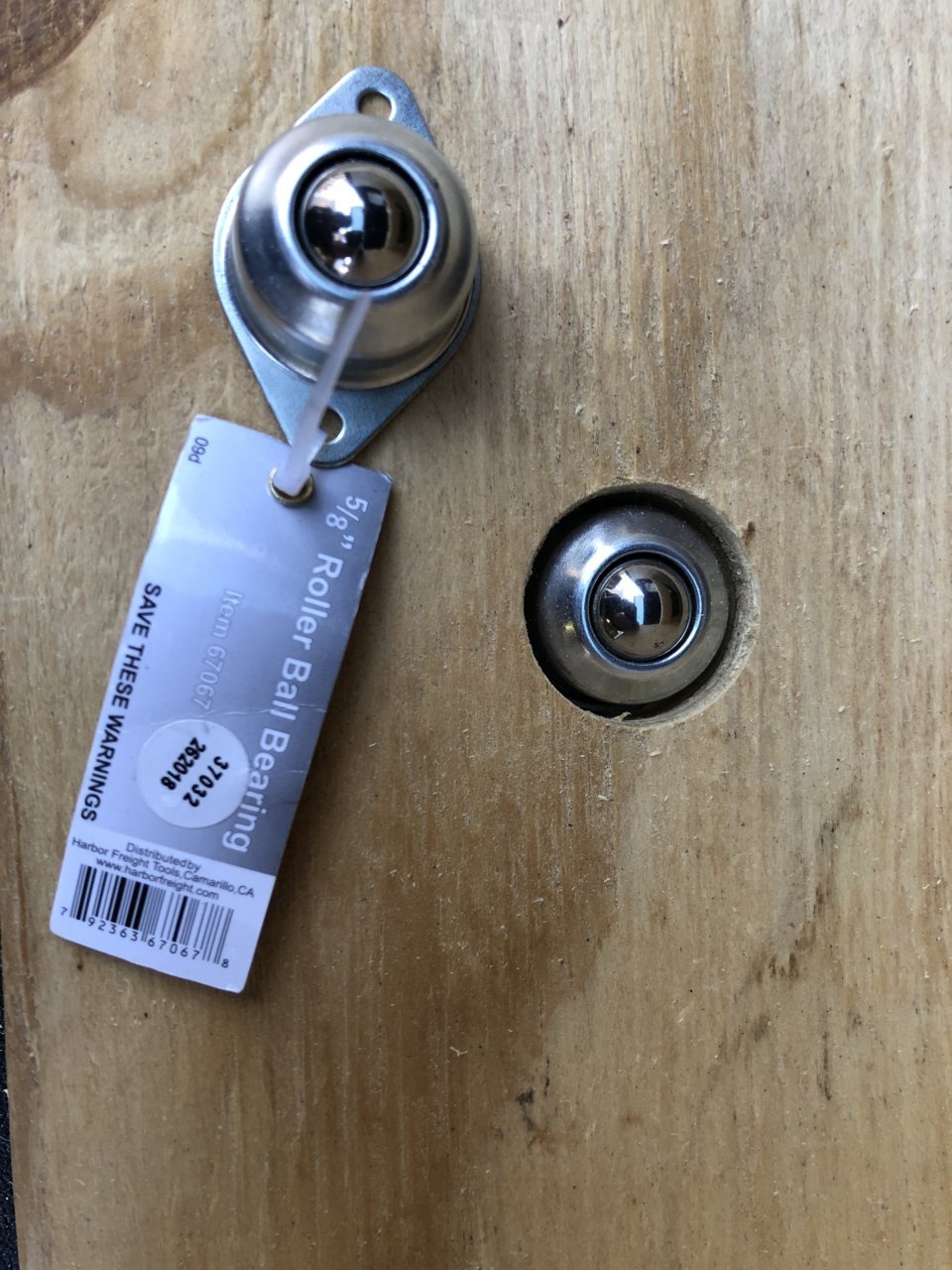

    229E5AF8-C9D6-48C8-B4C4-60D6B4DD9D10.jpg A2240AB0-777F-4FC9-8733-AD88A7698A6C.jpg CEB26B82-B40C-40DA-95CB-B3867AAC2790.jpg 448E9B7B-CF5A-4DA7-805D-49B3A4C6F2B9.jpg A160551D-89C7-4719-8E41-E8F3EC5E1DFA.jpg 53E0171A-124F-400C-87E8-7BD5F1264AEC.jpg 43CB3923-D0D6-4860-B4EF-96FC11D043C6.jpg 8A6C8C0D-B2D2-4F75-8837-727ADB4DBEE9.jpg
    More progress on my storage system today
    DoulosXP, POOLGUY, rob1208 and 3 others like this.

    Looks awesome man. Keep the pics coming I need to do this soon. I like the ball bearing idea. Do you have a stopper for when the drawers are extended out?

    Thank you! I don’t yet, but I’ll put a stopper block in so that they can’t slide out. The ball bearings are working well, think I may add some in the sides too.

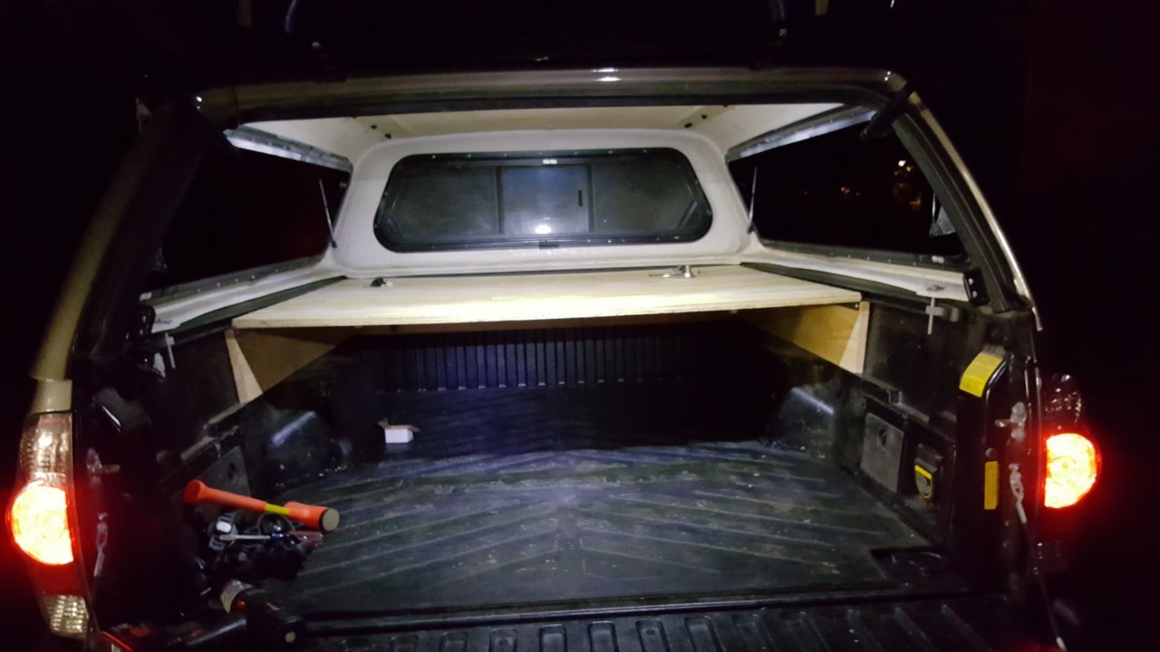

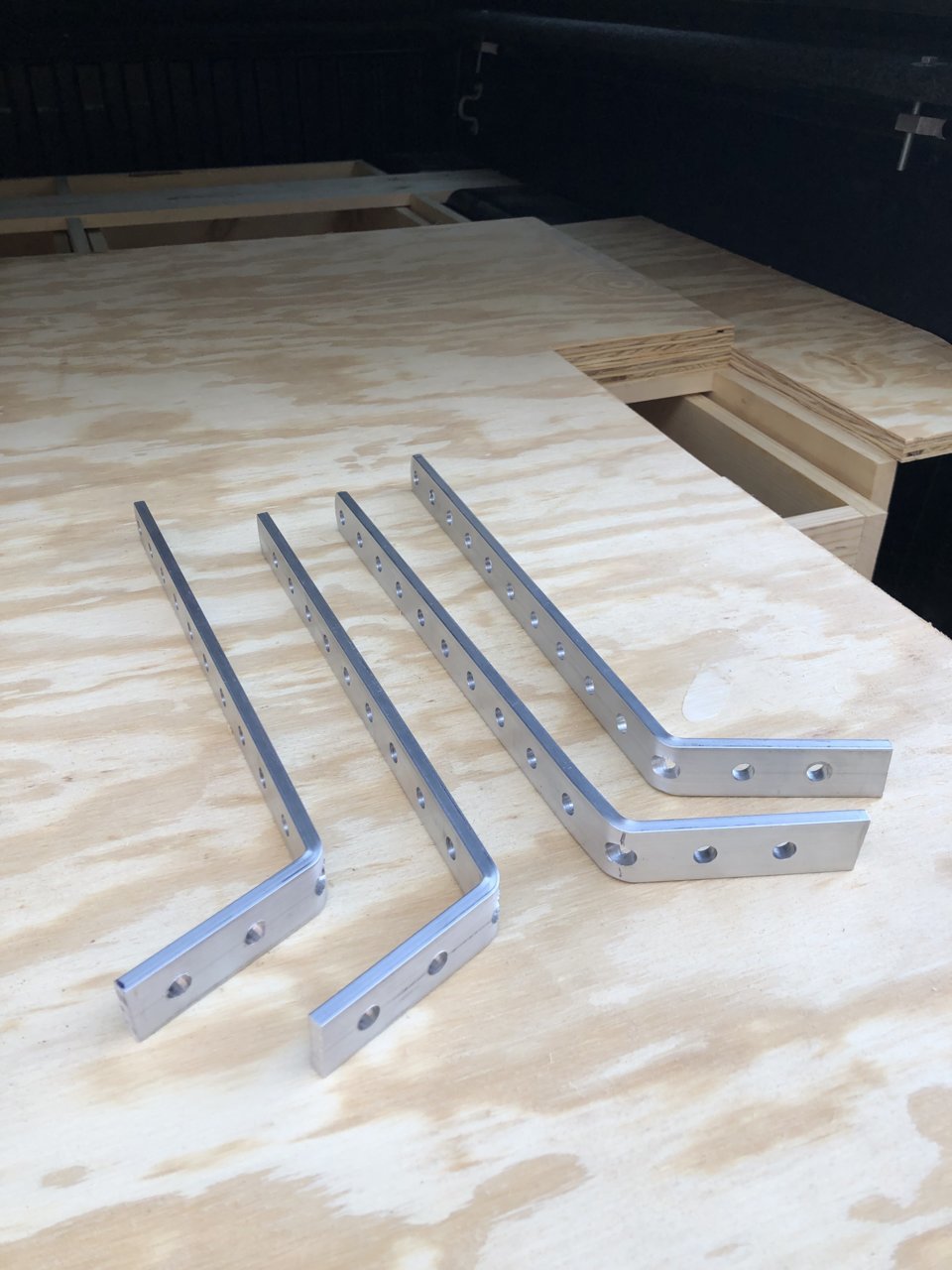

    Looks awesome! What's the plan for the angled brackets? (sorry if I missed it somewhere along this thread)

    Those are going to mount to the bolts holding my topper mounts on! I’ll take the bolt out and insert the angled brackets where the topper attaches. The angles will match the slope of the topper and act as rod tube storage for my fly rod tubes. It will work perfectly for my 8’-9’ 2 piece rods. Not sure about four piece or three piece. Will report back on that.

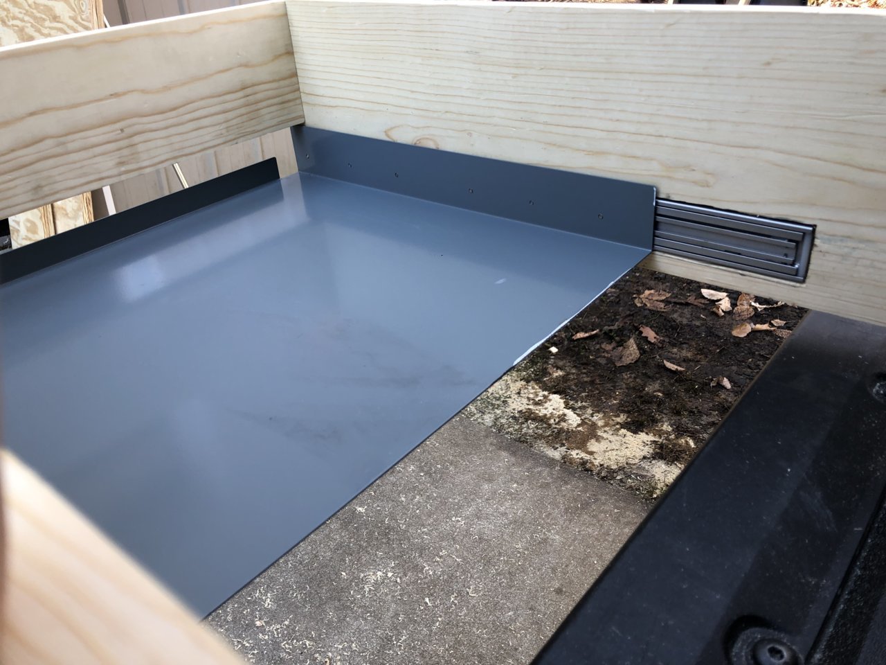

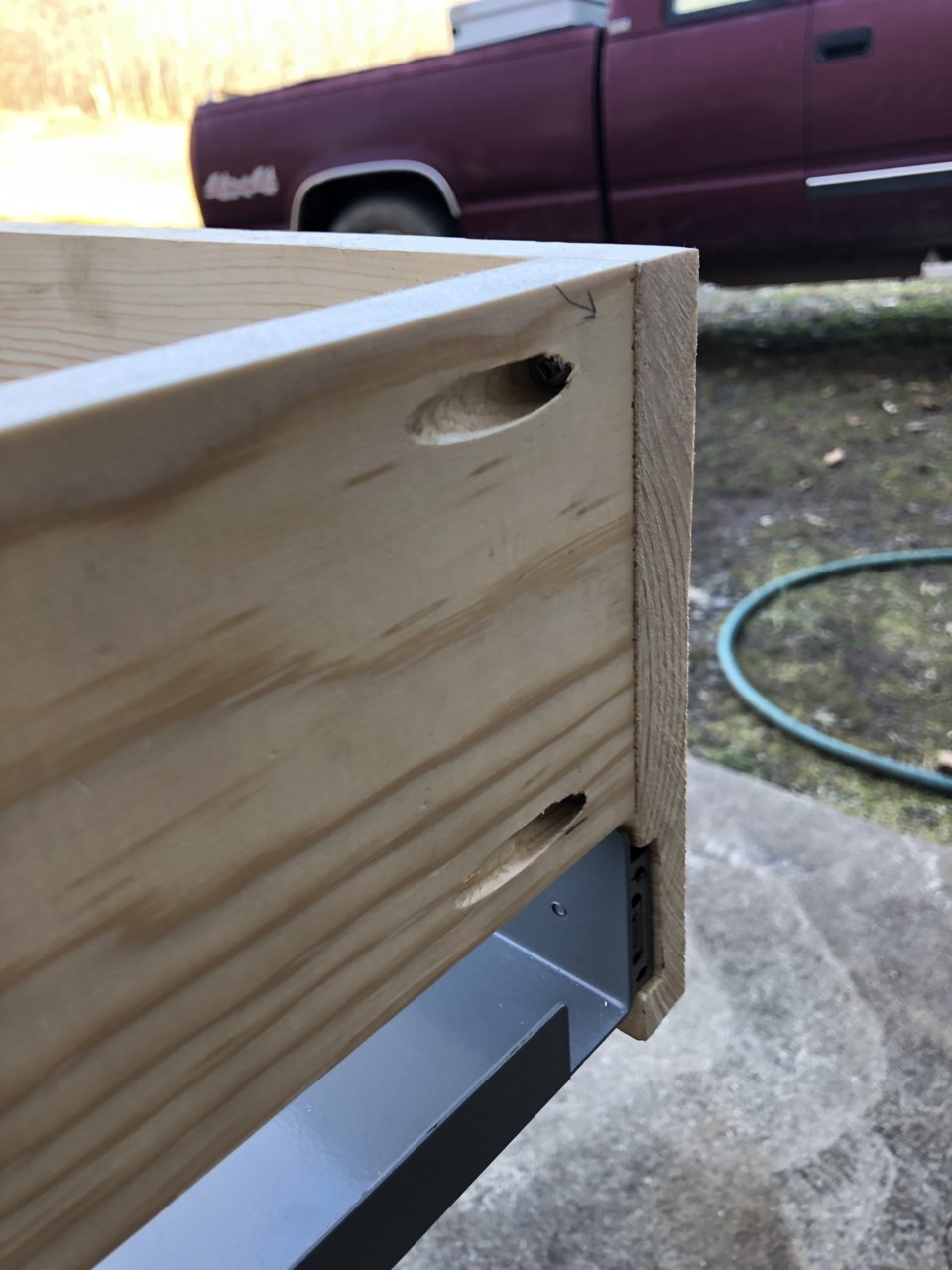

    84A45142-60C9-4EBF-862C-5227C08B8EC7.jpg 03B576DB-4D93-4BAB-8995-93A8FA1C1FAE.jpg
    2of2 almost complete. Pain in the ass to install they HD 5’ slides

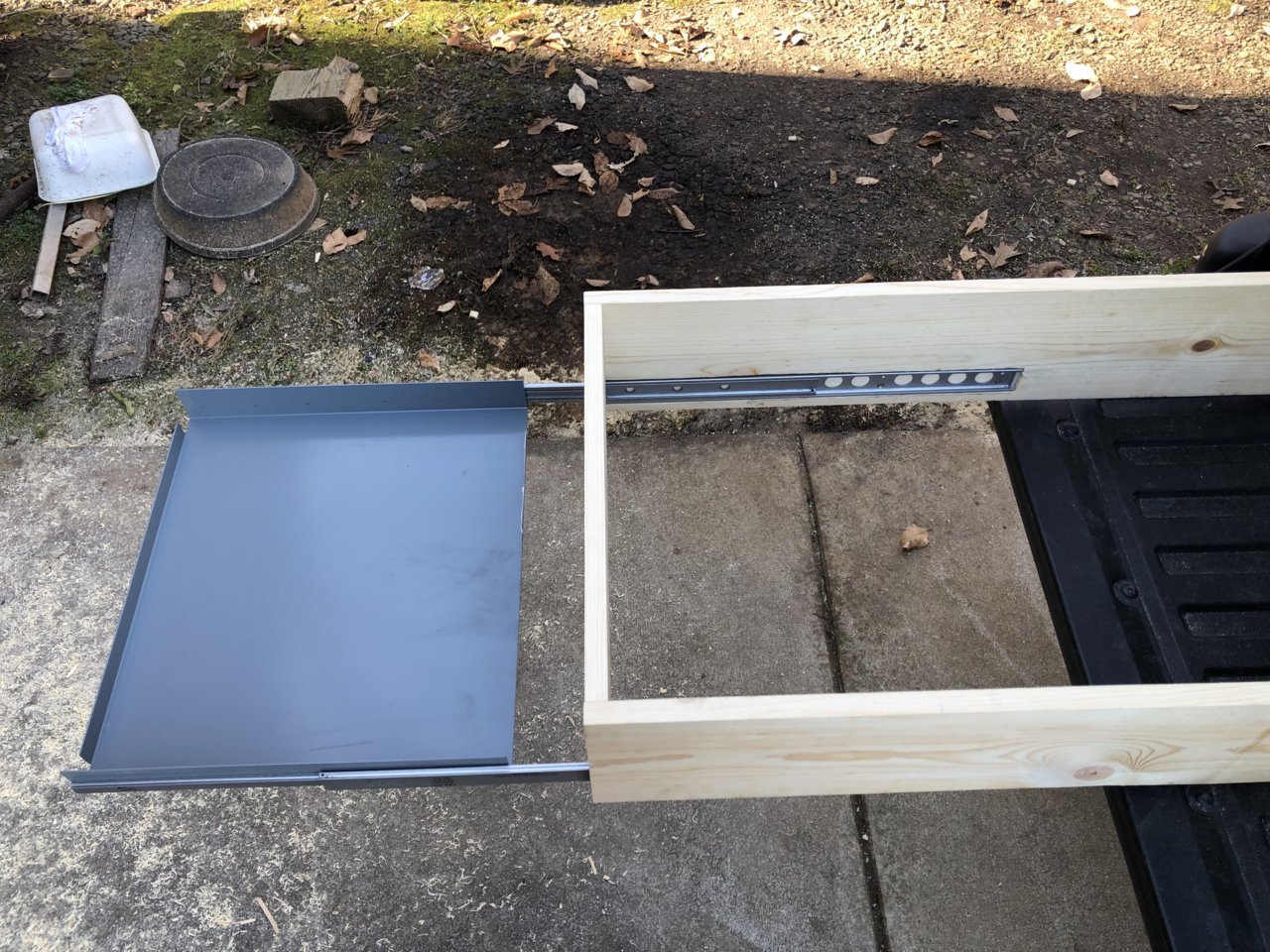

    F0DE0A89-CE3D-4CA8-87F0-88FA922B9BB3.jpg E05718BD-2B69-4421-A43C-D1742CC01314.jpg 548D457D-0F4B-4B91-B39A-595F1B454674.jpg
    More progress today. Carpet cut to fit for the drawers. Sanded all edges of both drawers as well as the top platform pieces. Sanded the shit out of it.
    Also put my rod tube holders in. They are sweet. And judging by how loose the bolts for my topper were it was about to fall off anyways, so, glad I did it.

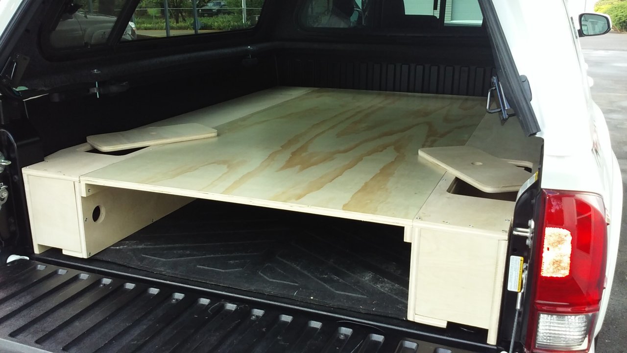

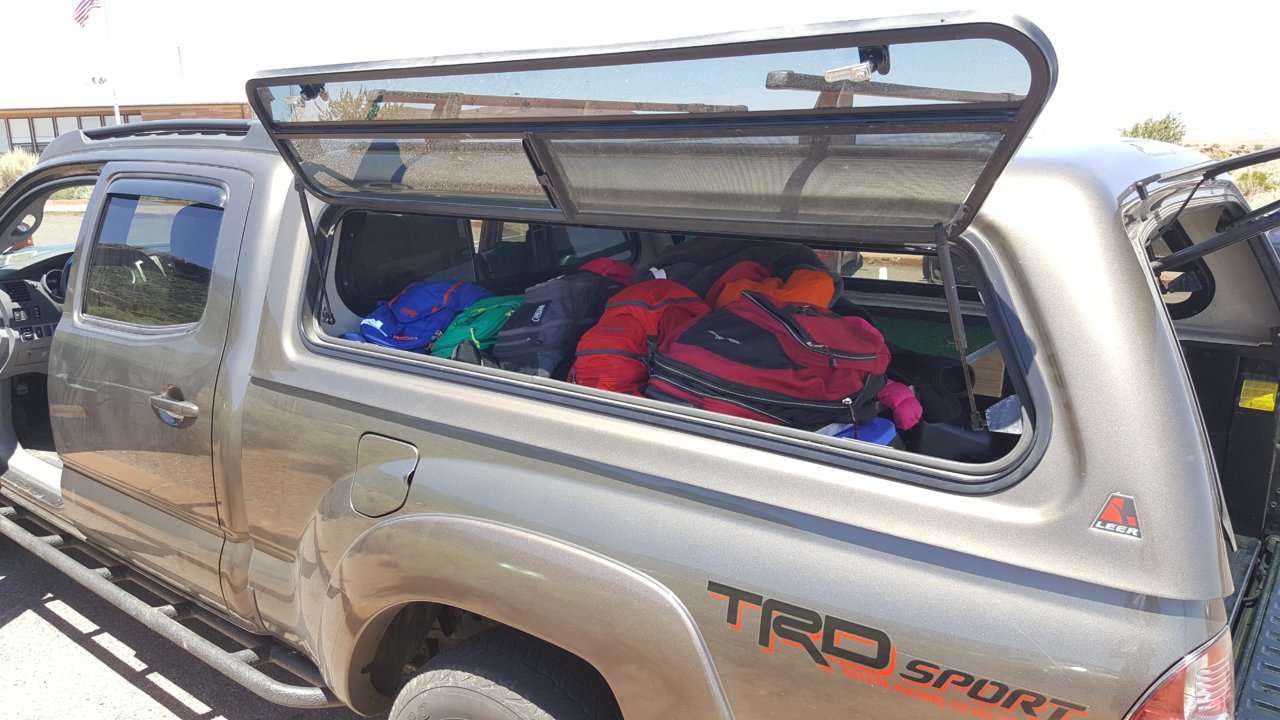

    Just getting started

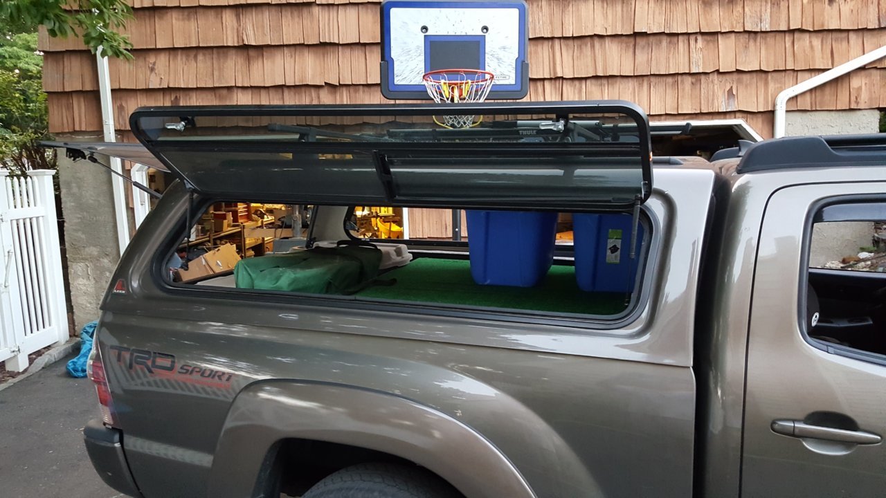

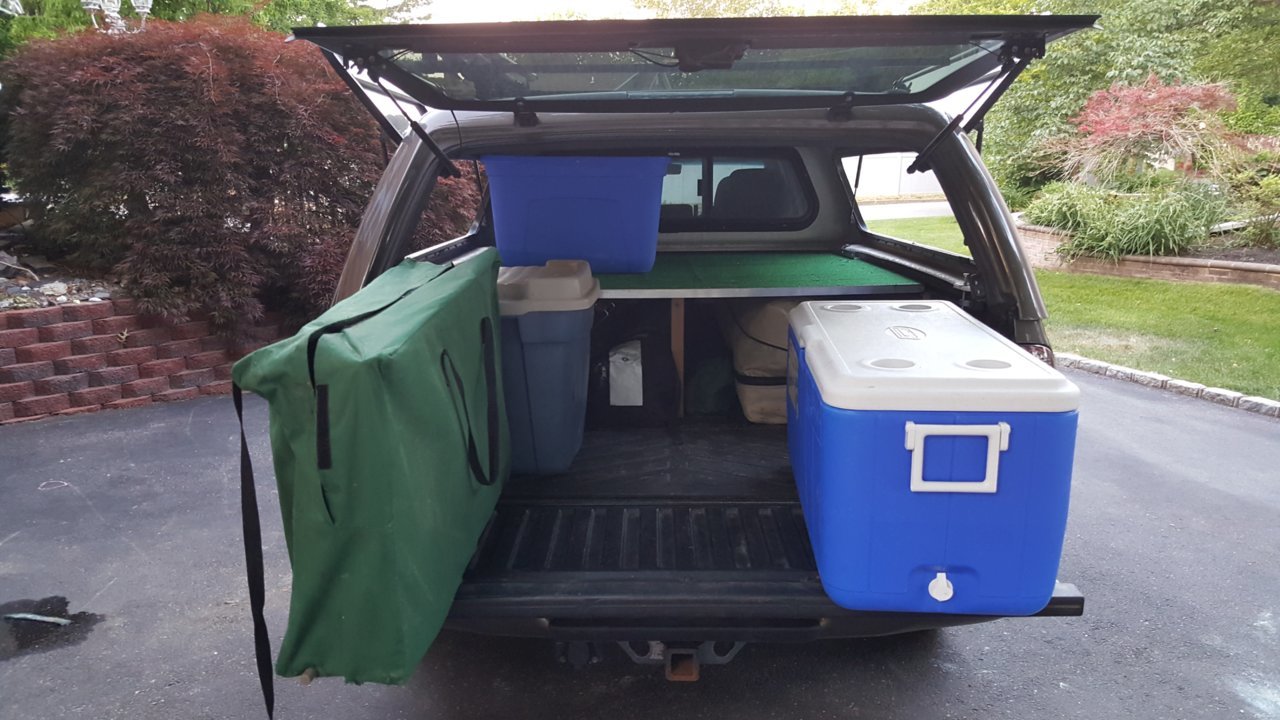

    I went for a very simple shelf, with a door on each side that lifts up for access through the windoors. Dry storage with levels makes it easy to pack and get to a lot of stuff.
