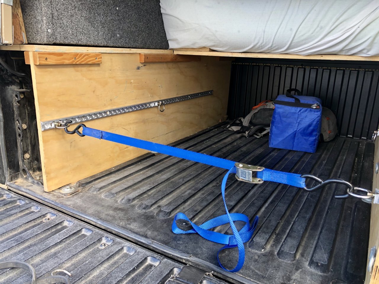

    I put some cargo L-track along each side of my main storage area below my platform. Now I can put a strap across for when I don’t have it full loaded to prevent stuff from sliding back and forth.
    yahoopaul, 2Toyotas and Dye22 like this.

    did you make the aluminum L brackets that are mounted to the shell bolts?

    Yes.

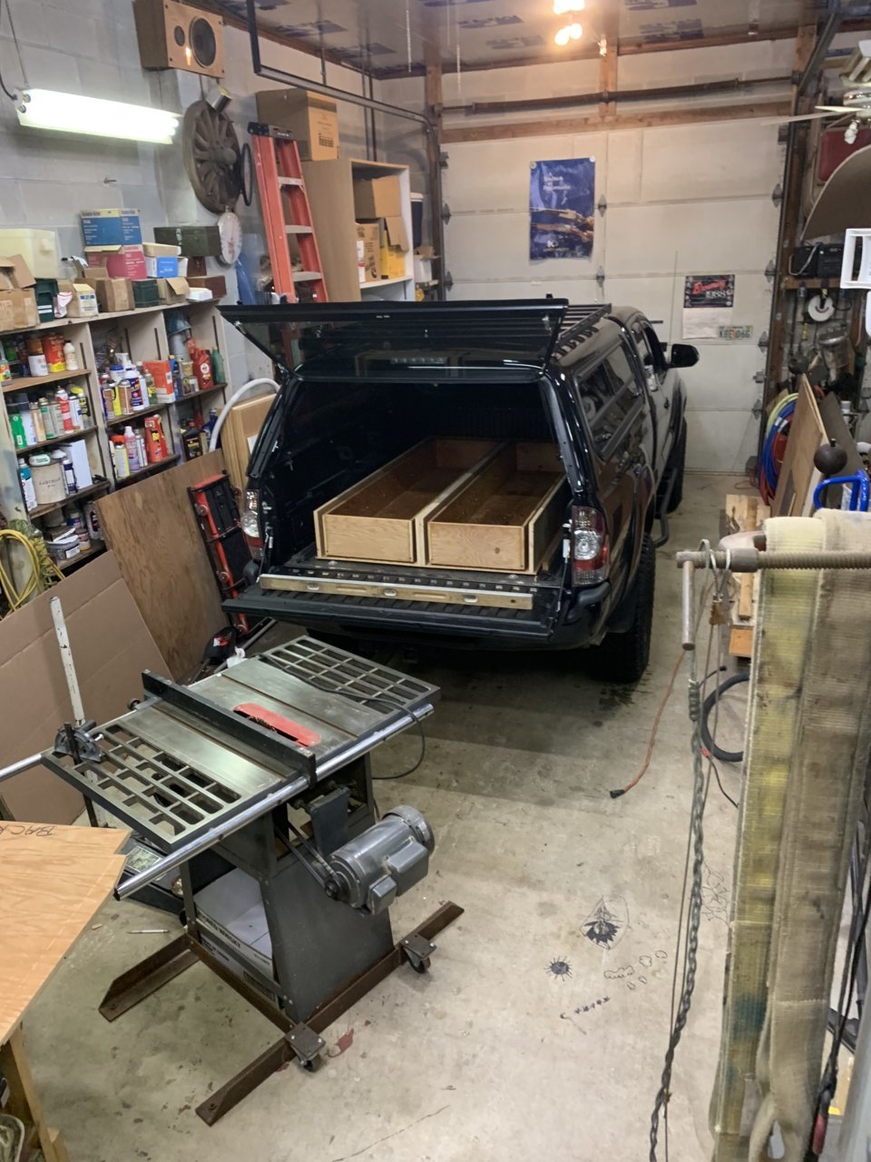

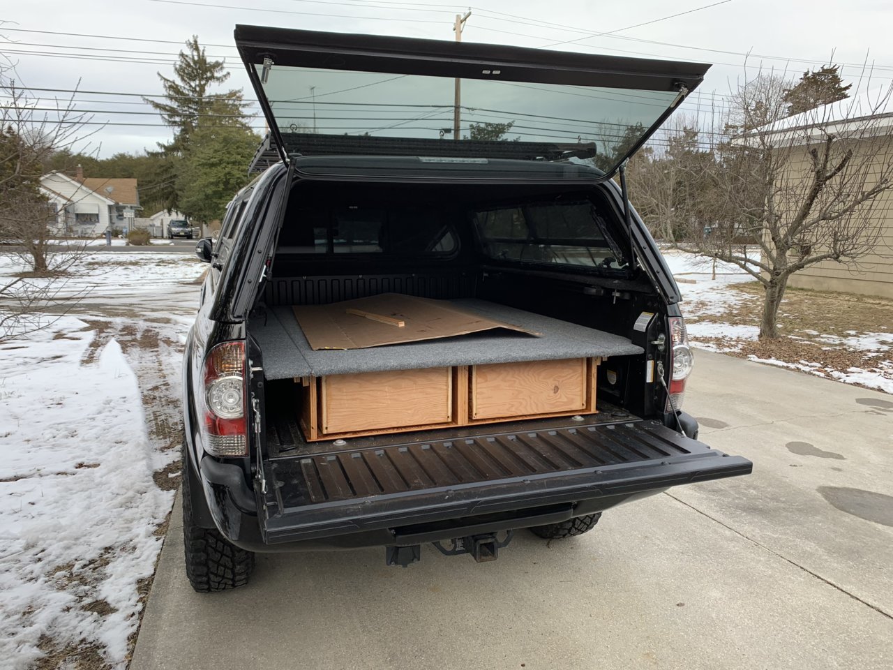

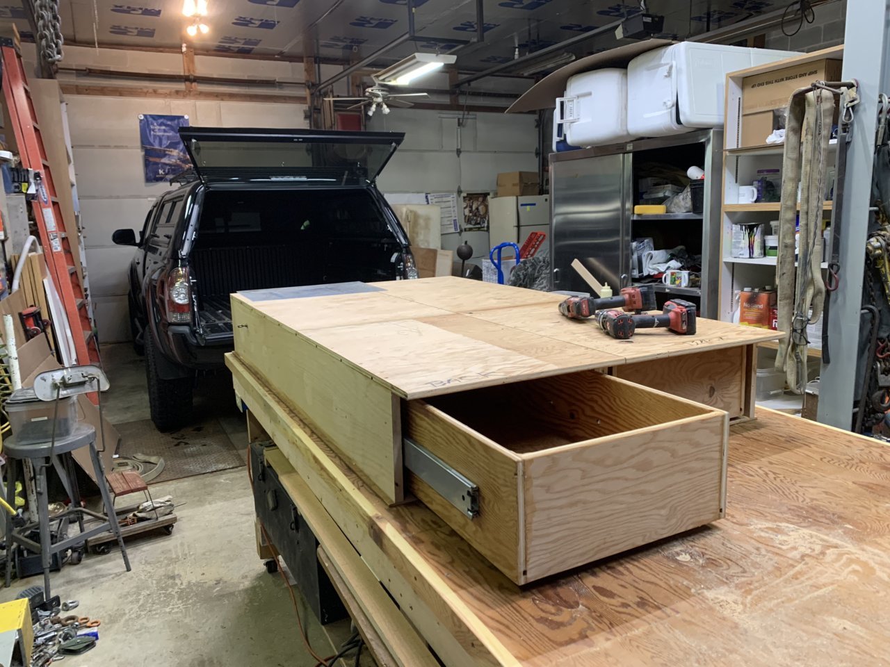

    F7A9B888-507C-4BEB-99B9-9A32353430B6.jpgTest fit make sure all works right
    467E7088-73DE-4DB4-8A0A-BA0526E2FA0E.jpgGlued and screwed the top on.

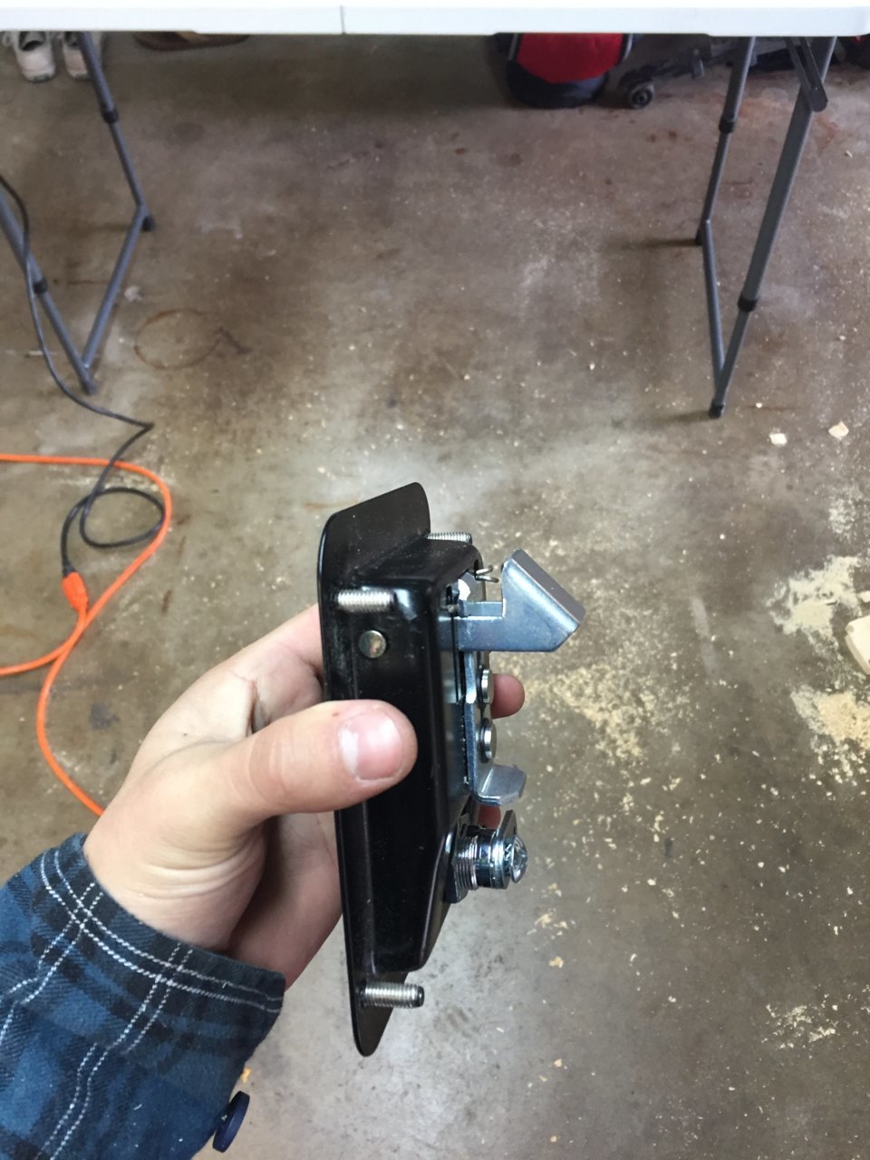

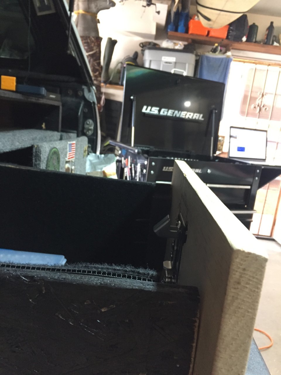

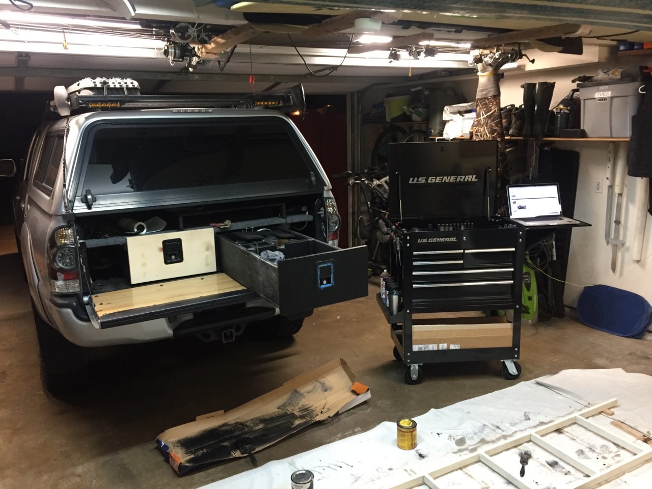

    Update on those latches. They're working out so far. I had to route out the holes a bit because the bolts on the latches are pretty short. Also had to cut out the drawer dividers because the catch hangs down so far. I could have mounted the latches higher to eliminate this. Didn't really think about it. Now painting the drawers black. Also did a diy TrekPak with corrugated plastic and black carpet.

  6. Jan 16, 2019 at 5:04 AM
    #1346
    p_chinnici
    p_chinnici Well-Known Member
    May 11, 2017
    #218757
    662
    Pete
    South Nj
    2015 Trd Pro Access Cab, 2.5 Kings, Dakars
    2.5 Kings all around, HD Dakars -1 OL, Camburg Moog BJ UCA, Leer 100r topper, Prinsu rack
    Looks good. Did lay plywood on the tailgate, or did you remove the plastic corrugation?

    I took off the stock tailgate skin and layed it over the wood and traced it out. The wood is some flooring I had laying around.
