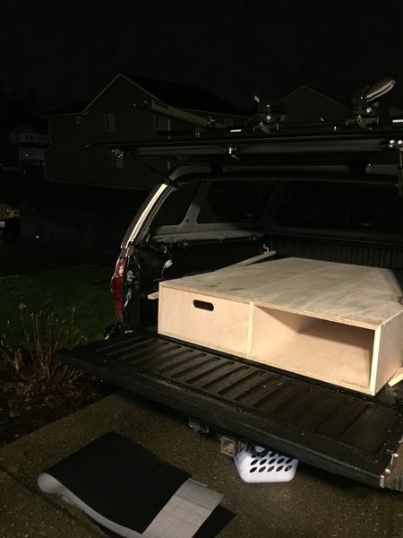

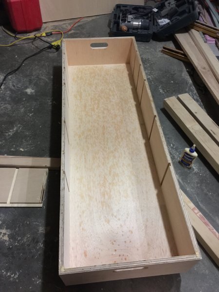

    I put this together a day before I left for a big trip. It started with the fridge needed to stay in place without moving around pulling the power cord out, so I figured I could make a drawer to go along with it. Only used to sheets of plywood so cost was less than $50.
    Drawer slides on the bed itself, not the smoothest but stays put when moving around. Fridge is bolted to a sheet to keep the fridge in place while moving and allows me to slide it out onto the tailgate for easier fridge access. Platform is supported by 2 running pieces on each side of the drawer, the drawer itself also acts as support. Behind the fridge is a false door for less used items, another false door behind the drawer for spare parts. Another small sheet is used to cover the end of the drawer when pulled out for a sleeping area, also doubles for a raised counter when cooking instead of having to push the drawer in and out to grab stuff it just stays pulled out.
    Not the best looking but after I get home Ill get some pads under the drawer to slide easier, wrap the entire thing in fabric and make it look decent. Its nice to have the fridge running 24/7 now

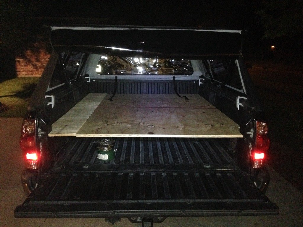

    @snwcmpr I'm using 2x10 in the stock notches in the bed. It required a little trimming in order for the top of the 2x10 to sit flush. Sitting flush allows for the plywood to sit flush all around. The 2x10 holds me well although it has a very slight sag in the middle. Adding a support in the middle would prevent the sag and wouldn't pose any problems to the storage underneath unless you have very wide things stored under the plywood. For my use the simplicity of no vertical supports outweighed the sagging. This set-up can be installed/removed in 2-3 min by one person. Nothing is screwed together just set into "place".
