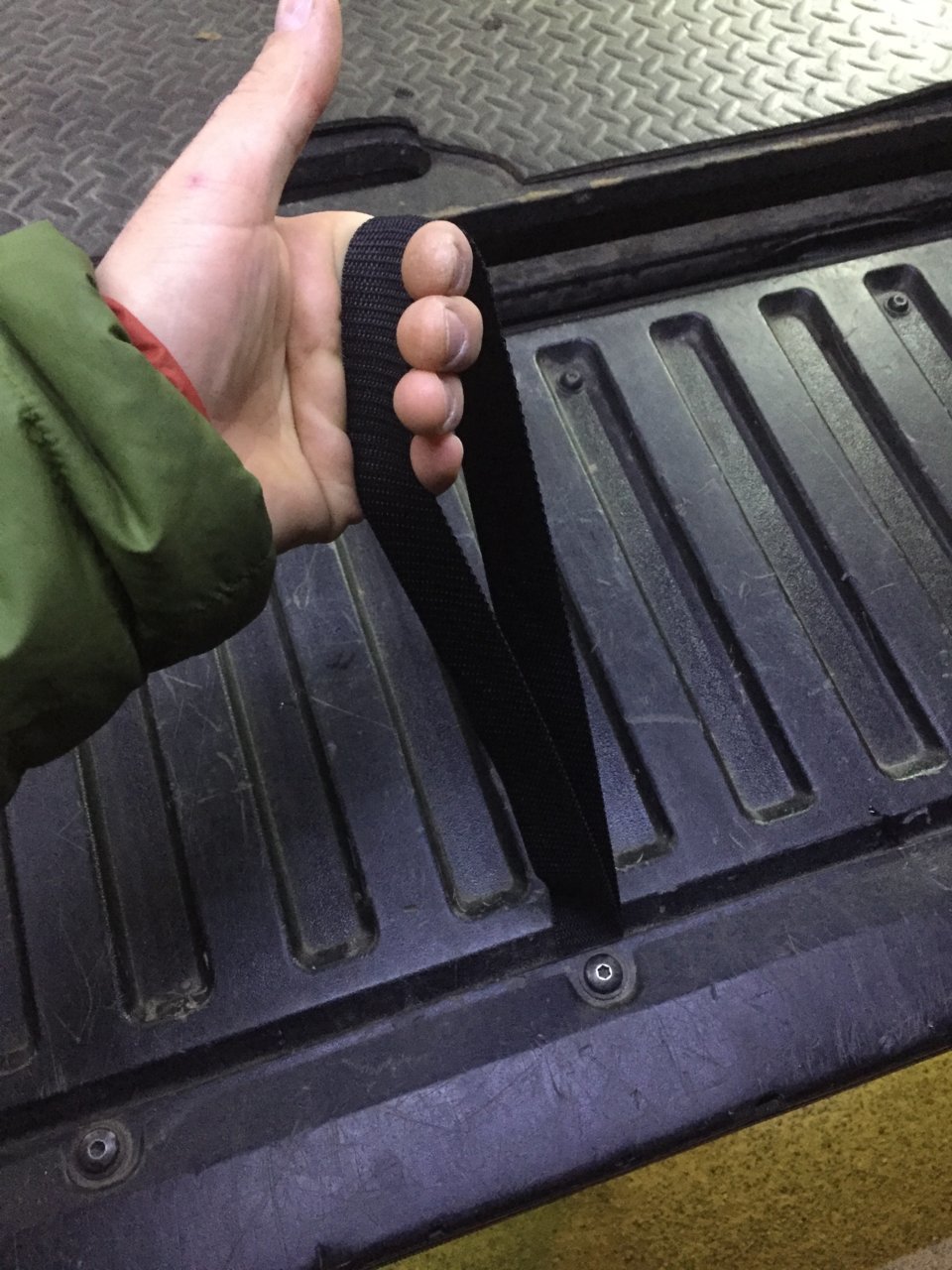

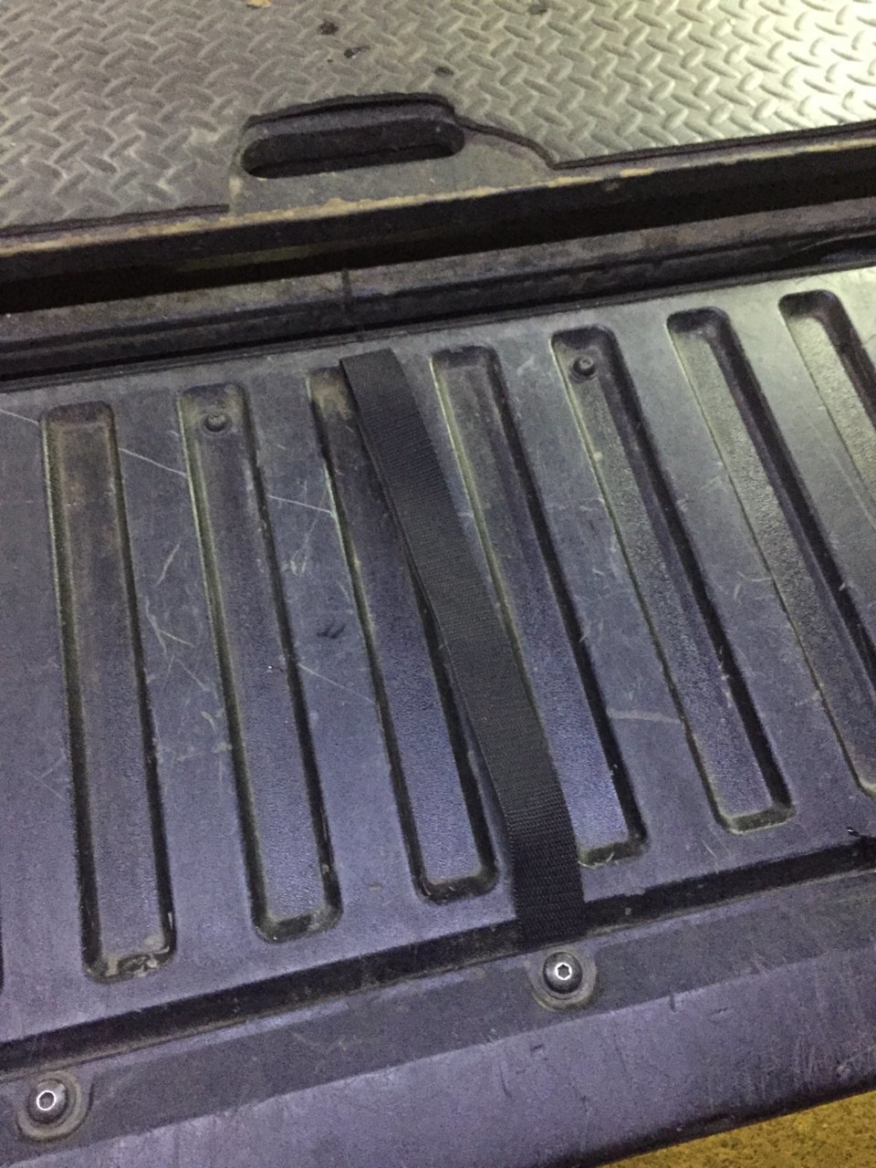

    I took two feet of 1" webbing from a ratchet strap, bolted the ends under the middle tailgate cap screw.
    It creates a loop to pull when you get it. It's soft and thin enough that it never gets in the way either.

    The same shit everyone else has.
    This is what I did too.
  6. Feb 26, 2019 at 8:34 AM

    Thanks, it is very self explanatory but, do you happen to have a pic? Cheers
