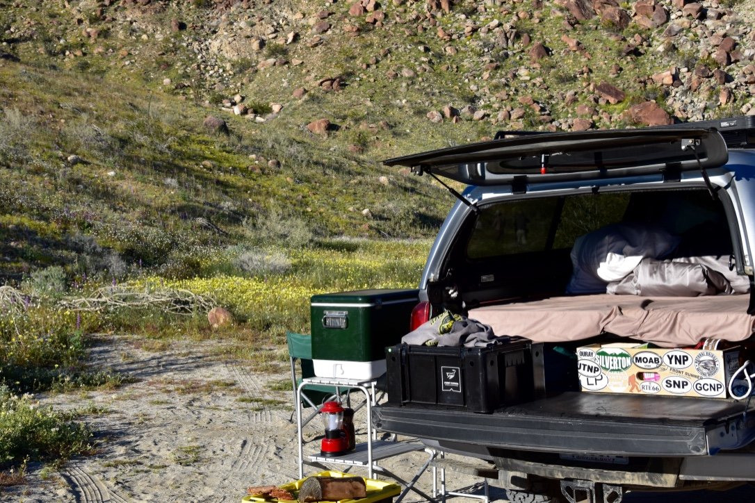

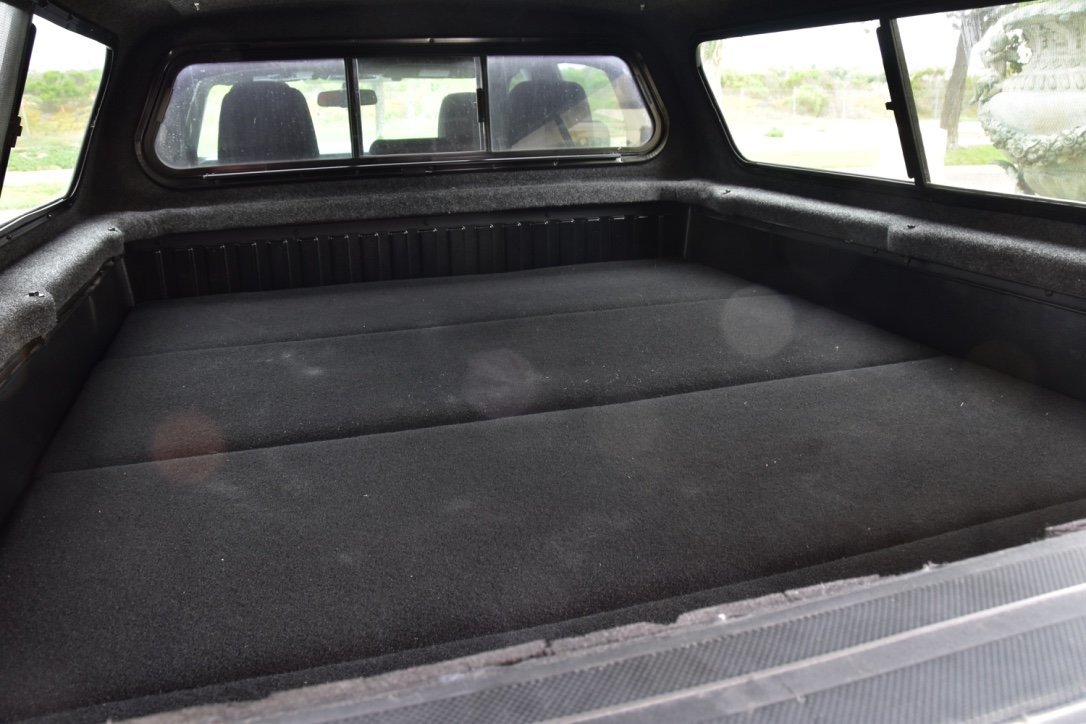

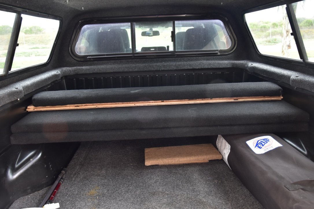

    1" ply in 3 larger and one smaller section, no additional support, carpeted and 3' foam pad. Sometimes I regret not getting a taller shell but this setup works great for me.

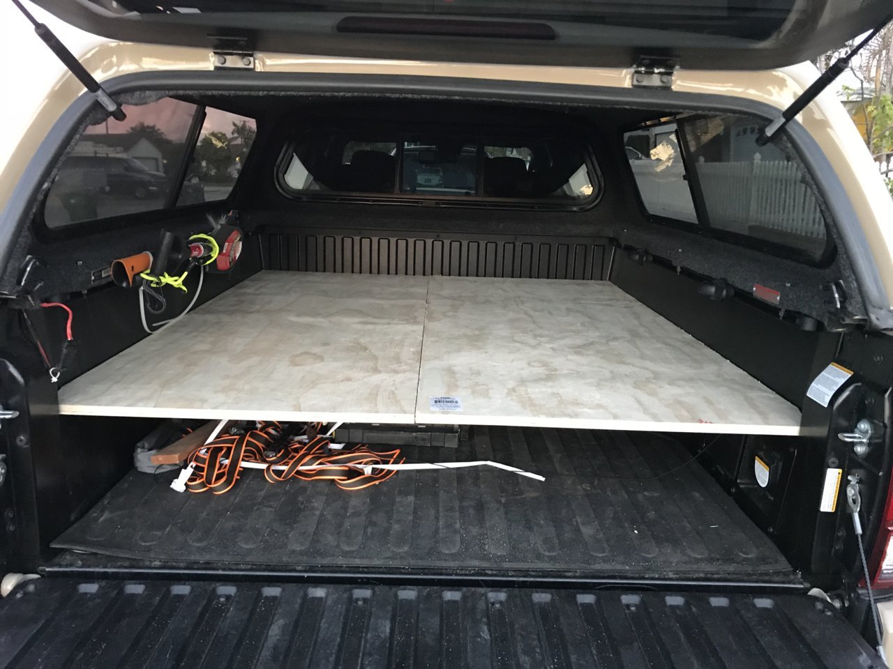

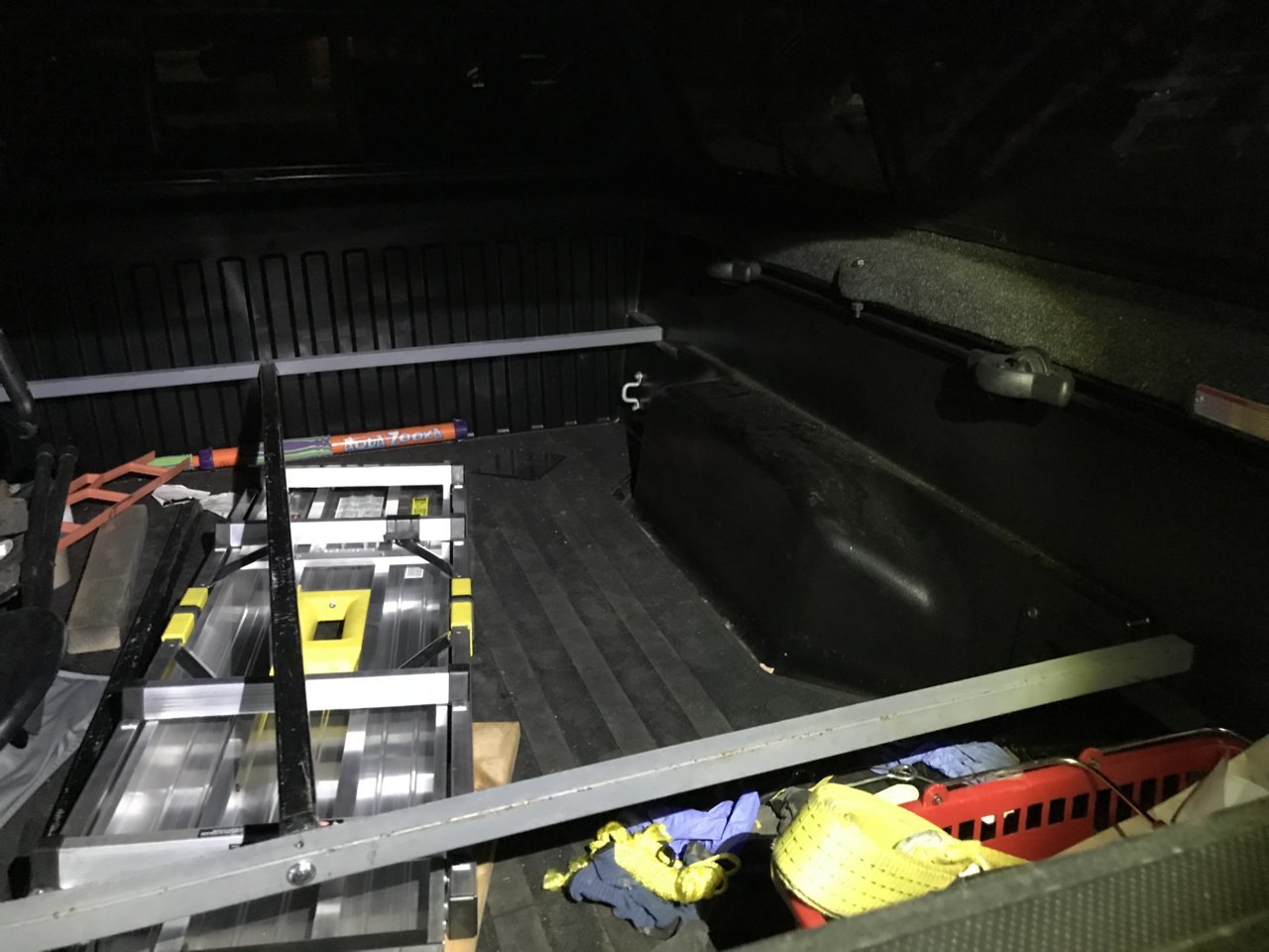

    How are the guys with stock suspension handelind the extra weight? With the platform, shell, and a roof top tent in felling the added weight pretty good. And that’s without any supplie. I figure the shell, tent, and platform adds 500lb.
    And my platform is pretty basic just some steeep cross bars for support and plywood base.

    DANG!!! 1 inch plywood?? why did you go with such a heavy sheet?

    Right? I went 3/4 and I wonder if I should have went 1/2 to save on weight.

    Yeah, rule of thumb for weight is 100 pounds per inch for a 4x8 sheet.
