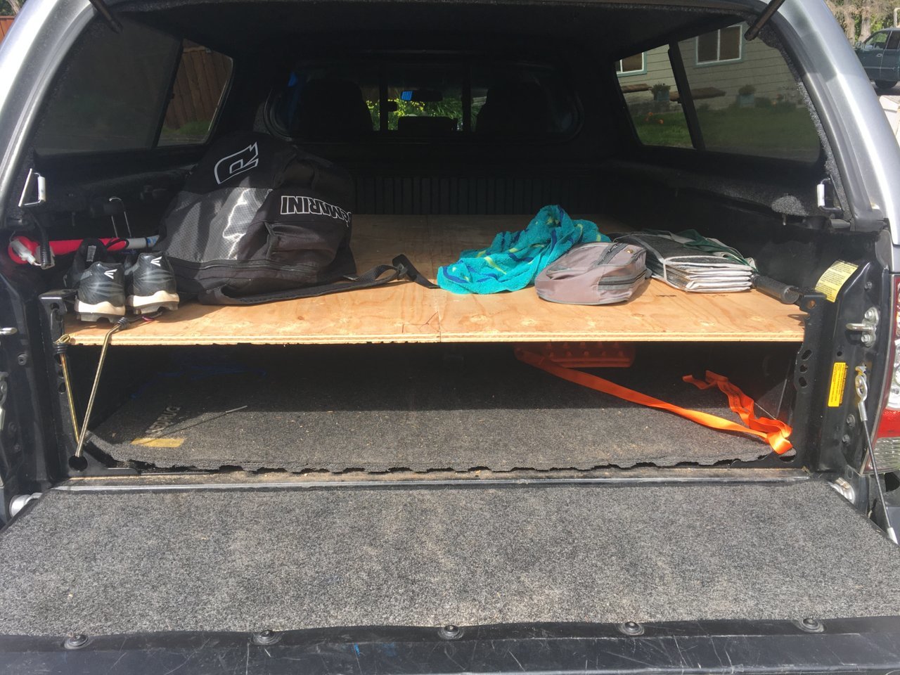

    He didnt want any under supports. So in total it possibly is lighter like this, but definatly less wasted room.

    Truth is, found it on CL when builder sold his truck. Simple to remove and great storage when camping

    My suspension is upgraded with bilstein lift using 6112 coilovers in front and 5160s in the rear. My 3+1 AAL includes the overload leaf. Probably would sag w/ stock suspension.

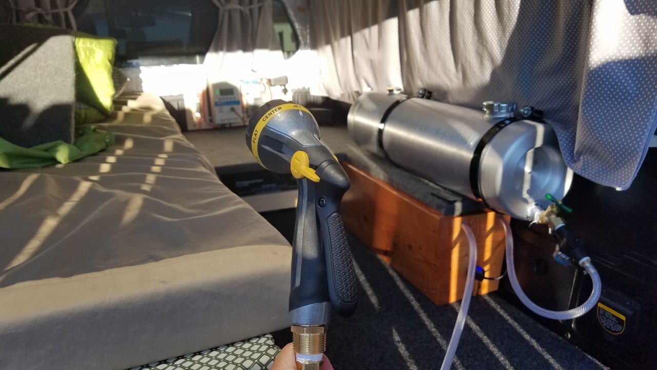

    Where did you get the tank? Looks great!

    how did you secure this to the bed?

    All of them
    It's own weight currently. I need to establish something but for right now I don't have anything haha
    It can't slide out because the drawers are locked into the top, the top is secured to the body and the body is built around the wheel well AND the bed stiffeners would stop it from falling out the back

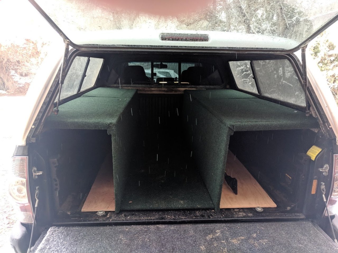

    Here’s mine. 2x8 cross pieces trimmed to fit in the notches and 3/4” plywood. EAF21279-87FE-4C91-B6F7-02240BD80A24.jpg
    Will carpet when I decide if it’s really what I want

    I thought alot about fabbing my own tank out of the way others have done with 6" PVC pipe or like a road shower, but in the end, I decided that the only portion of my system I wanted to pressurize is the line between the pump and outlet handle in order to minimize potential leaks from fittings and the like. It also wasn't much more cost to go out and buy a metal tank.
    I got a 6.5 gal 8" diam aluminum spun water tank from here. Mine is the one with the level indicator on top:
    https://www.ebay.com/str/bam-manufacturing/Water-Storage-Tanks/_i.html?_storecat=14239296015

    Awesome! Never thought into looking at them. Just rv tanks

    I wonder what the pressure rating is. 40-60 psi is hella lower than 3000psi scuba tank pressure. Unless it's literally wafer thin it should be ok for modest pressurizing.

    Yes, it's thin walled spun aluminum. I don't what the pressure rating is, but then again, I am not pressurizing the tank in any way.

    Yes, I saw that. I do know that abs and pvc are derated substantially with not much heat but aluminum should be better.
