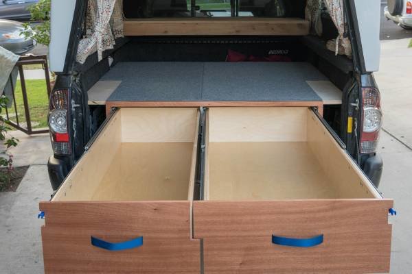

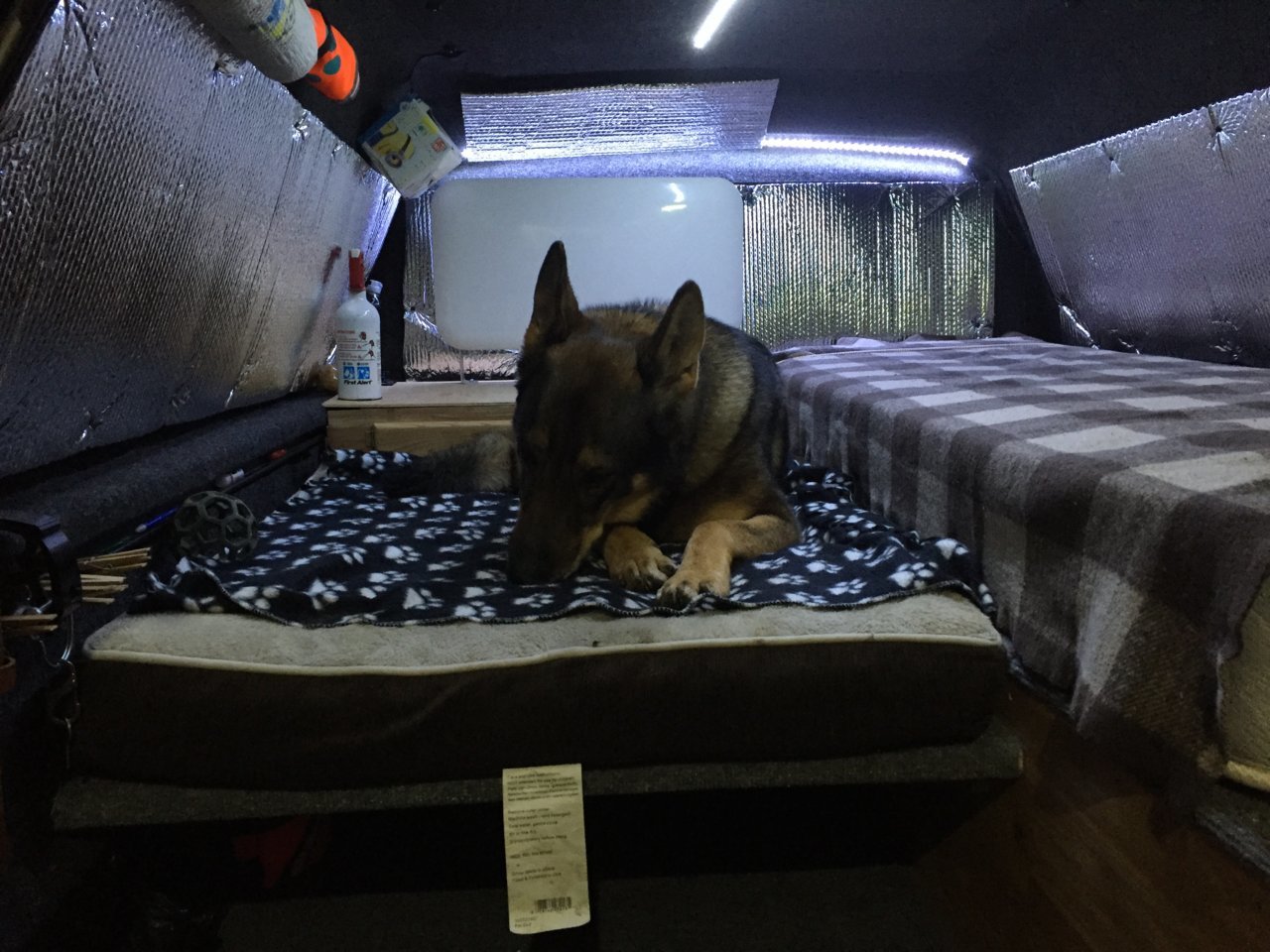

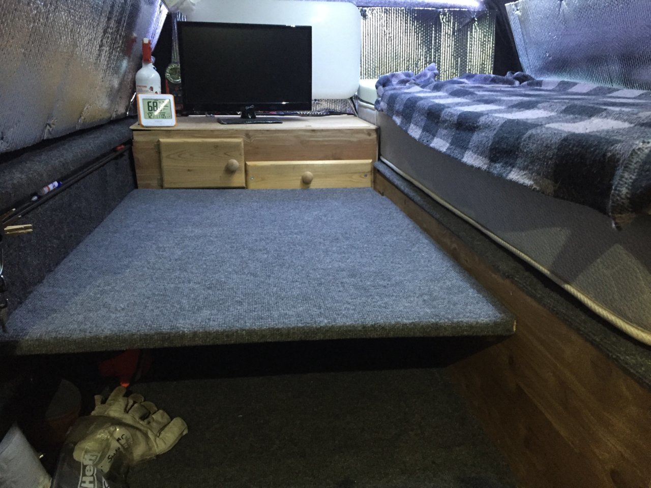

    ARE MX shell, BFG all terrains, hell wig add a leafs, Wet Okole seat covers, bedrug,

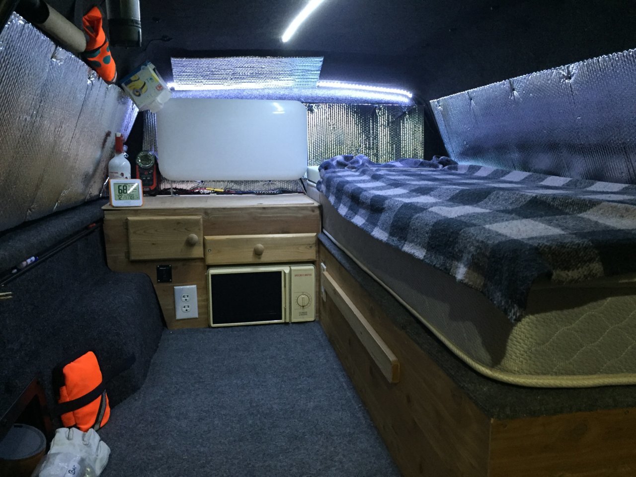

    Yeah I kinda got carried away on this:rofl:It started as a weekend project and turned into a month of tinkering with it and I've been making changes to it here and there ever since.

    13 TRD Sport Double Cab Long Bed
    Looks great! :thumbsup:
    Can you say anything about your heater? Brand and power type/consumption?

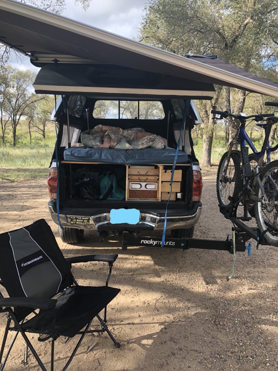

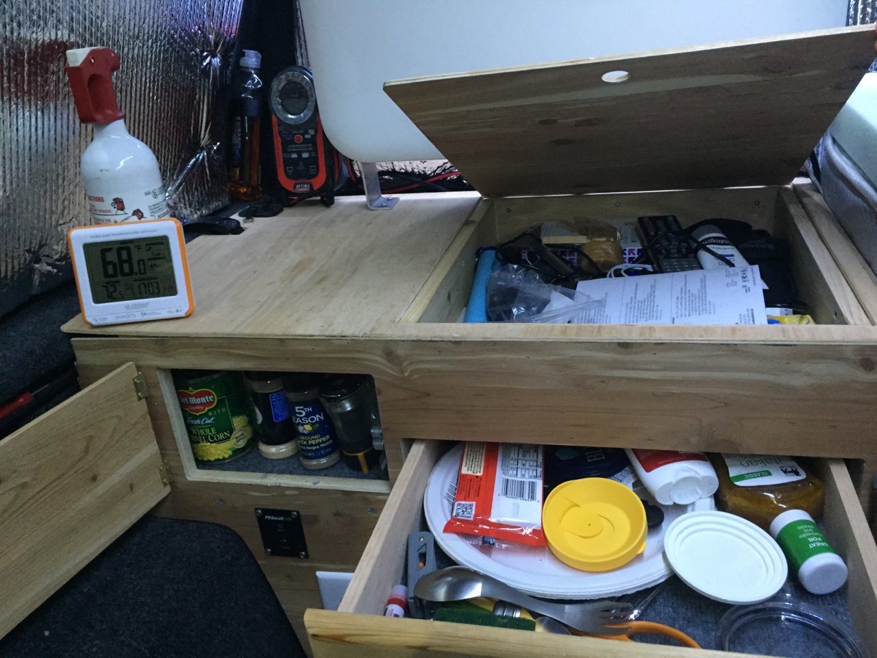

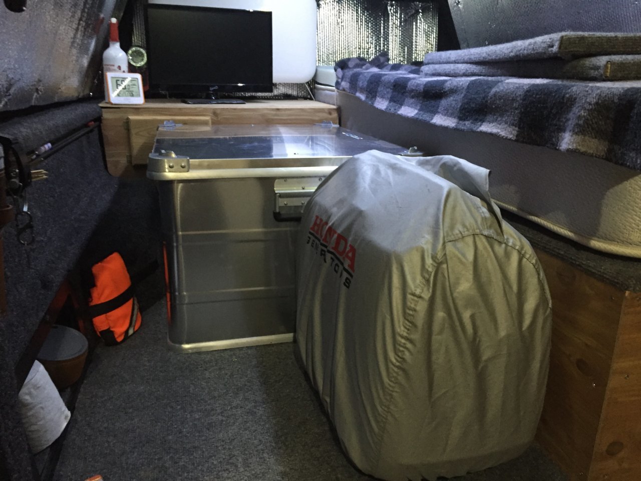

    Its a Mill brand safety heater, it has 3 output settings, 600, 900 and 1500 watts, 120 volts. I originally had one of those cheap heaters you get at Walmart but couldn't regulate it, it would either freeze you or run you out. This one works really well, I spent 9 nights in it last December with lows in the teens and on the lowest setting it I was comfortable. I have yet to use the other settings. I made brackets and bolted it to my cabinet but it comes with its own feet. I use it with a Honda eu2200 and a 2 1/2 gallon extended run tank and it would last 3 nights without running out. Just search safety heater on Amazon, its a little pricey but works great. You can see in the picture its only about 3" thick which makes a big difference in a little taco bed, really nice thing is I can adjust the thermostat without getting up as the thermostat is right beside my pillow.

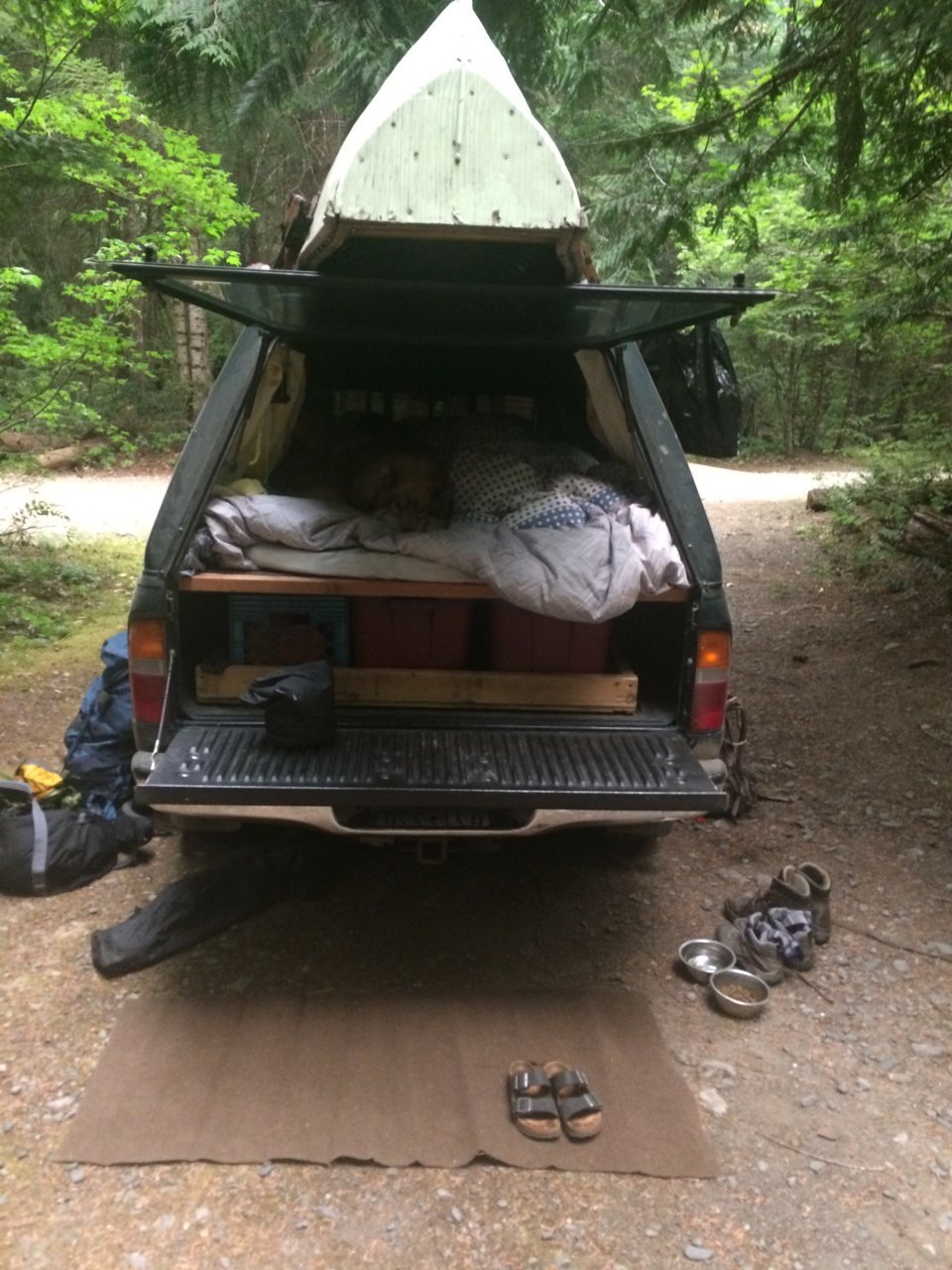

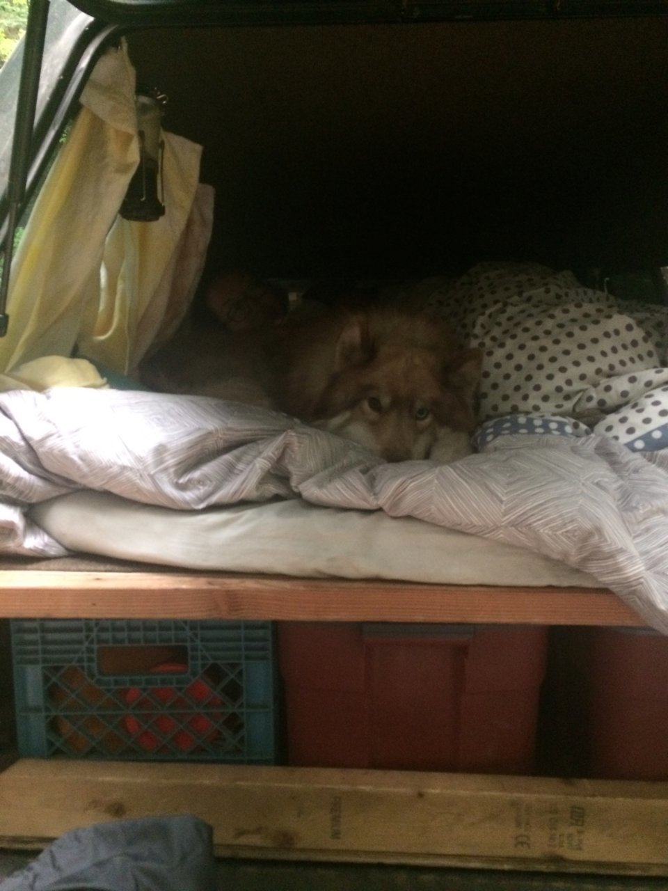

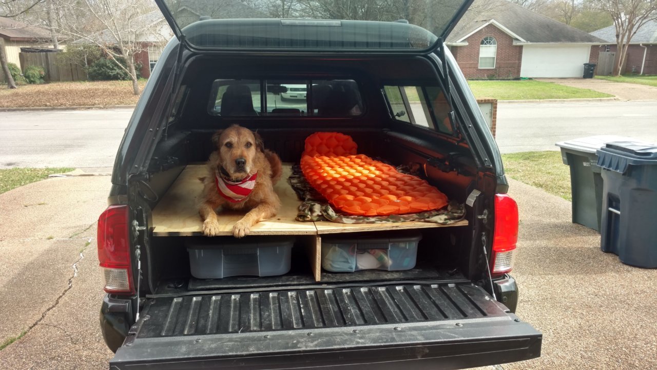

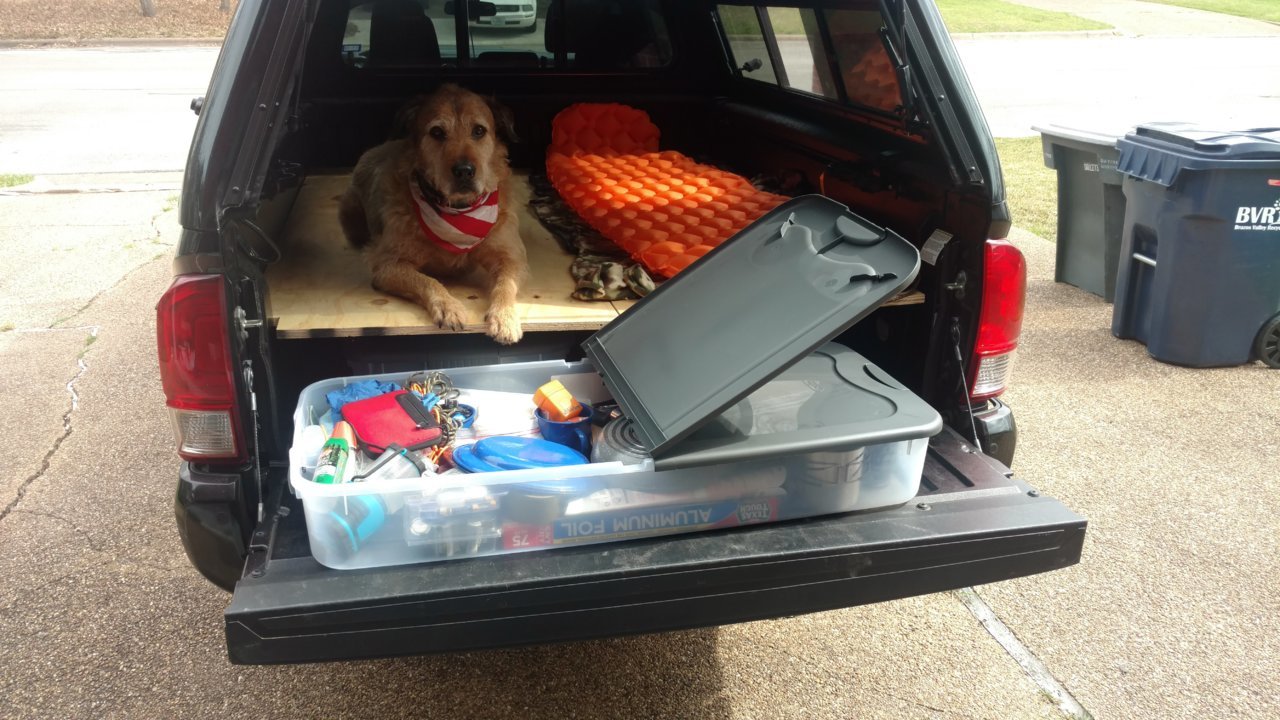

    #137386
    154
    07 Tacoma
    Snugtop, lift, Prinsu Rack and lead foot.

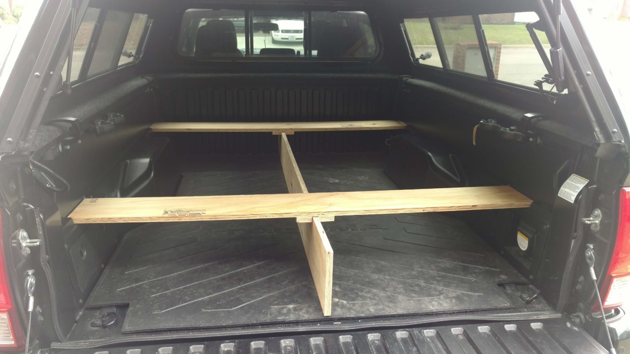

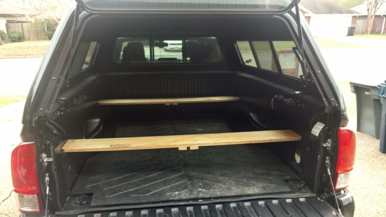

    I built a platform out of two laminated boars that were placed inside the grooves. I had these boards notched to keep the tops flush with the top of the ledge. The Two parts of 3/4" plywood were cut and put in place snugly. The entire set up can be quickly removed for full use of the bed without tools and store in the garage easily. I used the outdoor carpet available at Lowes for the covering of the plywood and attached it using the marine grade carpet epoxy and staples from the Bostitch stapler. I opted to avoid using drawers to reduce weight and not lock me into always requiring the drawers to be installed. Instead, I used i3300 Pelican Storm cases that easily pull out and can be tuned sideways on the tailgate. The storm cases also have the benefit of keeping anything inside them extra protected from water and moisture. I can fit two of the i3300 cases and a 60" hi-lift jack or maybe a narrow case.

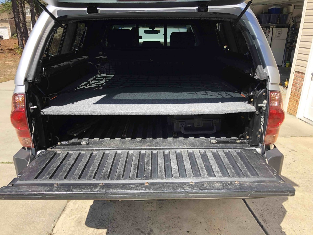

    I think the new Pelican Vault line will also work well in that setup. Two V800s should fit two between the wheel wells, and be just short enough to fit in the SB as well:
    https://www.pelican.com/us/en/product/cases/double-rifle-case/vault/v800
    Exterior is 56.11" x 19.15" x 6.65". You probably couldn't also fit the HiLift with 2 V800's though.
    I have the V730 and it fits in one "tunnel" under my platform (center divider). It's the same width, but slightly taller (6.9" vs. 6.65") and shorter (47" instead of 56" long). My platform is also setup to have the surface sitting on the side lip, but I do have a full width support board as well. The V730 fits under it perfectly, and I can fit the V730 down either "tunnel".
    The Vault series aren't quite as "bombproof" as the original Pelican, but overall I've been very happy with the V730, especially given the cost savings and the fact that there isn't an original Pelican with remotely close to the same dimensions.

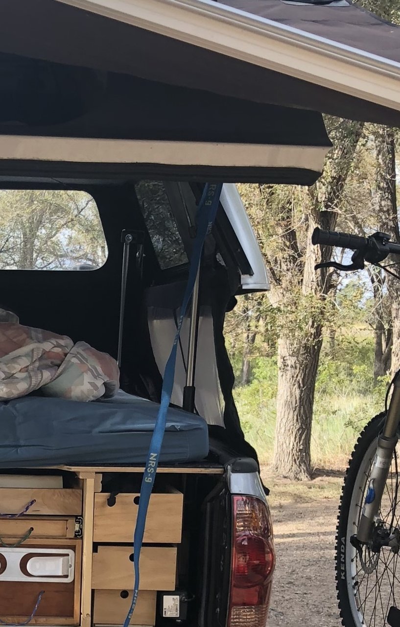

    Quick and simple for holding your window where you want it - ie 30 degrees, 45 or 90. use a piece of para cord with multiple loops tied in and then just loop one end over the t handle (my rear glass has a handle on each side)and then the end loops around the strut mount pn the shell- just adjust the distance between each loop for the amount you want the window open. Pic below shows where i just used a cam strap before rigging up the para cord. Only pic i have since i have removed the shell in anticipation of selling it
