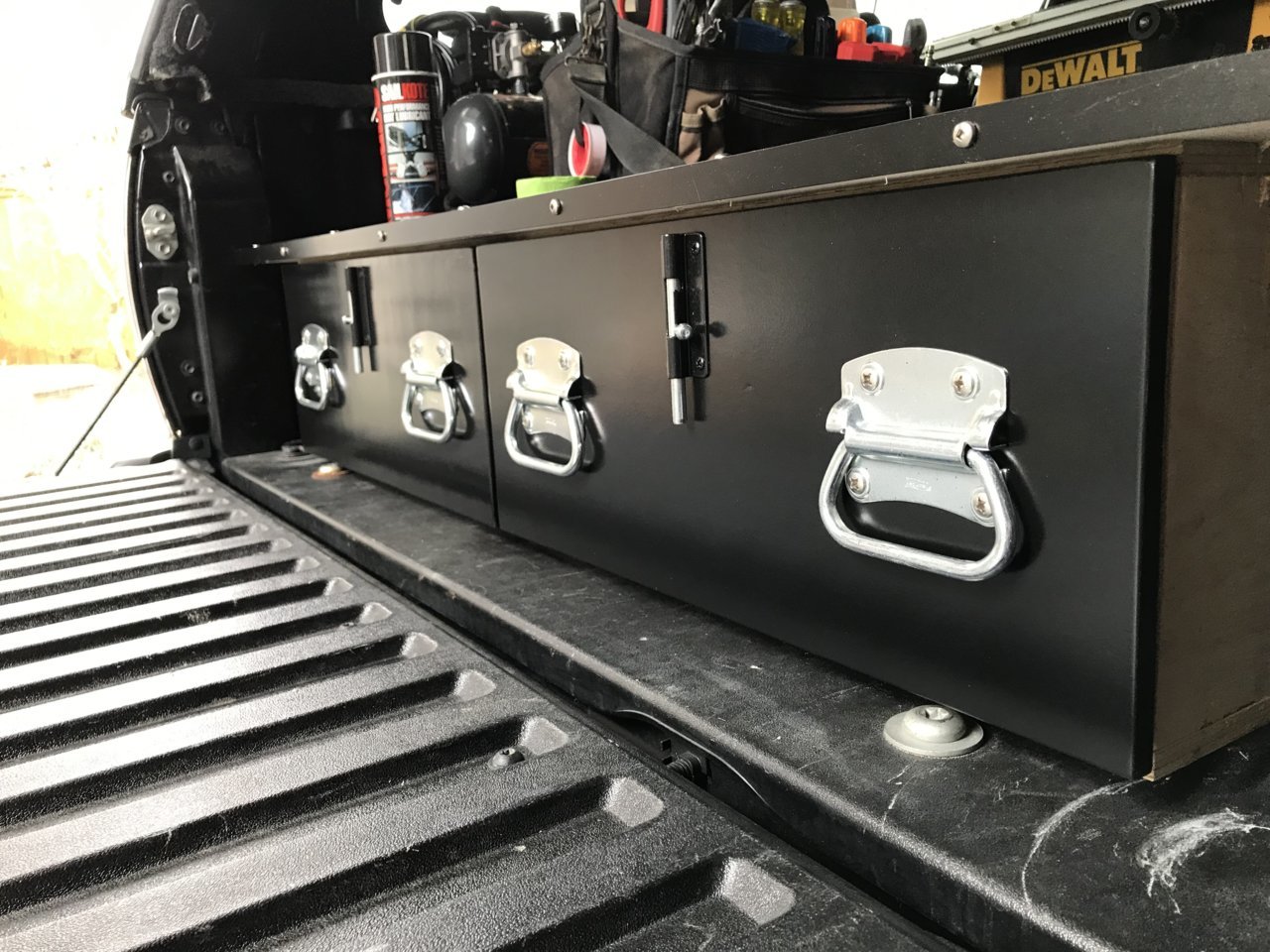

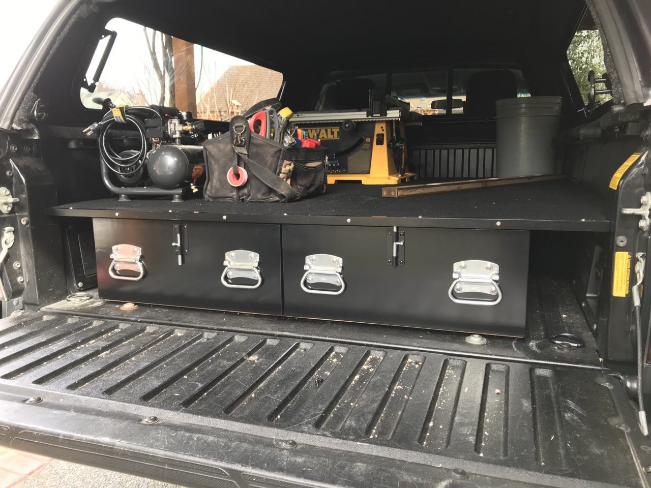

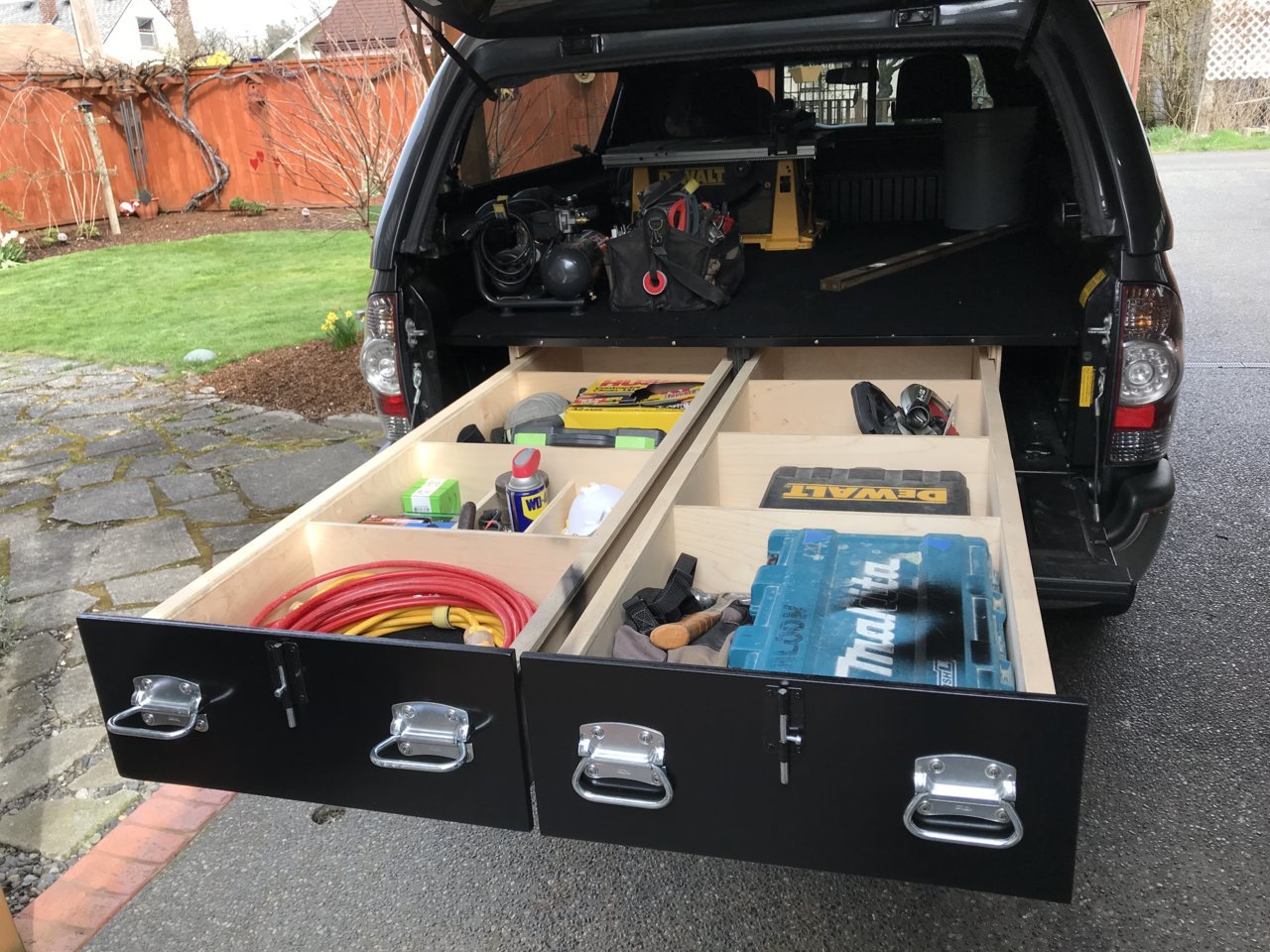

    I built this all out of 1/2 plywood, so its fairly lightweight. Just guessing, but I think around 170 lbs. Two units , basically a drawer in a box. Its easily removed, and I have the option of taking just one drawer/box out, leaving half the bed open. The drawers are 67" long, 18" wide and 8" deep. Glides are 1" strips of 1/4" UHMW plastic, sprayed with McLube sail track spray. Effortless open and close even when loaded with tools and fasteners.

    How did you paint it?
