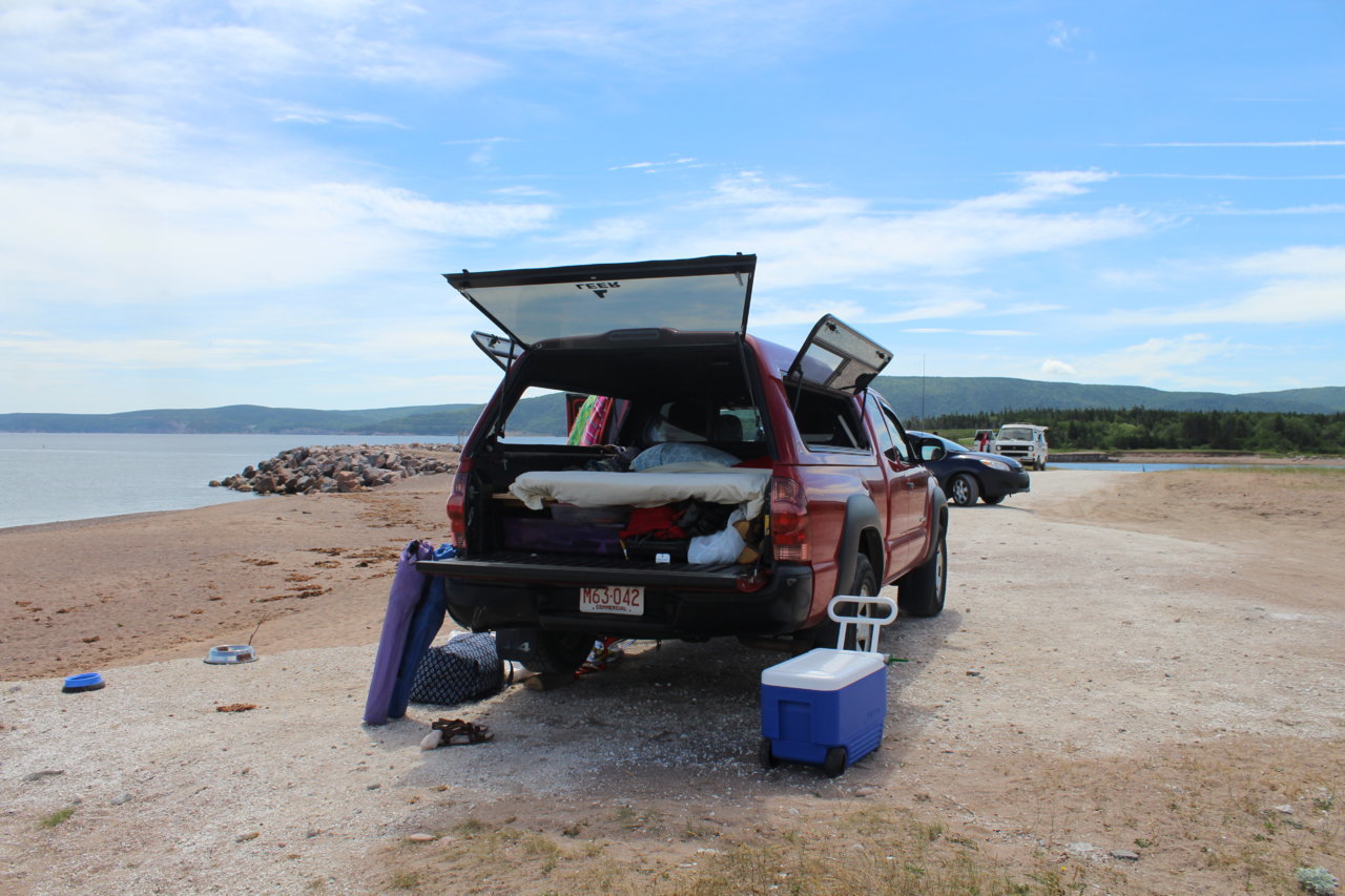

    Some do fold out extensions but I think short beds is one reason why RTT's, flipacs, and cab over pop tops (4-wheel camper) are so popular.

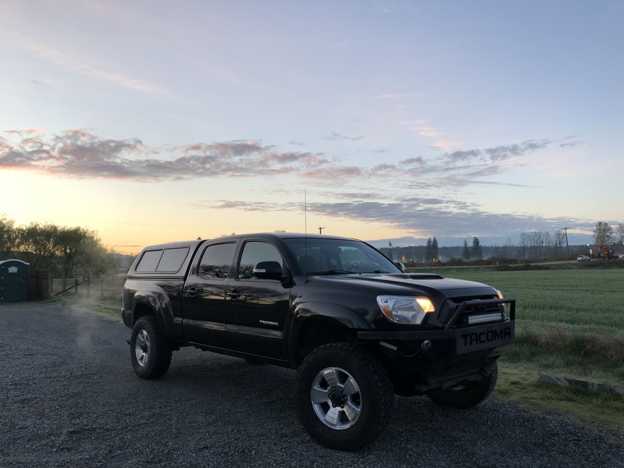

    Last night, I bought a canopy for my 2012 Double Cab. Will be starting my platform this weekend, and it is designed to be used for the next few months of camping while working on the road. Can’t wait to start this little project and hopefully develop it into some like seen here!
    Before:
    After: (Removed plasti dip for a refrehser)
