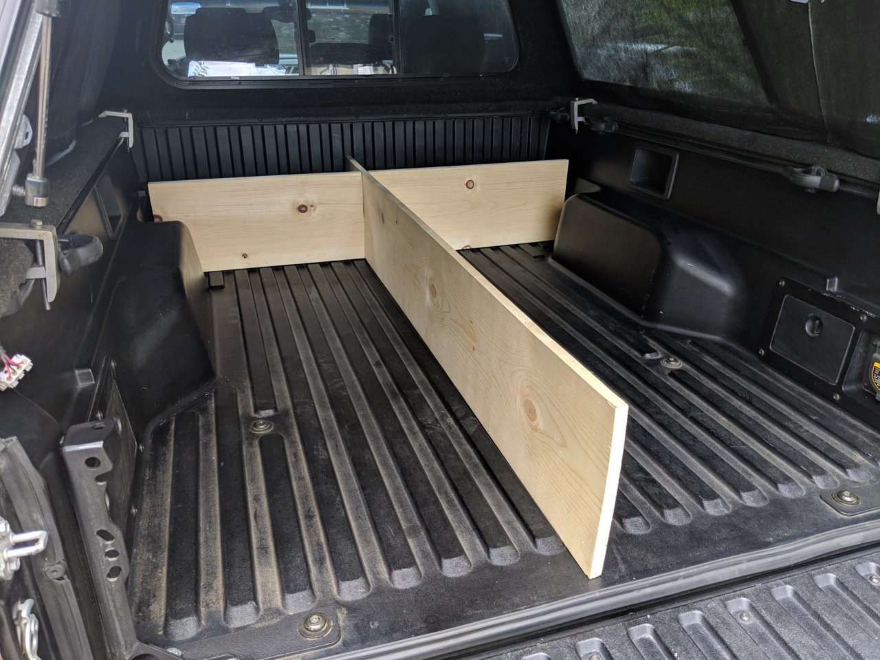

    This is what I did. 1"x12”? (Maybe wider)boards that I interlinked into a "cross" near the front of bed where I had plans to out a second battery there.
    It's good enough for me but not super sturdy.

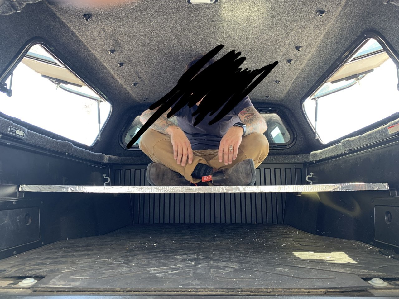

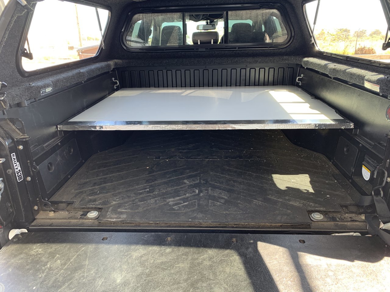

    Made a "2/3 platform" from a Thermoplastic Panel. Had to notch three small sections on the passenger side in order for it to drop down because of the SnugTop. 14 lbs. overall and no need for a middle support.

    Interesting!
    Why only 2/3?

    Because I’m not sleeping in the bed, but using it more for organization. My kids can sleep there though, side to side.

    Nice! Where do can I find panels like this on the retail level? Most google returns are for decorative panels of minimal thickness.

    I would look on the Plascore site for a dealer in your area. They usually stock the 1" stuff. I think shipping one panel would be cost prohibitive.

    If you read the site, they will sell 4x8. They say it's not economical to ship.

    That's why I would check with regional Plascore dealers and ask them about the specifics of the application. Make sure the panel has oriented or chopped glass reinforced polypropylene facing both sides.You might be able to pick up a sheet and avoid shipping fees.
