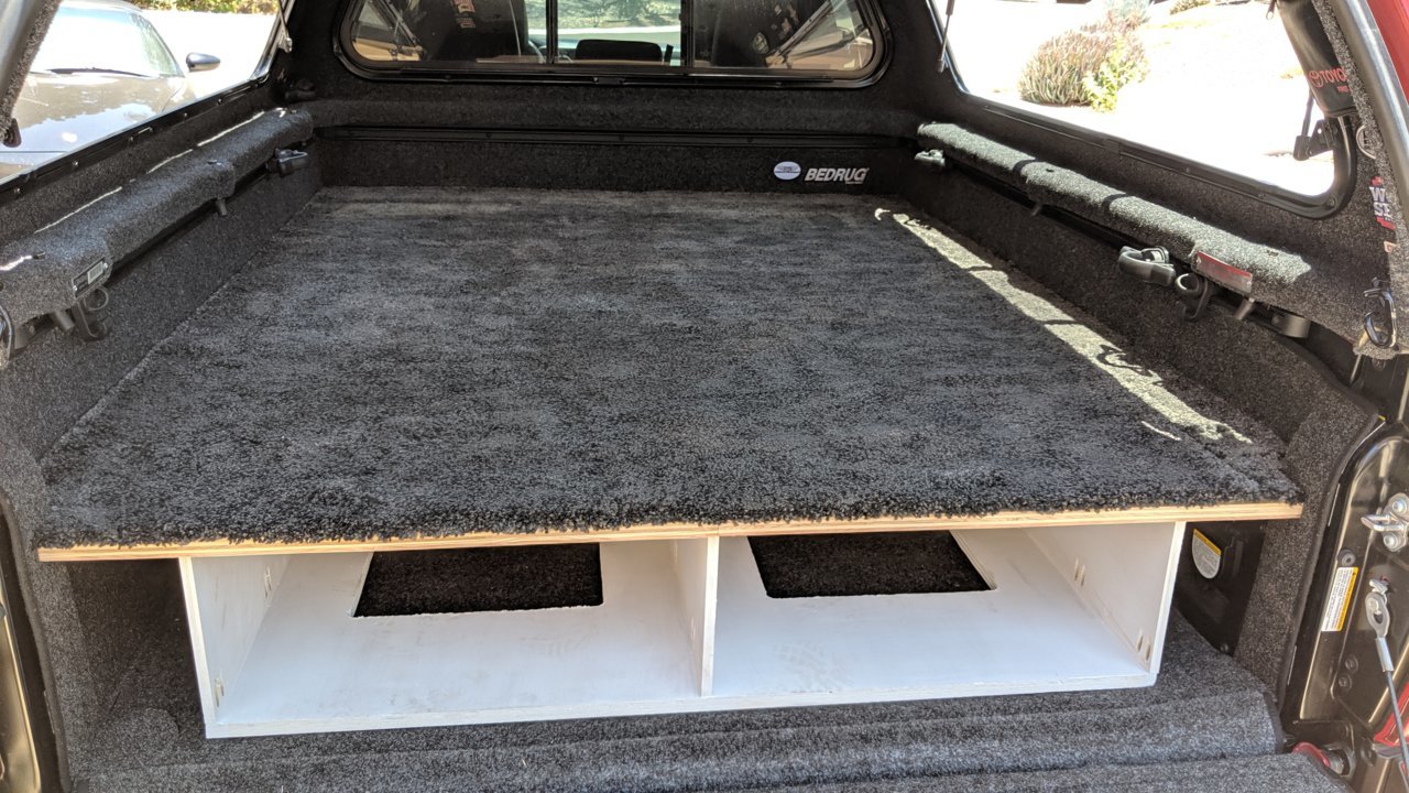

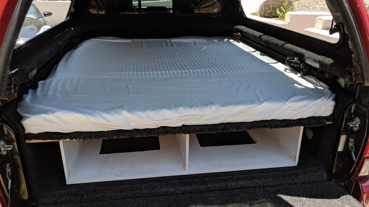

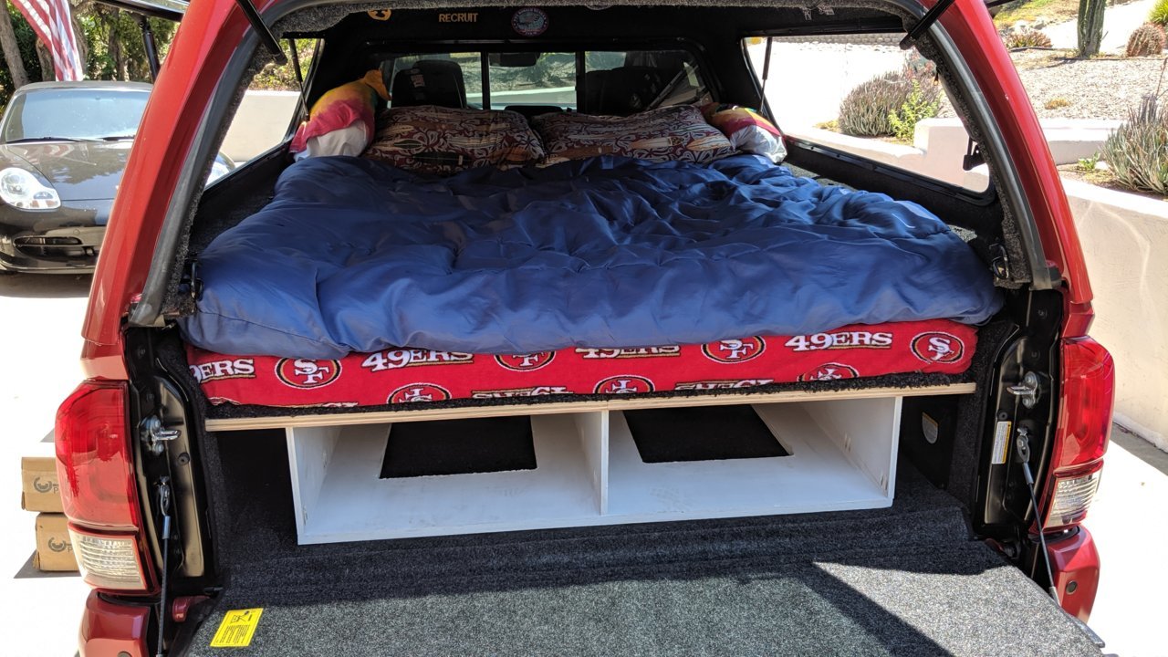

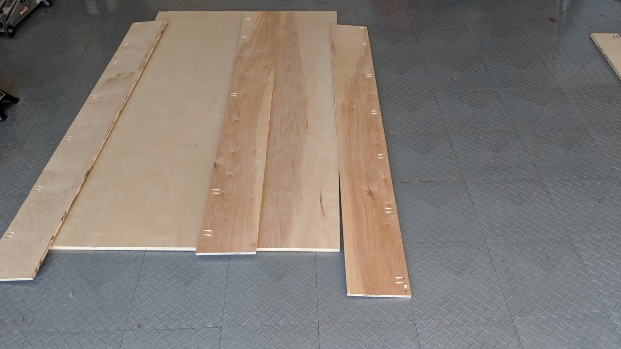

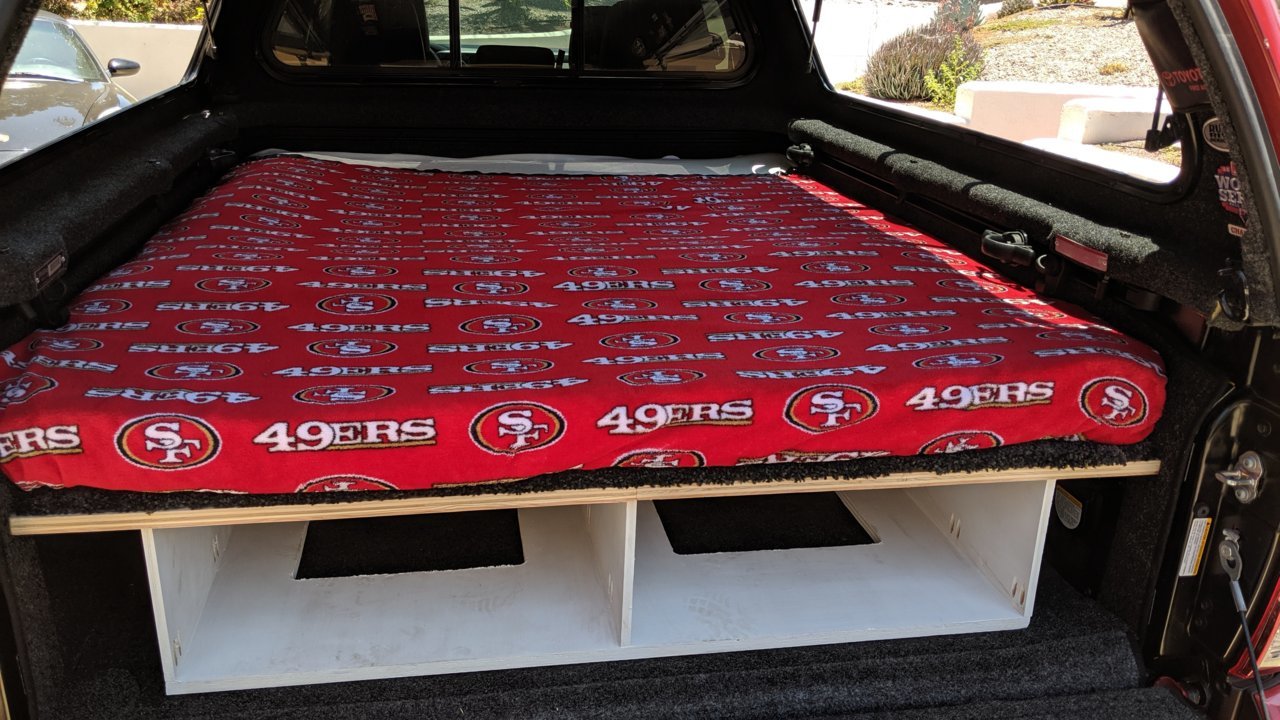

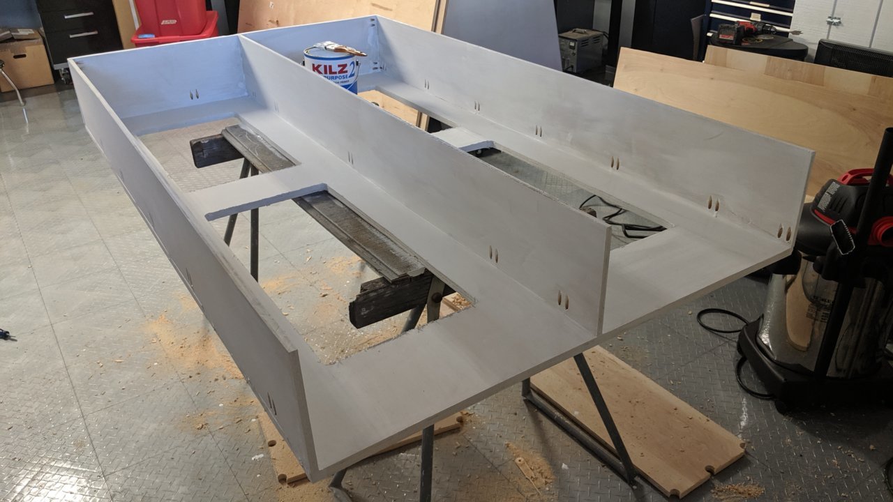

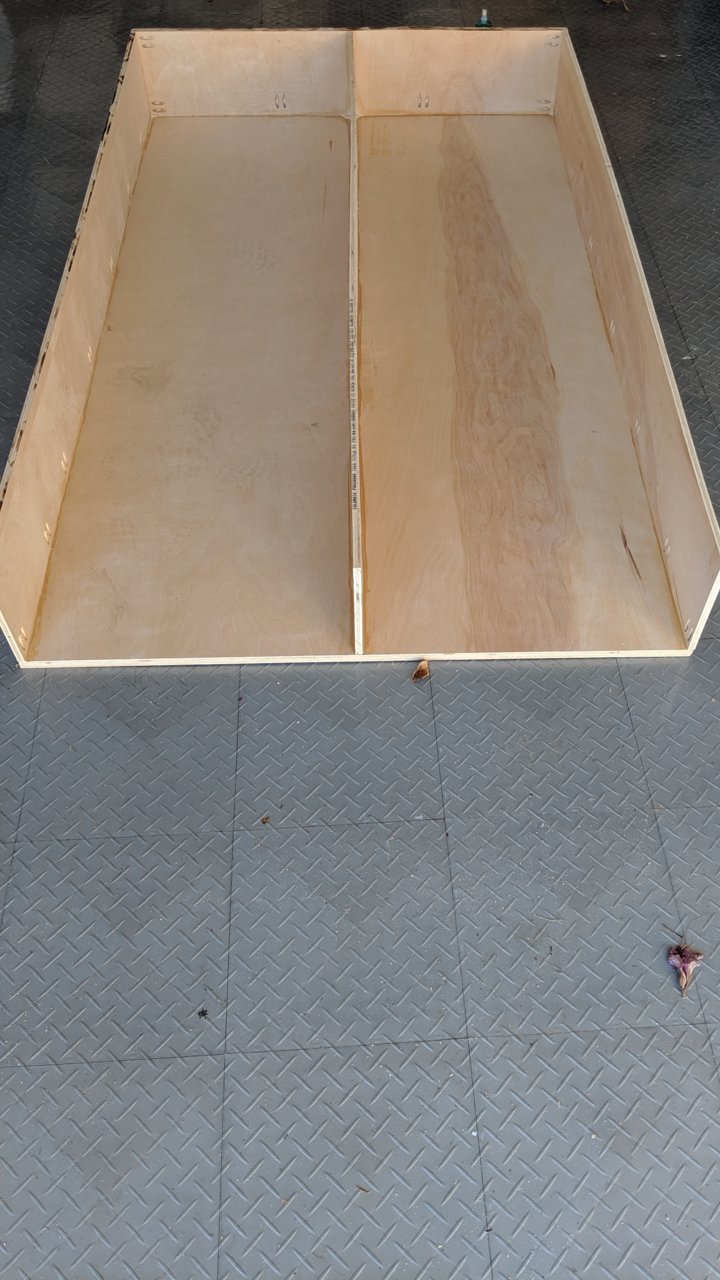

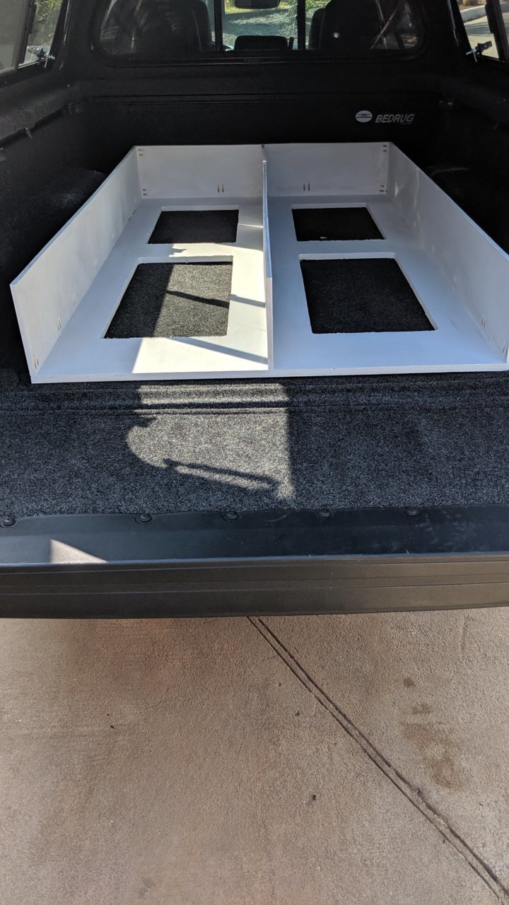

    Read every one of the 94 pages. Thanks to everyone who posted so far. Here is my build. I used 3/4" baltic birch plywood top and bottom with 1/2" sides and divider. I cut holes in the bottom platform to reduce weight. Kind of in a rush to get it usable so drawers will be built a bit later, but as of now I'm planning on trying to use solely UHMW polyethylene strips to make sliders, poly on poly contact. The right side of my platform is removable so that an ARB 82 QT refrigerator can sit inside the right side drawer. I added reinforcement to that side so the removable panel has better support. I think I'll be drilling holes for better ventilation also. I found the carpet at Ikea, 59.99 for the exact amount of carpet needed for a 57"x71" platform, but I did have to do some cutting and piecing in to make it have full coverage (the carpet came as 6'5"x4'6".) All in all I'm very happy with the outcome and I'll be using it this week. Mattress is a 3" memory foam mattress topper from costco, queen size and cut for length. Width was about 58 or 59" but it squishes in just fine to 57". Sleeping bag is one I've had for 10 years, its called the Grizzly. It is amazing for truck camping.

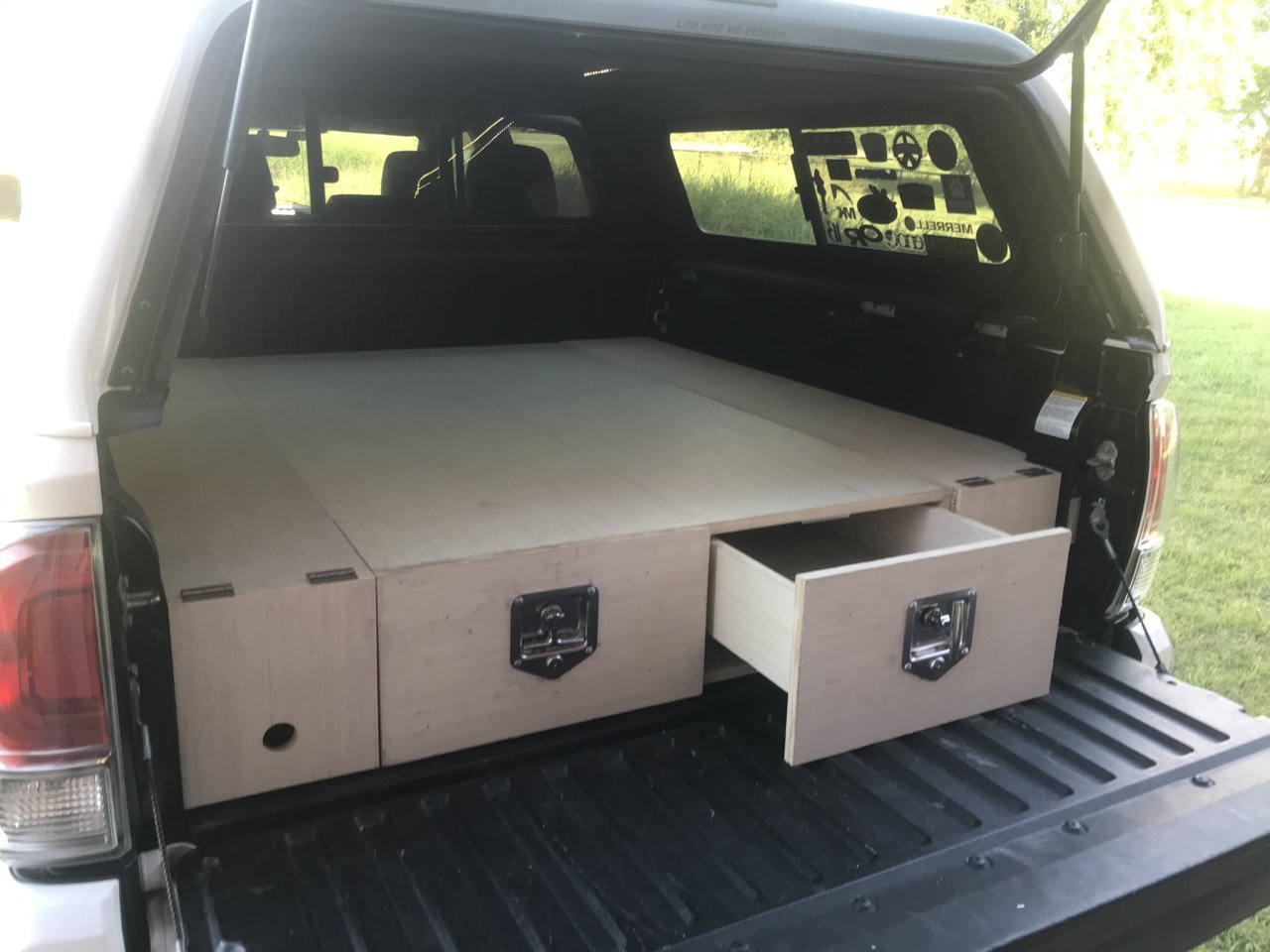

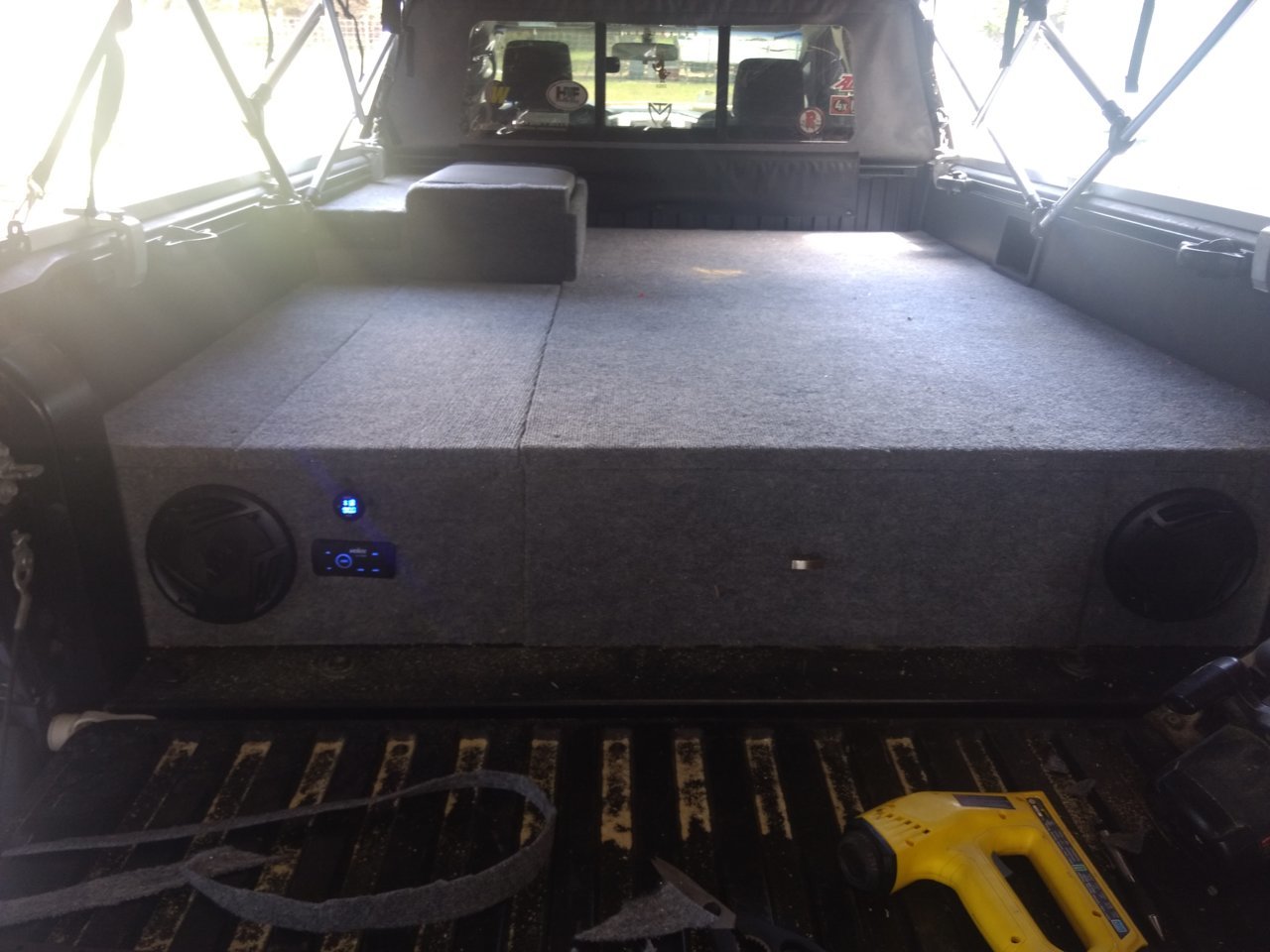

    Just finished mine tonight!! I may do a full build write up a little later for those interested 45951E5F-DA44-4553-B4CE-33A50855CFE9.jpg 8327F1FE-D960-4077-A7A4-127E624C444E.jpg

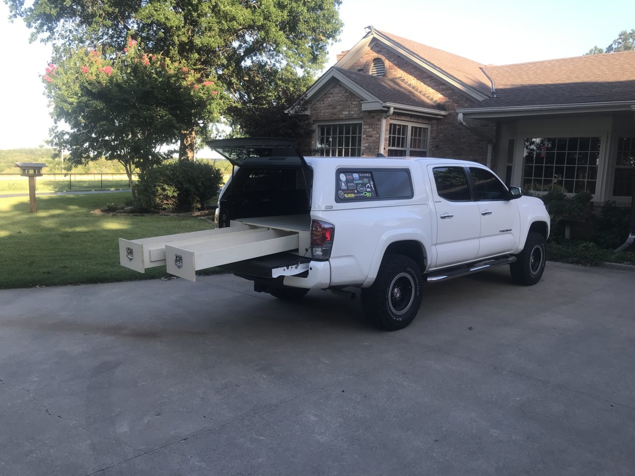

    My setup on a recent camping trip.

    I’m digging that extra long slide out.

    I took up the full 60" for both drawers too. It actually pulls out even farther and there is additional drawer space behind that cutting board area lol.

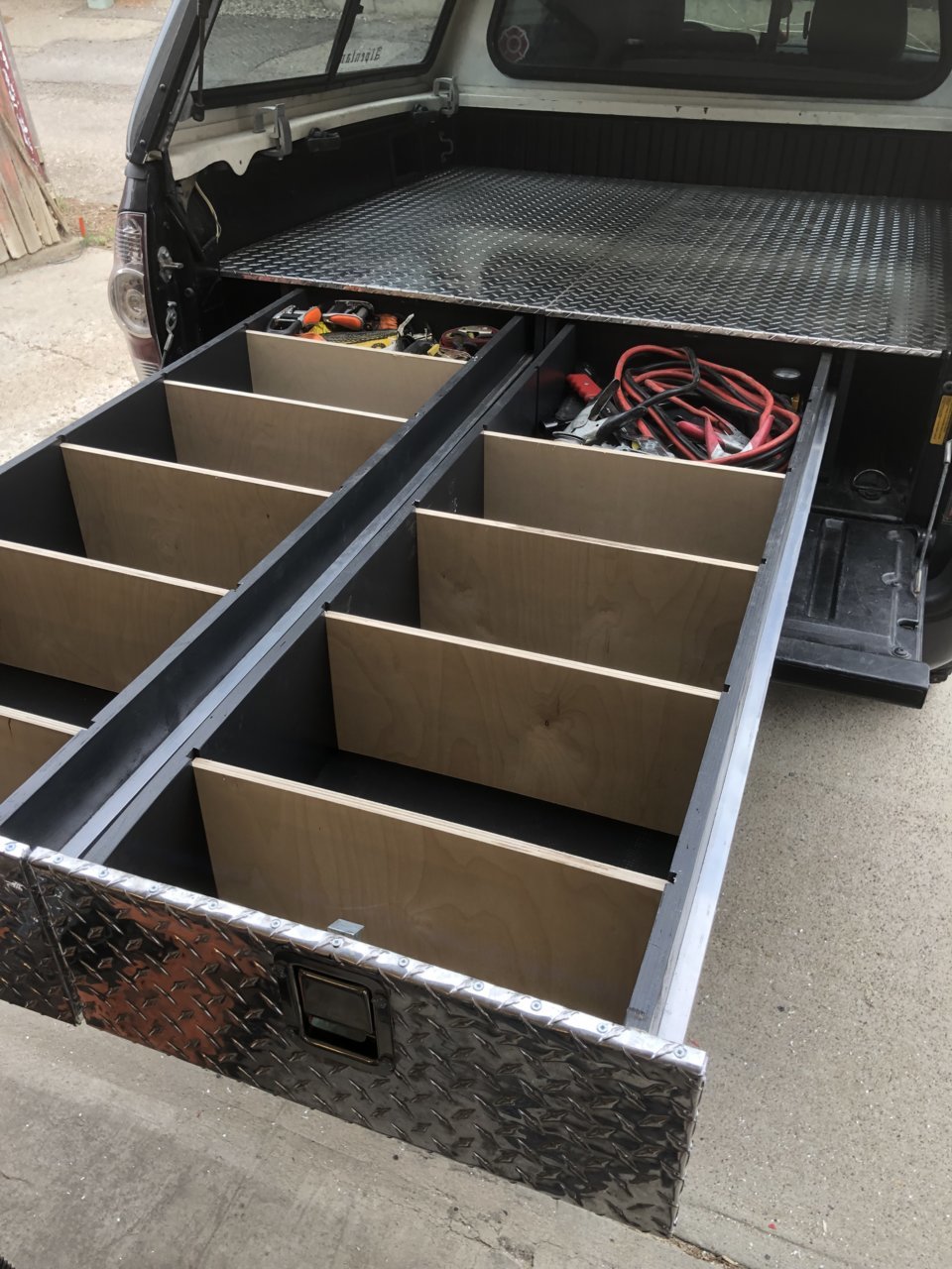

    Had a bunch of leftover diamond plate from a diff project

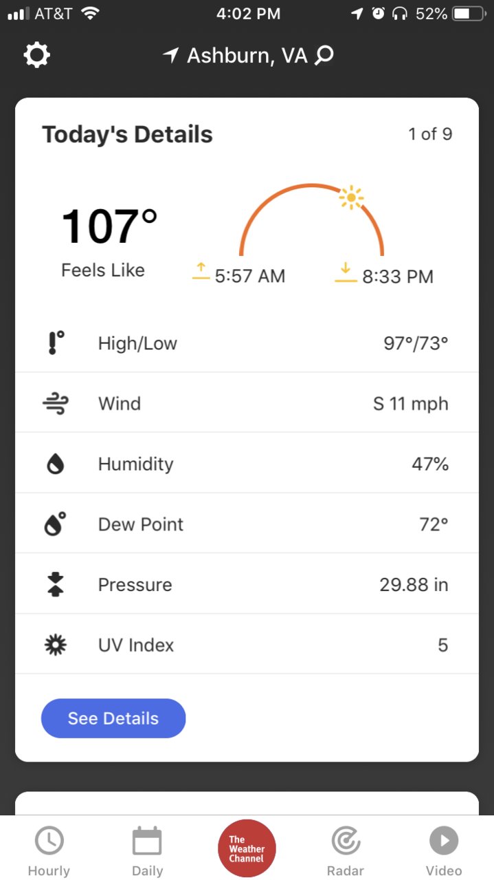

    Summer in death valley.
  18. Jul 17, 2019 at 6:51 PM
    #1758
    fatfurious2
    Jun 28, 2014
    #132884
    49,908
    David
    Ashburn, VA
    2010 TRD OR Access Cab
    And summer in VA apparently..
