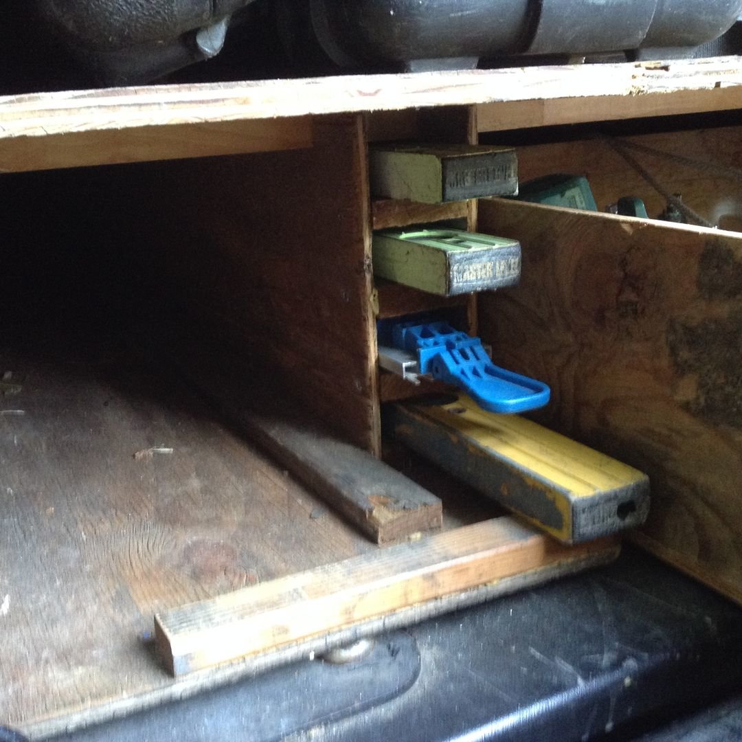

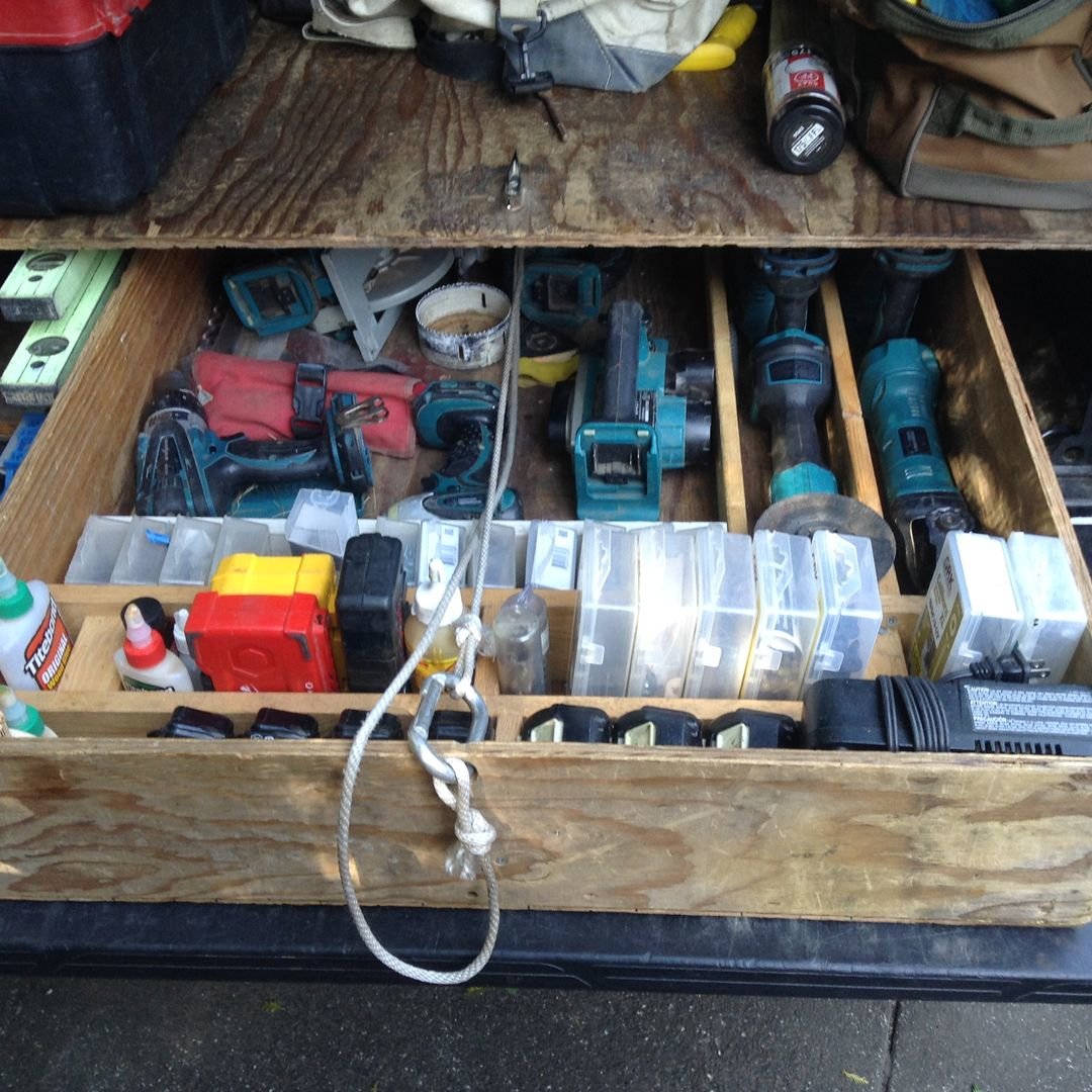

    The drawers aren't fancy, just 1/2" ply with a 3/8" ply bottom. What keeps the middle from dragging are the 1X dividers that segregate the tools and parts stored. The pulley is attached to the front cross piece and the back of the drawer. It rolls easily enough that I tie it off to a boat cleat to secure it but on a grade there's enough weight that I think I'll go to a double pulley on it. The wheels are mouted under the blocks next to the glue bottles on the left and 2 boxes in on the right, similarly up front.
    Wheels https://www.amazon.com/gp/product/B01N2UCY6M/ref=ppx_yo_dt_b_asin_title_o00_s00?ie=UTF8&psc=1

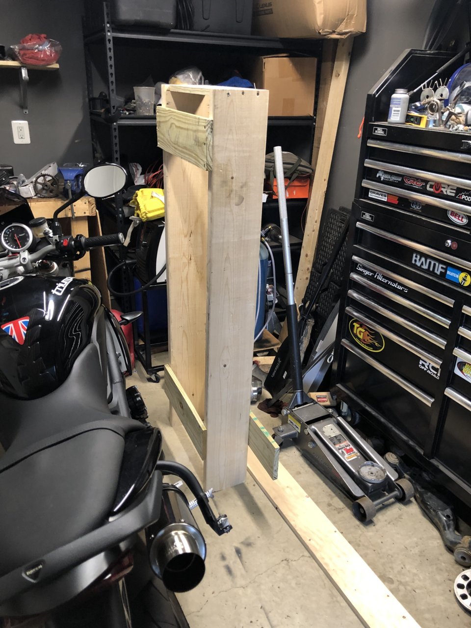

    Light and cheap drove my build along with a weight forward goal. I used some scrap 1 x 8 maple which is lighter and plenty if you use a vertical center support and 1/2" ply is also all you need. The support can also be used for storage of your high lift or other long items(mine holds 3', 4', 6' levels and a straight edge clamp.
    51152225-8D71-45A7-B133-C1A7962A65A1_zps_d6426d3a014b60ec6892ac99e6ae01de37b3bae3.jpg
    The space on the left is for my saw stand.

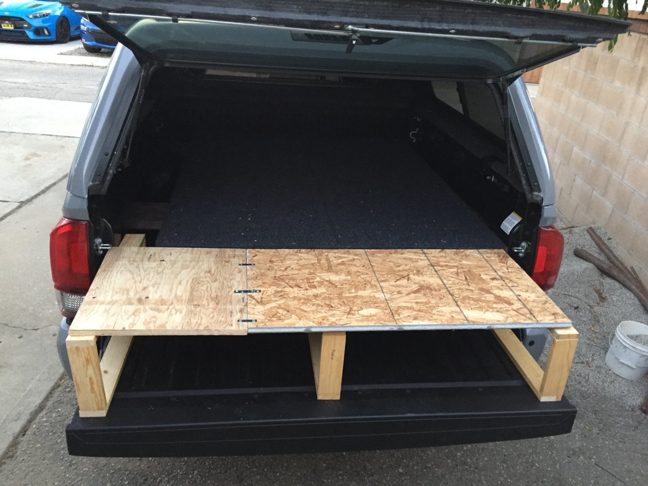

    Built a basic bed for solo camping and added an extension for the +1. Setup is completely removable and takes 2 minutes to remove. Plan is to make a tarp/canvas cover for when the camper glass is up and is tailgate down. Also, any recommendations for a mattress topper?
