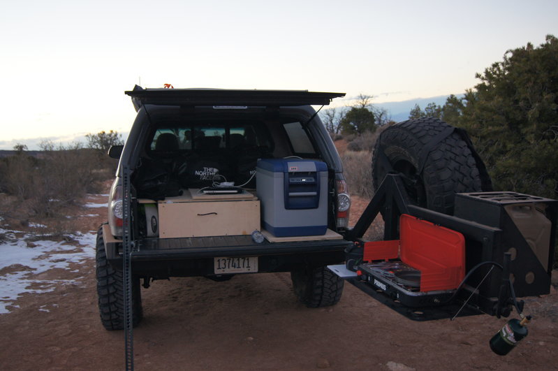

    Sleeping platform with storage. Cooler/ nite stand ,my mr. buddy heater and solar panel on window going to battery under sleeping platform to 600w inverter.

    Nice simple set up Easy_rider

    looks good. Is that heater mounted? How did you do that

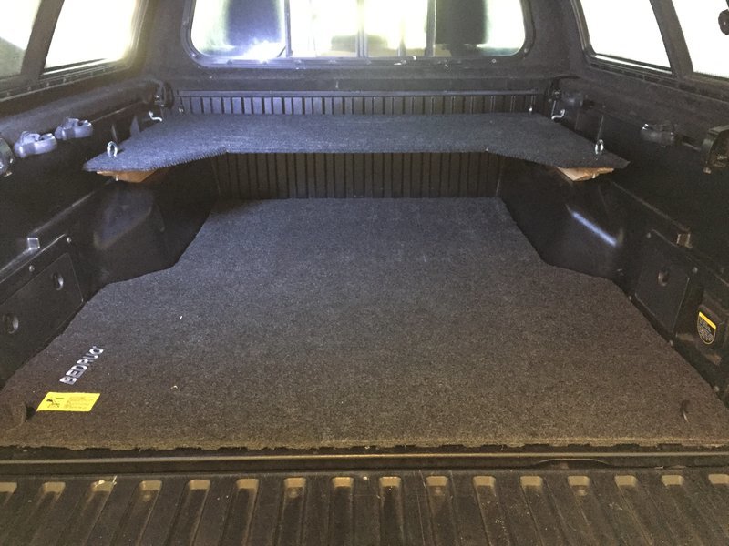

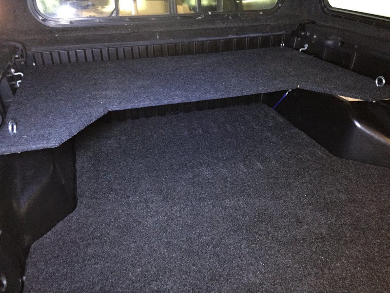

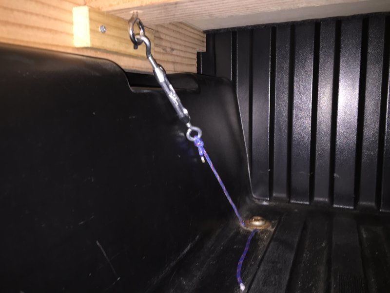

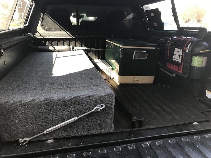

    Great job! I used full length double hook turnbuckles to connect from my eye bolts to the bed tie downs. And rubber instead of carpet for mud clean up. And dog hair. I also did not do a cut out in front of the platform, I used a 1x2 to reinforce the lip. Cabela's deluxe cot pad and it is very comfy, can sit up and good room for gear, dog and me.
    Perspective is hard to see in this night time picture but basically the same setup. For more than a few days hunt with the dog or snow I will pitch a tent or find a cabin. But for quick overnight setup anywhere I want it works great.

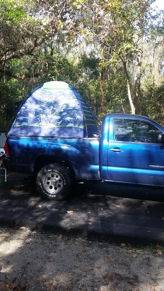

    Got a lot of stuff lol
    Don't have a cap but I made a tent out of a kids tent and I used the snaps ony cover to hold it down.

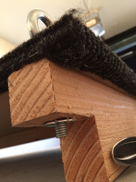

    I have a question for you guys who have built platforms in the bed of your trucks. What boards are you using to lay in the cutouts on each side of the bed? I remember measuring that notch and the only board I could find at Lowes/Home Depot that would fit was a 1x5. It fits with no cutting, but it's a bit flimsy. Are you guys using a wider board and notching it to fit?
  15. Apr 4, 2017 at 6:18 PM
    #175
    Sudsman44
    Sudsman44 Well-Known Member
    Jun 1, 2016
    #188472
    603
    Abington PA
    2012 Tacoma Access 4x4
    Ranch cap w/ rhinorack bars, 5100s, Deaver AAL, 2” front receiver, Matt Gecko bedlights, yadda yadda…
    2x6, notched on the ends about I" long by 3/4" deep.

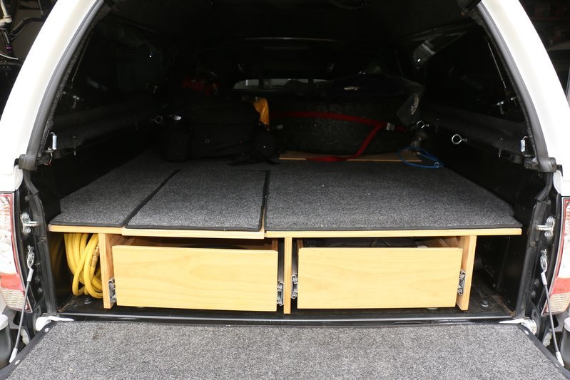

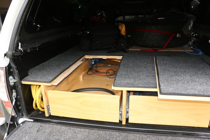

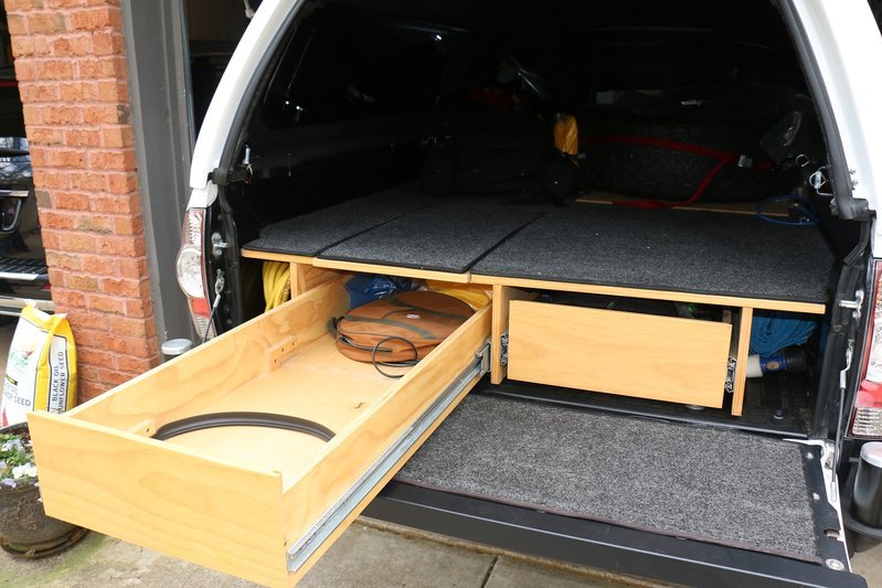

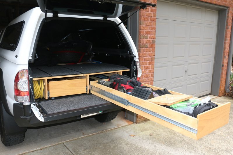

    Here's mine.
    3/4" plywood deck, supports and drawer boxes. 60" slides. (I have a 6' bed.)
    The left side deck has a cut-out for my Engel fridge.
    Two 60" drawers:
    An air compressor is on the left side, forward of the yellow air hose. The right side holds a tarp and hammer for tent stakes.
    It is a little heavy, and the long slides are heavy too. However, functionally it is wonderful.

    what did you do to your suspension to handle that load?
    are your bedsides spreading with that cap on it?
    what's the purpose of the marine carpet on the inside of the tailgate?
    nice slides, they look more than adequate
    Nice looking job,
    Pete

    and that cooler is a beauty, nice setup
