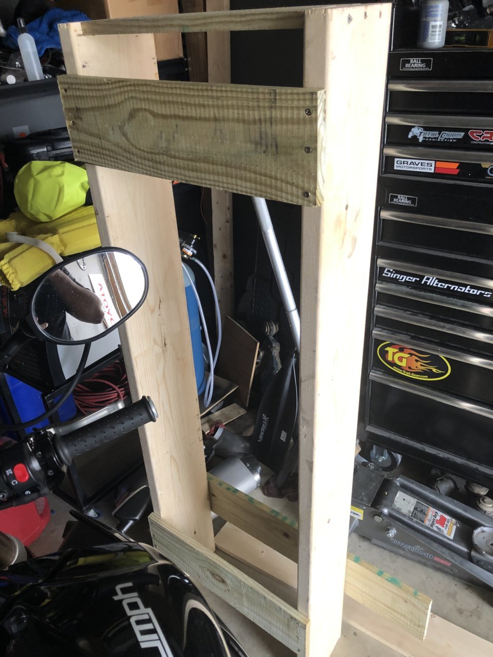

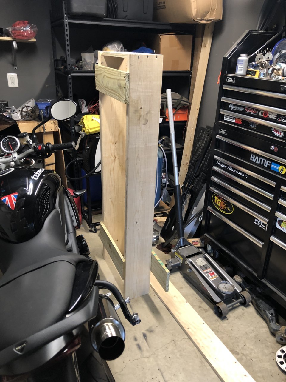

    I have 2x8 for the sides, and 1x6 supports.
    I haven't started the actual drawer yet. I have a bunch of skateboard bearings that i was thinking of using, and I just thought I could do a 1x1 aluminum angle for what they can slide on, on the drawer itself. Im not sure yet though

    Aluminum angle is cheaper, but it'll flex more with load applied than aluminum square tube.
    fatfurious2[QUOTED] likes this.

    I will do that then. And I can use the 3/4 for the bottom of the drawer too

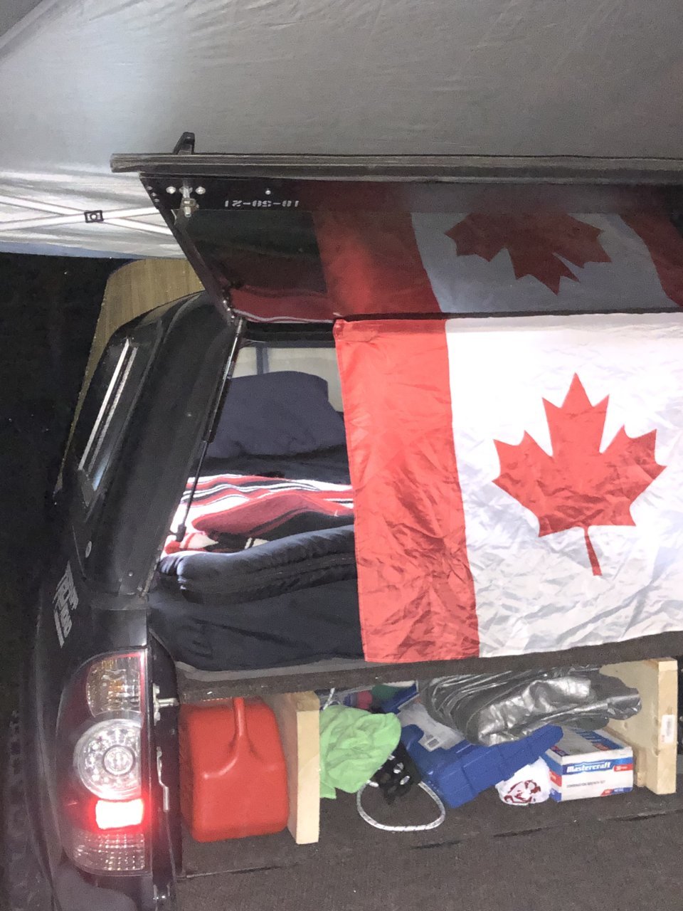

    First night out in a few months for me. New motivation again to make my work trips cost effective AND enjoyable at the same time. Hotels after a long hard day on the job can be depressing. So I’ve decided to switch it up.
    Campsite in Alberta, no power or water hookups. Potable water elsewhere in campground. Free showers and firewood were the REAL selling point. It’s easy to make it work, and as a rookie, I don’t completely go off the grid.
    Day 1 of 10 for me, so I’ll have lots to learn as I go.
